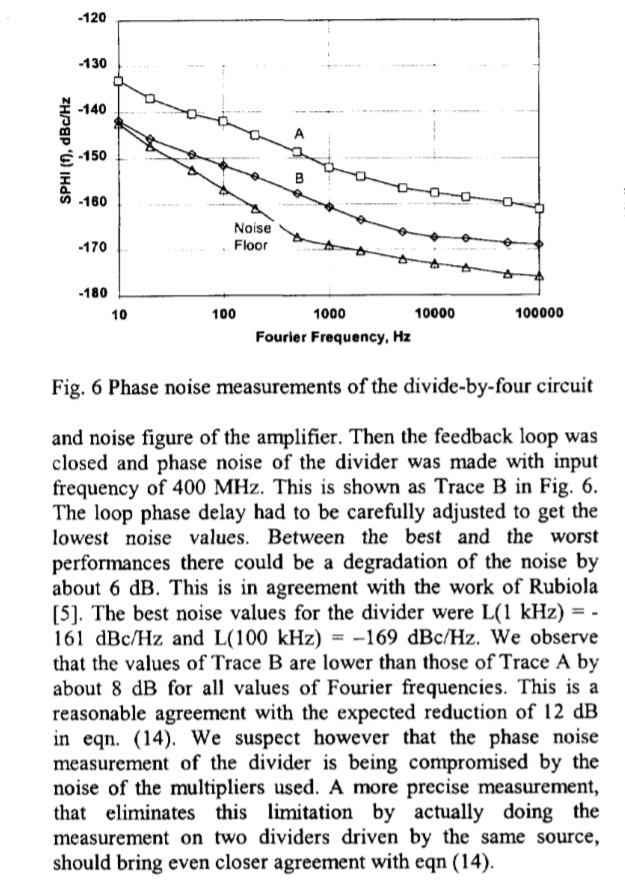

Just an example.
P.S.
I forgot, you cannot reach this performance with FPGA and flip-flop, you have to change the approach.
The above attachment shows the phase noise of the carrier to be divided (trace A) and the phase noise of the divider by four (trace B).
As you can see the divided signal is 8dB better than the original signal, although the improvement should be the theoretically 12dB.
So such dividers already exist and no PLL is needed.
This is another one using the same tecnique, it achieves -150dBc at 1 Hz and -162dBc at 10Hz from the carrier.
But as I said above forget FPGA & flip-flop to achieve these results.
You are wrong, the real product is ready to be tested and optimized.
It looks like you have not understood, in audio we don't need a microwave signal at 8 GHz, we simply need a pair of SOTA oscillators at 5/6 MHz to divide down to 44/192 kHz with a very low noise divider like the regenerative one.
You are free to continue enjoying with FPGA and flip-flop, but you have just seen the results.
The spurs of the measurements of your FifoPi have been suppressed, because they are out of interest, but if you want I have saved the original data and so I can publish the plots with spurs.
"BTW, the result is also not good", I hope you are joking, -150dBc at 1 Hz from the carrier and -177dBc noise floor!
I have to remind the phase noise of the FifoPi SCK: -74 dBc with the Crystek and -96 dBc with the Driscoll at 1 Hz from the carrier and -120/130 dBc noise floor, that means the phase noise of the FifoPo is 75 dB worse and the noise floor is 50-60 dB worse.

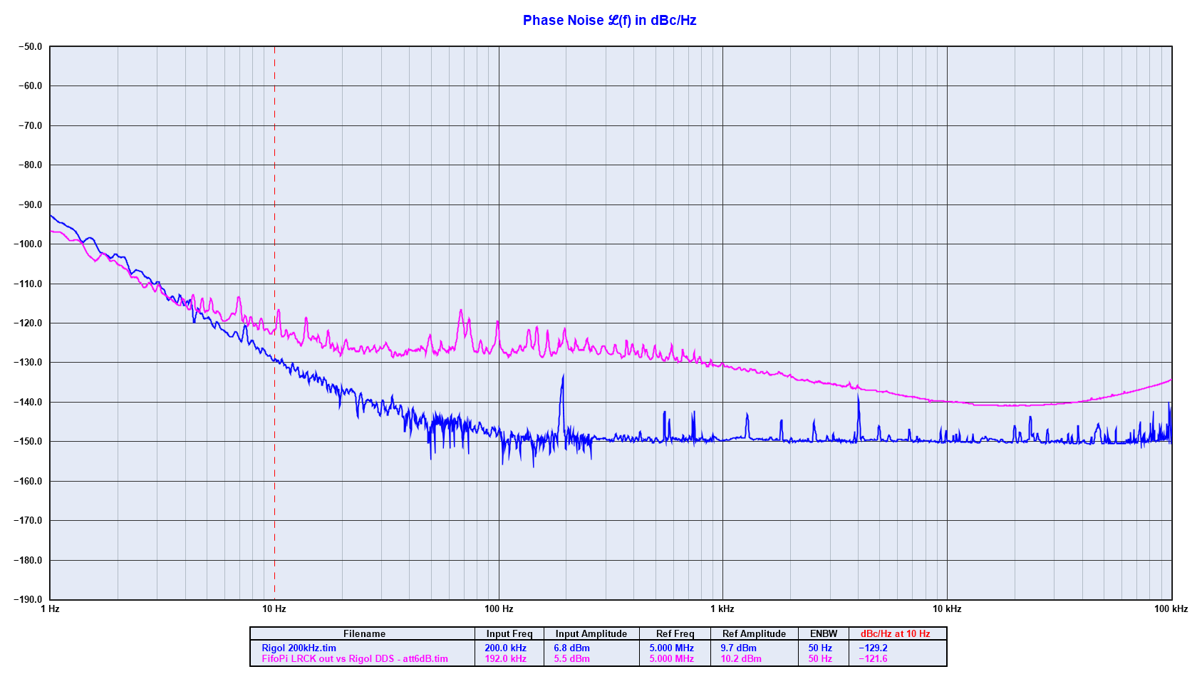

Next question.. It's my fault but where do I find the DDS generator spectra?
I attach the phase noise plot of the Rigol DDS generator at 200 kHz.
The cheap DDS generator performs around 8 dB better than the FifoPi at 10 Hz from the carrier, 25 dB better at 100 Hz and 20 dB better at 1 kHz.
But it is a losing battle, the measurements are not trusted in the opinion of the designer, since he claims that "It seems you are trying to degrade other's solutions by something that doesn't exist by now or not true".
I'm very stupid, I got an expensive gear to measure the phase noise while I could do better with a cheaper oscilloscope. Maybe I should have bought the Jitter package for my Lecroy WavePro 954, I would also have saved a lot of money.
Now I can figure out how stupid is Symmetricom (now Microsemi) who has bought the Timepod project from John Miles (the designer).

@Gerhard, thanks to explain that spurs have nothing to do with phase noise.
@Ian
I don't want to degrade your solutions, I have simply measured the phase noise performance with a suitable gear certified by Microsemi.
I have not filtered anything into sine wave, I have measured directly the square wave at the u.fl sockets of the FifoPi.
The Timepod also measure CMOS and other square-wave clocks.
Obviously you are free to publish your jitter results, I wonder what do you want to explain with a standalone number, but I look forward to know your explanation.
As I said your FifoPi is source dependent, as you know I have bought several boards from you and I have sperimented on my skin the sound difference changing the source.
This means that at least a part of the jitter from the source is not suppressed by the FIFO and the reclocker, and finally the noise reaches the output (or it's generated inside the FIFO).

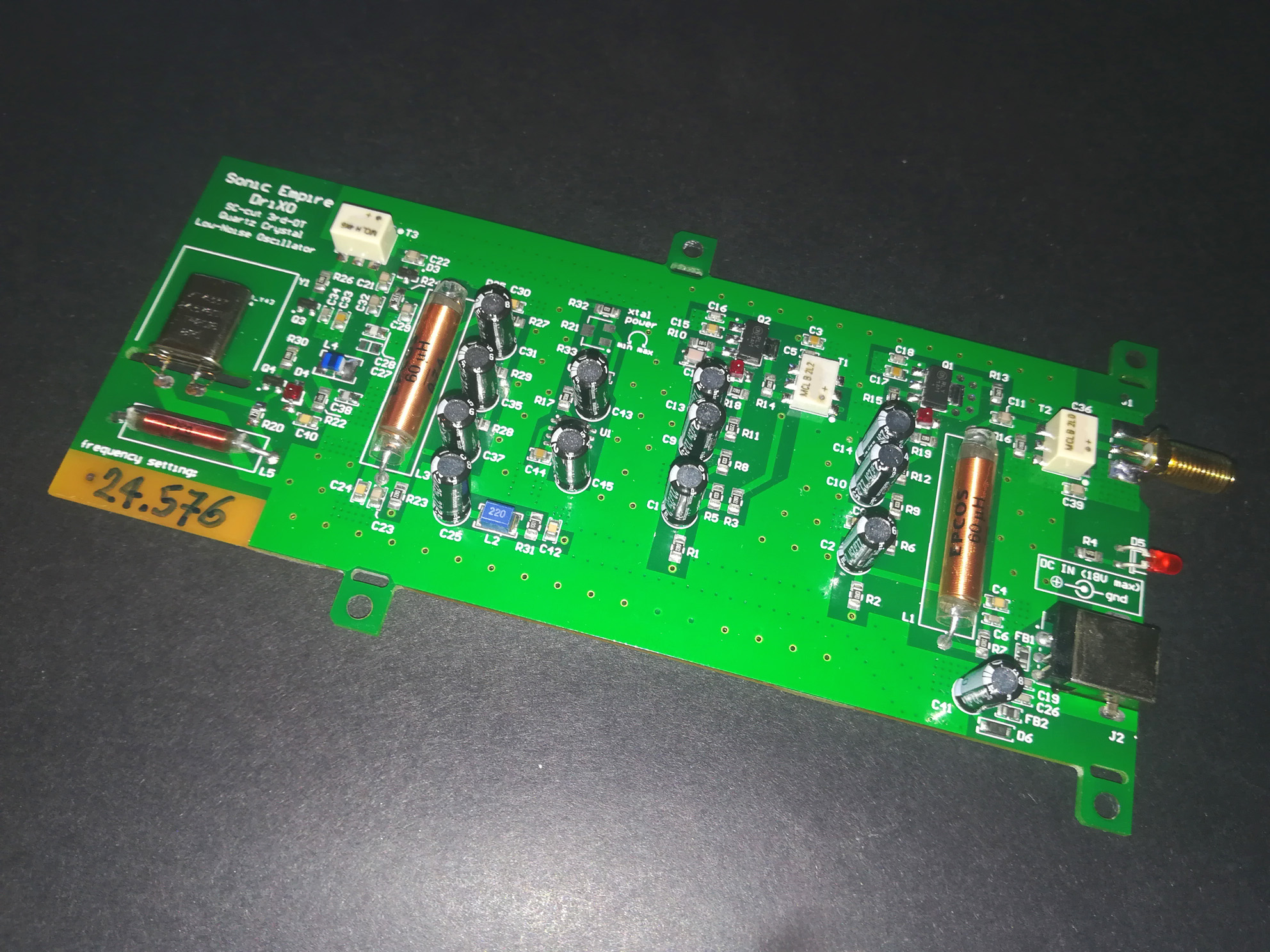

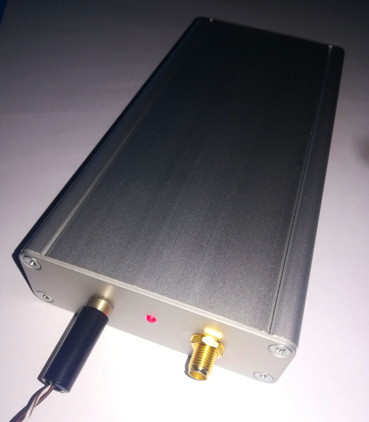

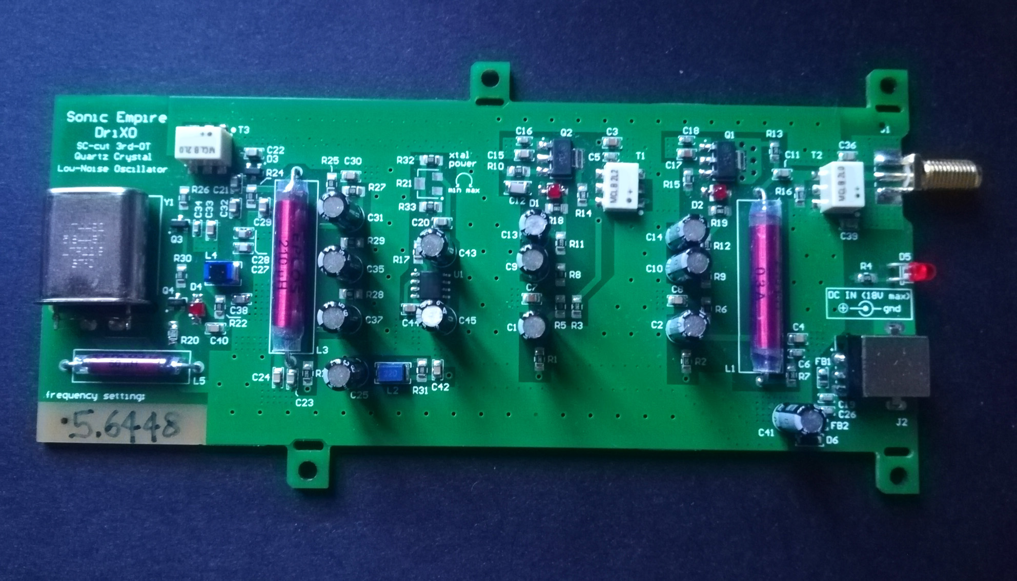

Back to the topic, some pictures of the finished Driscoll oscillators.
Oh this looks super nice, can’t wait for the bom and final measurements.
Just out of interest as the last picture also shows a casing, have you looked into shielding materials and do you have a distance recommendation as to speak how far is far enough from other equipment like psu, raspberries or DACs?
Mmh perhaps I have to build myself a rfi/emi sensor probe ;)
The box is a standard Hammond aluminum case, I will publish the item code from Mouser and Digikey.
I suggest to keep the oscillators far from other devices, at least 1 meter.
I suggest also to keep any other device as far as possible from the Raspberry.
Don't stack the devices.
