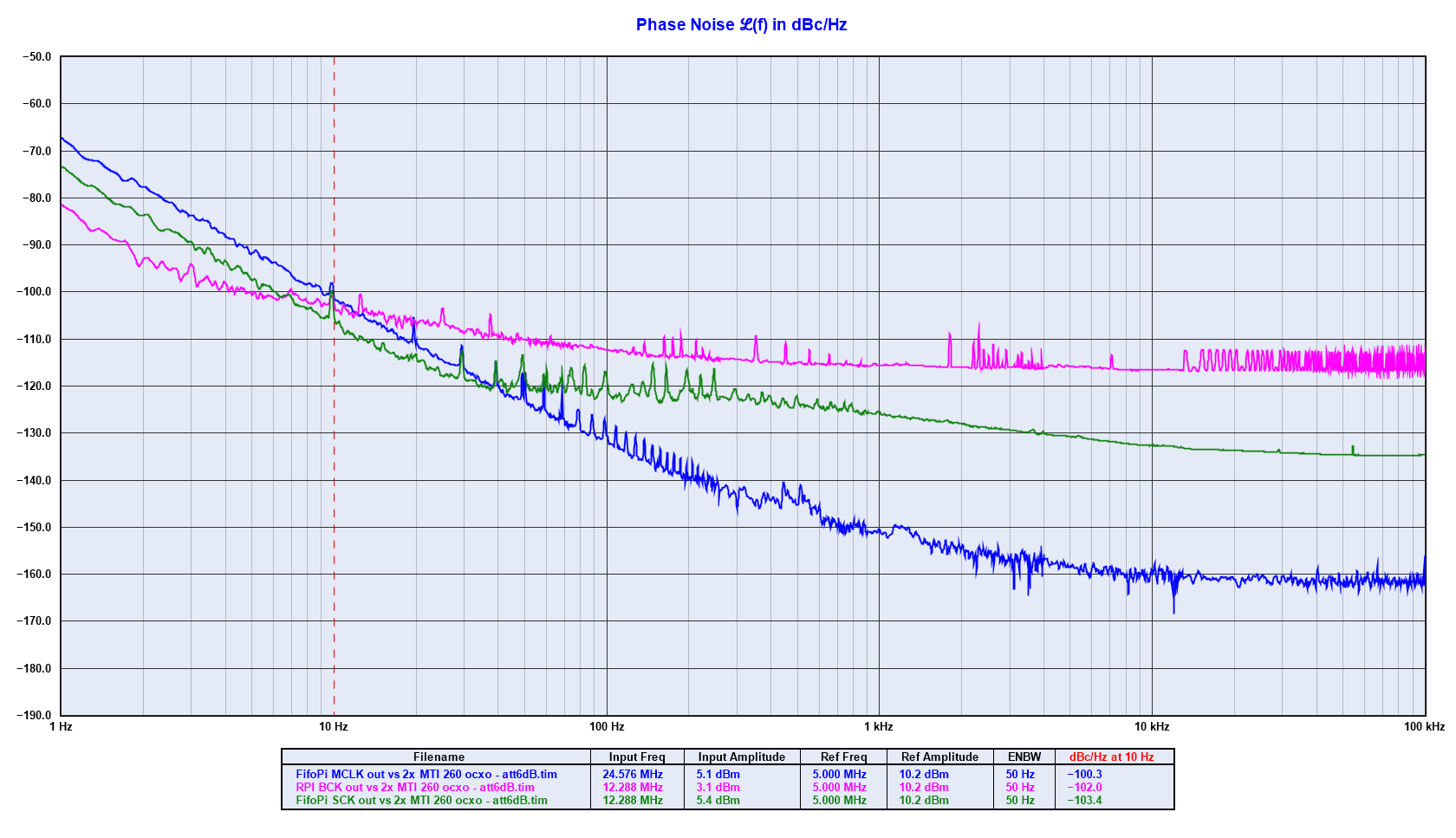

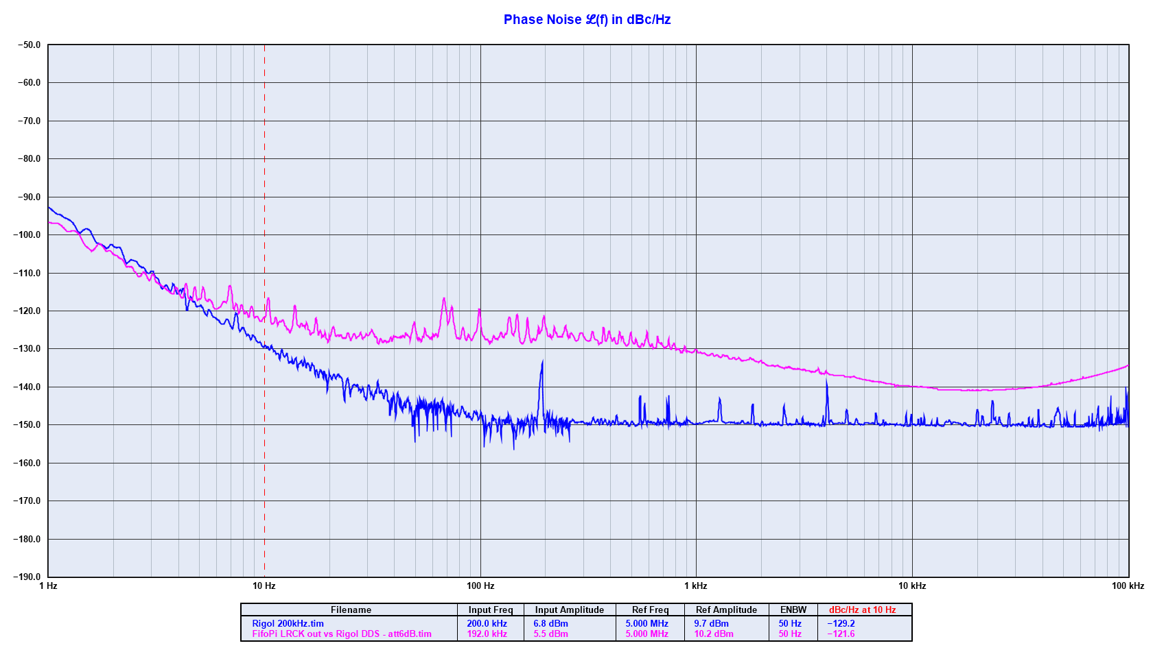

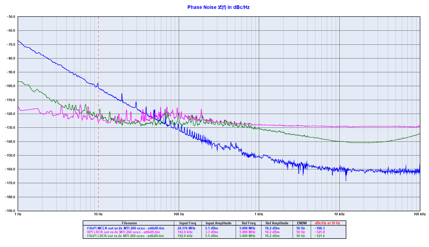

@Joseph
regardless of the spurs I wonder why the noise floor of the FifoPi LRCK is so high, almost the same of the RPI LRCK, while the noise floor of the MCLK is 20-30 dB better. Almost the same result with SCK.
I also wonder why FifoPi LRCK has crosstalk, crearly visible with the oscilloscope.
I also wonder why a cheap DDS signal generator has 20 dB better noise floor than the FifoPi.
Finally, I wonder why the FIFO buffer is source dependent, the better the clock of the source the better the sound.
I have my idea, but I'm here to learn, so please let me know.

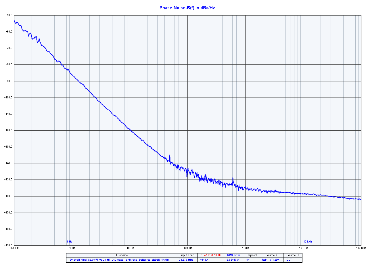

The phase noise plots of the Driscoll oscillator with a new set of crystals at all the frequencies.

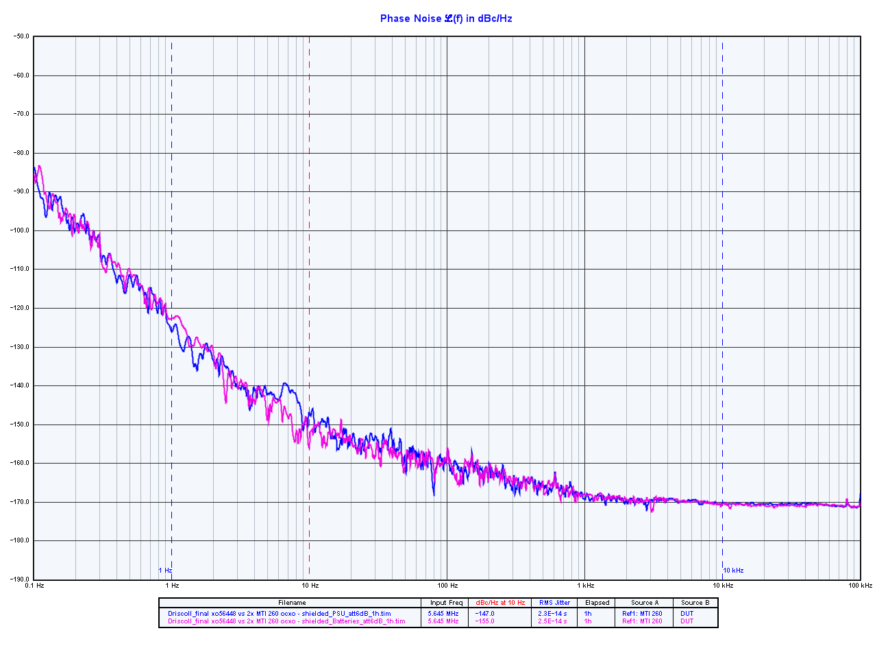

Andrea,With the 5.645 MHZ the battery has the advantage at 10 Hz, on the rest of the spectrum the difference is not huge.
At 1,5 Hz, the non-battery is 7 dB better... to make sense these measurements maybe need some smoothing?

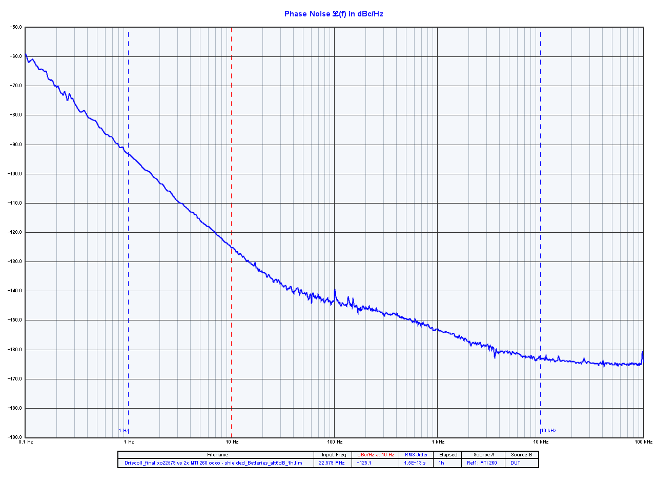

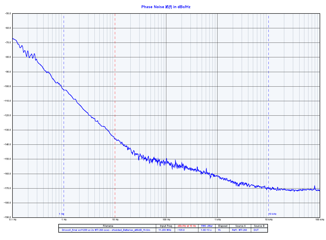

Looks good Andrea!
A couple of questions out of sincere interest...
1) How does the 5.6 MHz w. 2x frequency doublers compare to the 22.6 MHz?
2) Possibly a (very) stupid question. When comparing oscillators with different frequency is it 'better' to compare the phase noise at 'equal' or 'equal relative' distance from the carrier (i.e. @ 10 Hz for both 5.6 and 22.6, or 10 Hz for 5.5 and 40 Hz for 22.6)?
Just curios.
Keep up the good work!
The new Driscoll oscillator is not much sensitive to the power supply so a good linear regulator does the job almost like batteries, although I would decouple it from the main AC.
BTW, the battery power supply has been designed not only for the oscillators but for the whole digital chain, except for the FIFO buffer because it operates in a differente domain and is optically isolated.
We plan to power with battery the sine to square converter, the dividers and the DAC in both Lite and top version.
Looks good Andrea!
Just curios.
We are still working on the frequency doubler, so you have to wait for a comparison between 22/24 MHz and 5/6 MHz followed by frequency multiplier.
About the comparison between oscillators at different frequency keep in mind that every time you double the frequency the phase noise increases and the progression is not linear.
As I said several times the best phase noise performance is reached with crystals at a frequency around 5 MHz, so I suggest to use the lower frequency your system requires.

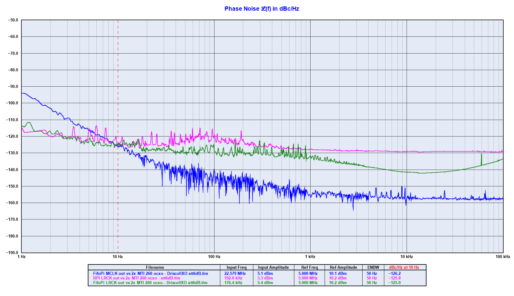

Questioning about andrea_mori's testing(3), Real RPi LRCK time jitter measurement
The first picture is the time jitter histogram plot of my RPi 4B LRCK signal before FifoPi. I2S was running at 192KHz 32bit.
The second picture is the time jitter histogram plot of the same LRCK signal after FifoPi.

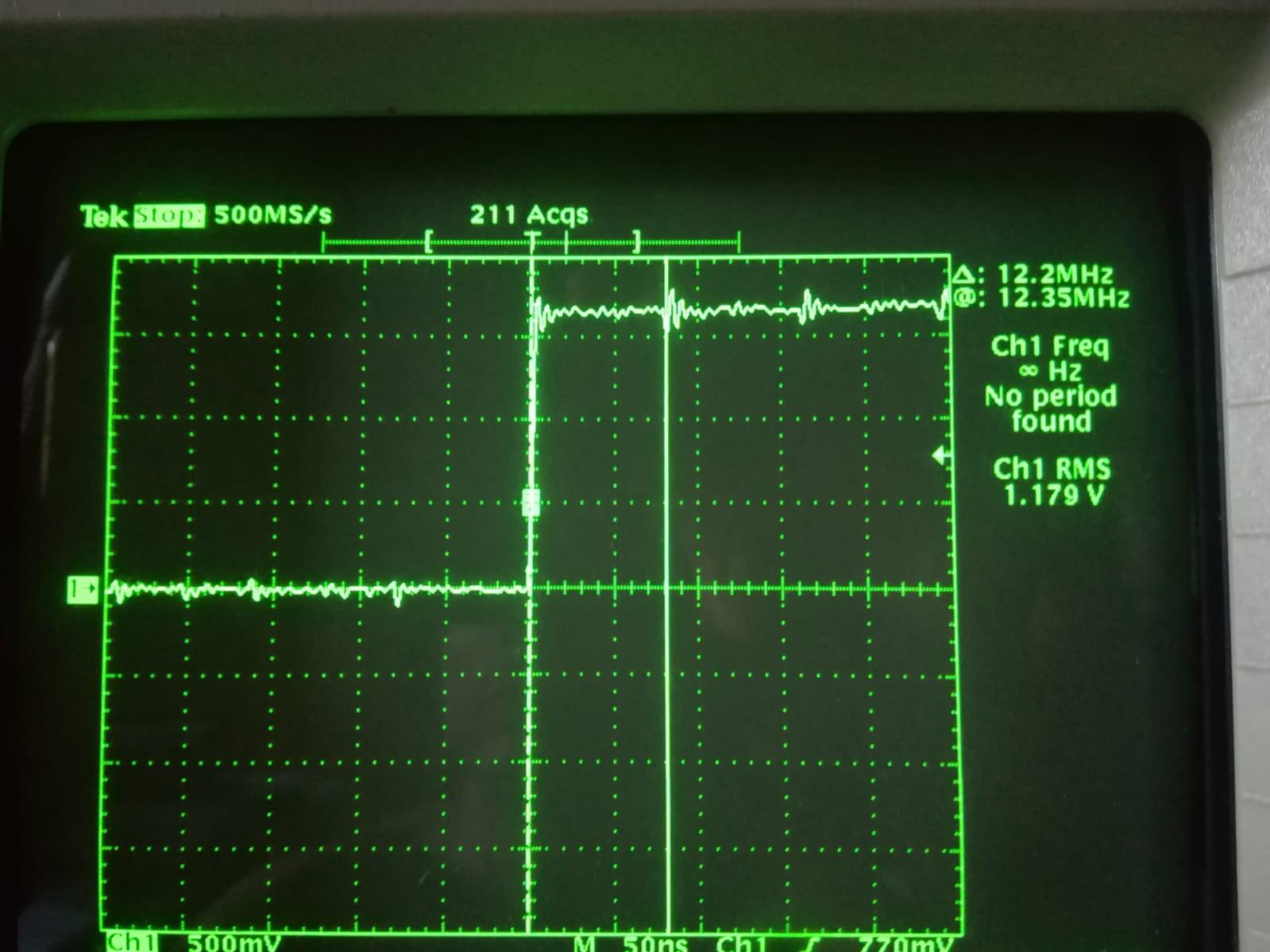

The third picture is the direct analog waveform view of RPi LRCK before FifoPi.
The fourth picture is the direct analog waveform view of the same RPi LRCK after FifoPi.
Testing results:
1. RPi LRCK signal has both random jitter and deterministic jitter. The two deterministic jitter deltas separated in around 1.3ns in between, both of them are very strong. which were from the systematic jitter of RPi internal PLL (to generate audio clock). The overall RMS jitter measured was 590.4ps .
2. After FifoPi, all deterministic jitter was removed. Based on the principle the LRCK jitter will be exactly the MCLK jitter + additive jitter of flip-flop. However, the jitter measurement noise floor seems to be a bit bigger because the sampling length was 64 times longer than the SCK. The LRCK time jitter after FifoPi is around 2.68 ps to 4.68 ps if excluding the noise floor. I think that's pretty reasonable. All input RPi LRCK jitter was removed. Output LRCK jitter has no business with LRCK input (jitter isolation).
3. Observation directly from the analog waveform also clearly supports the above testing results.
4. Rising time also reduced to 1.19ns from 2.25ns because FifoPi output has much higher bandwidth and speed.

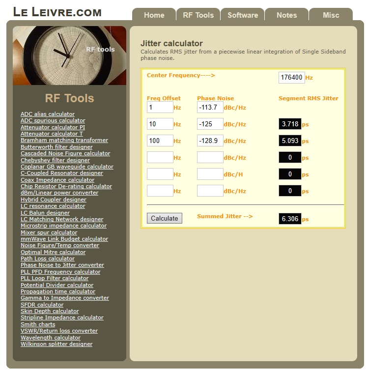

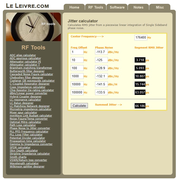

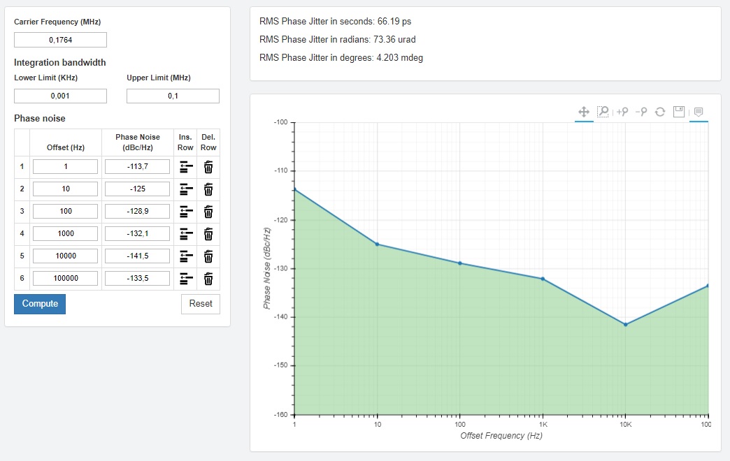

I attached andrea_mori's LRCK phase noise plot and phase jitter calculation for reference. I see three problems in his testing results.
1. His phase noise plot (pink) didn't show any RPi LRCK systematic jitter signature in frequency domain (the pink curve). What was missing?
2. His FifoPi LRCK phase jitter calculated was RMS 66.19ps, roughly 20 times higher than the 2.68 ps to 4.68 ps time jitter measurement result. That's totally wrong. I don't think his measurement and calculation are reliable.
3. In his measured phase noise plot, the LRCK signal before FifoPi (pink) and after FifoPi (green) look almost the same. That's very unreasonable. The huge difference can even be clearly figured out from the analog waveforms, why can not his TimePod see it? Can we trust his 192KHz out of input range testing results?

"The LRCK time jitter after FifoPi is around 2.68 ps to 4.68 ps if excluding the noise floor."
"His FifoPi LRCK phase jitter calculated was RMS 66.19ps, roughly 20 times higher than the 2.68 ps to 4.68 ps time jitter measurement result. That's totally wrong. I don't think his measurement and calculation are reliable."
Well, let remove the noise floor from the integration bandwidth and magically the calculated jitter from the phase noise plot become 6.3 ps as in the second picture.
If you like then remove the noise floor so the calculated jitter matches your measurement.
But the noise floor is here, the first picture shows the amount of each integrated segment, 60 ps of the total jitter come from the noise floor.
Again, you look at jitter while I trust the phase noise, I don't want convince you, but try to read carefully the posts from other members, they have explained better than me what you have to look for.
"Observation directly from the analog waveform also clearly supports the above testing results."
And also clearly shows a crosstalk, confirming the captured waveform of the third picture already published.

You forgot that you have the same noise floor issue with the SCK.
Please, take a look at the 4th and 5th plots, the noise floor of the SCK is even worse than the noise floor of the LRCK.
Moreover, if you don't trust the LRCK phase noise absolute values, take a look at the 6th, it's a comparison, so you can read it as a relative measurement: the noise floor of the FifoPi LRCK is 20 to 30 dB worse than a DDS signal generator.
It looks like you have noise floor issue, at all outputs and frequencies.
Again, please read carefully some posts from other members, they have suggested where the noise floor issue might arise.

03 rpi-fifopi-lrck-crystek-cchd-957-24-576-mhz-phase-noise-png.png102.8 KB · Views: 228
02 rpi-fifopi-sck-crystek-cchd-957-24-576-mhz-phase-noise-png.png106.5 KB · Views: 228
I would trust in his Timepod measurements over a digital sampling scope with a Jitter measurement package - ESPECIALLY when we are talking about close in carrier measurements (LF Jitter measurements)...
Digital scopes are not designed for high dynamic range nor LF noise performance - the reference timebase on an oscilloscope will not be temperature compensated and will sway about like a drunken sailor when compared to the Oven compensated oscillator used as the Timepods reference.
I have said the same several times, I would add that in digital audio we are looking for the best phase noise close in to the carrier and a digital oscilloscope cannot measure accurately in this region, as you said the timebase is not suitable.
Is there a schematic of your FifoPi? if the LRCK is outputted from an FPGA / CPLD then this will be the cause of the higher PN.
No schematic and firmware is unknown, but I suspect the same, I'm almost sure that SCK and LRCK are generated inside the FPGA, I don't know if the PLL was used to generate the signals.
The crosstalk indicates that there is an interference with the SCK.
