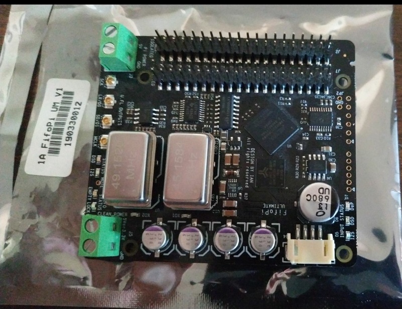

Not sure if my FifoPi is the latest version but if it is I will happily send it on Monday
Will verify with Ian.

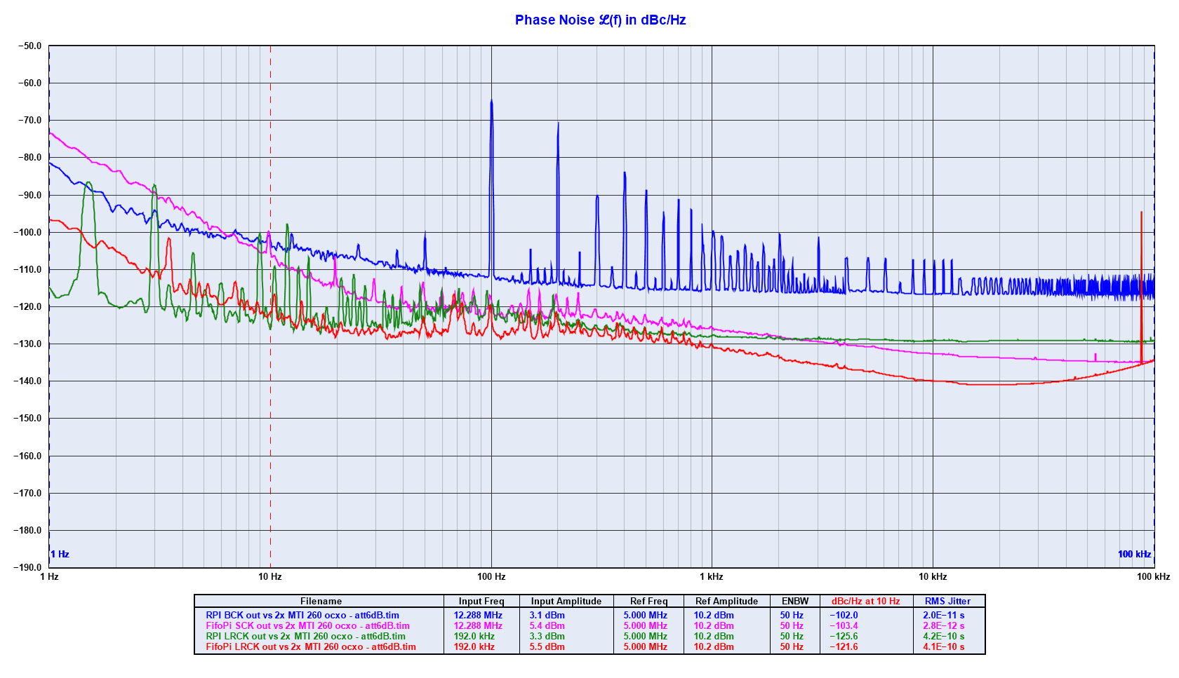

I don't see any jitter, I measure the phase noise, I have calculate the jitter using a converter.
As I said several time I don't care about jitter since it's a standalone number without the noise spectrum, useless for me.
You continue arguing about LRCK, but the phase noise plot tells that you have even higher noise floor in the SCK.
For your convenience, forgive for a while the LRCK since you don't trust the measurement with the Timepod at low frequency, but you have the identical noise floor issue at a frequency (12.288 MHz) where the reliability of the Timepod is indisputable.
Can you explain the reason?
You still not answer my question "Why can't you see the 590.4ps time domain random jitter and deterministic jitter in your phase domain measurement?"
If you can not see jitter, you should see something in phase noise.
2.
Because if you change the integrating bandwidth the jitter change too.
As you can see it's an arbitrary value, while the phase noise plot is absolute, it shows exactly the noise in dB of all the sideband.
You can't argue an absolute value, while you can argue an arbitary value.
Integration bandwidth has nothing to do with my time domain measurement.
To convert phase noise plot into phase jitter, you need to integrate the full bandwidth to make it equivalent to time jitter. If the bandwidth is not enough, the calculated phase jitter number will be smaller. But in your case it is opposite, the RMS 66.19ps calculated phase jitter number was much bigger than the 7.68ps time jitter. You didn't give us any explanation.

"TimeLab does not make a distinction between random and deterministic jitter, so any spurs in phase noise plots are “integrated” as if they contained only random noise."
I have measured the phase noise not the jitter, so I cannot see the jitter while you cannot see the spectrum of the noise.
Jitter measurements are useless for me, I need to see the spectrum of the noise, so as I said everal times I have calculated the jitter using a phase noise to jitter converter.
I have not converted anything from square to sine wave, the LRCK feeds the Timepod directly (I only use 6dB attenuator in all the measurements).
Anyway, the attached plots shows the calculated jitter from the Timepod.

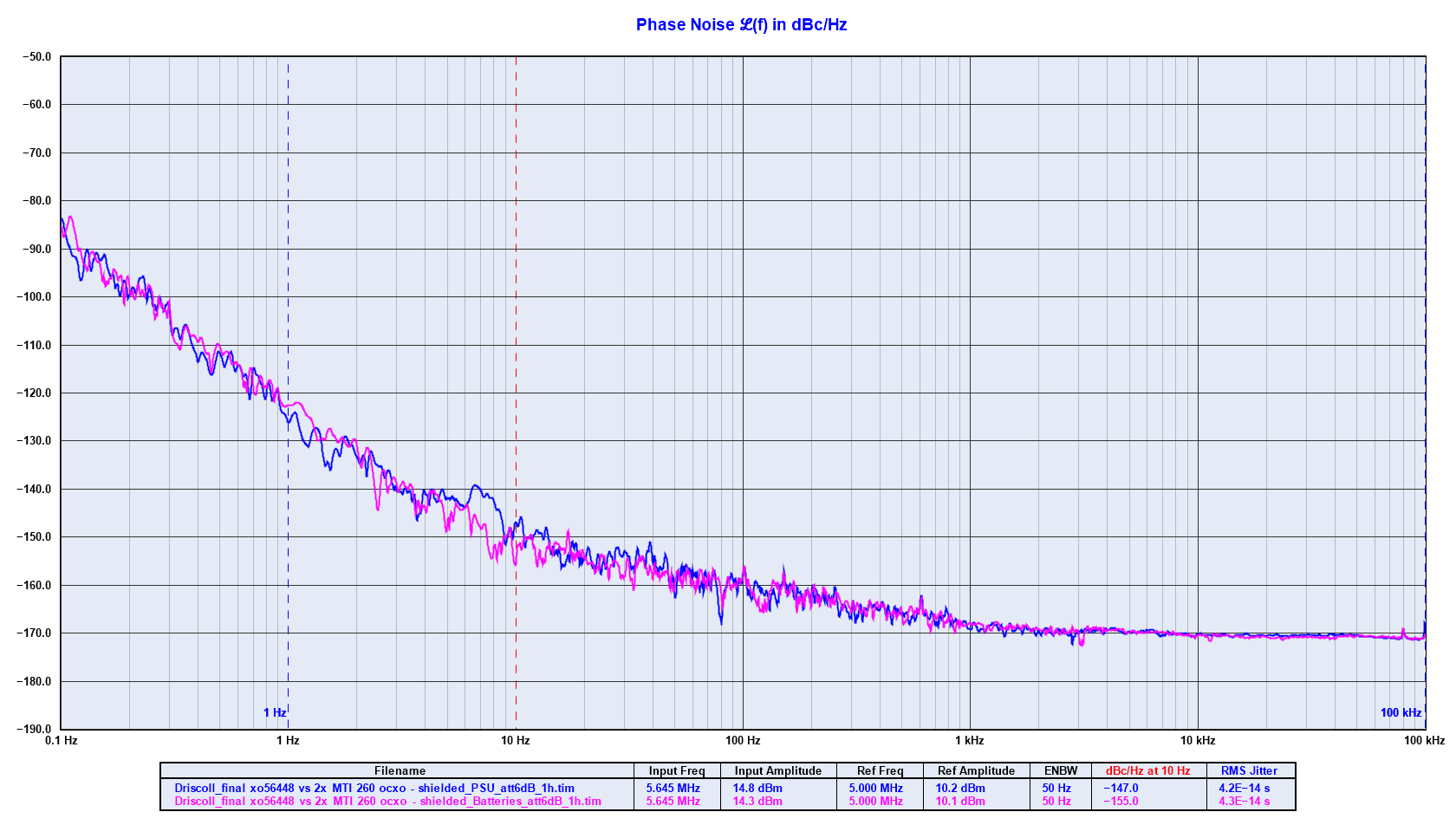

At 1,5 Hz, the non-battery is 7 dB better... to make sense these measurements maybe need some smoothing?
Smoothed plot, anyway you have to ideally smooth the traces, peaks can change between measurements, mostly in the close in region (1Hz).
There is a great literature on this at Rubiola.org

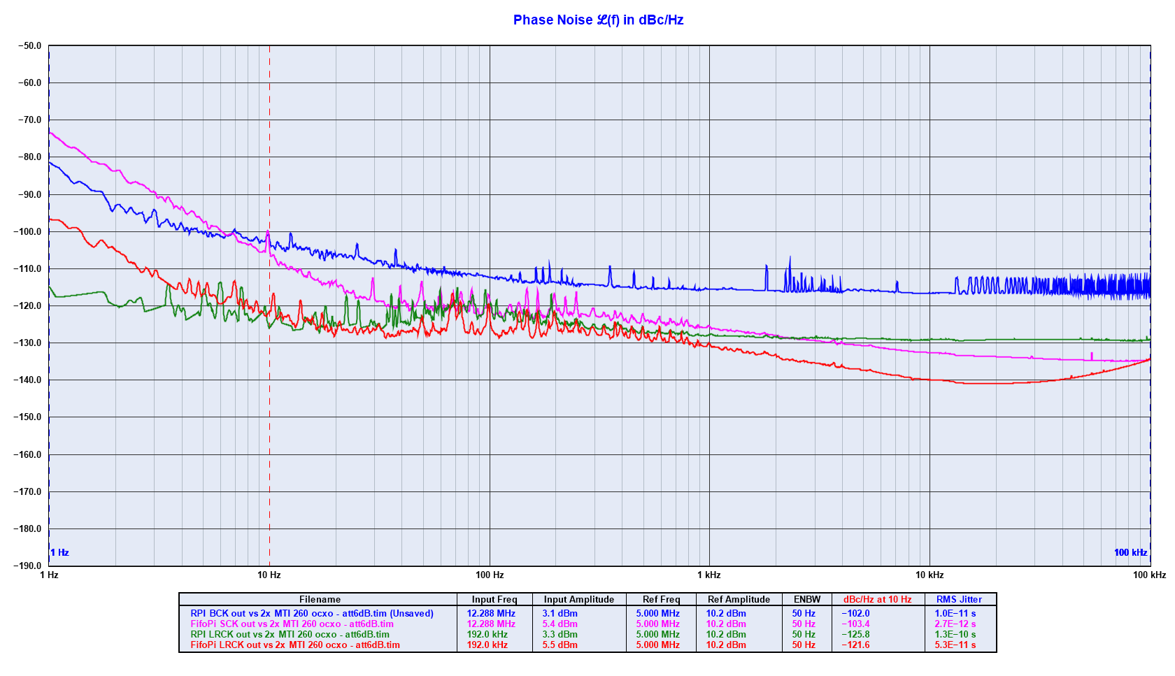

It looks like you have not understood, the Timepod integrates spurs when calculating the RMS jitter, so nothing is lost.
Simply the spurs are useless to understand jitter and phase noise, Gerhard has well explained the reasons.
Anyway, since you are so interested on the spurs I turn off the suppression and I attach the plot with spurs.
Now you see the power supply noise (100 Hz) and its harmonics, that are totally useless.

When performing Low frequency, high dynamic range Phase noise measurements - an oscilloscope is not a capable tool (they dont have the dynamic range, reference time-base stability, thermal stability or memory depth), where as the phase noise measurements systems such as the TimePod / E5052 etc. are designed for this very purpose...
Unlike earlier phase noise system, making PN measurements is child's play, and pretty much infallible... Knowing the TimePod, I suspect there's a good chance I'll confirm Andrea results, but whats more important is to understand the cause so I can get this information back to Ian.
