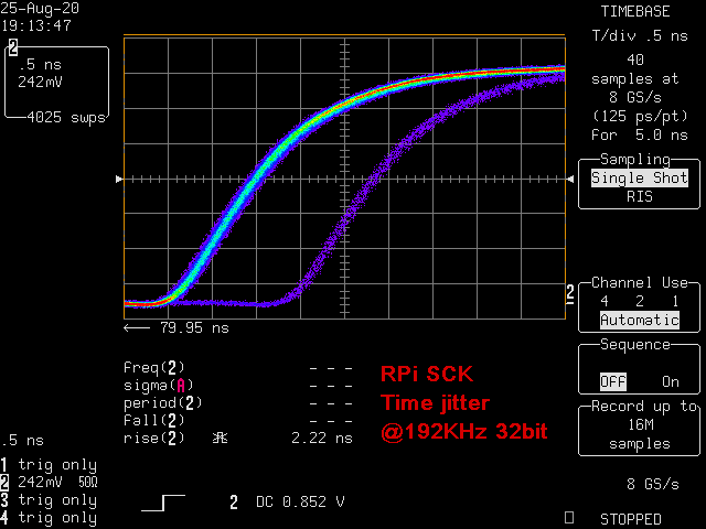

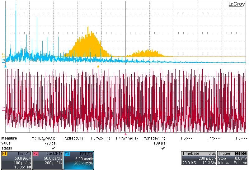

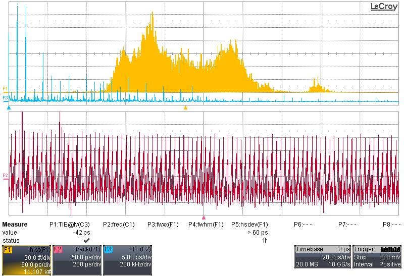

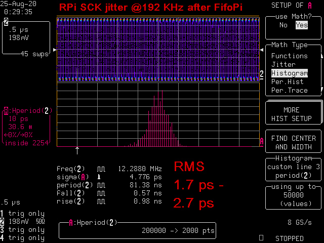

I have made a series of these tests years ago.
Here it is a bit for having the taste. Also what can be seen on a scope.
Yellow trace is the jitter distribution, like with Ian's test.
Red trace is the waveform of the jitter modulation signal, blue trace is FFT (~phase noise) plot of that trace.
Easily can be indentified the intruder frequencies, there distribution, intensity.
The two plots are my Rotel player SPDIF output, when in idle, and when playing.

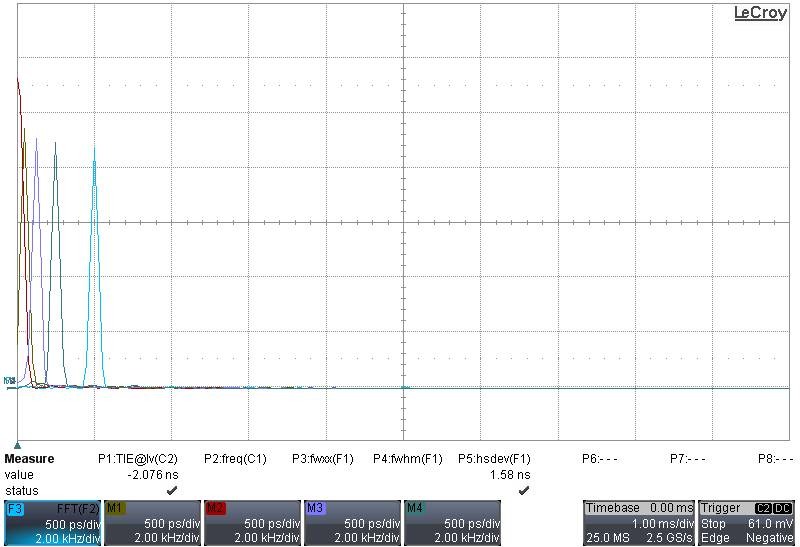

And here is the phase plot when I had been testing an artificially induced fix modulation frequency, sitting on a 10MHz carrier. Modulation frequencies were 100; 200;500; 2000 Hz
Yes, these are not SOTA results but also absloutely usable down to useful range. Noise pickups and gnd loop problems happen here, not at 1Hz

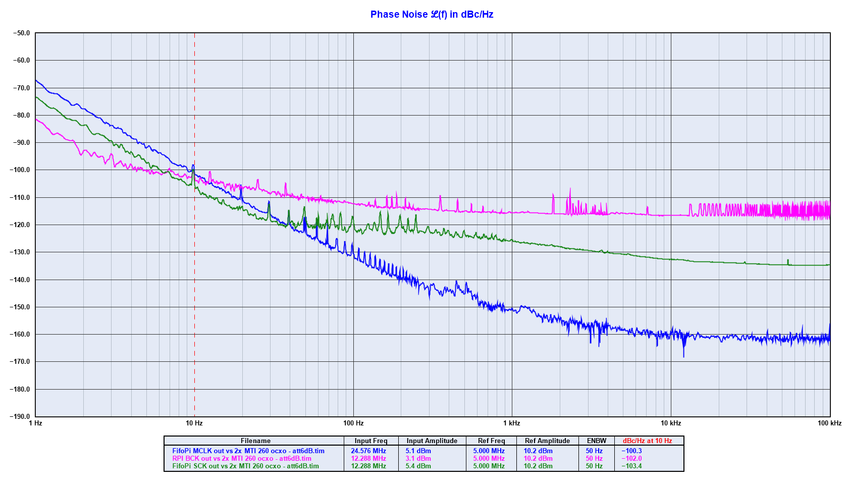

Yes. With respect to the raw Rpi spectra, the Fifopi had cleaned up what? 70? dB spurs at least.. That is much more coherent with Ian's scope shots.
If You would have.started like that, weeks ago, leaving the spurs on (and to be cleaned up by Fifopi) - then nobody, but me for sure would not had started to complain when You point out the problems that remain.
And if spur removal would be that easy, then why nobody can produce a clean jitter spectra, like in the ASR test? And those are not even pushing hard to show the fine details.. (that is doing those tests much more seriously)

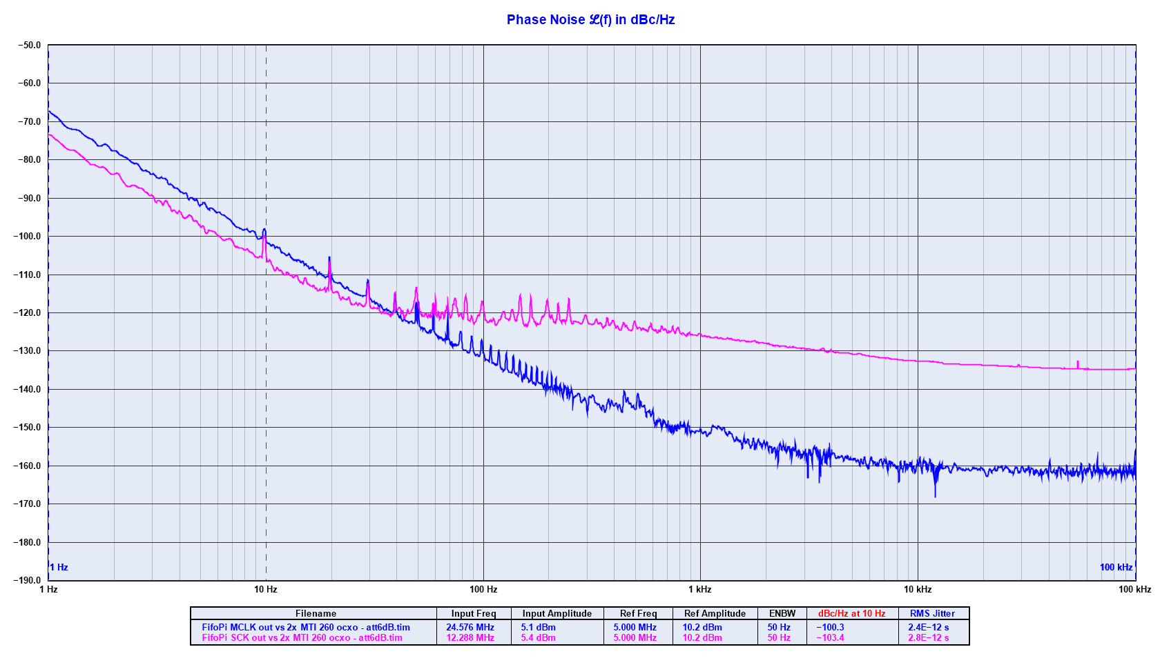

Well, let me drive along the way of "both".
I would assume that you can trust the Timepod SCK measurement since the calculated jitter is almost the same of the one calculated by the digital oscilloscope you trust, 2.7 vs 2.8 ps (picture 1 & 2).
The third picture is the same plot of the first one but using the Driscoll oscillator as the master clock.
Now a few considerations:
- the calculated jitter is almost identical to the one of the master clock (Crystek)
- although someone with high speed logic design experience disagree ("If you have high speed logic design experience, you should know that there is no ideal clock divider in the real world. All clock dividers have additive jitter. A good clock divider normally have a couple of ps of additional jitter. So, 6dB doesn't exist in the real world.") dividing the master clock you should get 6 dB better phase noise. Sometimes the real world confirms the theoretical laws, from 1 Hz to 10 Hz from the carrier the phase noise of the SCK (the master clock divided by 2) is effectively 6 dB better
- above 30 Hz from the carrier the phase noise of the SCK grows, 12 to 30 dB worse than the master clock
- moving to the Driscoll oscillator the calculated jitter decrease to 1.2 ps, but the master clock calculated jitter is 150 fs, one order of magnitude better
- we have lost the 6 dB improvement of the close in phase noise, at 10 Hz from the carrier the phase noise of the FifoPi is 9 dB worse
- above 10 Hz from the carrier the phase noise of the SCK grows, 10 to 30 dB worse than the master clock
Now a few simple questions I hope you would kindly reply:
- the calculated jitter is identical, can you trust the measurement?
- what does 3 ps jitter explains?
- is 3 ps of jitter the "ultimate" performance to be reached?
- why the close in phase noise improvement due to the division disappears with a low noise oscillator?
- why the phase noise grows above 10 Hz from the carrier?
Maybe the answers are the key to improve the performance of the device.

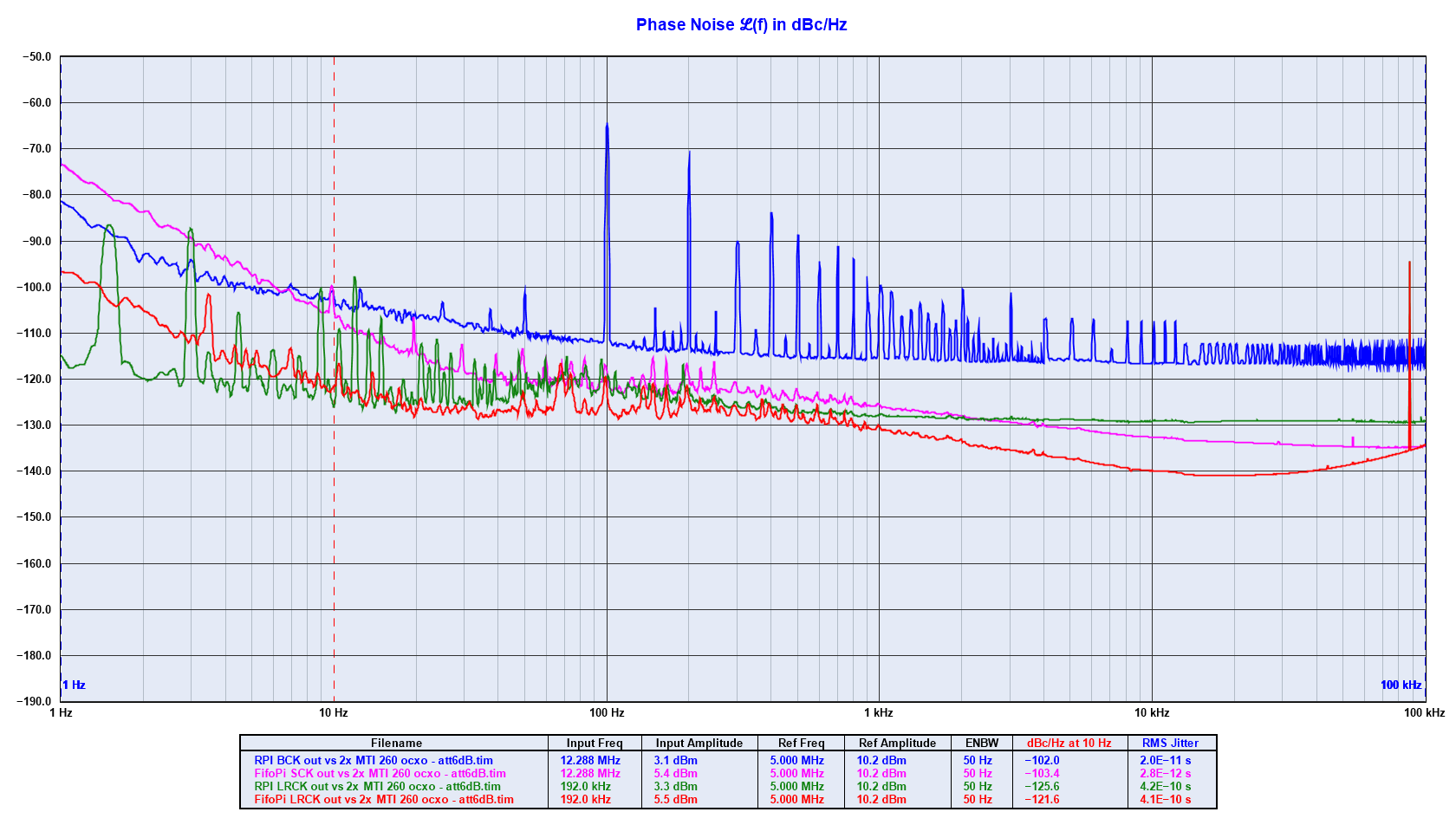

andrea_mori's PRi SCK phase noise plot still not correct
Seems you can make up the phase noise plot by enabling and disabling different suppression. Are you playing with the testing result?
I attached your two times posting RPi SCK phase noise plots. Such a big difference. However, I still can not see the spurs of deterministic jitter at the 1.3 ns in your second plot. (Please find the third picture the analog view of the RPi SCK time jitter to reference). Only 100Hz and orders spurs from the RPi power supply. Your testing result can not be convinced.
The possible problems could be:
1. The integration bandwidth was not enough. To see a bigger picture, normally it needs to be up to the half the carrier frequency.
2. With spurs included, the calculation of RMS phase jitter from the phase noise plot will be different. All spurs have to be integrated. The calculated RMS phase jitter number should much bigger than you did before.
Regards,Ian
It looks like you have not understood, the Timepod integrates spurs when calculating the RMS jitter, so nothing is lost.
Simply the spurs are useless to understand jitter and phase noise, Gerhard has well explained the reasons.
Anyway, since you are so interested on the spurs I turn off the suppression and I attach the plot with spurs.
Now you see the power supply noise (100 Hz) and its harmonics, that are totally useless.

We have all understood that your real time digital oscilloscope is the reference gear to measure the jitter, so keep out for a while the RPi measurement and focus to the FifoPi SCK and master clock (Crystek) measurements.
Your FifoPi operates in a different domain then we have to assume that it was not source dependent, so the source is not relevant in the investigation.
I attach again the phase noise plot of the FIfoPi SCK vs the master clock.

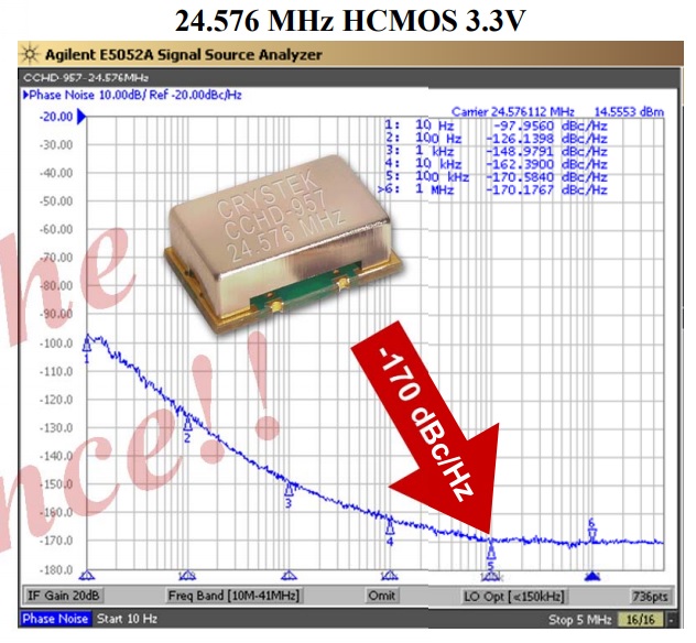

I also attach the phase noise plot of the Crystek CCHD-957 at 24.576 MHz, measured from the manufacturer using an Agilent E5052A (it uses cross correlation to measure the phase noise like the Timepod).
As you can see the phase noise plots are almost equal, the measurement from the Timepod is around 2 dB better against the E5052A. You should know that could be a difference from a crystal to another, mostly if we are talking about cheap crystal. Maybe we have got one of the best.
This means that the measurement from the Timepod is reliable, at least at 24.576 MHz.
Since the half frequency of the master clock (12.288 MHz) is still in the range of the Timepod we can assume the reliability of the FifoPi SCK phase noise measurement.
Now the jitter, as you can see the calculated jitter from the Timepod is almost the same from your digital oscilloscope, a little less than 3 ps.
We have to assume the reliability of the calculation.
A little disgression, take a look at this link Crystek CCHD-957 | H i F i D U I N O
They have calculated the jitter with a different integration bandwidth, so the Crystek is more than an order of magnitude better, 120 fs!
What a trick!
This says a lot about the usefulness of the jitter measurement.
But if you take a look at the phase jitter per segment you see that the major contribution is in the 10 Hz region (1 Hz is missing), so you can understand the possible weight of the 6 MHz from the carrier you are pointing out, null.
Back to the topic, I forward again a few simple questions, just in cause you would kindly answer:
- the phase noise measurements of the Crystek are almost identical (Timepod vs E5052A), can you trust the measurement?
- why the phase noise grows above 30 Hz from the carrier?
Please, let us know.
What a trick!

You still not answer:
1. Why was your phase noise testing result incorrect for the 11.2896 MHz RPi SCK signal?
2, Both your RPi and FifoPi 192KHz LRCK phase noise results were wrong, why?
I attached the three analog waveforms of the above signals. Just make it easier to understand.

Ian
SCK_RPi_192_Direct by Ian, on Flickr
LRCK_RPi_192_Direct by Ian, on Flickr
LRCKafterFifoPi192_Analog by Ian, on Flickr
