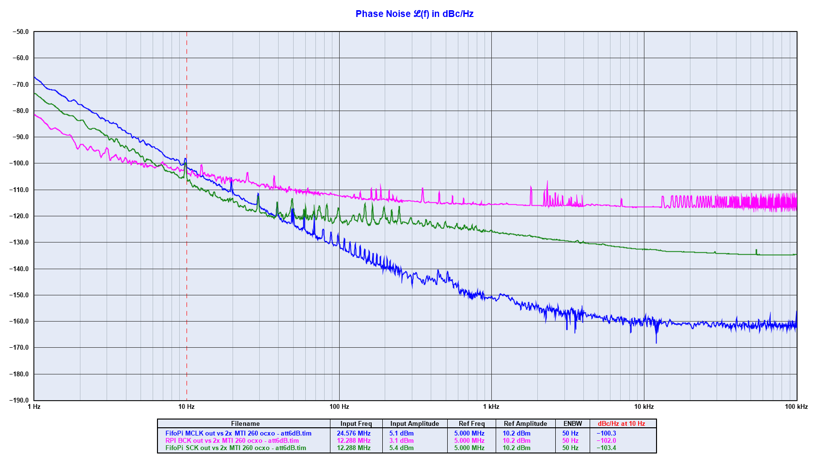

The strange thing is that in post #2535 I have published a pair of phase noise plots and asked a few questions, but no one answered.
And You did not answer at all to the point of Ian about those two SCK curves which would be supposed equal, instead are showing 10 / 20dB difference between them.
So before demanding answers, You should decide which of your's curves are valid..
Post #2536 ;

The RPi SCK plots in posts #2536 differs only about the spurs (disabled/enabled), the phase noise at 10 Hz from the carrier is identical (-102 dBc).
Even the FifoPi SCK plots in posts #2535 and #2536 are identical.
If you want I can send you the .tim files so you can load them in the Timelab and manage them as you want.
But I see you continue arguing about the RPi, avoiding to talk about the FifoPi.

Andrea!
You got the point! I had mixed up the curves!
Thank You.

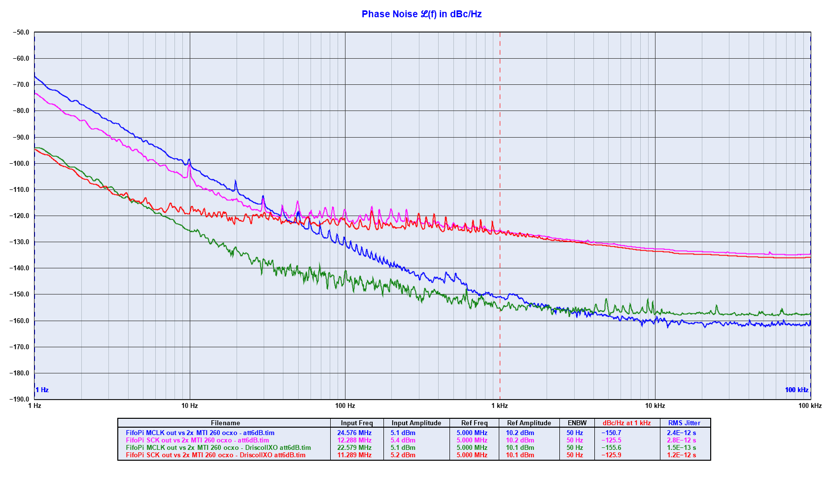

Andrea,
I wanted to say something similar to John, about your questions, plus that I don't feel OK to descend into remote debugging something I do not have at hand.
But would like to add: Your comparison 'chart', the FiFo SCK curves with two different clocks are indeed a nice help, and show that with a higher close-in phase noise oscillator the theory does work, the division by 2 do bring a - 6dB premium.
(So the FiFo is an adeguate solution to extract the best from the oscillators it is used with typically.)
With the better quality, Driscoll oscillator the inherent phase noise limit of the FiFo itself had been reached, and the result is not following the division rule any more.
So with these tests You mapped the FiFo's own phase noise contribution borders.
In the same time this limitation shows up as 'noise', noise floor modulation, not 'spurs' like it would be with deterministic contribution.
But signal feedtrough, what You are suspecting, even more, synchronous signal leakage is proper, typical deterministic jitter source.
So I think You search at the wrong part...
Noise floor could be more connected to power supply noise, device noise limitations..? Guessing.
Logic gates are 'defenseless' against PS noise, very low PSRR.

Maybe the limits of the FifoPi has been reached with the Crystek too.
Above 30-40 Hz from the carrier the phase noise overcomes the noise of both oscillators, at 1 KHz from the carrier there are 25 dB difference with the Crystek and 30 dB with the Driscoll.
So the question is: why the FifoPi sounds better with the old Driscoll oscillator against the Crystek?
The master of clock Pat Di Giacomo, as you probably know as Jocko Homo, pointed out the reason some time ago: the phase noise close to the carrier, 10 Hz and below, where our brain is more sensitive to the timing error.
As you can see from the plot, although the phase noise is similar above 30 Hz with both oscillators, there is a big difference in the close in noise, around 20 dB.
So I believe you can expect a further improvement with the new Driscoll at 5 MHz, because the close in phase noise will be around 25-30 dB better, although I don't think there will be an improvement above 30-40 Hz from the carrier.

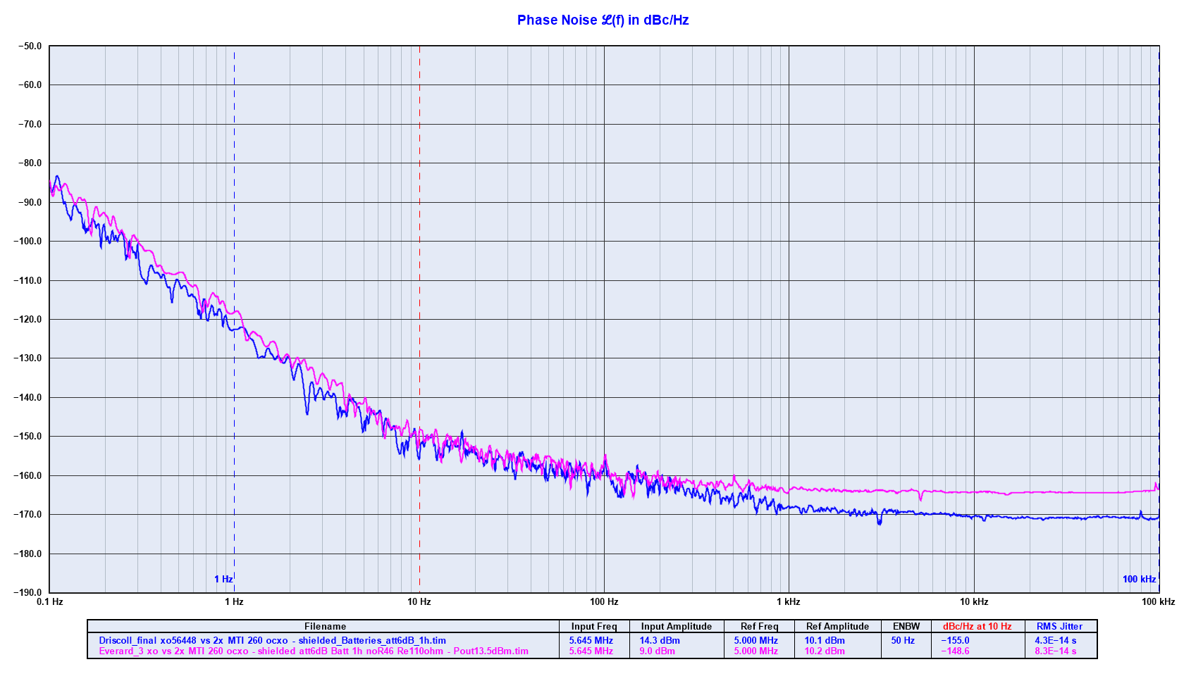

New Differential oscillator
The Differential oscillator is ready, I attach the phase noise plot with the crystal at 5.6448 MHz compared with the Driscoll.
The blue line is the new Driscoll while the pink line is the new Differential.
They are very similar, the Driscoll has 5-6 dB better noise floor, the close in phase noise is almost identical.
The noise floor difference is probably due to the different location of the crystal in the circuit, in the Driscoll the crystal is in the emitter circuit while in the Differential it's in the feedback loop.
Anyway they are both real very low noise oscillators, in the region of BVA and ULN.
