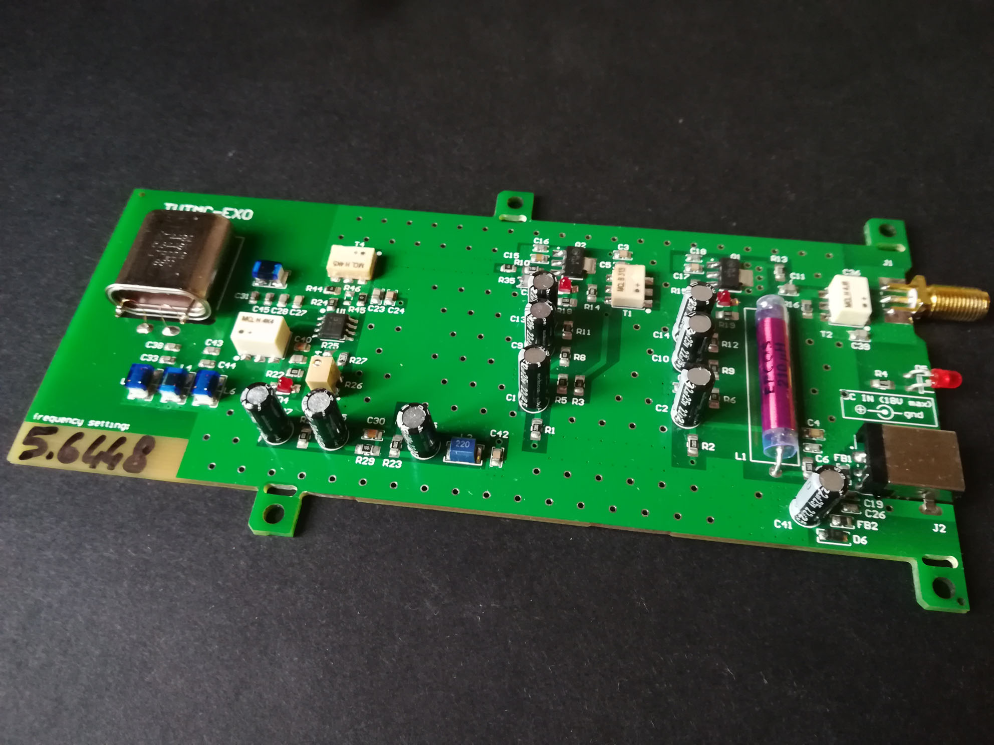

Can you share the dimensions of the new PCB's? I am curious if I can fit them into an existing chassis.A picture of the new Differential oscillator at 5.6448 MHz.
At some point before we have to commit to the GB, it will be great to see a comparison chart of the Differential vs other. Size, voltage, performance and BOM cost. Right now for me it would simply be a coin toss to decide which route to take. I am not even sure why you'd go to the trouble to offer both as they appear interchangeable. So maybe someone smarter than I can explain. thanks

PCB size is 75 x 151 mm, the box we have choosen is the Hammond 1455J601.
The comparison plot between the Differential and the Driscoll oscillators has been published in post #2580.
I will publish all the BOM soon, we are now testing the frequency doubler.
Both Differential and Driscoll oscillator need 12 to 18 VDC, batteries (suggested) or low noise linear regulator.
The cost has not yet been definitively decided because it will depend on the number of components we have to solder by hand (finished board), but we are thinking to offer a semi finished board, with the most parts assembled at a lower price (all the through hole and a few SMD parts to be assembled).
Soldering components by hand take long time and we have little free time to spend assembling the finished boards.
When we started building the new oscillator we had not idea about the best circuit to implement, so we have decided to develop a pair of devices, we don't knew what performance to expect from both.
Only after the measurements and several iterations of circuits and layouts we have discovered that they perform very similar.
