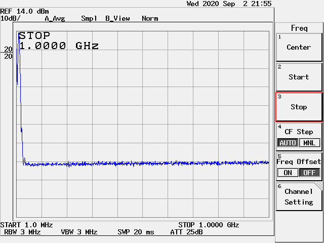

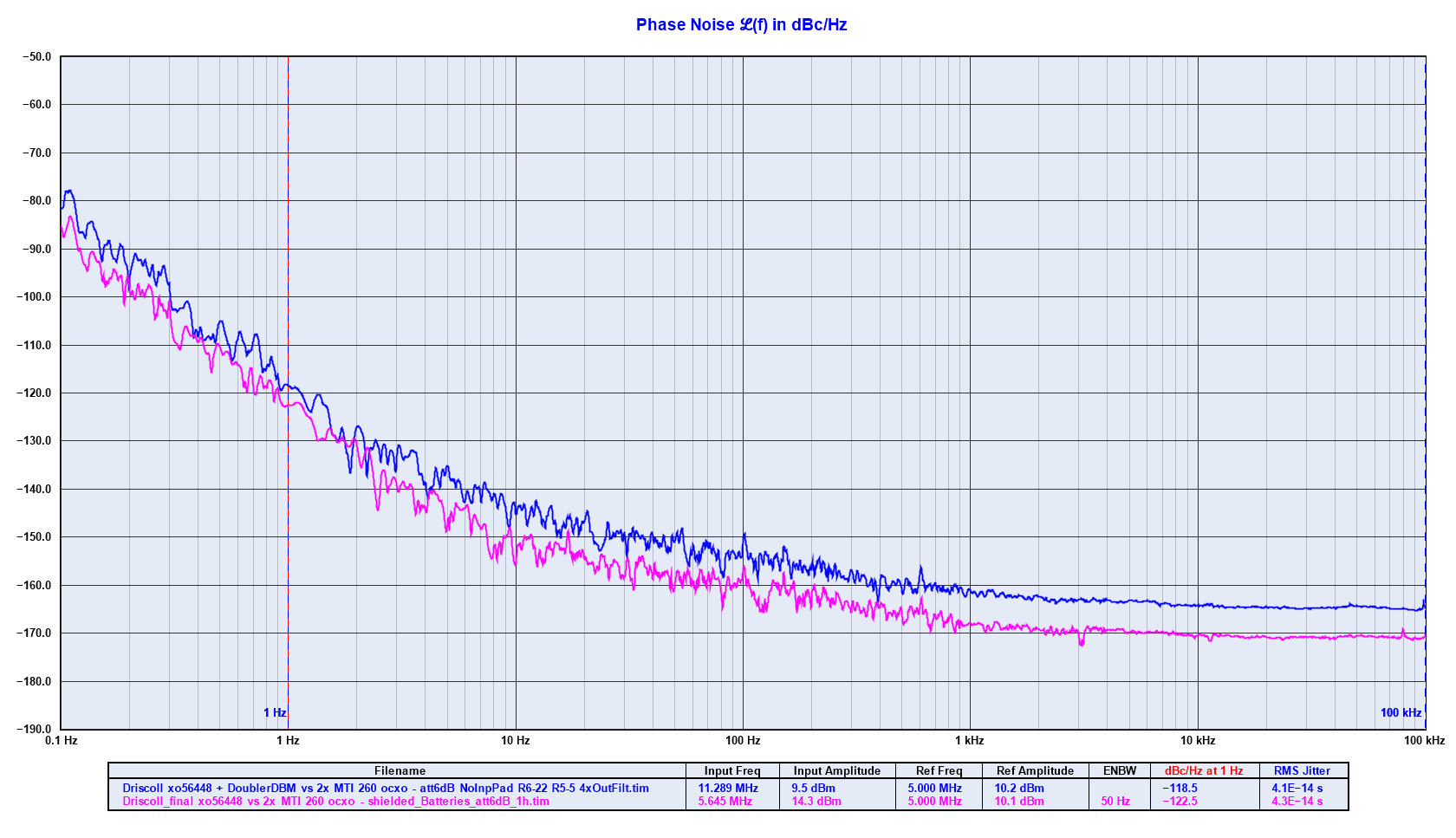

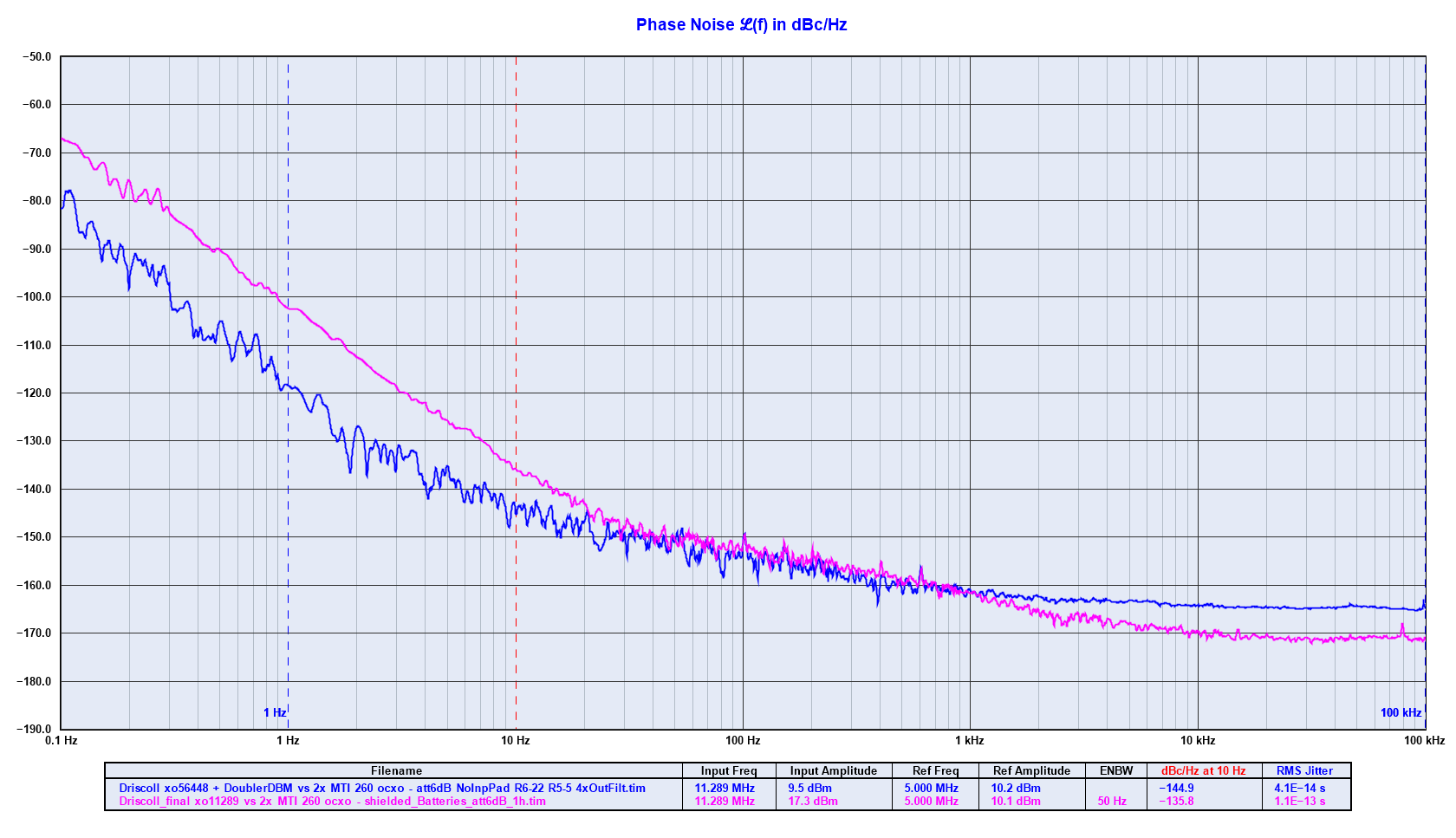

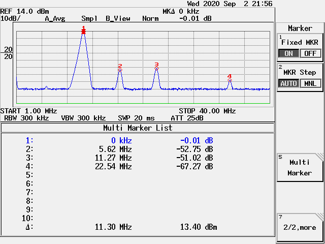

The frequency doubler is almost ready, I attach the first measurements.
The first plot is the comparison between the Driscoll with crystal at 11.2896 MHz (pink line) against the same Driscoll circuit with crystal at 5.6448 MHz followed by the frequency multiplier (blue line).
The close in phase noise of the oscillator followed by the doubler is far better than just the oscillator at the required frequency.
Only a higher nois floor due to the frequency multiplication.
The second plot is the comparison between the Driscoll at 5.6448 MHz (pink line) against the same oscillator followed by the frequency multiplier to get 11.2896 MHz (blue line).
One more time the real world confirm the theory: each time you multiply the frequency the phase noise increases by 6 dB. Even the 1/f 3 phase noise is better than the assumed theory.
The third and fourth pictures are the noise spectrum of the duplicated clock.
The harmonics are very low and there are no spurious up to 1 GHz.

Could you please help me understanding that number (in bold) by putting it into some context ? (Is it big enough to be important ? ... )

Theoretically every time you multiply the frequency you should get a phase noise around 6 dB worse than the basic oscillator and the phase noise plot of the doubler confirms the theory.
This allows to get better performance using the basic oscillator at lower frequency and then multiply it one or more times to achieve the required frequency.
For example, looking at the above plots, if you need 11.2896 MHz you get better phase noise performance multiplying the basic oscillator at 5.6448 MZ by 2 times rather than just using the oscillator at 11.2896 MHz.
However there is a limit to duplication because you loose around 3 dBm output for each multiplication.
The suggested limit is 2 times, so if you need 45.1584 MHz you should start from 11.2896 MHz and multiply by 4 (two cascade doubler).

Rather than the 6 dB difference between the base oscillator and the multiplied one you should look at the phase noise difference between the multiplied oscillator and the the one directly at the required frequency (the first plot).
The oscillator folllowed by the doubler has far better close in phase noise (10 to 20 dB), that's what we are looking in digital to analog conversion.
