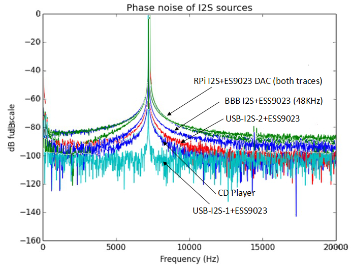

A further indication that something is wrong could be coming from this plot:
Coming from here: Sound quality limitations of Raspberry Pi + I2S DACs - DACs - Volumio
