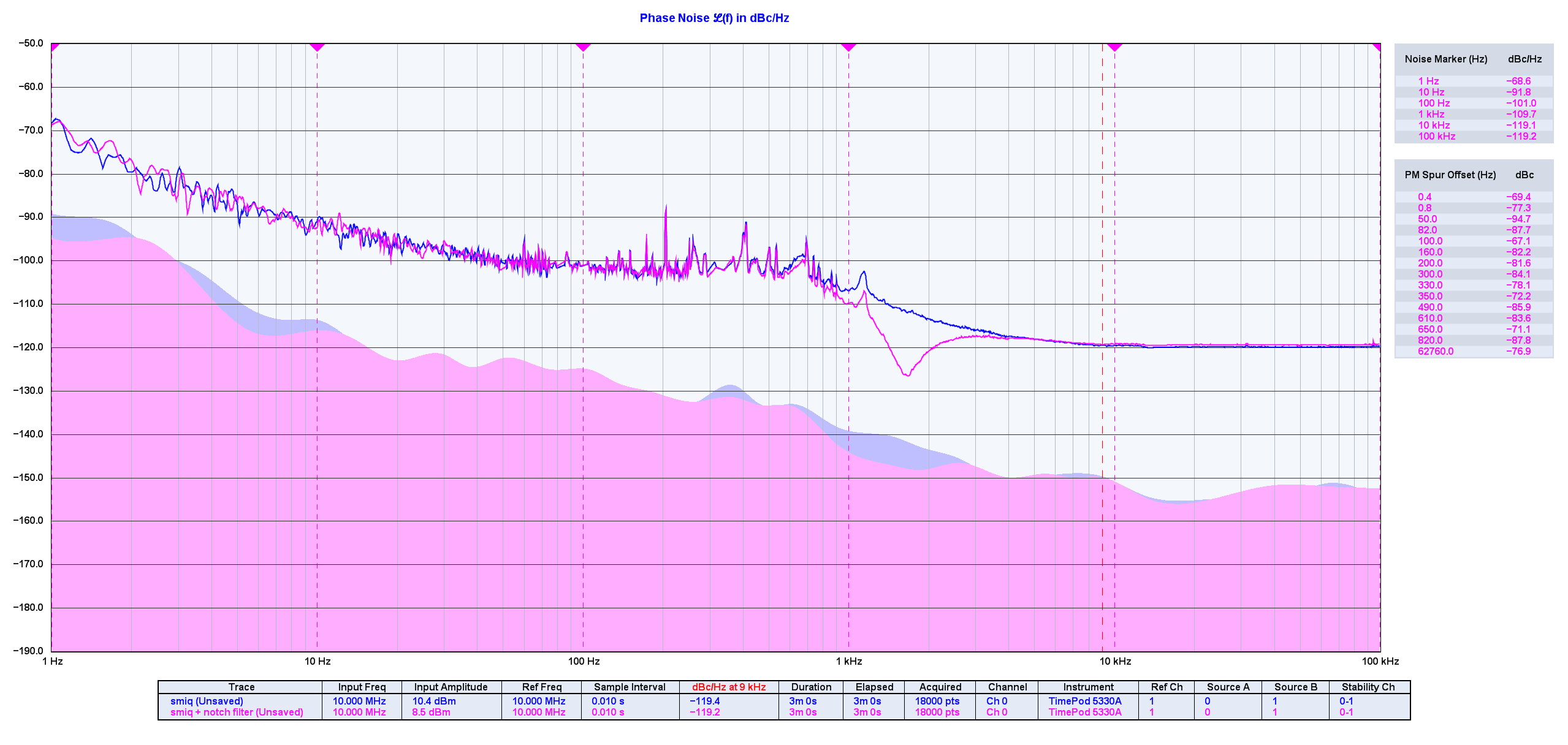

I also did some experiments with crystal notch filters, with a crystal pair
sucking out phase noise at, say +-5 KHz of the carrier. That can be done
at very high power levels without harming the crystals. Penny crystals
are good enough for that.
Yes, the SMIQ-4 signal generator is an easy victim, it is more
a modulation- than a phase noise wonder.

I attach a picture and the phase noise plots of the new Pierce All in One oscillator. The base frequencies are 5.6448 MHz and 6.144 MHz, then there are a couple of frequency doublers to provide 11.2896/22.5792 MHz or 12.288/24.576 MHz (output configurable).
The phase noise performance are very good for a AT-Cut crystal.

Theoretically every time you multiply the frequency you should get a phase noise around 6 dB worse than the basic oscillator and the phase noise plot of the doubler confirms the theory.
This allows to get better performance using the basic oscillator at lower frequency and then multiply it one or more times to achieve the required frequency.
I am confused about this.
(A) In the first sentence you are saying that frequency doubling results in 6 dB worse phase noise.
(B) In the second sentence you are saying that the frequency doubling gives better perfomance.
(A) and (B) seem to contradict each other. What's going on here?

Yes, the new Pierce TWTMC-PXO-AIO has two doublers on board, so you can configure the output for 2x or 4x.
As Thom said to configure the output to 2x or 4x you have to solder a few smd 0R resistors (2 for 22/24 MHz or 1 for 11/12 MHz).
You cannot change the frequencies of the base oscillator, they are fixed 5.6448 or 6.144 MHz, so the outputs are 11/12 (x2) and 22/24 (x4). Of course it's possible to use similar crystal frequencies like 6 or 6.25 Mhz.
To clarify the relation between the duplication and the phase noise performance: theoretically every time the frequency is duplicated the phase noise will be 6db worse.
The plots I have published confirm the theory, although the close in phase noise (around 1 Hz from the carrier) is a little better than the theory.

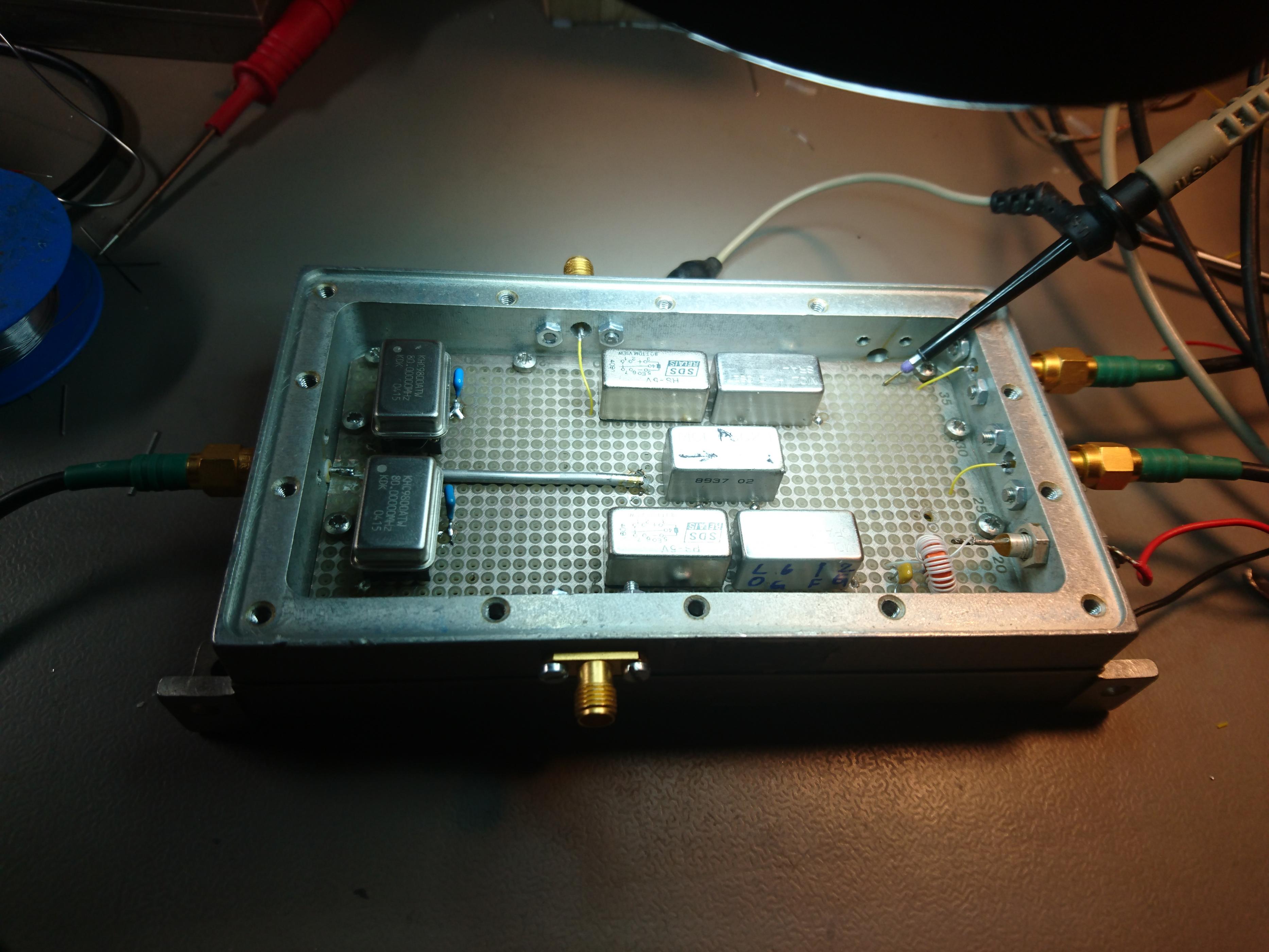

I'm just working on my cross-correlating frequency extender for the Timepod.
Seems to work as fas as I can say with the scope.
If supplied with 5V, it has two independent 80 MHz oscillators and 2 mixers
that convert either 50...80 or 80...110 MHz to 0...30 MHz for the Timepod.
Without 5V supply, it mixes everything below 400 MHz to the Timepod range,
but you must have 2 external frequency synthesizers.
It uses MCL SRA-1 mixers, a PSC2-1 power splitter, SDS reed relays to switch
between internal/external oscillators , and 2 80 MHz crystal oscillators.
Surprisingly they can drive the ring mixers directly, but then these need only 7 dBm.
I had to use parts that are in the junk box.

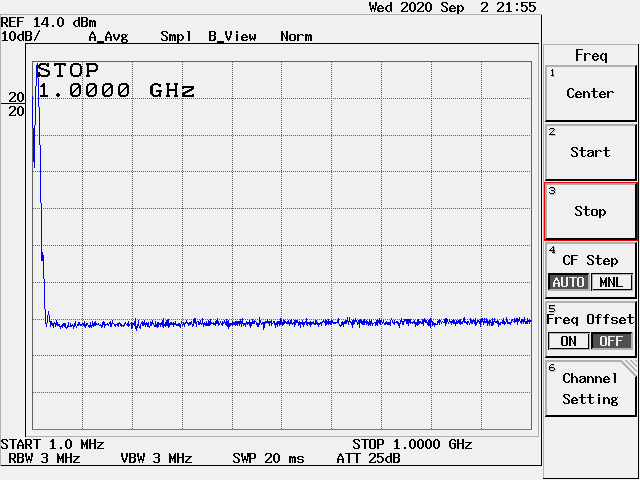

With the doubler the close in phase noise is already very close to the reference oscillator (3-4 dB worse).
IMHO the PLL is not a clean solution, I think it adds more close in noise than the doubler.
And a noise floor around -164dBc is not so bad when the reference is -170dBc.
@MarcelvdG
And where are the subharmonics?
Right there in your second picture, unless I misinterpret your second picture. About -80 dBc at half the output frequency and -52.75 dBc at 3/2 times the output frequency (which would mix with the first alias of the sigma-delta idle tone).
At 3/2 times the output frequency is -52.75 -13.4 so the result is -66.15 dB.
And at 6MHz from the carrier do you think -66 dB is high?
BTW you can add more output filter to mitigate the harmonics, we have used a pair of them here, but you could use 5 or 6 of them, althoug I think it will be a waste.
You are using relative markers, the first is 0KHz 0db, so it is what Marcel says, the sub-harmonic component is -52.75dBc.
With respect to 0dBm, that is - 39. 35dBm, but I don't see why would that count..
I do, and I also think the level with respect to the carrier is what matters, which is -52.75 dB if I understand the picture. When I have the time I'll run a simulation to demonstrate the effect on an ideal continuous-time single-bit sigma-delta DAC.
But I would be much more worry about the close in noise, that's affects heavily the sonic result, at least many member have reported so with any type of DAC.
I wouldn't; it just produces sidebands right next to the desired signal that should be masked quite well. Of course it doesn't hurt to minimize such artefacts rather than to discuss if they are audible.
