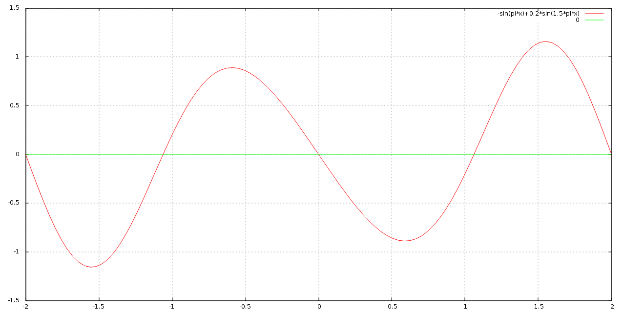

Imagine you are a slicer and you are confronted with the attached waveform (which has a grossly exaggerated component at 1.5 times the frequency to make the picture clearer). How are you going to turn that into a square wave where the rising edges are nicely equidistant?

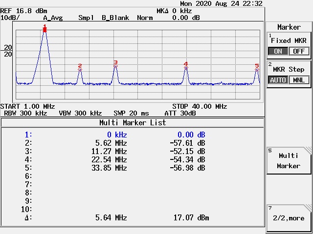

Well, it's no so, -60dBm means a power of 1000 times lower then the carrier and this means that the squarer neglects the harmonics.
The sine to square converter is not a linear device, it simply switches from 0 to 1 and from 1 to 0 at a certain voltage treshold, so it will switch at 22MHz not at 28MHz.
I have already said that a pure sine wave oscillator like the Driscoll has the second harmonics at 60 dB, so you are claiming that an oscillator capable to drive a sigma-delta DAC does not exists in the real world, that's obviously not true.

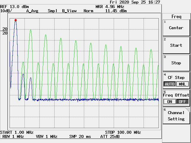

Moreover, take a look at a 5MHz CMOS output clock spectrum, as you see the harmonics are much greater than the sub-harmonics of the doubler.
Then in your opinion a CMOS output oscillator is not capable to clock correctly a sigma-delta DAC, I don't believe.
And this is a SOTA oscillators, phase noise plot and harmonics spectume analysis.
Not much difference against the duplicated one.
So a SOTA oscillator (you can take a Wenzel or a Oscilloquartz if you want) is not capable to clock a sigma-delta DAC?

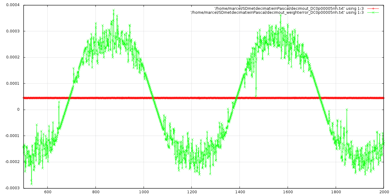

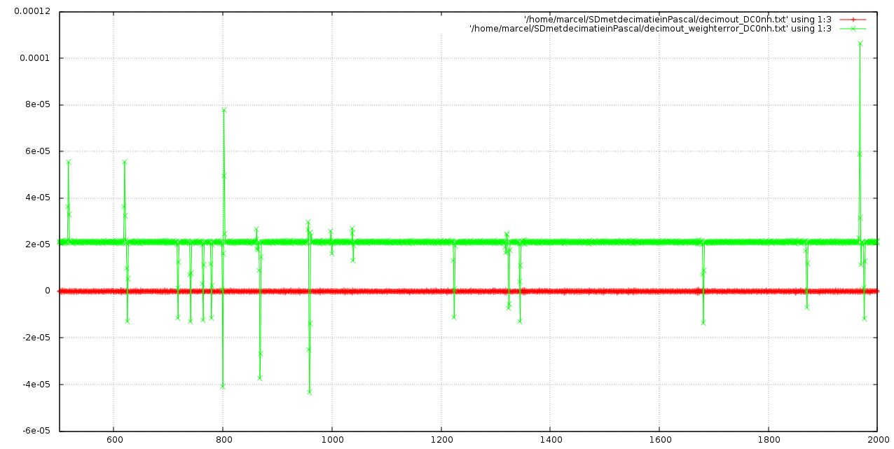

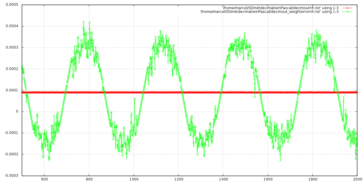

Getting back to the sliced sum of a sine wave at the desired frequency and a small one at 1.5 times the desired frequency: when you write out the equations, you will find that with the worst possible phase relations, the time between two rising zero crossings is 1 +/- arcsin(beta)/pi times the ideal period time, where beta is the ratio of the amplitude of the spur at 1.5 times the desired frequency to the amplitude of the desired sine wave. In the best case, the rising zero crossings don't shift at all because the sine wave at 1.5 times the desired frequency happens to cross zero at the same timepoints as the desired sine wave; in fact you can see this happening for the falling zero crossings in the first figure. You will usually end up somewhere between these extremes.
After slicing, you get a square wave with, in the worst case and counting from rising edge to rising edge, alternating clock cycles of 1 + arcsin(beta)/pi and 1 - arcsin(beta)/pi times the ideal length. For a -52.75 dBc spur, beta is 0.002304092976 and the periods are 733.4162219 ppm too long and 733.4162219 ppm too short. This is the worst case, let's assume +/- 500 ppm for the typical case.
When you have a single-bit continuous-time non-return-to-zero sigma-delta DAC (such as the noDAC from this forum, The Best DAC is no DAC ) or a two-tap return-to-zero FIRDAC (such as the valve DAC, Valve DAC from Linear Audio volume 13 ), the bit weight is proportional to the period time. Therefore, alternating 500 ppm too long and 500 ppm too short clock periods lead to 500 ppm too large and 500 ppm too small bit weights.
This bit weight that gets modulated with half the clock frequency can mix down the idle tones around fs/2 that straightforward sigma-delta modulators have. Without any signal or offset, the idle tone is exactly at fs/2 and mixing it down just causes some offset. With a small signal or offset, the idle tone shifts from fs/2 and mixing it down can cause a tone in the audio band. In fact, as the desired signal modulates the idle tone, you get a complete FM modulate added to the signal.
To demonstrate this, I have simulated a sixth-order slightly chaotic sigma-delta modulator and a low-pass filter with and without alternating +/- 500 ppm bit weight errors and with 0, 0.00005 and 0.0001 at the input. The Pascal program used for the simulation is attached, as are the results. The red traces are without and the green traces with weight errors. From left to right: 0 input, 0.00005 DC in and 0.0001 DC in. The x-axes are in samples after decimation by a factor of 64 and the y-axes are in arbitrary units, the largest signal that can be handled without overload is somewhere between 0.5 and 1 and the level used for the largest signal peaks would typically be 0.5. Hence, the mixed down idle tones are about 66 dB below the largest signal.
Mind you, the sigma-delta modulator and DAC type I have assumed are almost worst case for sensitivity to clock subharmonics at odd multiples of fs/2 (almost, because a sigma-delta without chaos or dithering would be even worse). A switched capacitor DAC or a FIRDAC with a notch at fs/2 would be less sensitive. For my own valve DAC, I use a sigma-delta algorithm with an embedded pulse width modulator with randomly rotated patterns, I expect that subharmonics will only cause some noise floor increase with that.
The multibit DACs that Andrea prefers shouldn't have any issue with a bit of second subharmonic. It's just a matter of choosing the right clock generation for the application.
