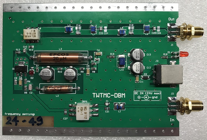

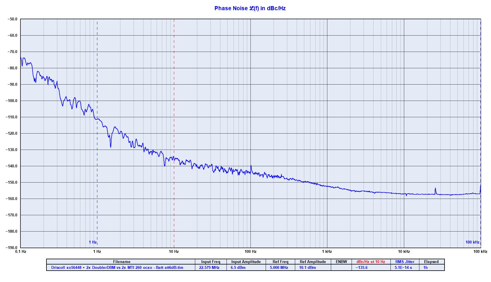

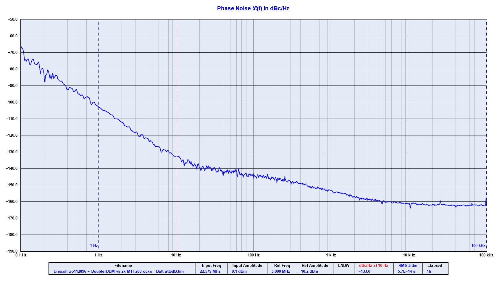

TWTMC-DBM Frequency doubler
I attach a picture of the new frequency doubler and a pair of phase noise plots (5 to 22 MHz and 11 to 22 MHz).
Adding a pair of doublers to the 11.2896 MHz oscillators you can expect around -127 dBc at 10 Hz from the carrier for a 45.1584 MHz oscillator, that's an exceptional result at such this frequency.

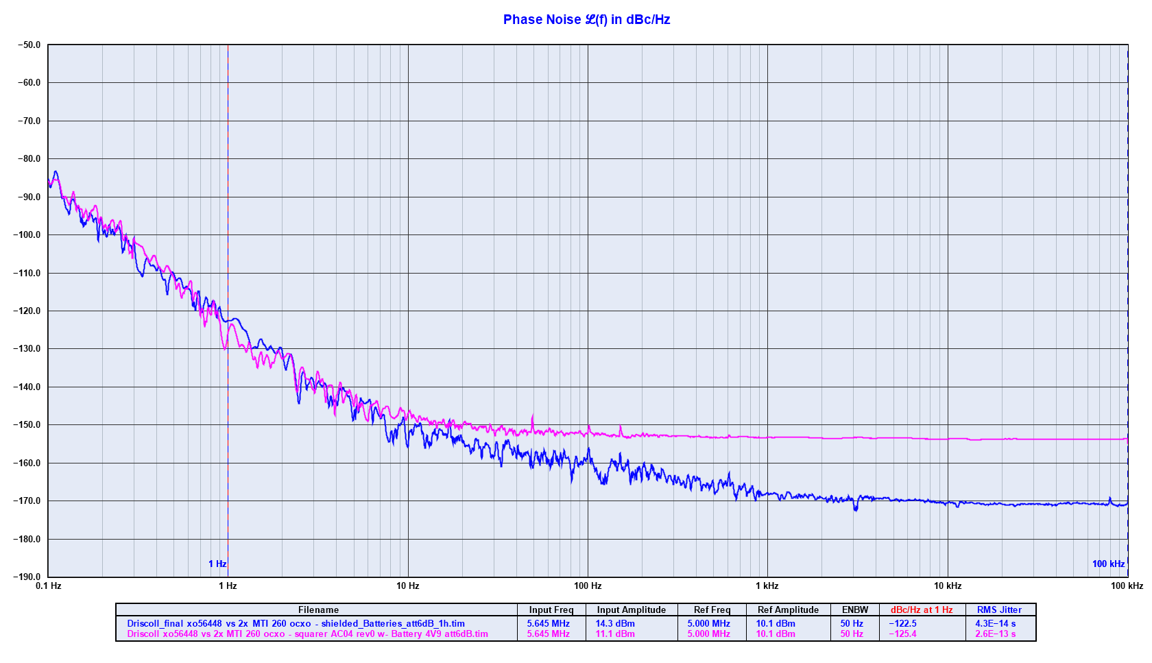

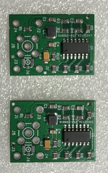

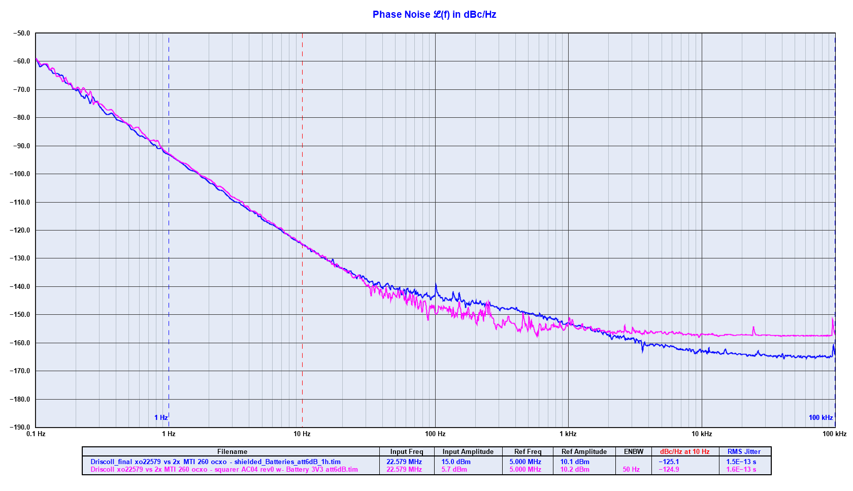

TWTMC-STS Sine to square converters
I attach a picture of the Sine to square converter (SX and DX to fit Ian's FIFO) and a pair of phase noise plots (22.5792 MHz and 5.6448 MHz).
The close in phase noise at the output of the squarer is the same of the base sine wave oscillators, only a little higher noise floor due to the noise added by the gates.

Your reasoning is wrong, the sine to square converter does not increase the close in phase noise, as you can see in the plot the sine wave output 22 MHz oscillator has -125.1 dBc at 10 Hz from the carrier, while after the squarer is -124.9 dBc, so exactly the same.
You are wrong because you are looking at the base 22MHz oscillator, but if you look at the phase noise plot of the base 11MHz oscillator followed by one frequency doubler (so 22 MHz at the output) you can see -133dBc at 1 Hz from the carrier.
Then add the theoretically 6dB for one more frequency doubler and you finally get exactly -127dBc at 10 Hz from the carrier with 45.1584MHz output.
The sine to square converter only increase the noise floor but not the close in phase noise of the sine wave oscillator.

Might I ask (only for educational purpose) what the frequency mixer on “TWTMC DBM” is for?
