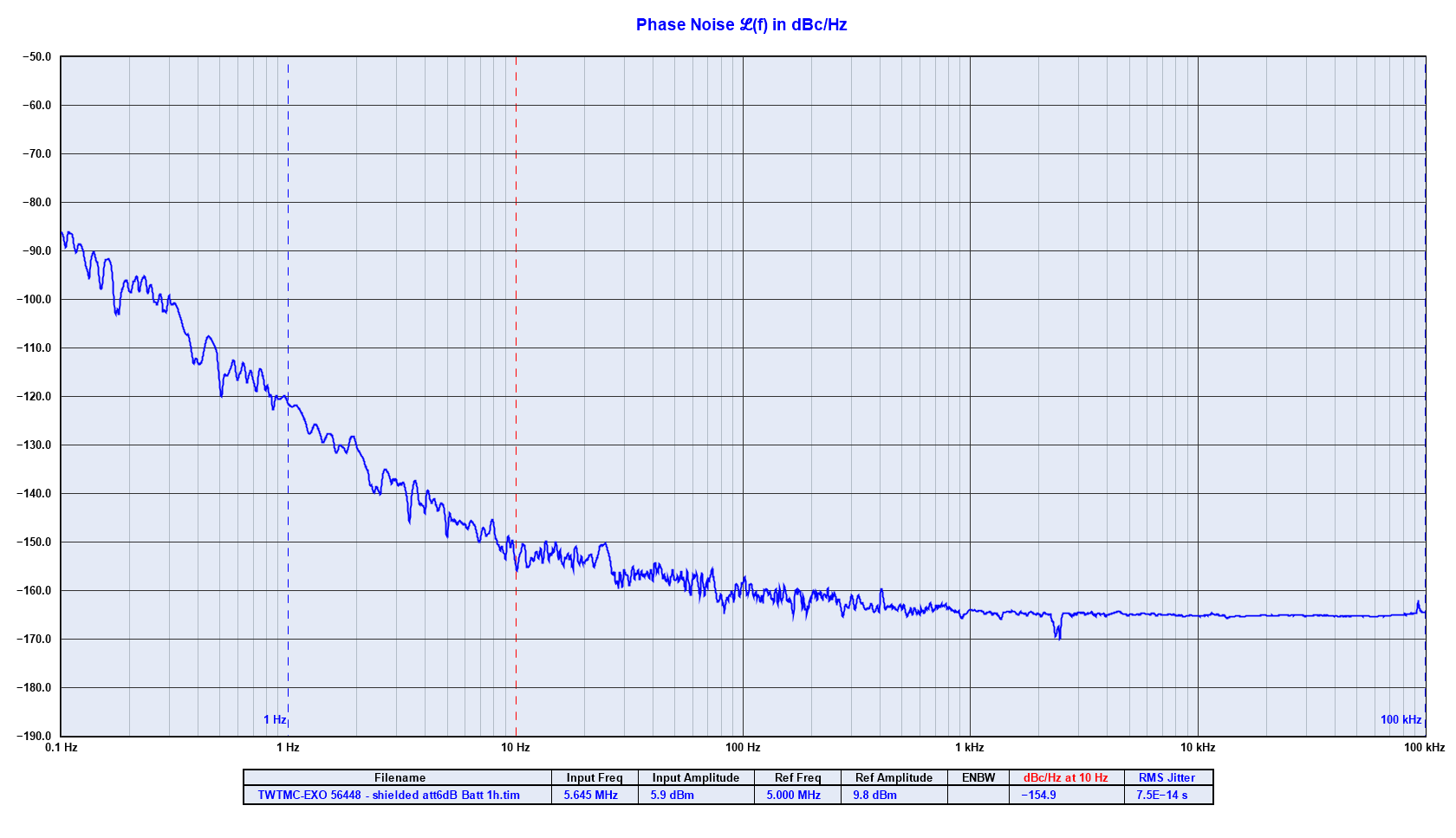

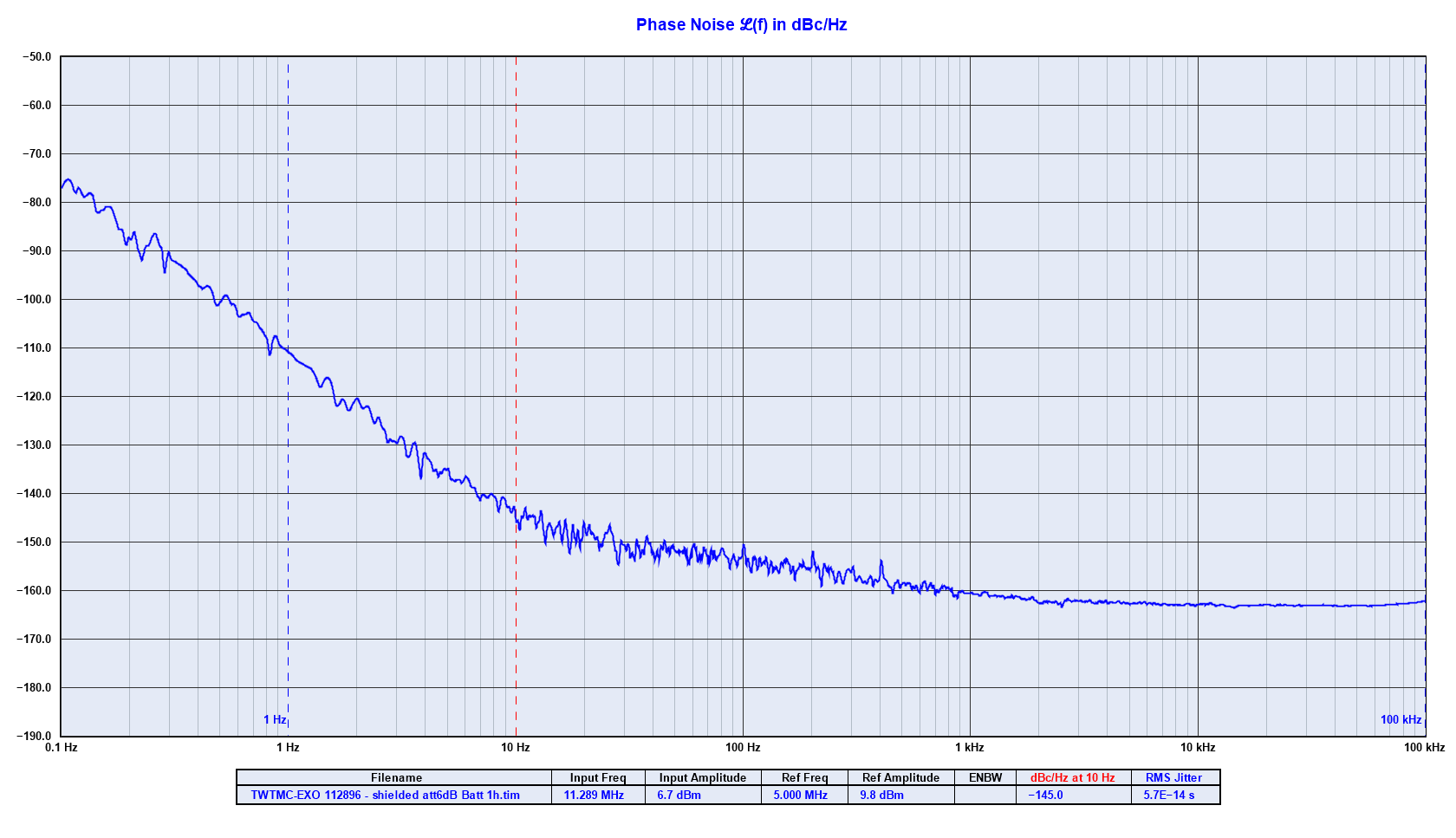

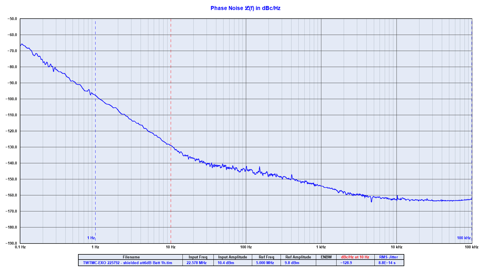

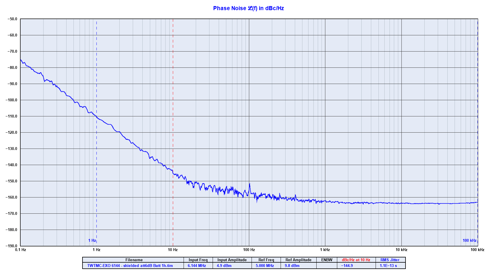

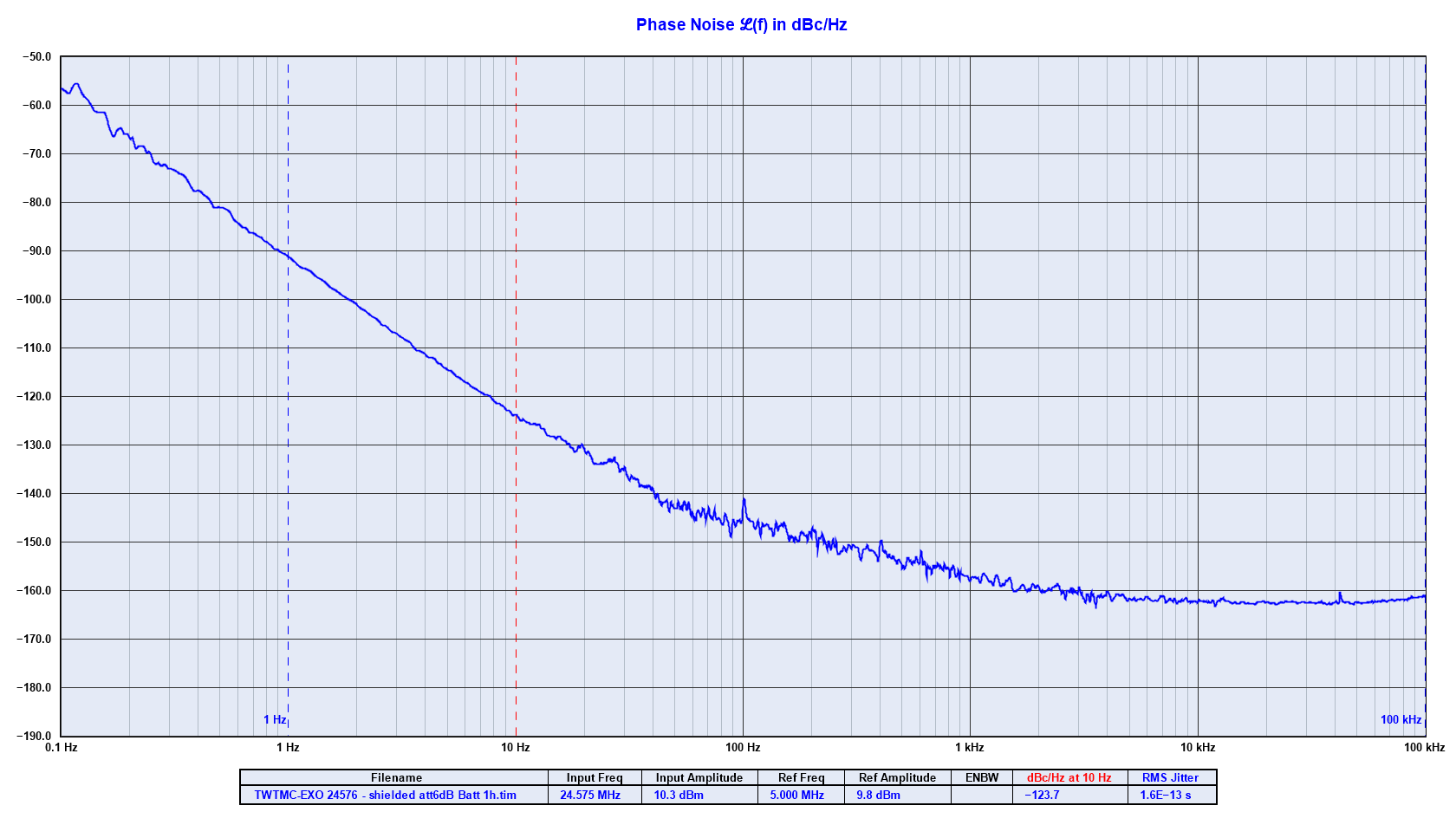

After a little tweaking these are the phase noise plots of the Differential oscillator TWTMC-EXO at all frequencies (except for the 12.288 MHz, crystal not yet available).

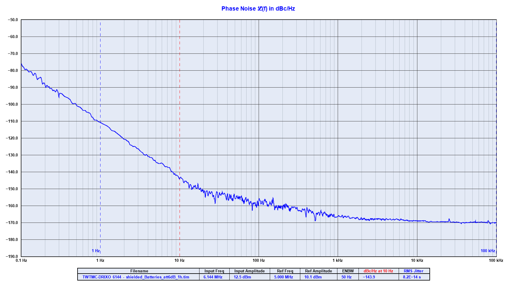

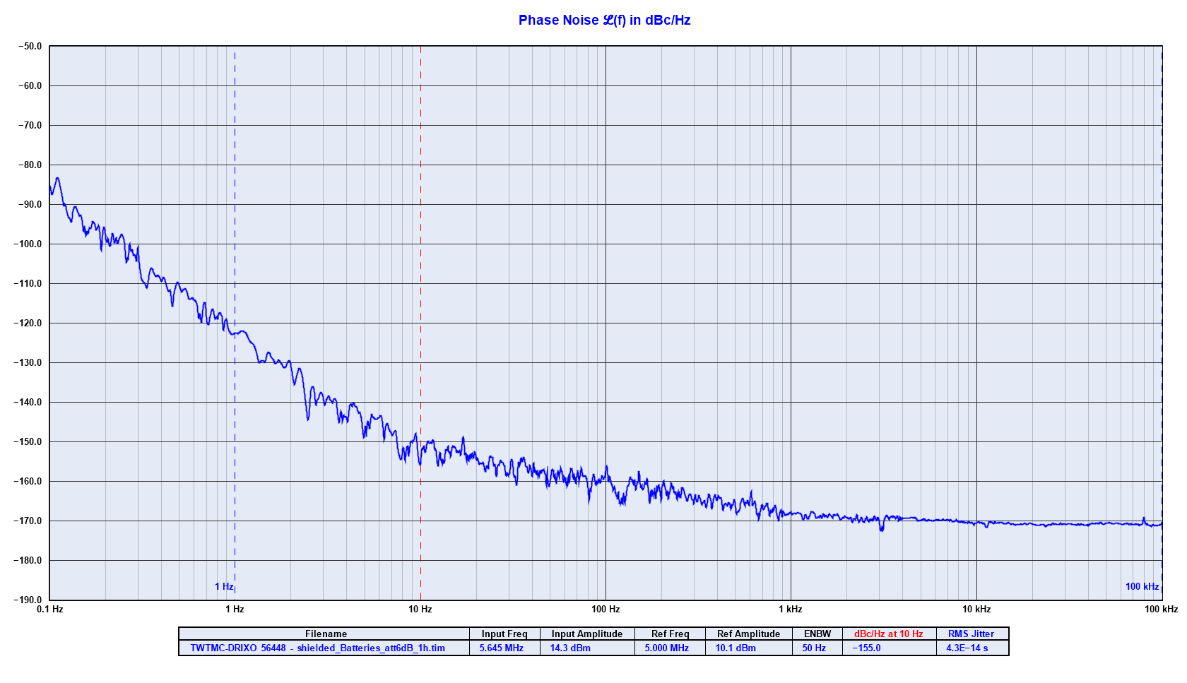

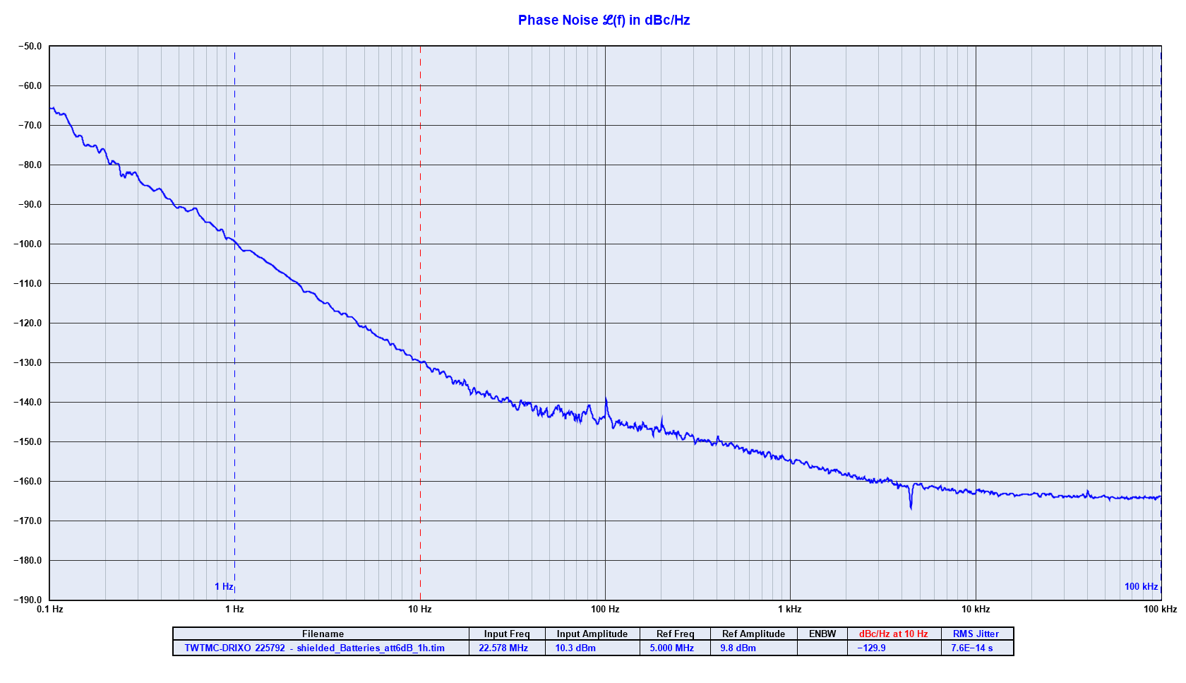

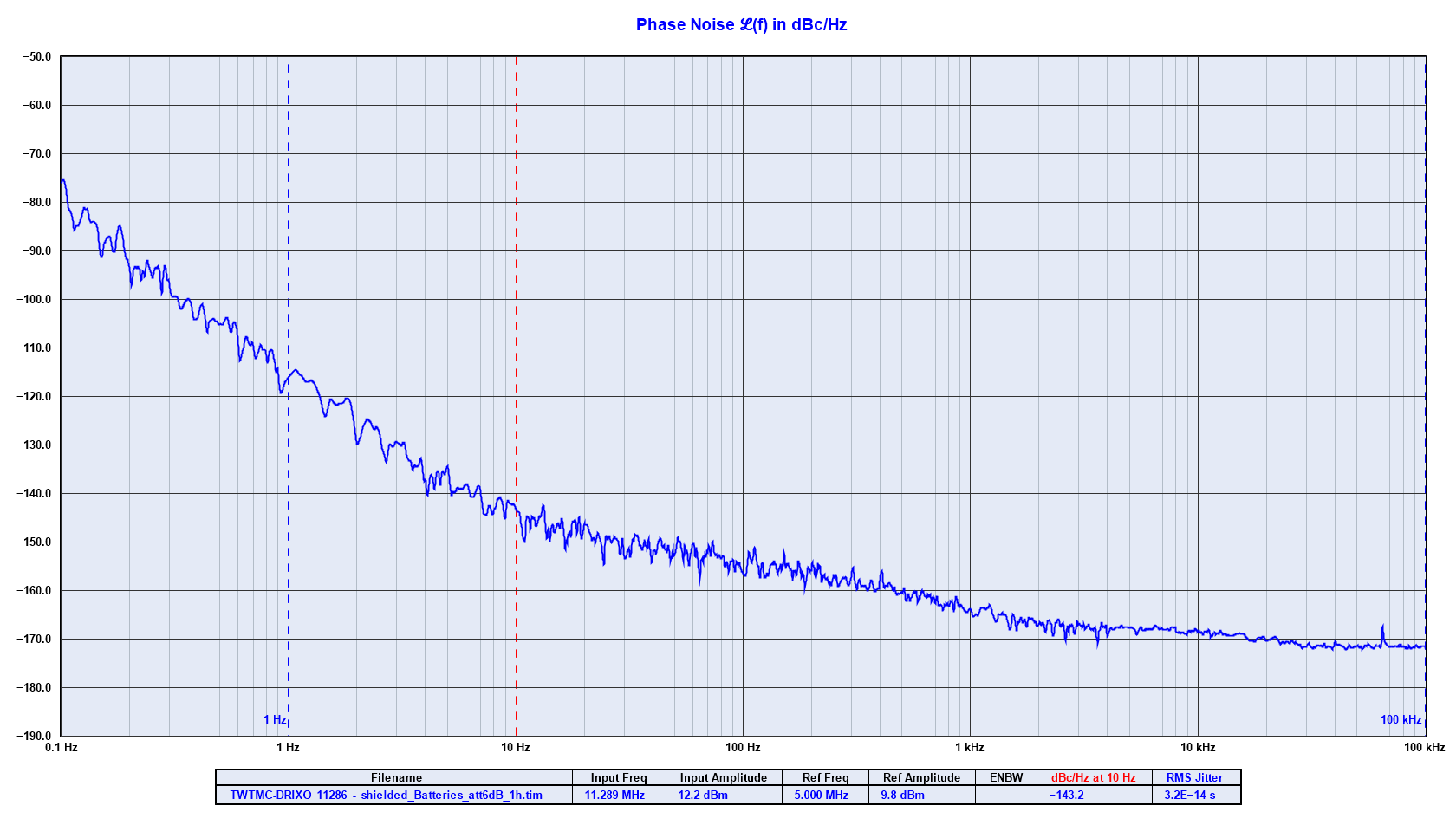

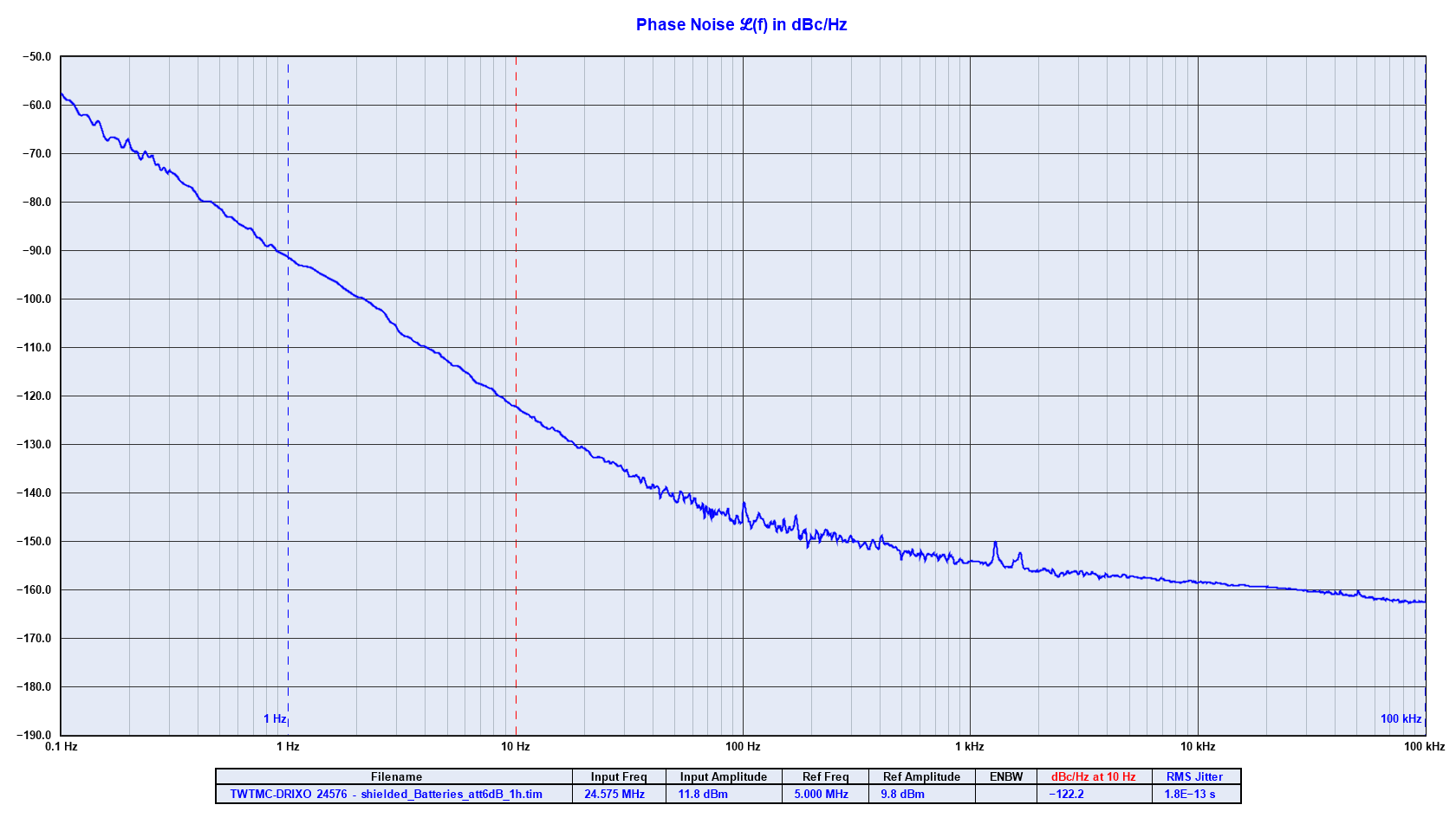

And the phase noise plots of the New Driscoll oscillators TWTMC-DRIXO.
These are great numbers.
To my eye, no appreciable difference between the two circuits on close in numbers meaning we can choose based on cost and implementation convenience.
Same crystals, same performance, same cost, same size, the only difference is the little higher output level of the DRIXO.
From pictures from memory, it appeared one of them had a larger BOM which could impact to a small degree the parts cost and effort to solder SMT.
Granted insignificant in the full picture.

Hello Andrea, Hope you're doing well.
These results are truly remarkable, specially the 11.2896 MHz oscillator. I haven't seen anything quite like it.
BTW: What do you mean by "a little tweaking"?
Best regards:
Alex

Hi Alex,
I meant fine tuning of the drive level of each crystal (single frequency) and a little update of the LC tank used in the Differential oscillator.
The Differential oscillator is single ended output like the Driscoll, I named it differential because it uses the active device in differential configuration with the crystal in the feedback loop.
Sorry but differential output is not planned.
You could use a RF transformer to convert single ended to differential.
Just a curiosity, why you need differential output?
