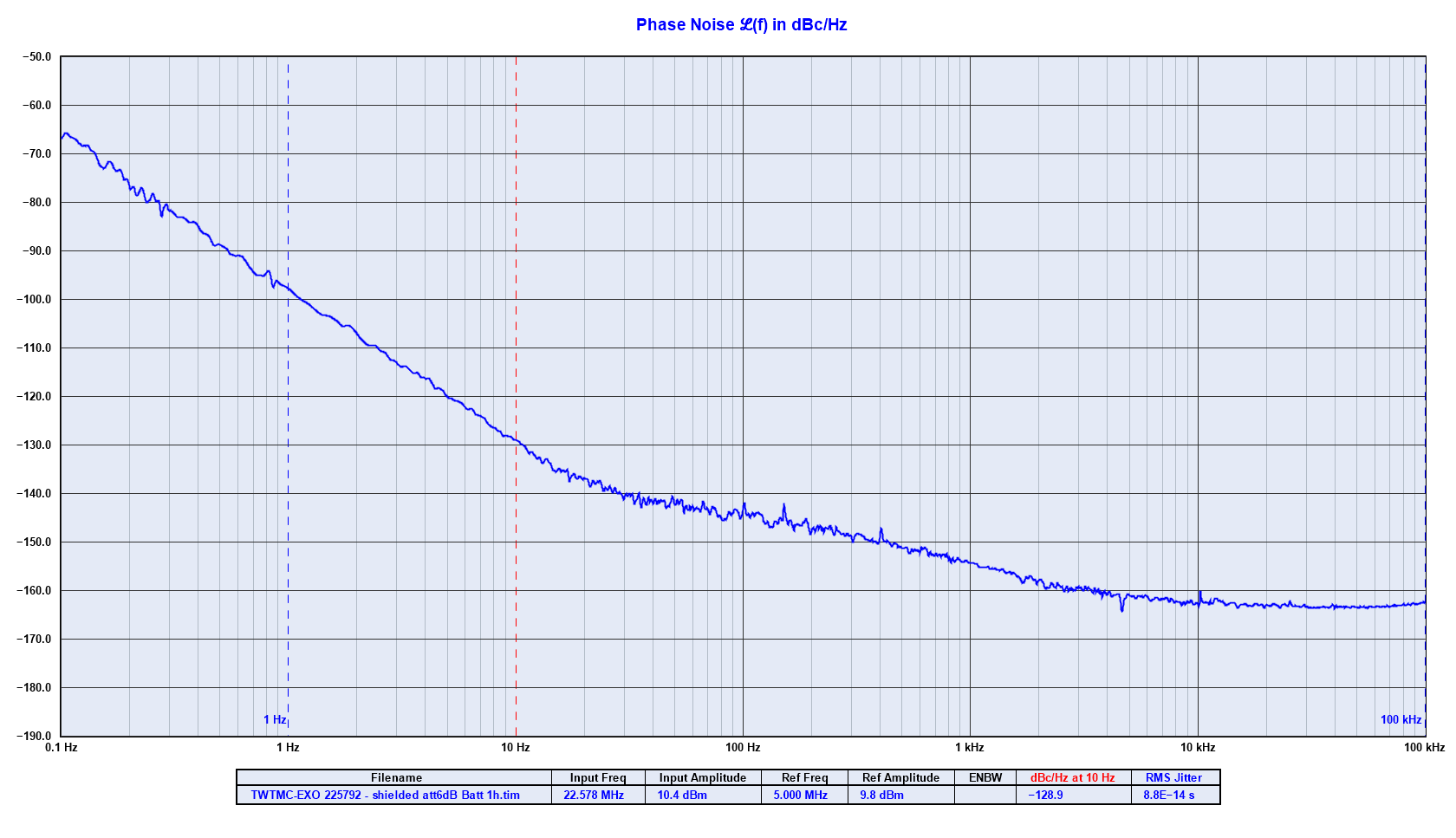

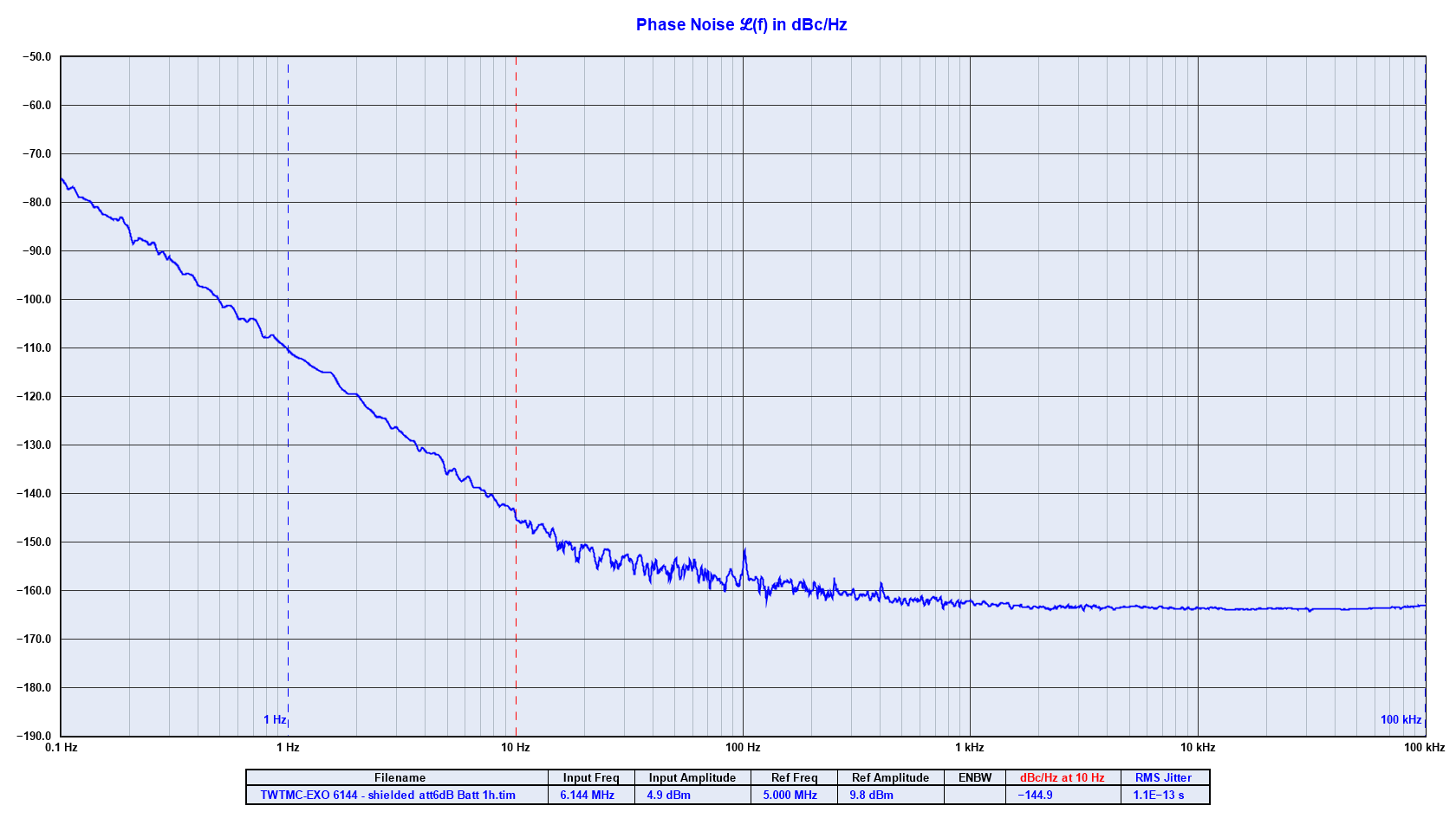

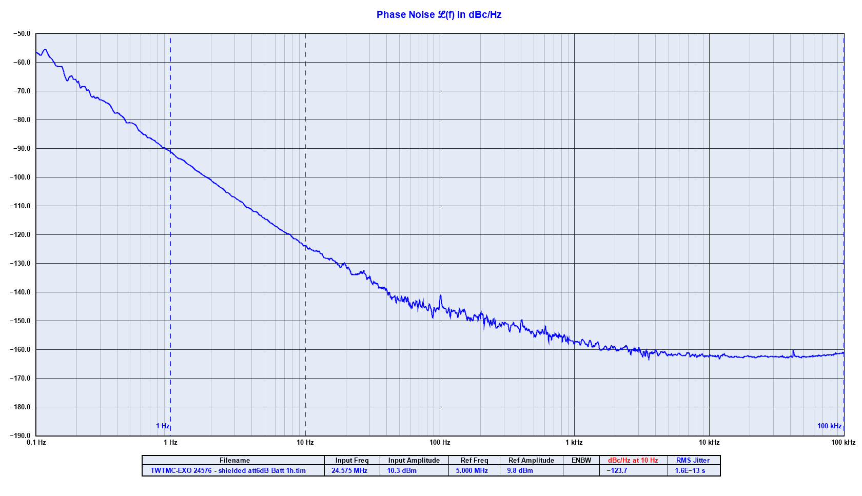

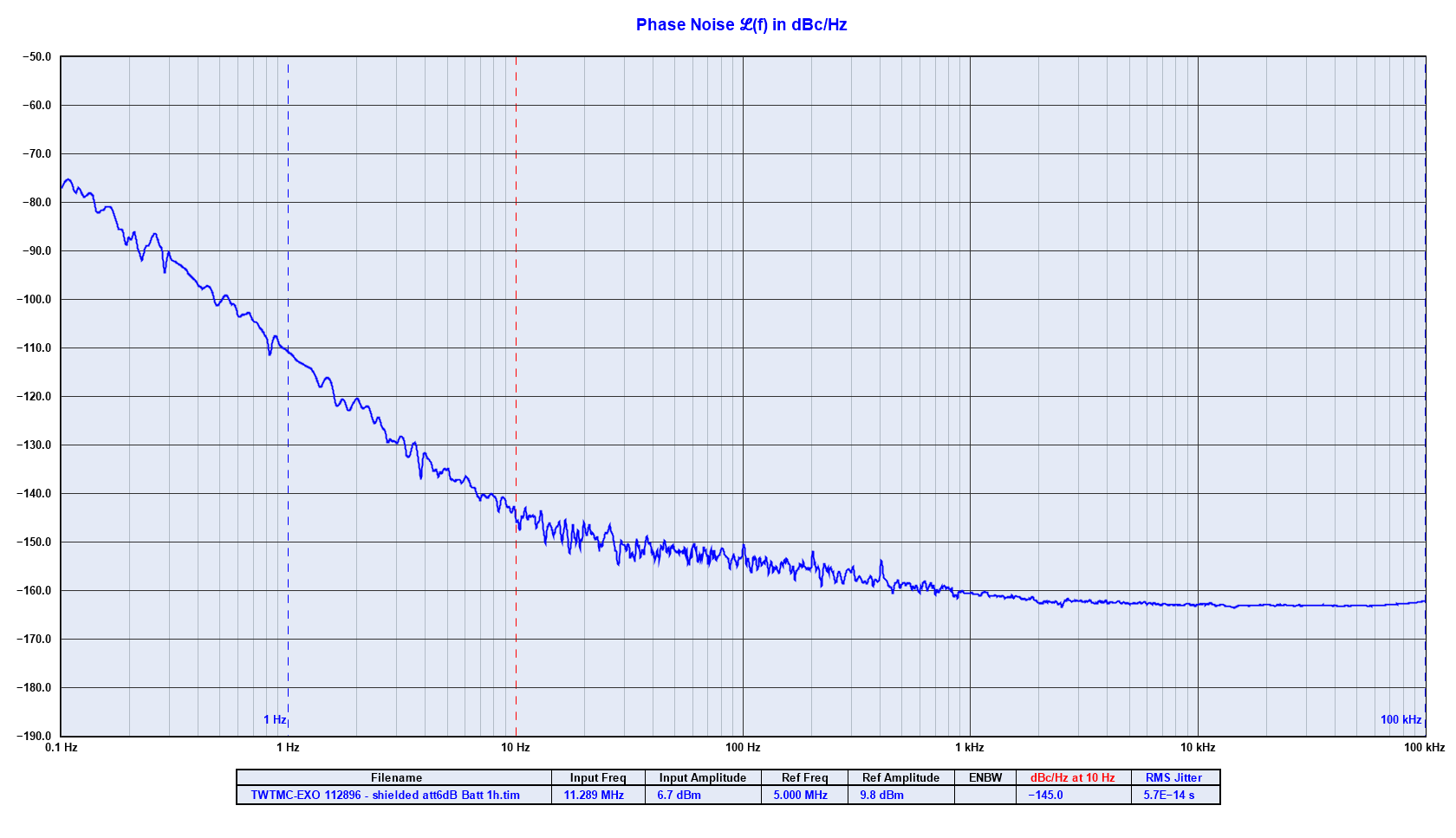

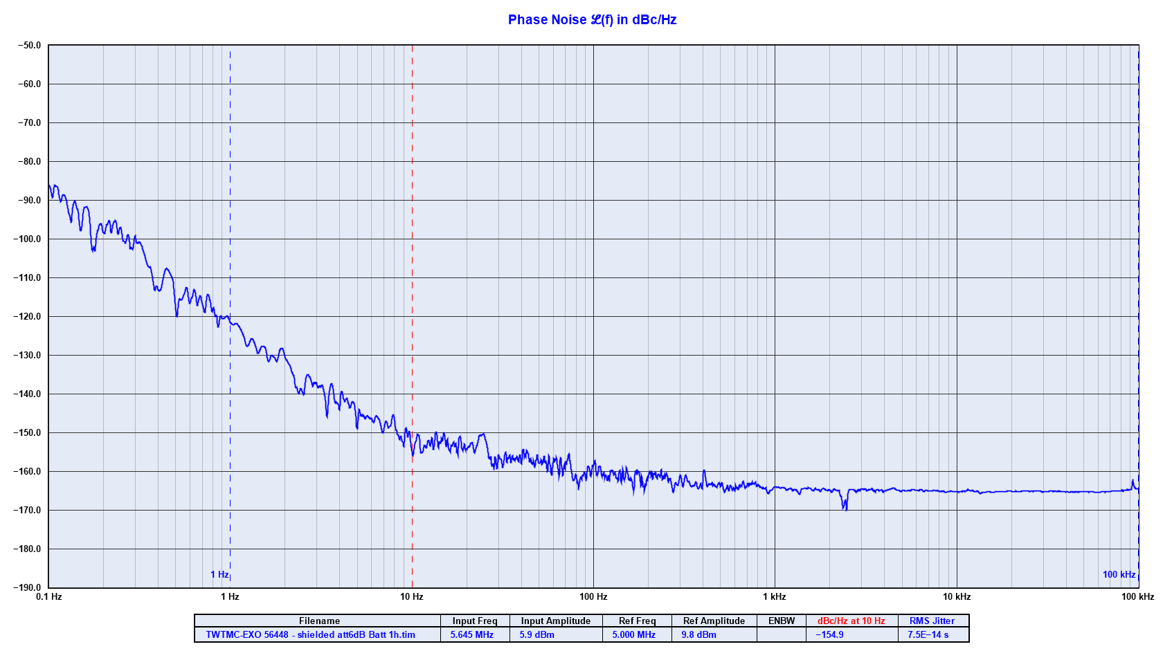

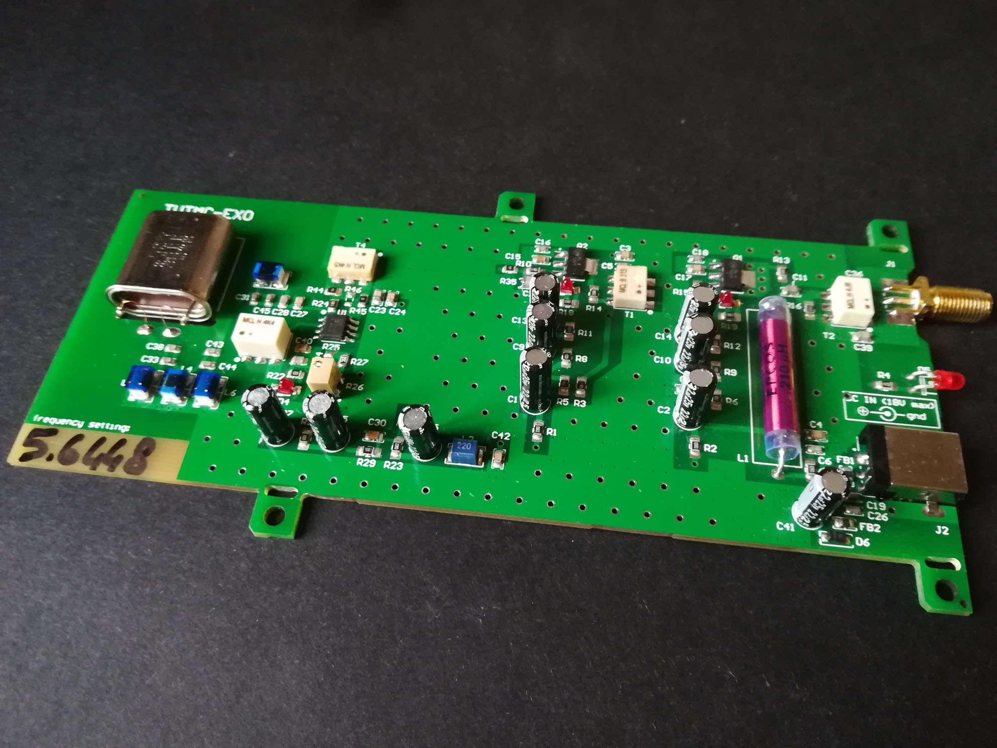

The new Driscoll (TWTMC-DRIXO) and Differential (TWTMC-EXO) oscillators are state of the art devices to be used as the master clock in digital to analog conversion.
The 5.6448 MHz oscillators are in the region of the Wenzel BT ULN and the Oscilloquartz BVA8607, the absolute references on the market.
These are the top of the line oscillators we have developed to be used in the top version of the whole audio system we are designing.

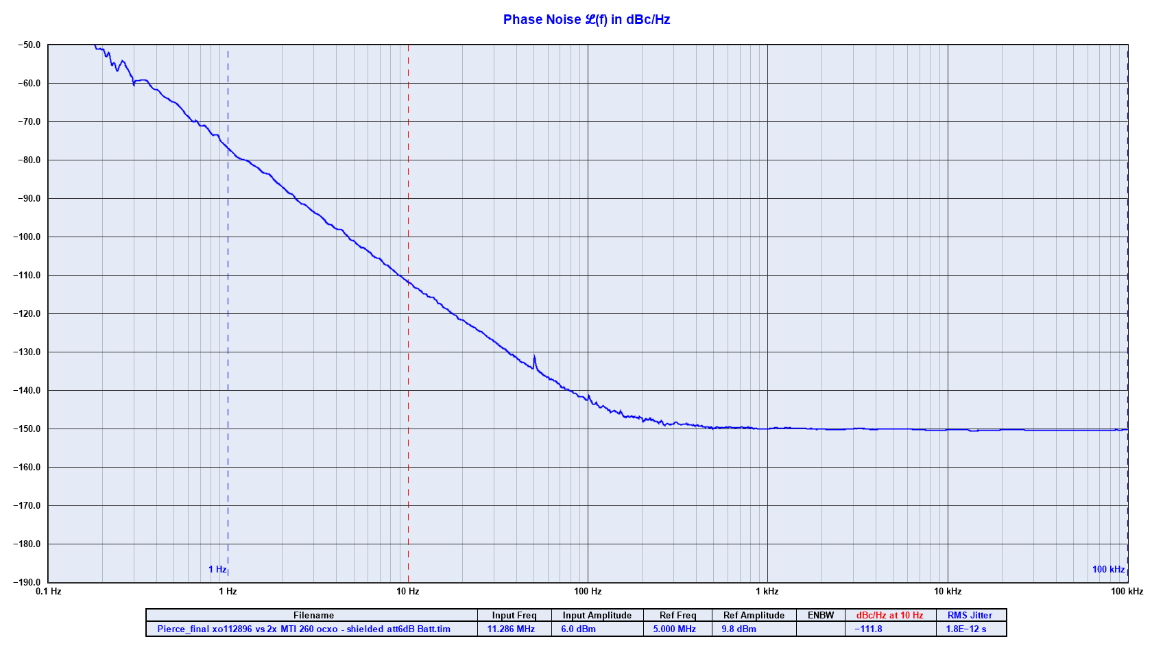

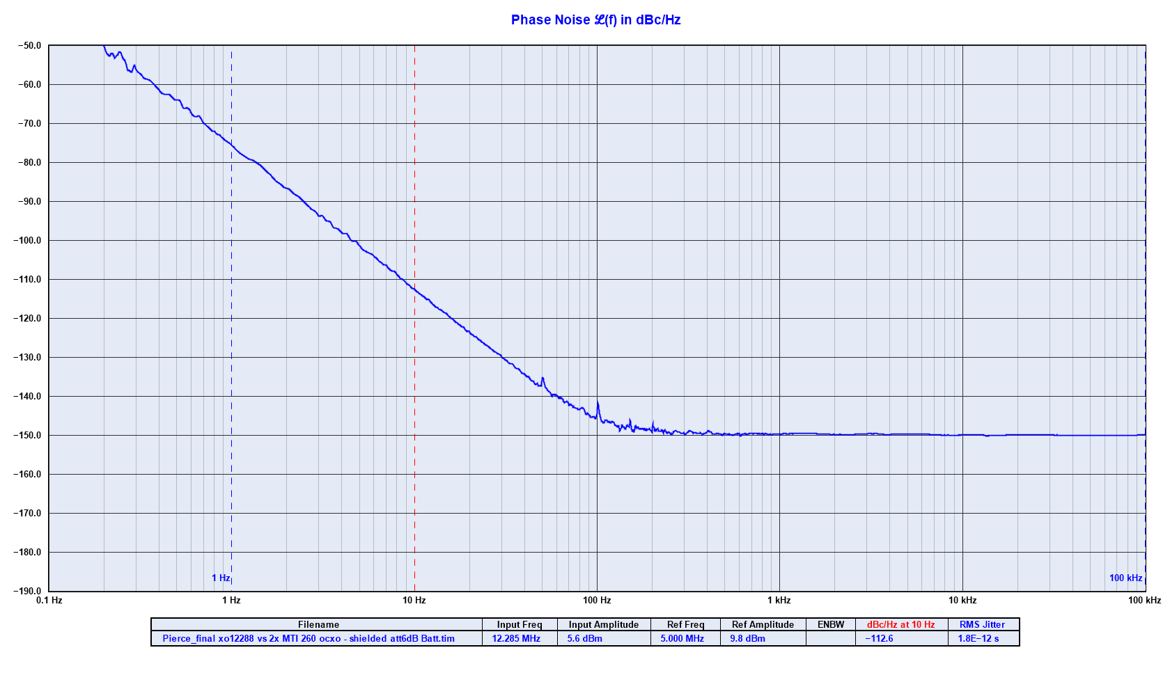

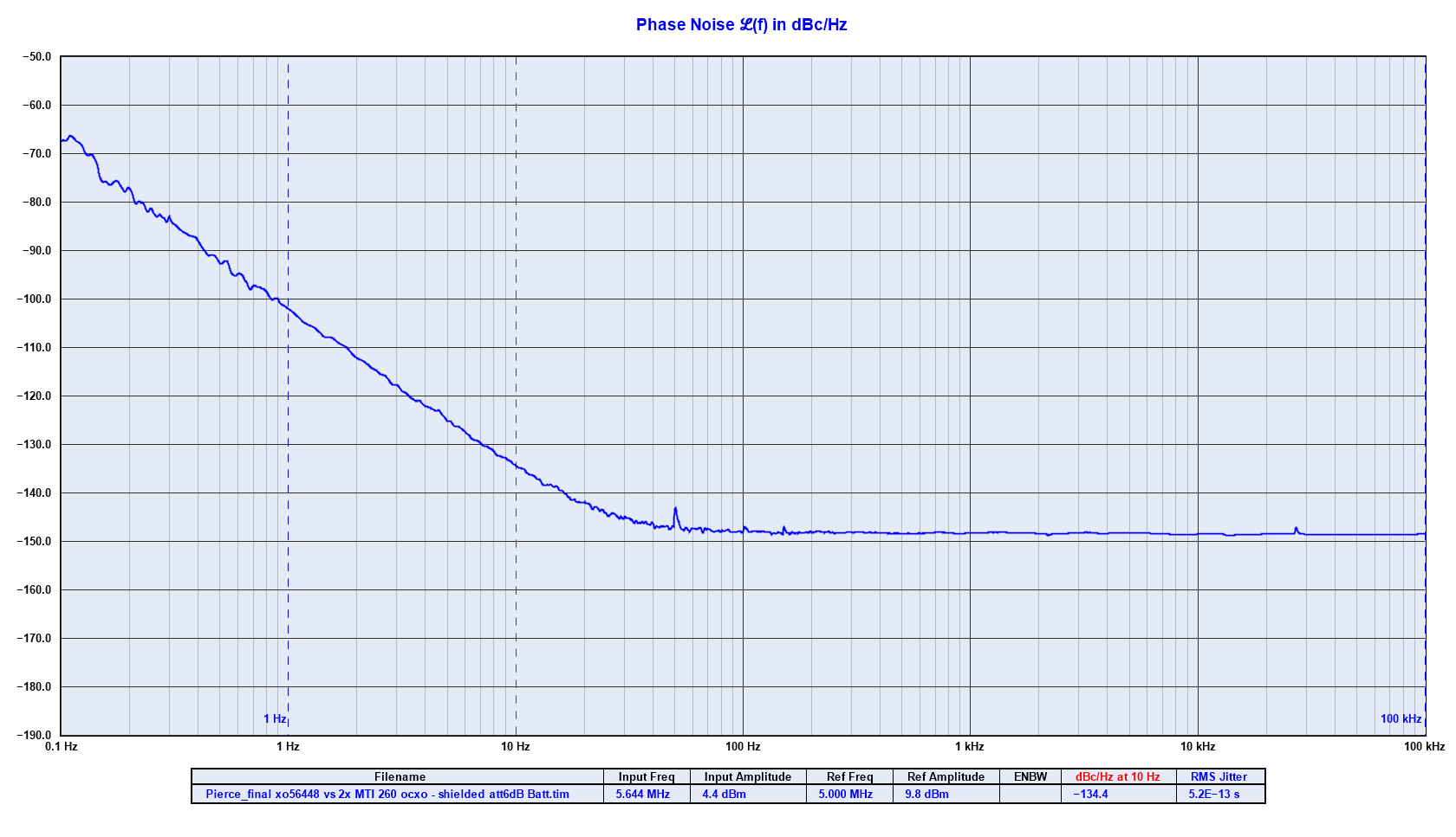

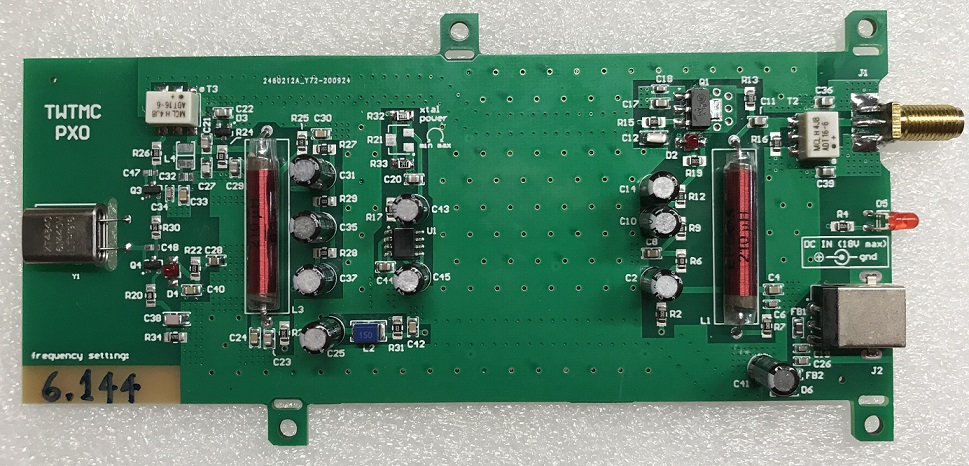

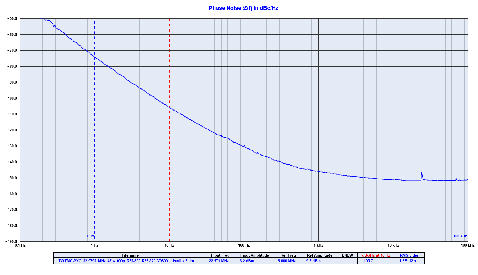

The new Pierce oscillator (TWTMC-PXO) has a few compromises against the top of the line and obviously its performance are not the same.
BTW, the 5/6 MHz perform very well considering thta they use AT-Cut crystals.
The Pierce can be used up to 45/49 MHz.

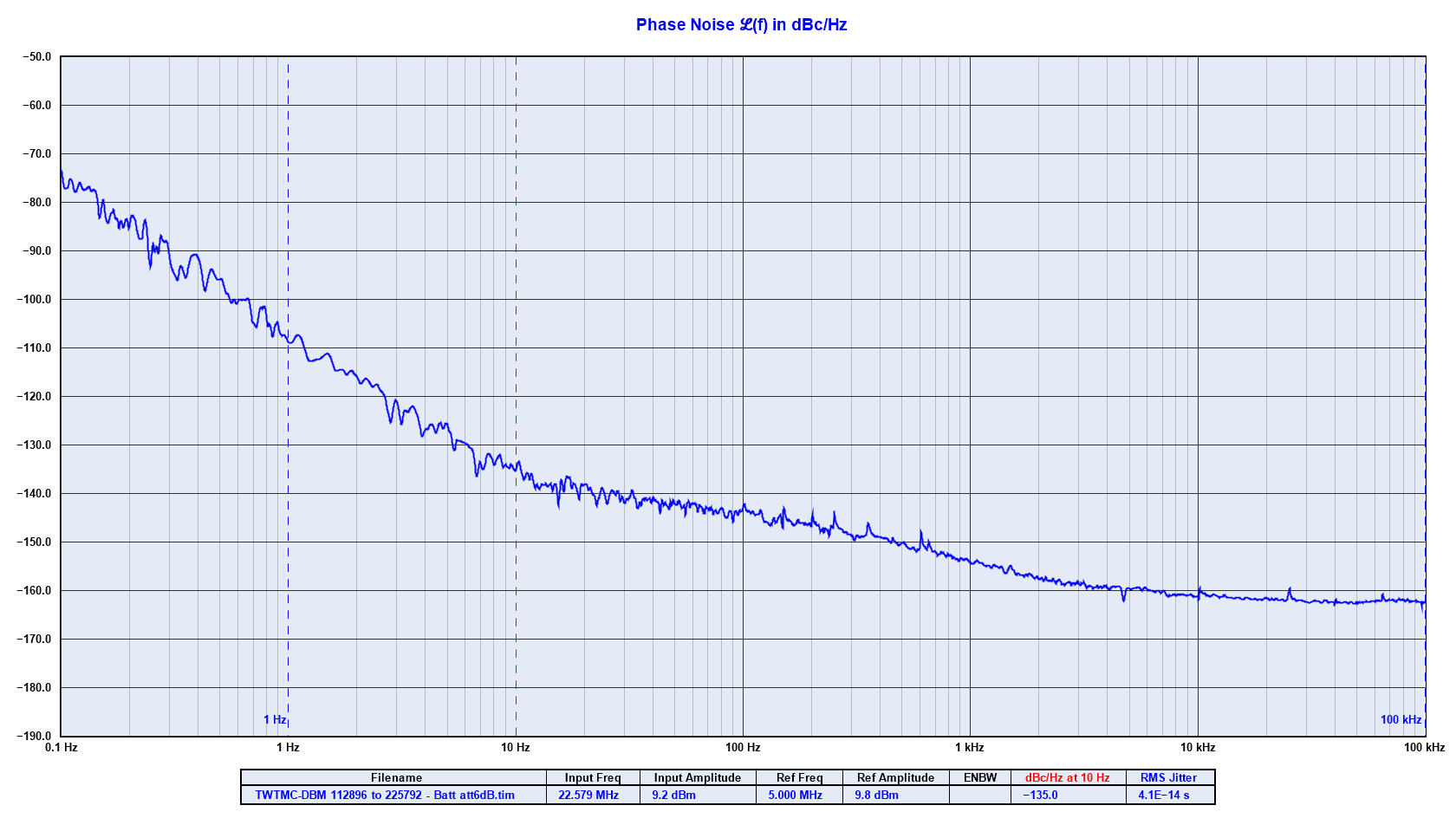

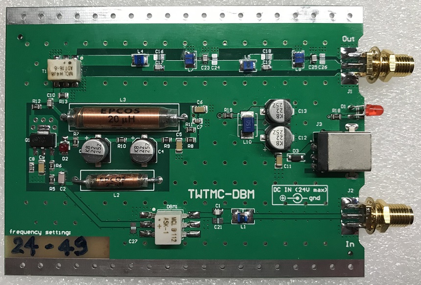

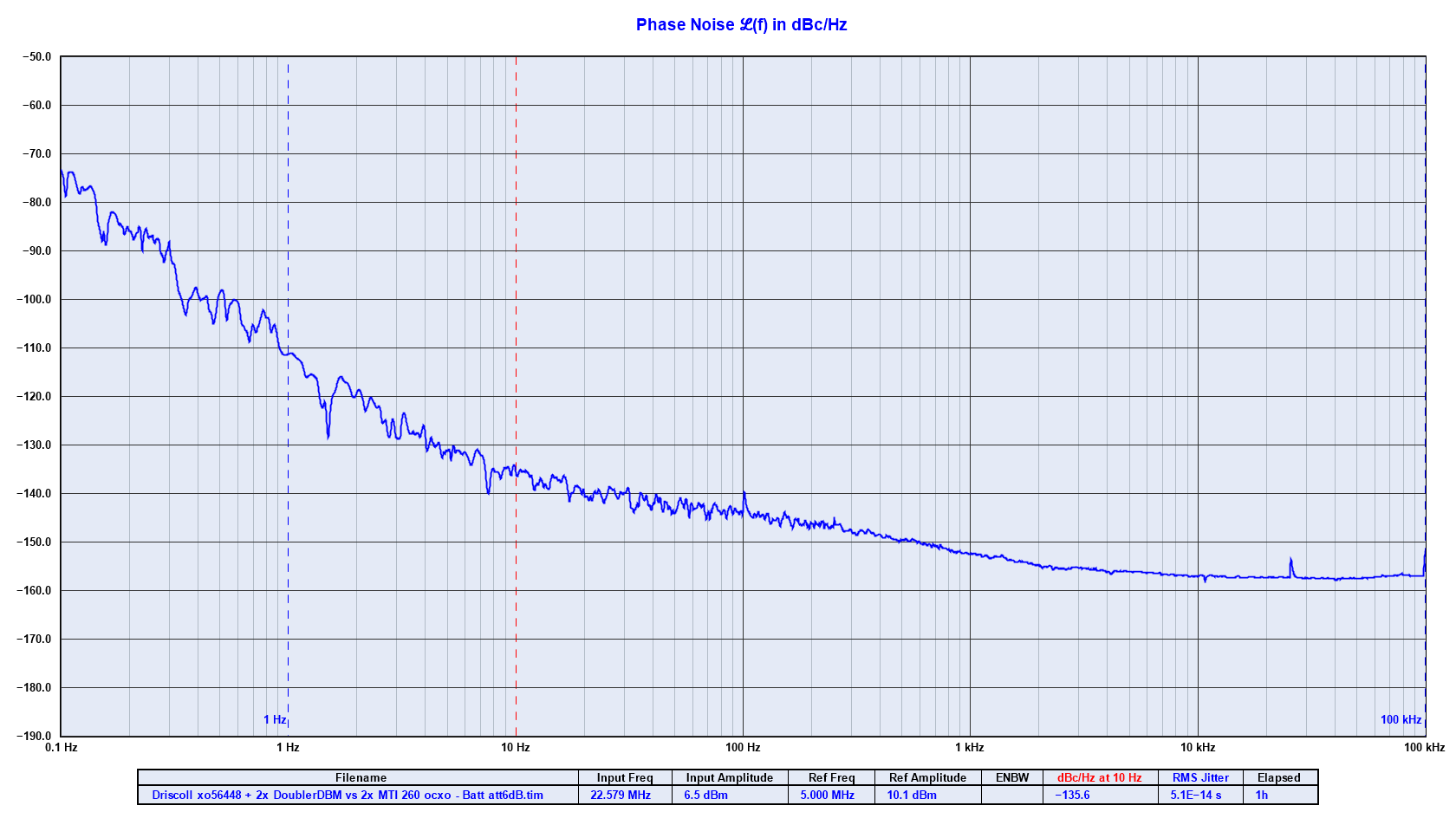

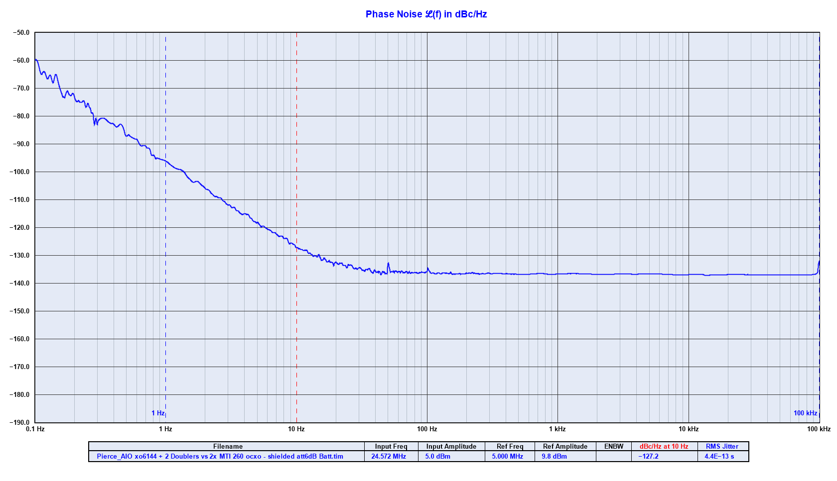

The frequency doubler (TWTMC-DBM) has impressive phase noise performance, by the measurement plots we have published it adds less than the theoretically 6dB for each multiplication.
It can be used in series (max 2 doublers) to reach 90/98 MHz.
When used with 5/6 (followed by 2 doublers) or 11/12 MHz (followed by one doubler) base oscillators the resulting 22/24 MHz output is really ultra low phase noise, better than the MSB Femto Seconds Galaxy Clock.

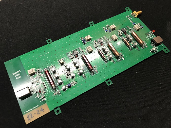

The combo Pierce oscillator TWTMC-PXO-AIO is a versatile device that can be used with 5/6 MHz AT-Cut crystals to provide very low phase noise outputs at 11/12 (-134 dbC at 10 Hz from the carrier) or 22/24 MHz (-127 dBc at 10 Hz from the carrier).
It also could be used to clock other devices like mother boards or switches at 24, 25 and 27 MHz starting from the base oscillator with crystals at 6, 6.25 and 6.75 MHz.

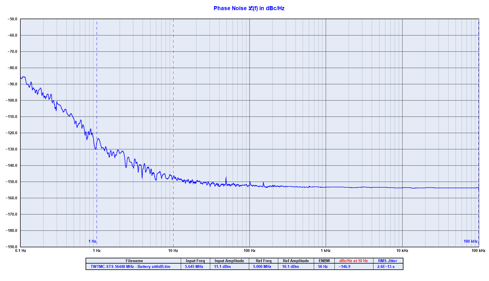

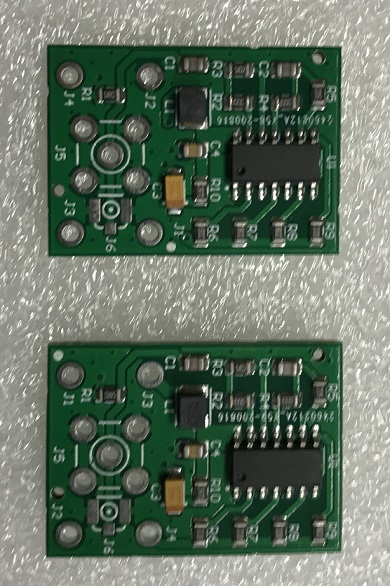

The sine to square converter little board TWTMC-STS performs very well, it substantially adds a little noise floor only to the sine wave oscillator, while the measured close in phase noise is almost superimposable to the phase noise of the oscillator to be squared.
It has be designed to fit Ian's FIFO boards.

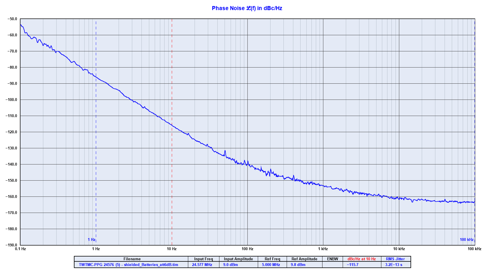

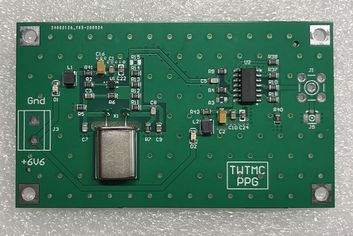

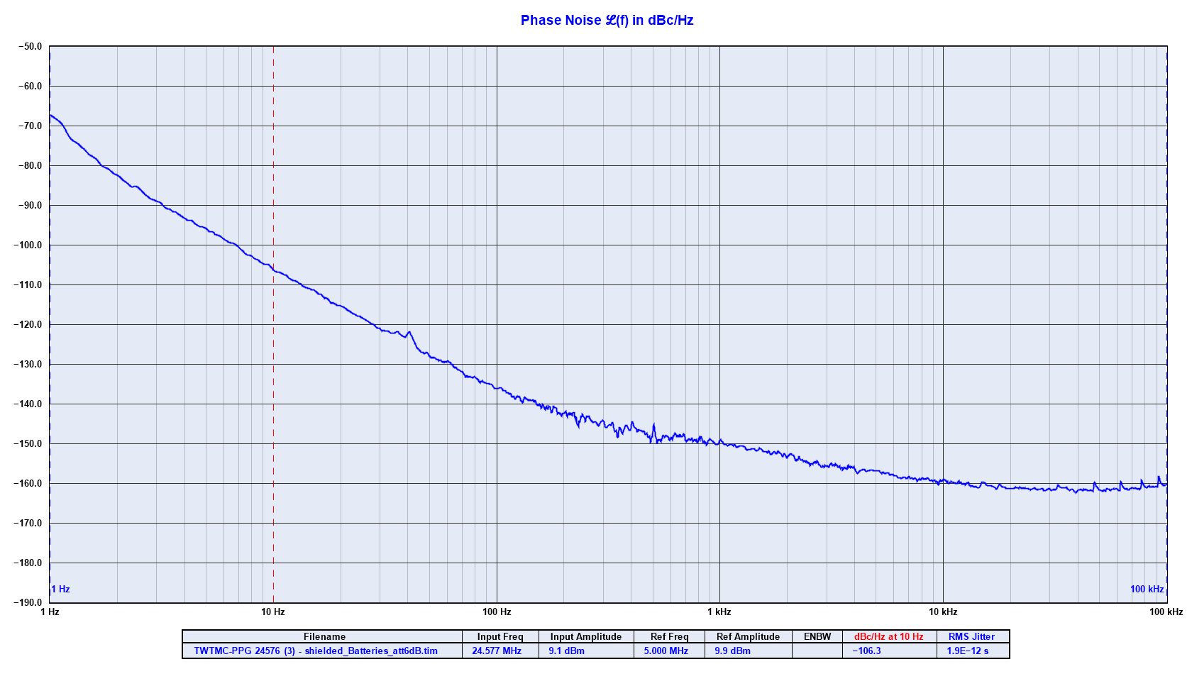

Finally the new Pierce pico gate oscillator TWTMC-PPG is a entry level affordable oscillator at 22/24 MHz.
The price is similar to tha Crystek CCHD-597 and the measured phase noise is 10 to 20 dB better than the Crystek one.
BTW, it uses standard HC49 crystals so consistency of the phase noise performance cannot be guaranteed.

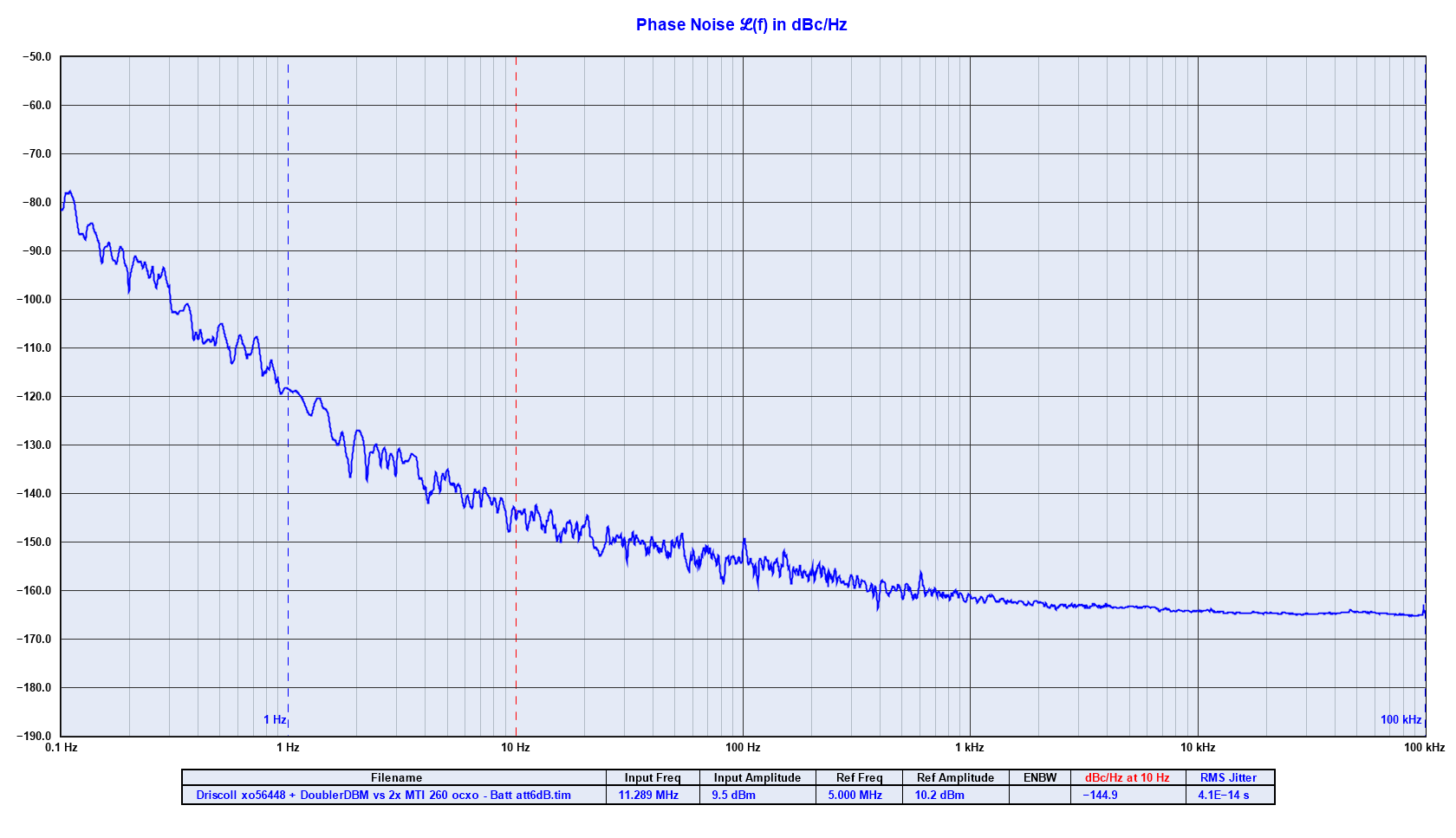

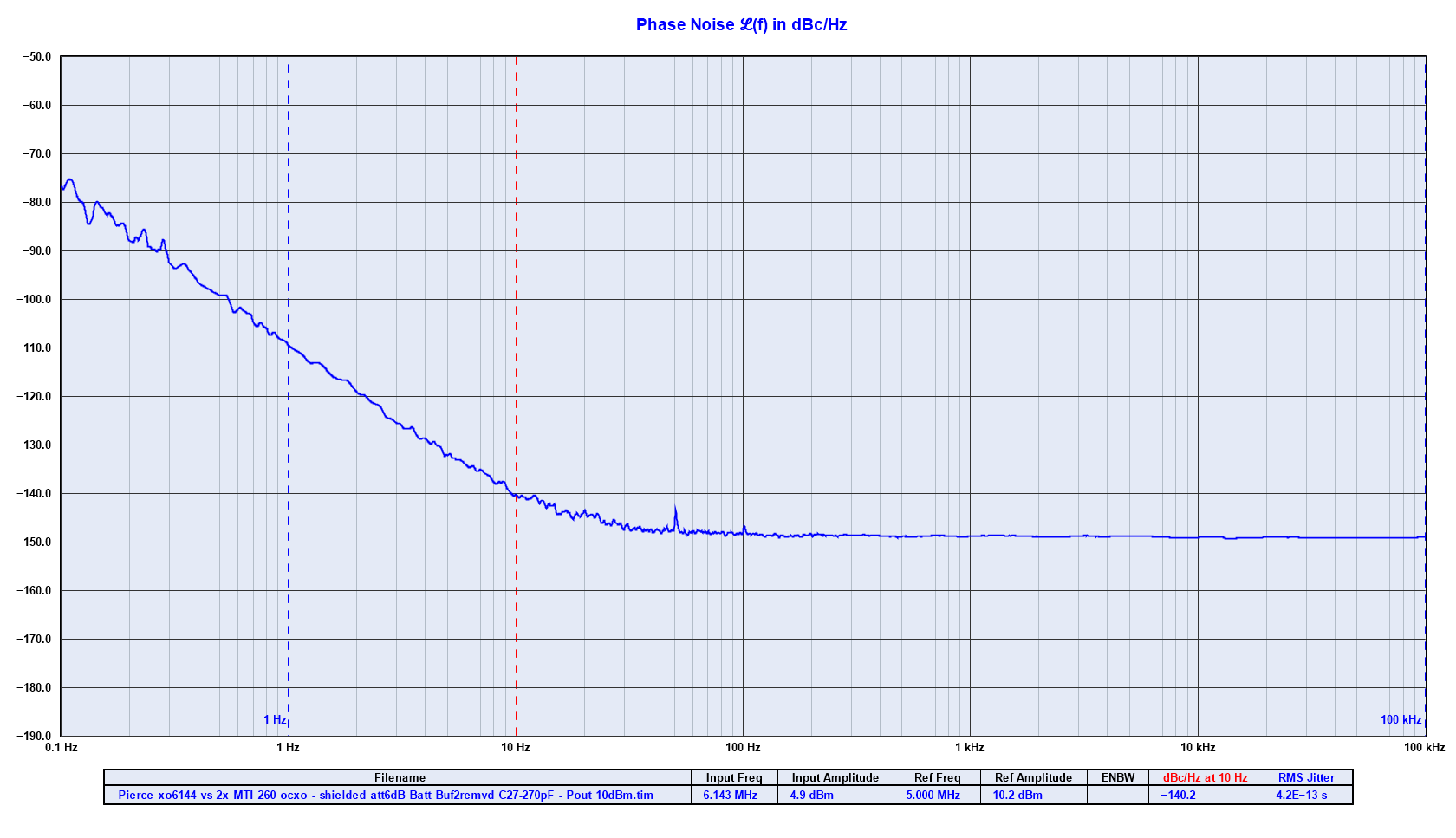

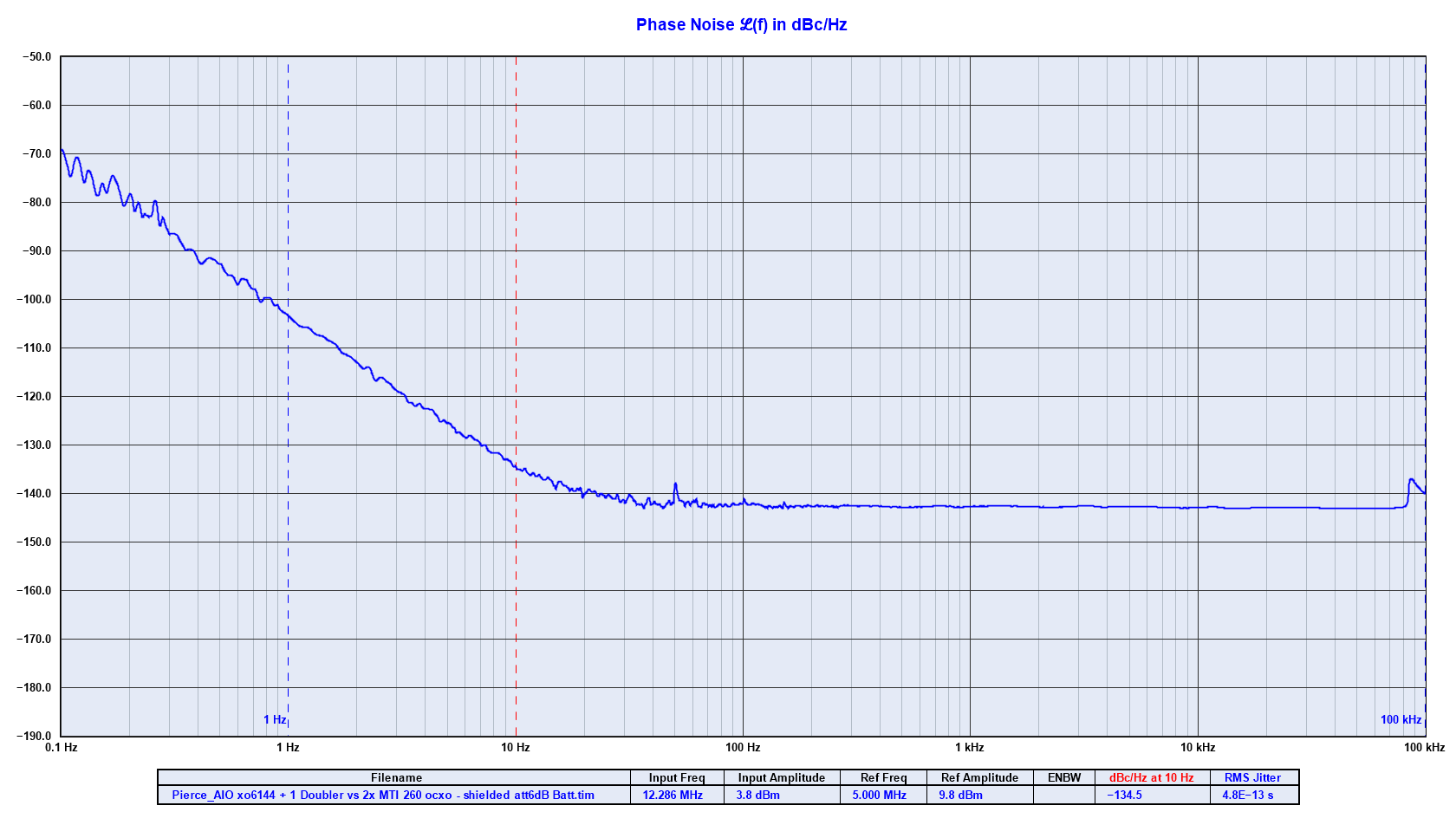

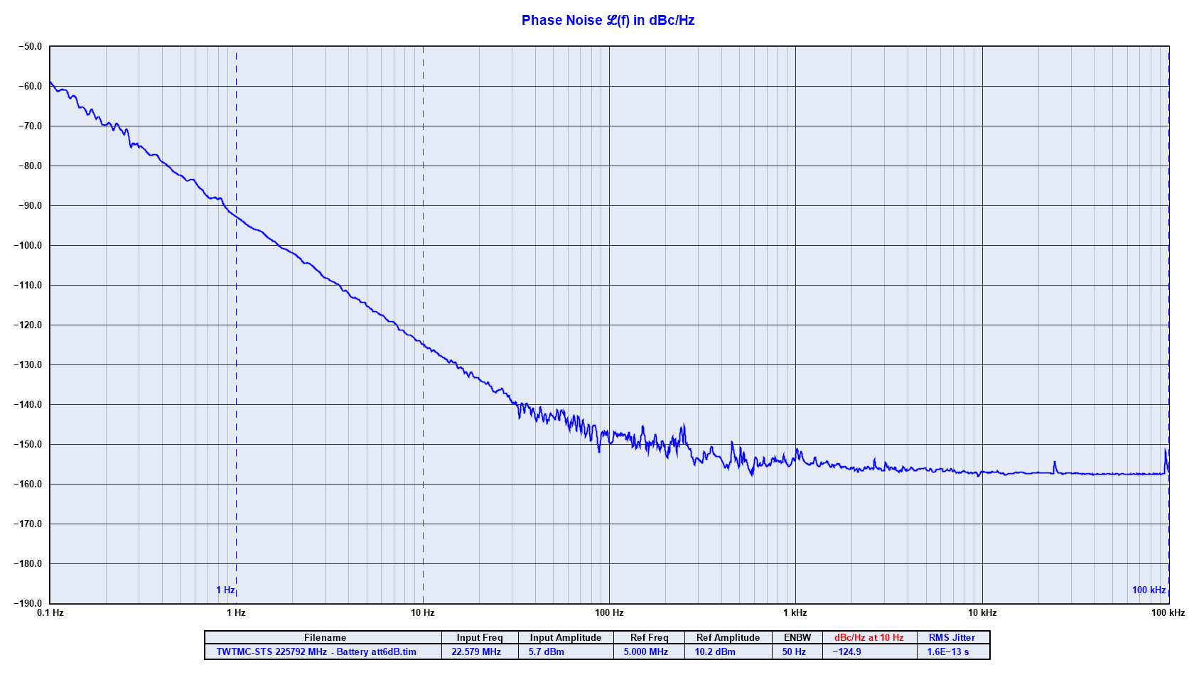

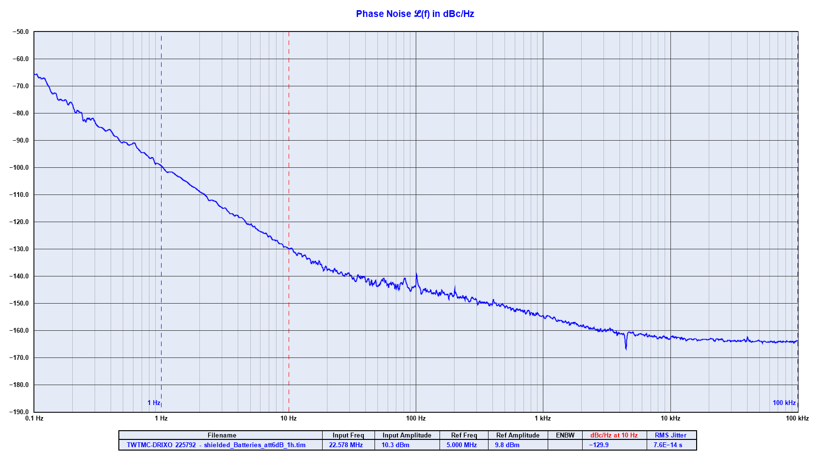

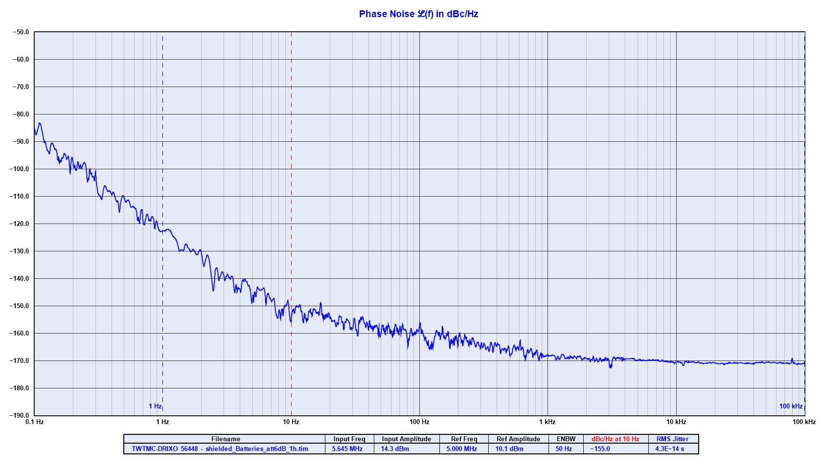

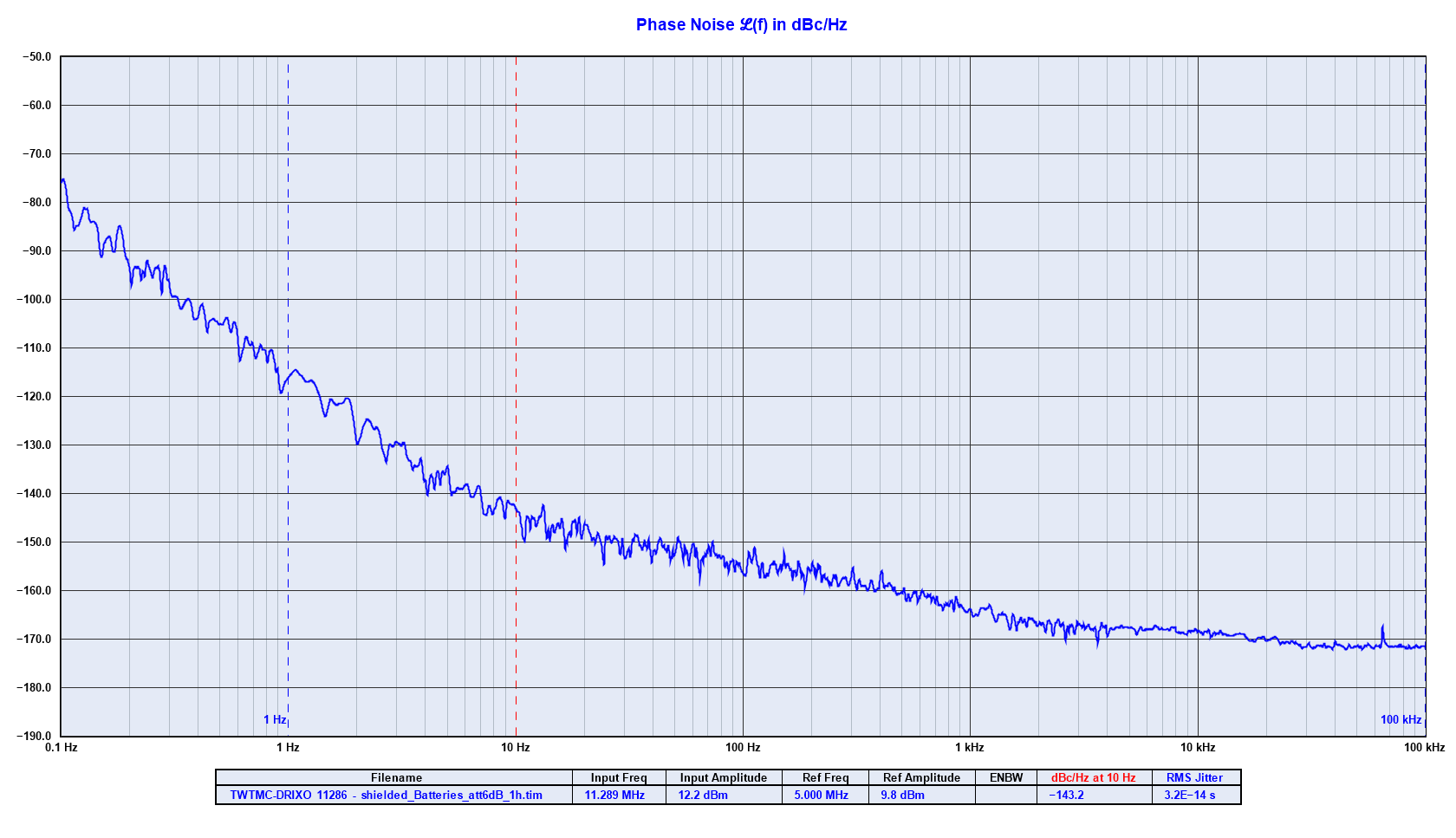

TWTMC-DRIXO new Driscoll oscillator
Oscillator type: Driscoll
Frequencies: 5.6448 MHz, 6.144 MHz, 11.2896 MHz, 12.288 MHz, 22.5792 MHz, 24.576 MHz
Output: sine wave (+16 dBm to +18 dBm)
Crystals: SC-Cut overtone only
Board size: 151mm x 75mm (excluding SMA connector)
Suitable box: Hammond 1455J1601 (Mouser part 546-1455J1601)
Board options: finished and semi-finished
Note: supplied without crystal and box
