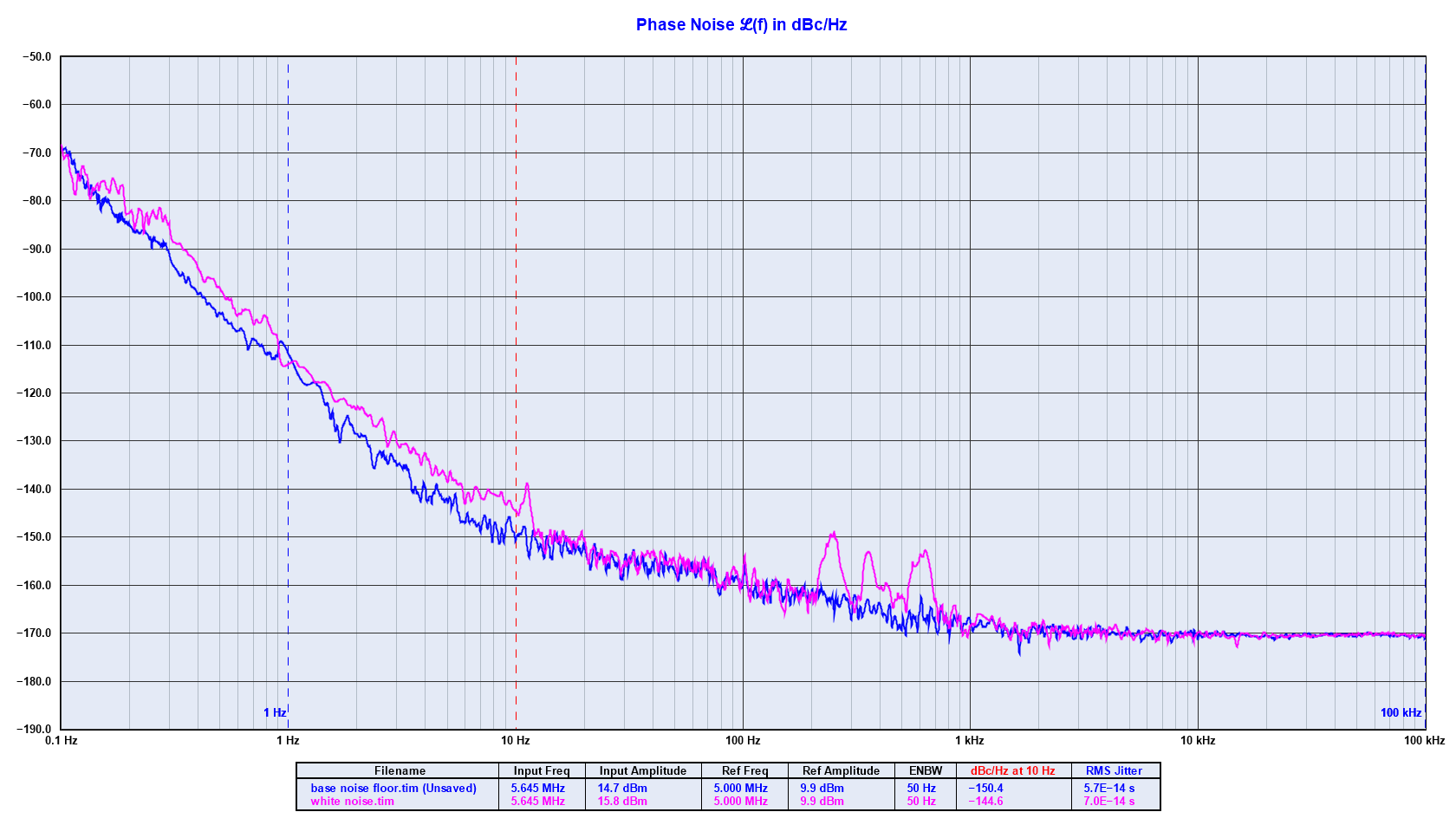

Anyway we have already measured the impact of vibrations on the phase noise of the oscillator.
I will publish the plots as soon as I find them.

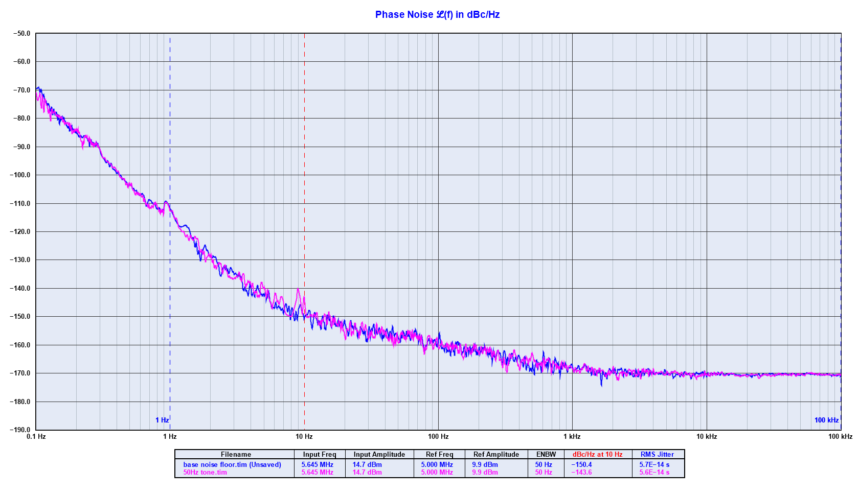

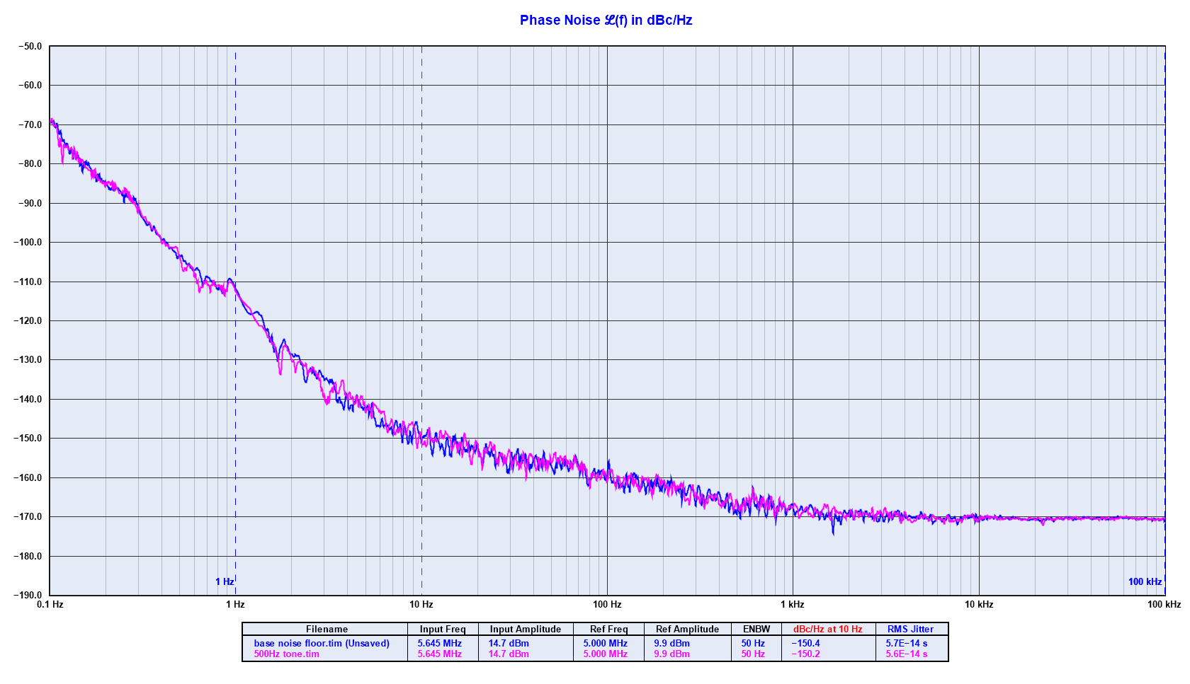

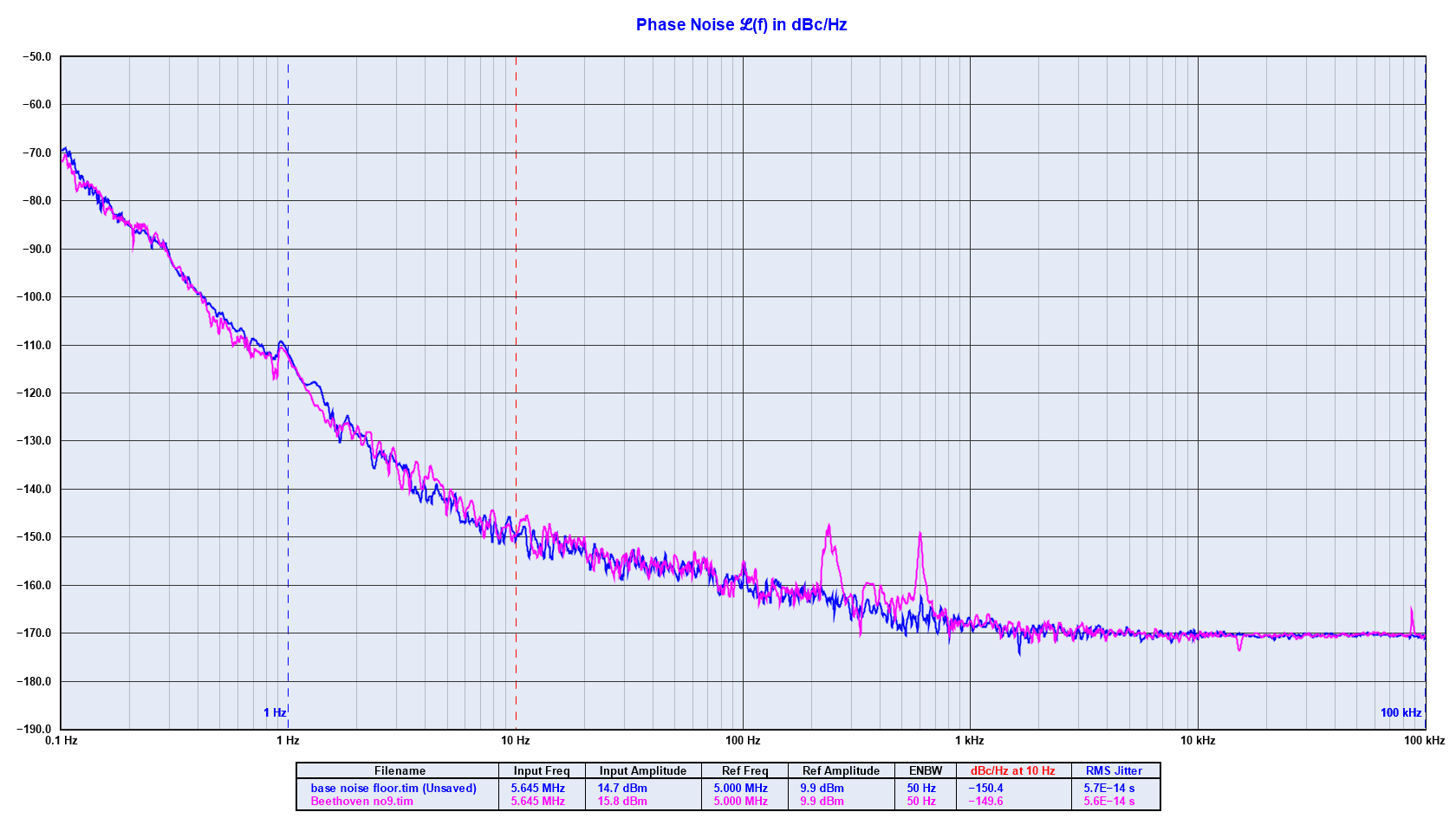

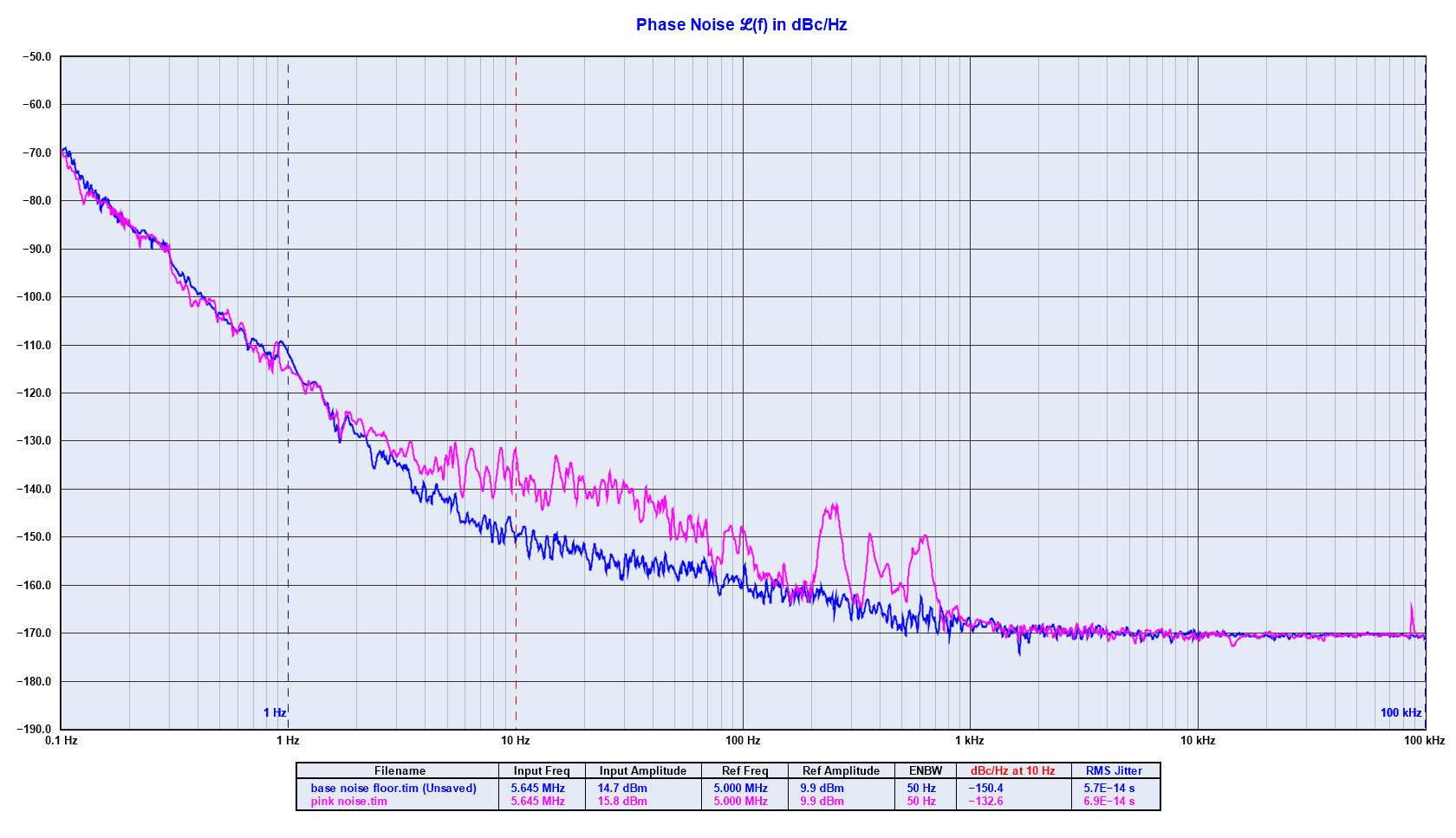

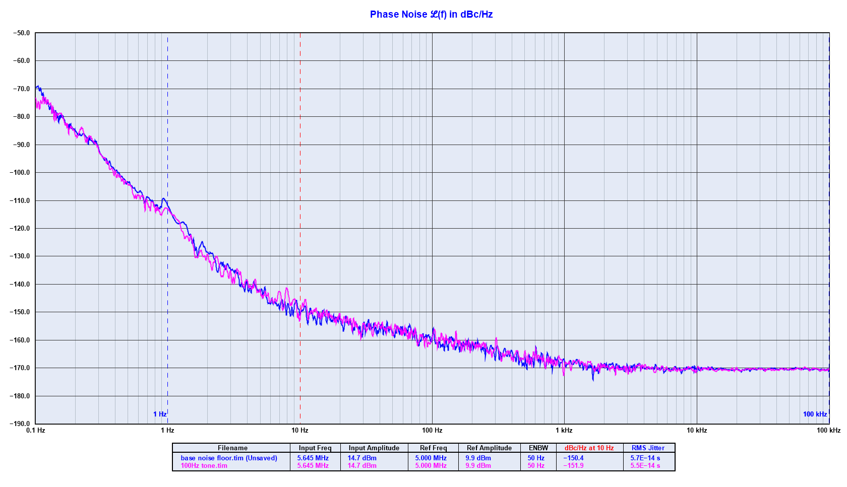

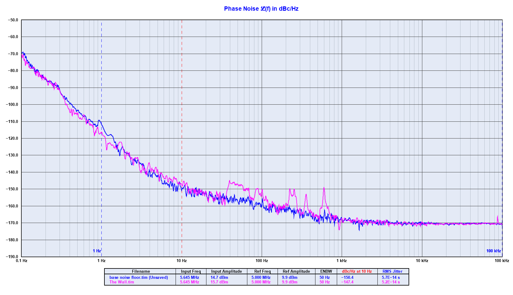

The following measurements was done in 2020 March with an older version of the new Driscoll oscillator at 5.6448MHz.
The oscillator was shielded in the aluminum box but was not yet decoupled with damping material as suggested in post #2808.
The condition was almost extreme:
- 90dB and more of sound level
- oscillator box placed at a distance of a few cm from the bass driver on a wooden tablet that rests on the speaker box
- no damping material was used
It was sufficient to move the oscillator box 50 cm away from the speaker to make the spurious disappear almost completely.
But keep in mind that even the moving air can affect the close in phase noise performance.
