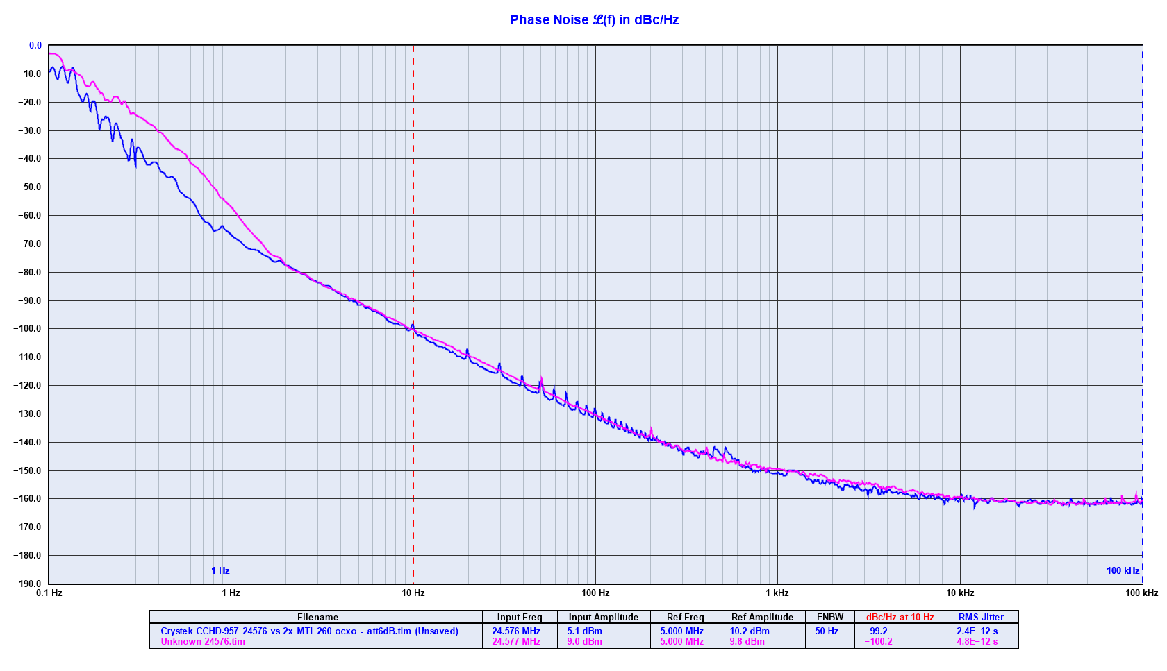

Someone did ask me to publish the phase noise plot of the Crystek CCHD-957 down to 0.1 Hz from the carrier.
I attach the plot compared to the cheap TWTMC-PPG at the same frequency, I had to change the dBc scale to show the phase noise of the Crystek at 0.1 from the carrier.
Maybe after hours of measurement it could perform a little better, this measurements was 30 minutes long (even the measurement of the TWTMC-PPG).
The crystek cchd957 curve below 1Hz - is very familiar.
A heat shield/cover for convective air currents would mitigate that quite nicely. 'basta poco'..
It looks like you still have a little to learn maybe you are not yet enough familiar with phase noise measurements and crystals behaviour.
The Crystek was shielded in a metal box during the measurement so no moving air and double isolation since the crystal is already inside the can of the oscillator.
Indeed "The crystek cchd957 curve below 1Hz - is very familiar", it's a typical behaviour of a cheap crystal where the surfaces are full of impurities, that heavily affects the random walk.
I attach a comparison against another cheap "unknown" crystal I have measured in the same shielded conditions in the Pierce pico gate oscillator.
The plots are almost superimposable (remember the rule of the ruler, Rubiola teaches, I know it's tiring but it would be better if you read his literature), so no currents air simply crappy crystals.
And it's pretty obvious since it's a 20 EUR oscillator from the shelf.

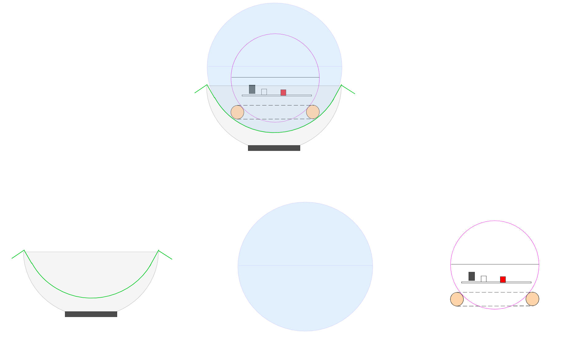

My take on isolation is inspired from the good ol' recordplayer. It houses an Ian buffer with NDK clocks. It's built up by:
- The inner bowl: houses the electronic which is mounted softly isolated resting on bubble plastic.
- The outer bowl: houses the inner bowl - the inner bowl being held and isolated by bubble plastic.
- The most outer foundation half bowl: It carries the outer bowl by 2 pc of training rubber bands in a cross and they are terminated under the foundation so that the weight itself fastens the whole thing.
The attached zip file contain a short .mp4 flick of the suspension in action.
I have not done any measurement of the grade of isolation.
But I feel it improves on my DAM dac an it's not so superior jitter buffer design.

I'm contemplating a way to communicate with the clock by light so that no open holes in either of the bowls and no mechanical contact - even not by wire...
- Drill the 2 holes in each bowl and glue glass windows so to make a pressure tight bowl - .
- Align the windows so that the electronics can be supplied energy by light - fix solar cell power system in there...
- Send clocks by laser - receiver on the outside
Levitate everything by strong magnets and a glued iron clad in the bottom of the foundation bowl.
Well, maybe... :-D
PS: Now a use silicon to seal the holes for the cabling...
PS2: The 2 inner bowls have been painted on the inside with a total of 3 kg worth of dampening latex.

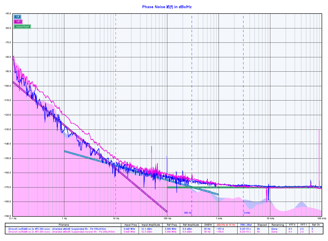

Exactly, the oscillator does not generate sub-harmonics, only harmonics (I have already posted the spectrum of the Driscoll oscillator).
A PLL like the one you are referring is very complex to realize, setting the right PLL loop bandwidth is critical and finally you risk to add some noise that could invalidate the low phase noise of reference clock at close to carrier frequency.
We have made a 6 hours phase noise measurement as in the attached plot I have already posted and of course the close in noise improves for both oscillators since at 1Hz and below from the carrier is the crystal random walk to dominate the performance.
The phase noise at 1 Hz from the carrier is almost -130dBc.
I fully subscribe "it remains very hard to understand the perceptual model why this aspect of the audio master oscillator is so important" and mostly I fully agree with your statement "since it simply is that audible, the best you can do is making sure you have the best possible clock in your audio system".
I have said the same several times, even too times, to get me tired.
I would repeat again, if not so this thread does not made sense, get a 20 bucks Crystek and forget this discussion.

I'm extremely surprised that exposing 100 Hz tone of 90 dB onto that box for an hour didn't make a significant impact on the trace in the PN curve at -160 dBc; how can that come? I mean... 160 dB, thats is such a extraordinary span...
That's what we have measured, sorry but we have no time to make the measurement again.
Indeed listening to The Wall the phase noise at 100 Hz and around increases.
Anyway, none in their right mind places the oscillator onto the speaker driver.
As I said keep the oscillator box at least 50 cm away from the speaker and there are no spurious.
