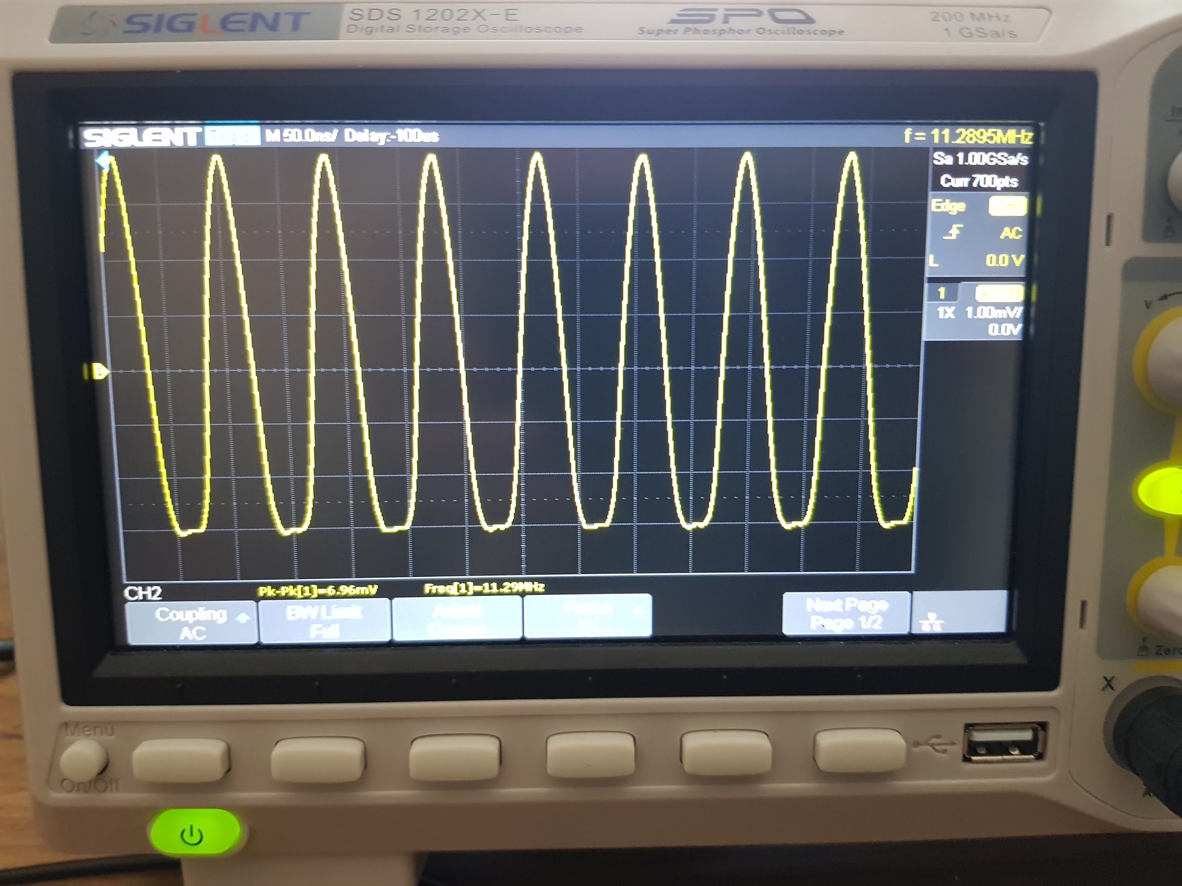

I confirmed today that the grounding of the coil indeed makes a big difference
the sine in was 11.29 MHz, 5.5 Vpp
with open relay, on the output I measured:
coil not grounded, 7 mVpp (58 dB isolation)
coil grounded, 0.3 mVpp (84 dB isolation)

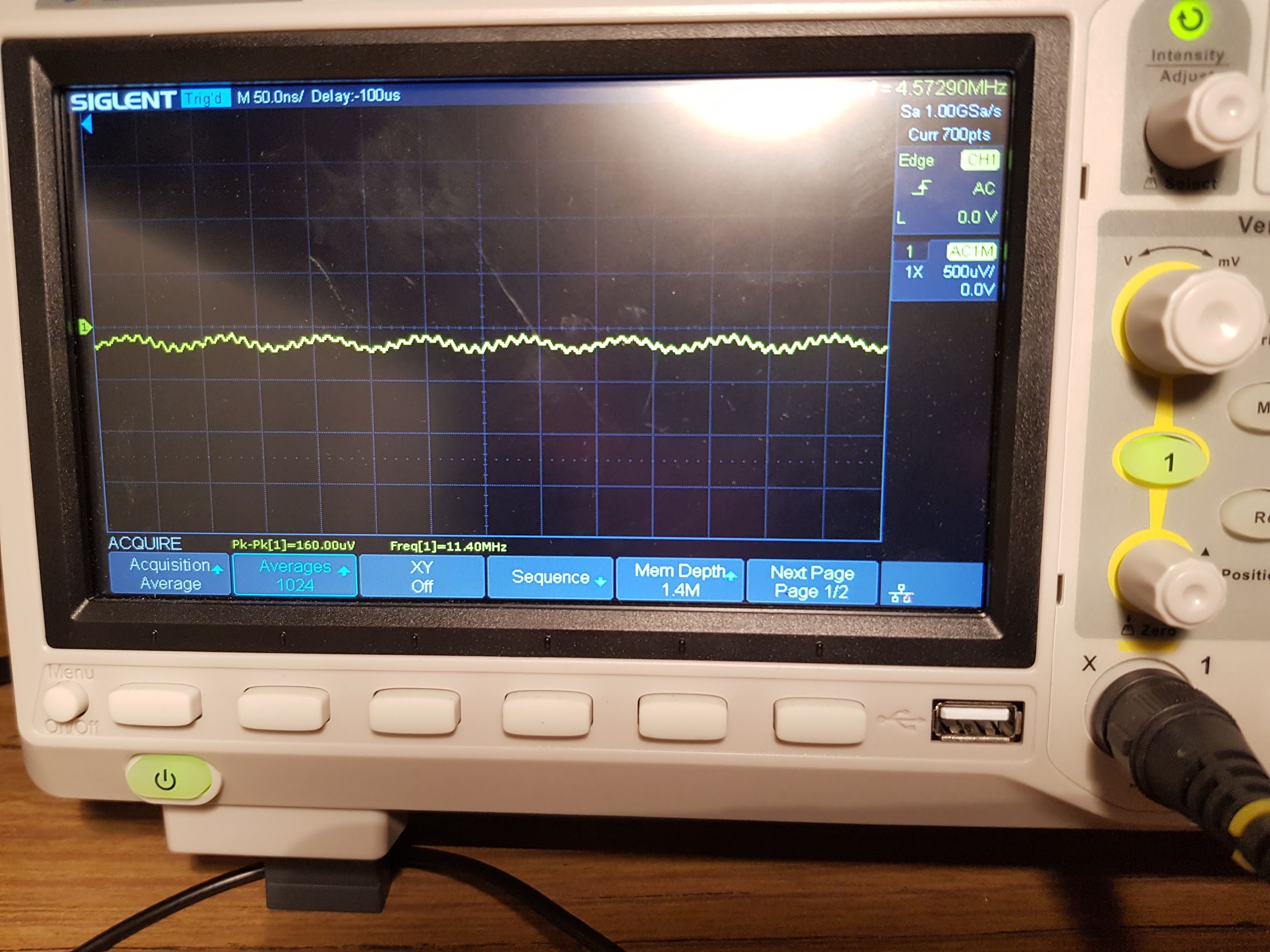

new test,

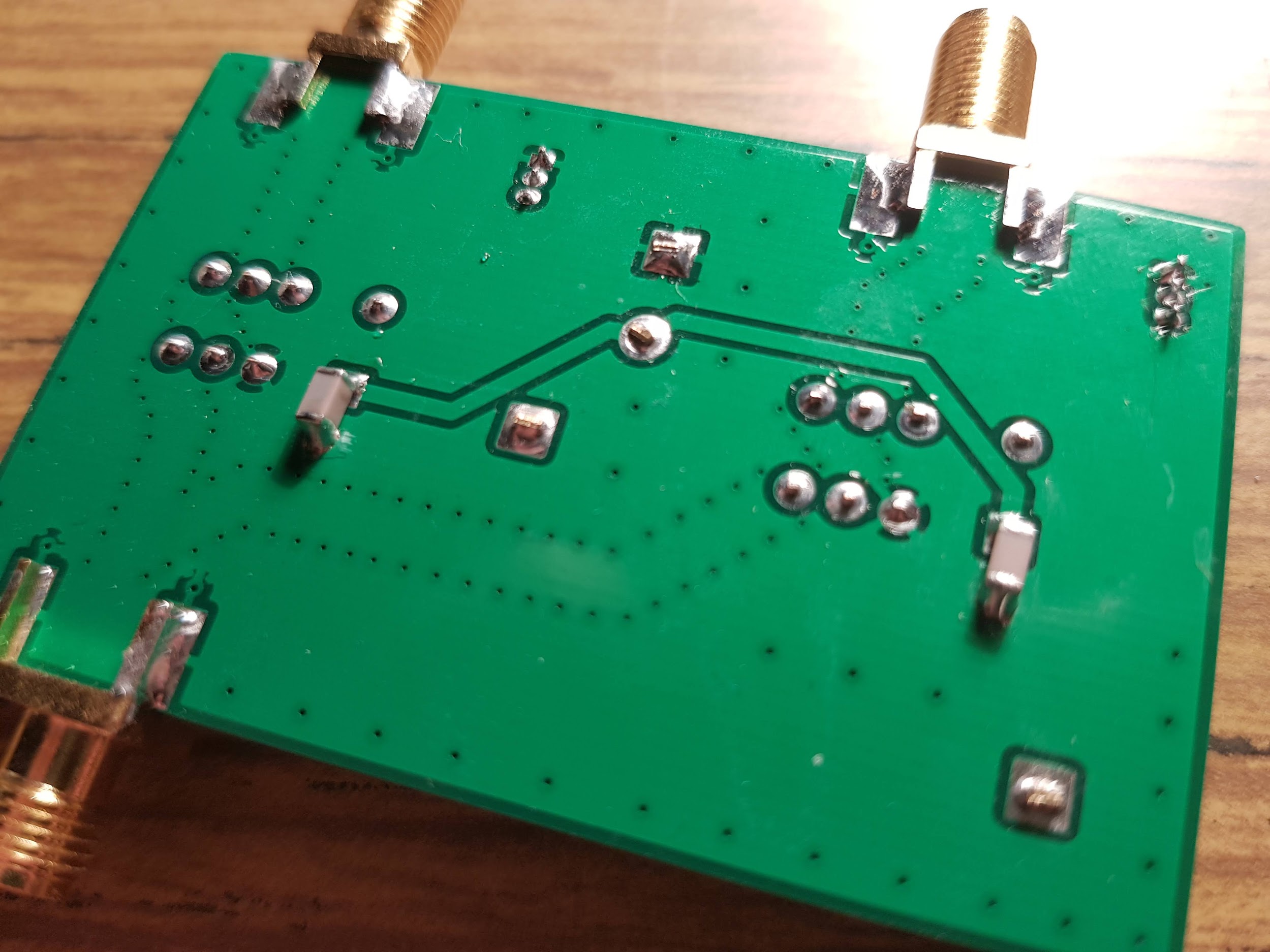

As suggested here, I soldered a 0.1 uF MLCC between coil pin and ground plane at the 3.3V side at each relay and re-measured, and this gave nice results, direct coil grounding not needed anymore I think.
I measured only 0.16 mVpp leakage in the best case.

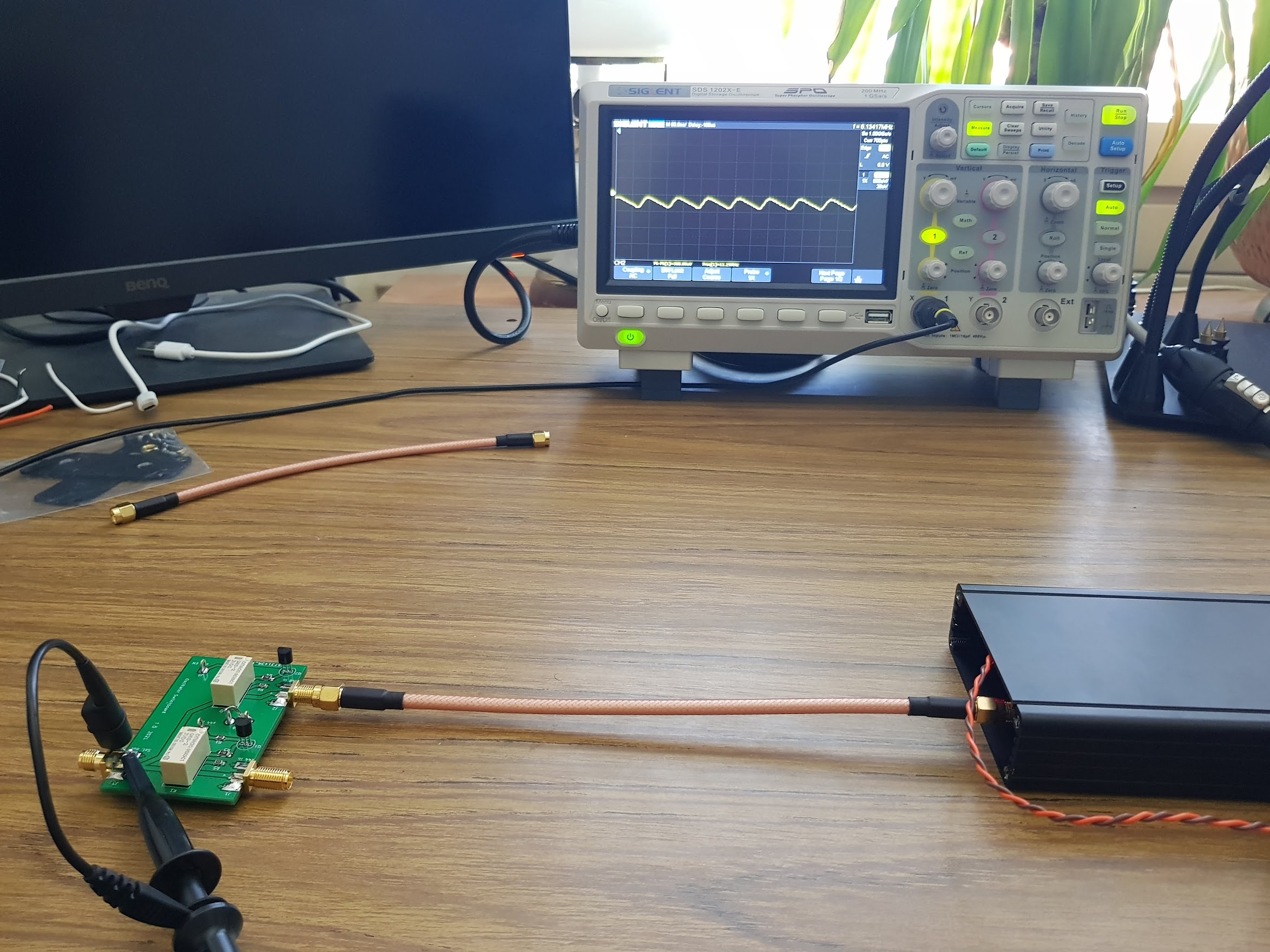

I changed termination from 100 to 75R (did not have 50R at home at this time) and the waveform looks better. Something that looks like approx 100 MHz is riding on the waveform, picked up from something nearby I guess?

in my experience, one side solidly grounded and the other bypassed by a cap performs best.
By switching the coil "high-side", extra care (filtering) must be taken on the psu that act upon the coils (if shared with other electronics..)
but mileage may vary based upon the type of signal/relay/layout.

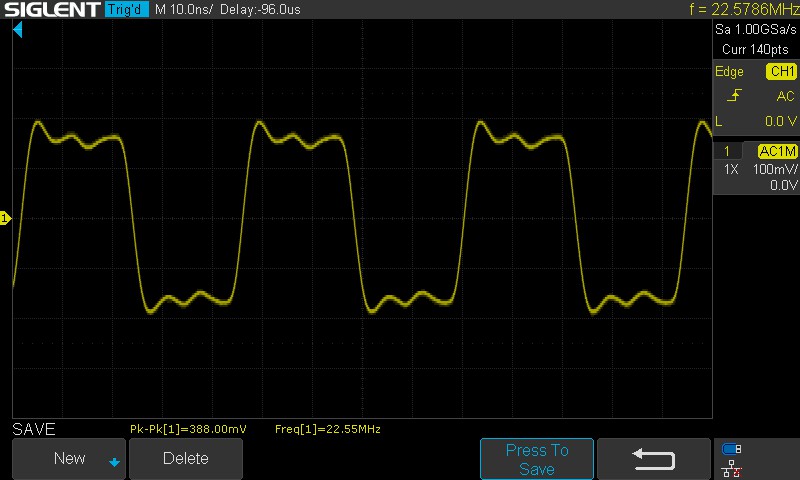

I have tested the switchboard + STS-DX squarer board in my DAC now. Input is Driscoll 11 and 12 MHz + doublers. Sounds good, will make some listening comparisons later when the build is more final.
Output from the squarer mounted in DAC looks like this.
