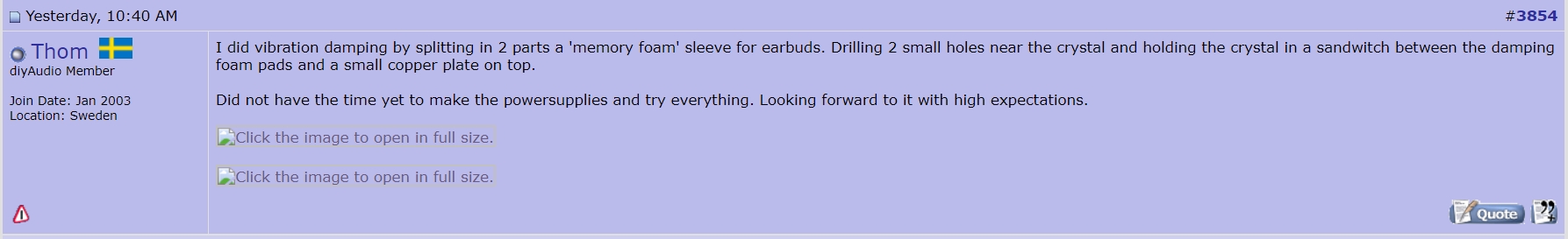

Those microphonics could be from the circuit board, components and transistors as well as the crystal. Anyplace where you have a higher impedance and a voltage bias with some capacitance a little flex and you have a microphone.

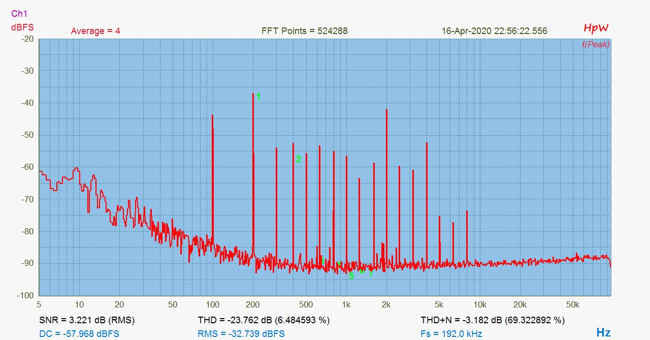

Even semiconductors are sensitive to mechanical strain. I remember when I tested various LDOs, those that had a X7R cap on the reference bypass pin were very microphonic, but even an ADP151, with no reference bypass cap, had some sensitivity to board flex.

With LT3042, Ref bypass cap X7R.
Then changed Ref bypass to PPS, REF resistance to an S102. Then played a multitone signal from like 20cm distance.
First shot is 'standard', second shot is LT3042 'deadened'
The tests were for 'mapping' an observed vibration sensitivity, while originally I was looking for regulator noise, simply.
The DUT was an LT3042/ LT3094 dual reg, made by ourselves. The signal is taken from the regulated DC output, 4,5V, cca 60mA load.
The setup was: Cookie can >battery> reg. board> Gerhard 's 20x4898 pre at 60dB gain > RTX6001 > HPWorks

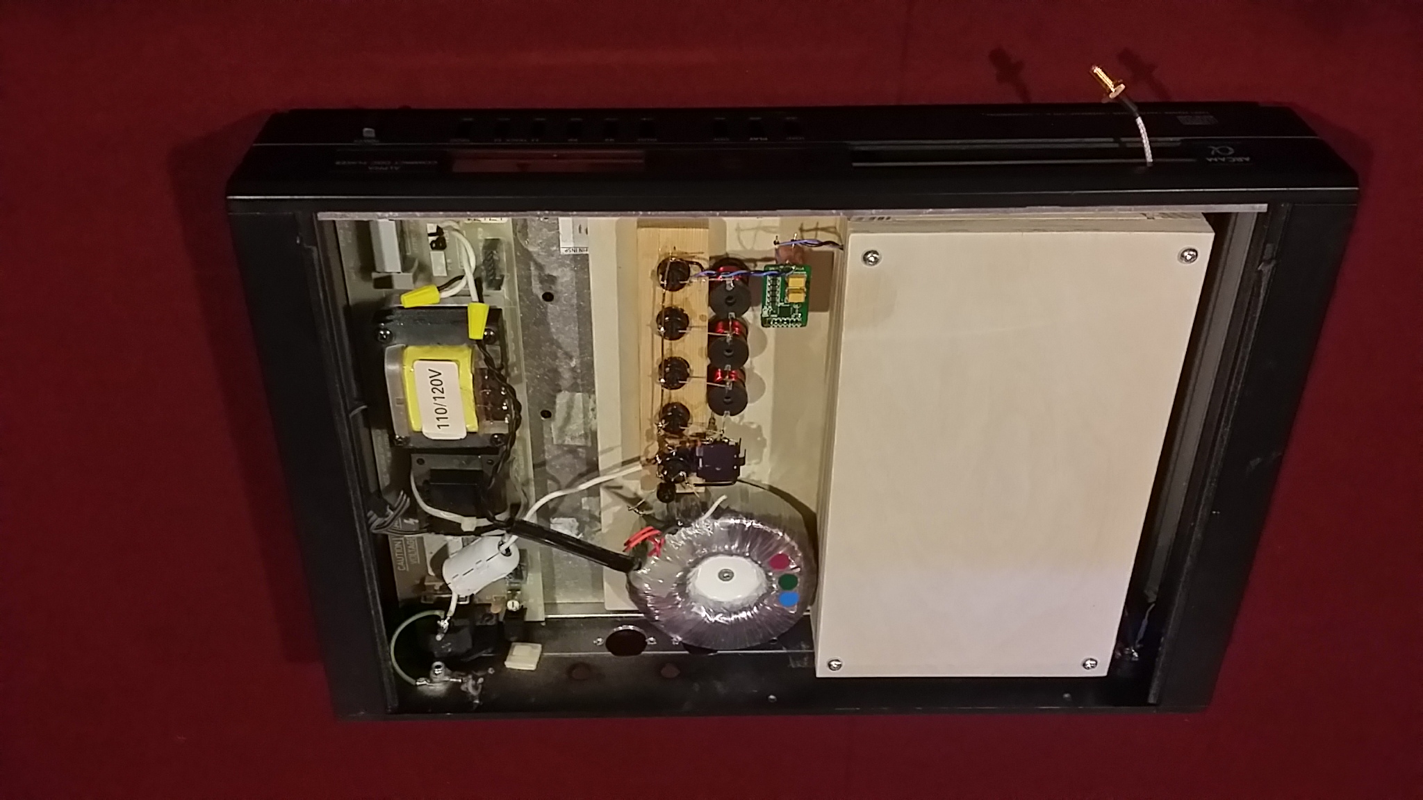

microphonics of board and crystal
Nice testing Joseph K
That is precisely why I did my best to isolate the crystal, and the board.
Crystal is mounted in foam block.
board mounted on foam
board covered with layer of sand
whole thing is in a wood box
box is on silicon inside alu chassis
alu chassis on foam

What multitone was that? The spikes appear to be even multiples of 50Hz (mains frequency in yours and your “we” country.
It is the "Speech" range multitone signal from Arta. And yes, it starts like
"Linearly spaced sine signals from 100 Hz to 500 Hz, plus 1/3 octave
spaced sine signals from 500 Hz to 8 kHz. Phases optimized for crest
factor 10 1 dB."
