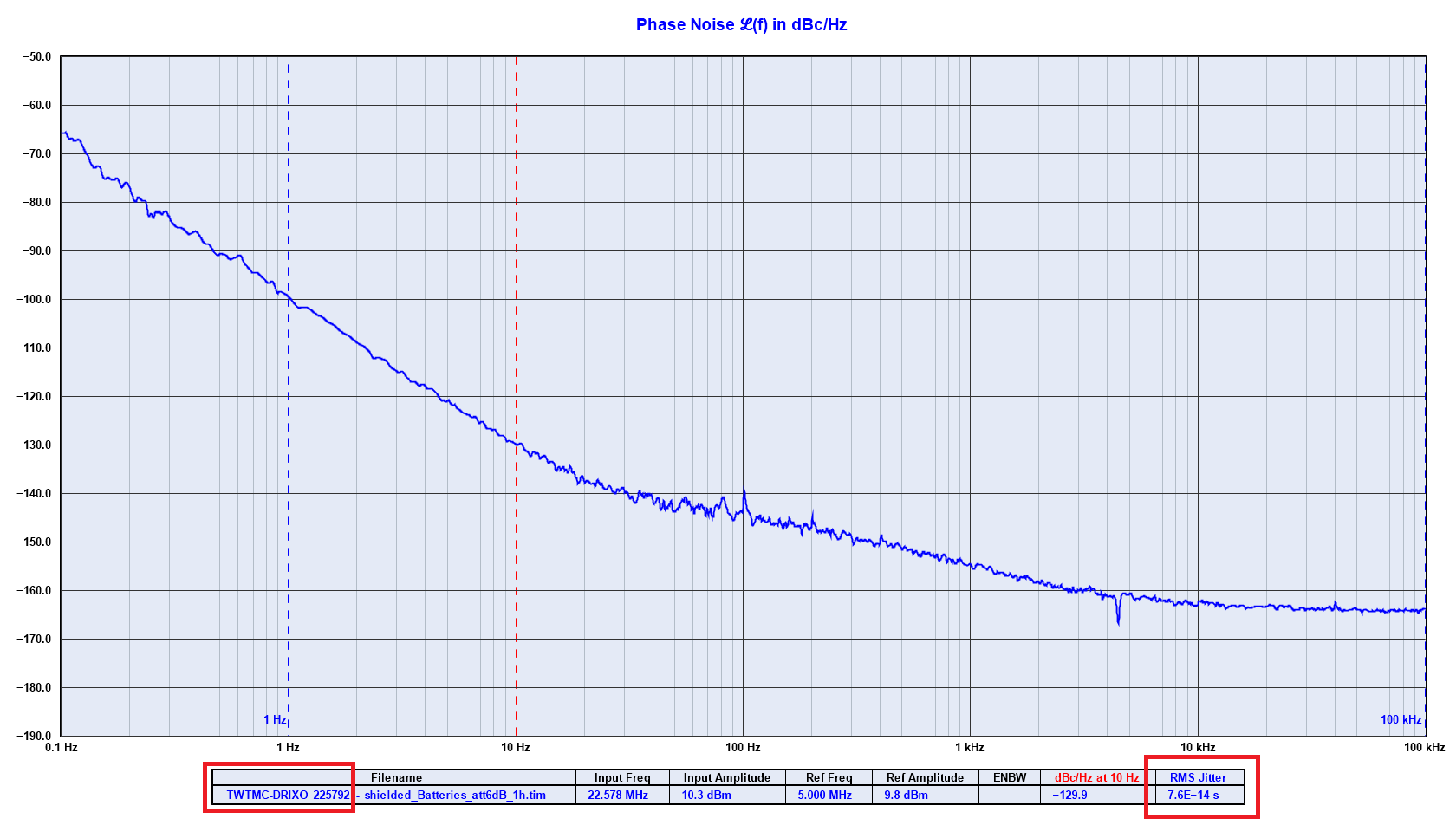

In the meantime I had made a ~first measurement of the TWTMC DRIXO 22,579MHz clock.
In isolation, both thermal and mechanical.
There is that upper range resonance, which I left in here, because for optimizing for that, I should dismount, experiment (with grounding, schielding, it's an interaction between the oscillator and it's environment. In the Hammond box it appears to be less)
Also, here the first time I have started to note the importance of a good power supply. Present shot was taken with a TPS7A4700, 15V regulator.
Mechanical vibrations to be excluded.
If these requirements satisfied - - I see an optimal agreement, again, with Andrea's measurement, in the low frequency, close-in zone..
There is a deviation in the 100Hz region. I feel that "hump" in that zone appears in Andrea's, Roberto's and lastly even Gerhard's measurements, so could it be a kind of feature of the Timepod kit used..?

Interesting Joseph K
Can I assume PS was a well filtered linear supply with a TPS7A4700, 15V regulator? I use Linear PS/TPS7A4700 set to 16.5V. That would confirm my assumption that there is little to be gained by using a battery at 16.5V vs the TPS7A4700 regulator. Is that a reasonable assumption?

Yes, I am using a linear (lab) PS /TPS7A4700_15V config. I did try a Pb battery, 12V, but I got sligthly higher noise floor) (very probably because if the lower PS).
Earlier on I did try to look for PS voltages between 15V--17V, and did not see great differences..
I measure 69mA PS current.
Thanks Joseph
I note that your test and Andrea's appear to show the same results. His was tested at 16.5V using Lithium PS and yours at 15V with a low noise reg. Seems to confirm phase noise not materially impacted by the battery supply. Then we'll soon have Doede's subjective report based on a supercap based supply. Useful for those still planning their build.

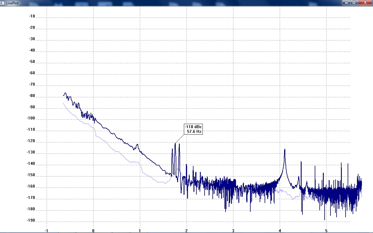

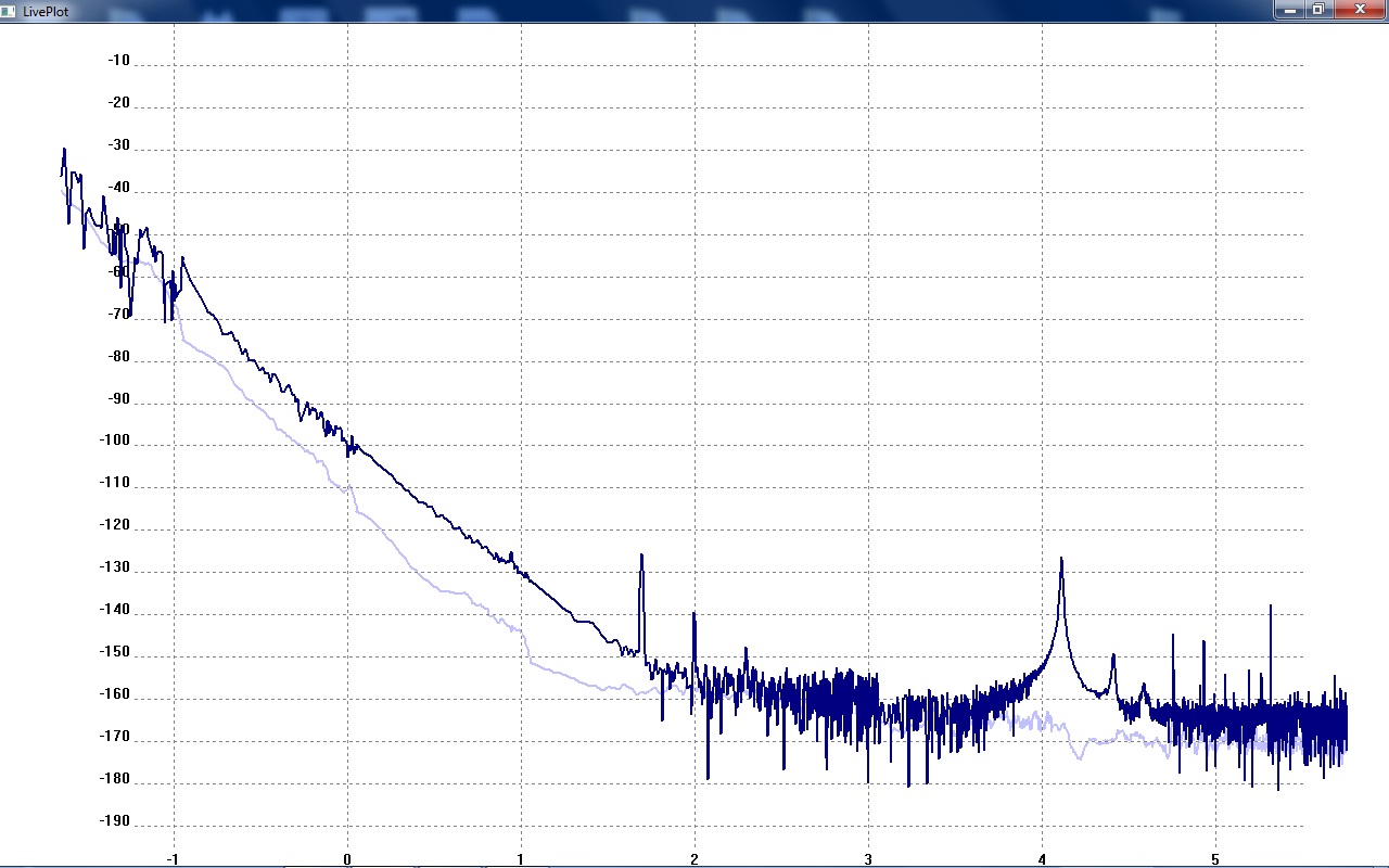

Now.. Only for fun!!
I have noticed that Andrea's design is somehow sensitive to vibrations. I did have to try to isolate, because low freq rumble (~cars passing outside..) did have an influence on the response..
So it came the curiosity, how do it react (in this, isolated way..) to acoustic excitation?
Achtung, very far from scientific trial..
just a speaker placed at ~1m from the table with the setup+oscillator. 4W power, series of single 57Hz, 70Hz tones played. Speaker is about 85dB sensitivity. 4W neans 6dB +, so we are at about 91dB level. +_, !!
Those microphonics could be from the circuit board, components and transistors as well as the crystal. Anyplace where you have a higher impedance and a voltage bias with some capacitance a little flex and you have a microphone. The modulation is -118 dB below the capacitance being modulated, so not much.
