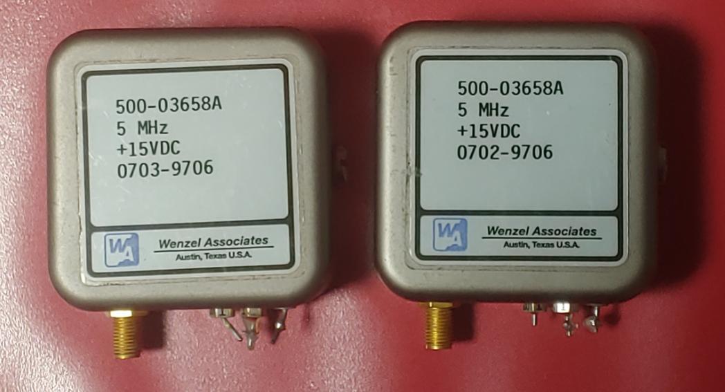

While I have the Timepod and two carefully selected Wenzel oscillators for it ready I have been way too busy to assemble the pieces.

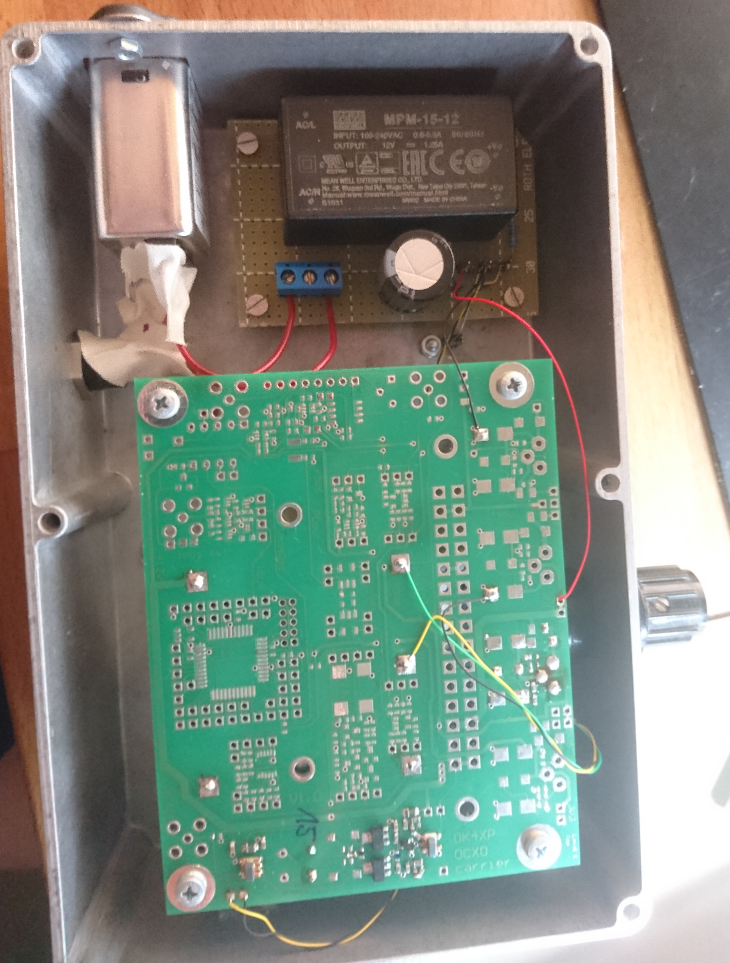

It is funny that in a field of half a dozen 5 MHz oscillators the one with the
digital €12 Mean Well power line switcher has the least birdies and the best PN.
Sorry, no Lithium and no 3 cascaded regulators.
There is nothing but a power line filter, an added electrolytic and a 10 turn pot
connected to the oscillator's Vref and Vtune to pull the frequency a few Hz.
The OCXO carrier board is only there for the mechanics and the push-pull
17 dBm amplifier.

I did not do that with mine but make sure they cannot injection-lock
each other. That would make the 3-cornered hat meaningless since
they were no longer independent.
