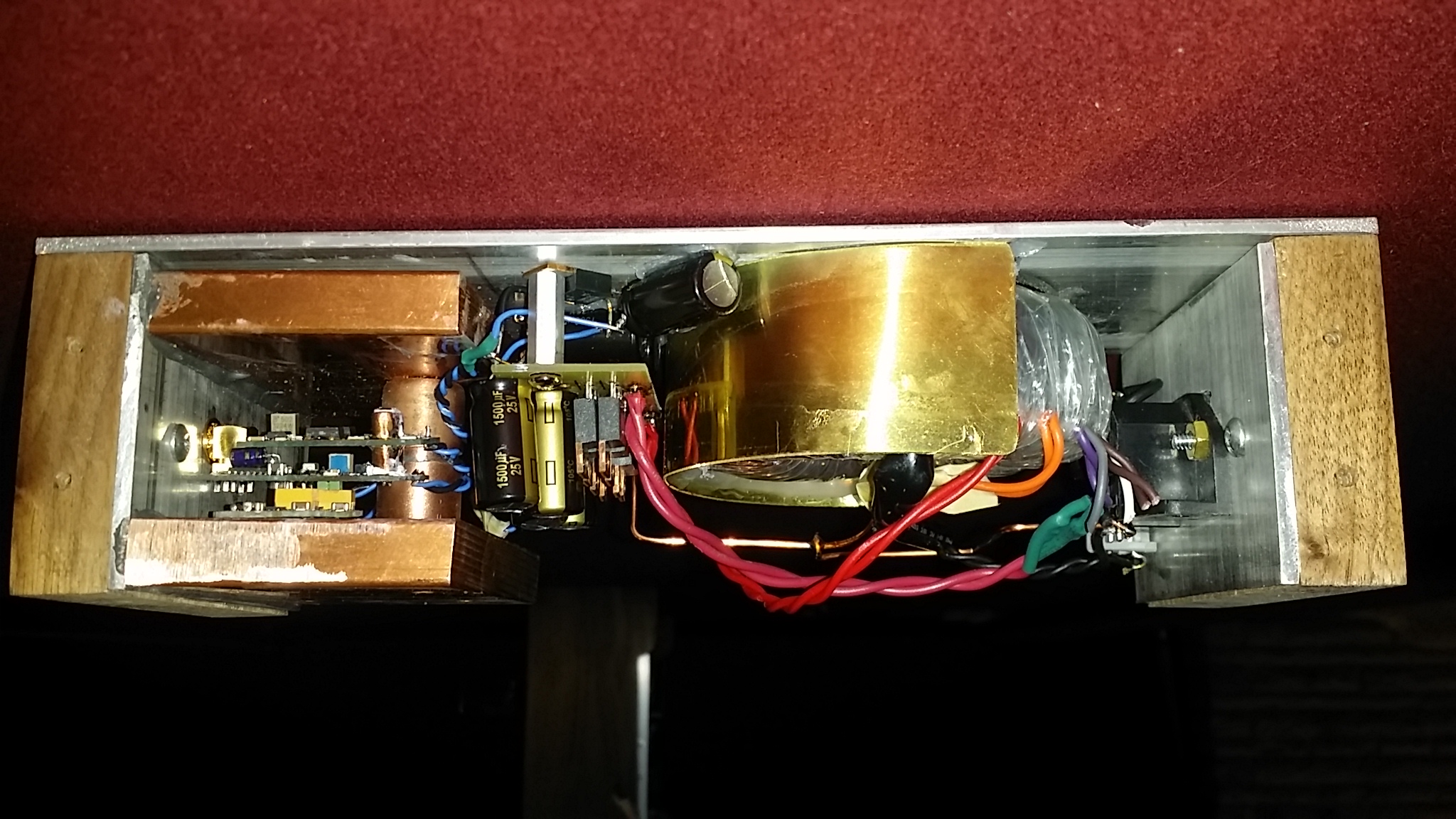

I can relate. My 45MHz clock is encased in 1/2 copper plate and then filled with sand. I have no way to measure it, but adding the sand definitely knocked my pleasure meter up a few notches.N
So the whole pcb is buried in sand?
PCB in Sand?
With Andreas initial 45MHz WTMC, the oscillator and squarer are on one little pcb and a second pcb heats the oven. There are two power supplies required which I did with low noise regs hardwired to the base pcb. I didn't want to cover the oven as its a little finicky and might melt. So the sand filled up to cover the regs to the base of the pcb. see first 3 pics.
With the 5MHz DRIXO I mounted the crystal inside a little foam block, put the pcb face down on a foam block with cutouts and then put a layer of sand over the whole PCB. That assembly was in a hard wood structure, mounted on silicone in an Al chassis. Last pic

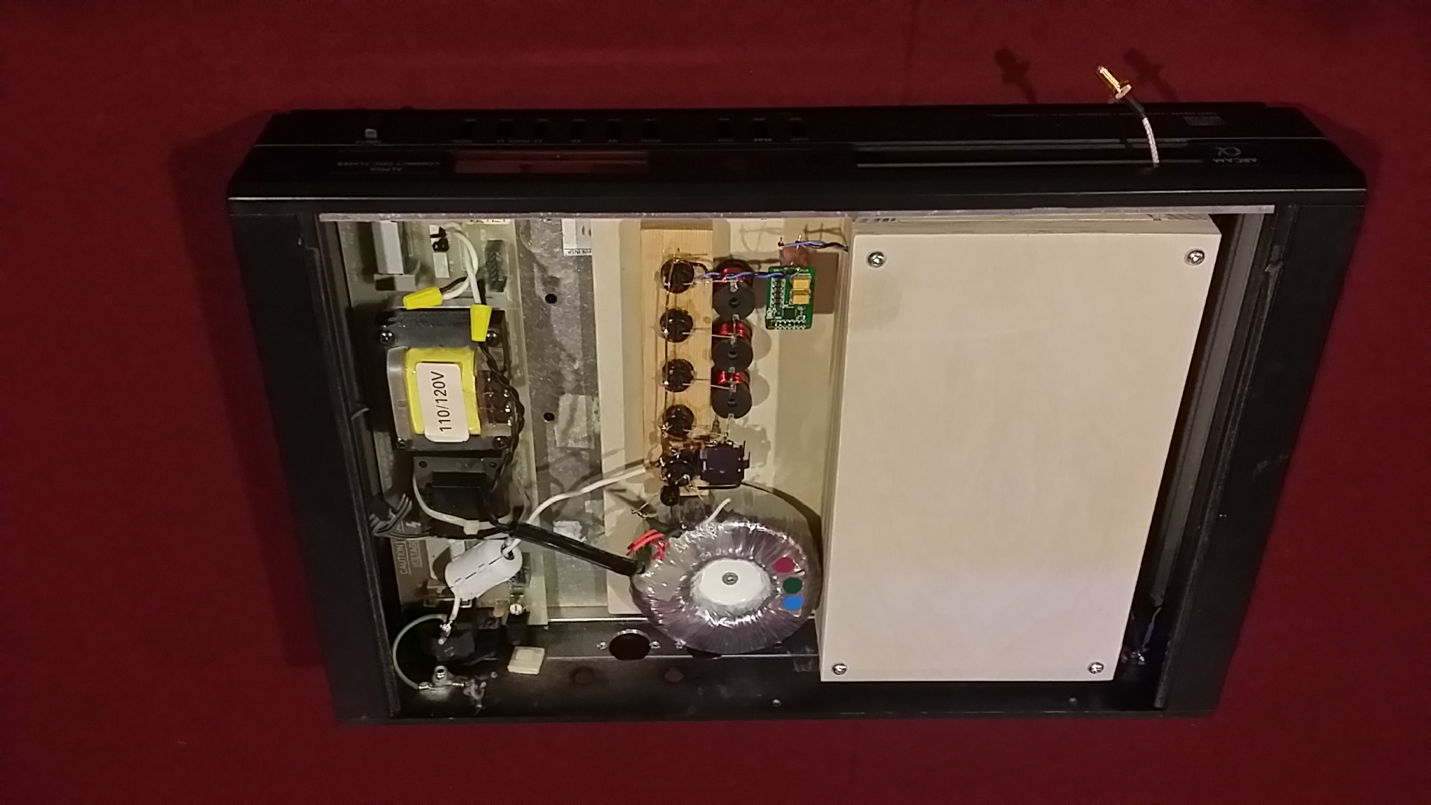

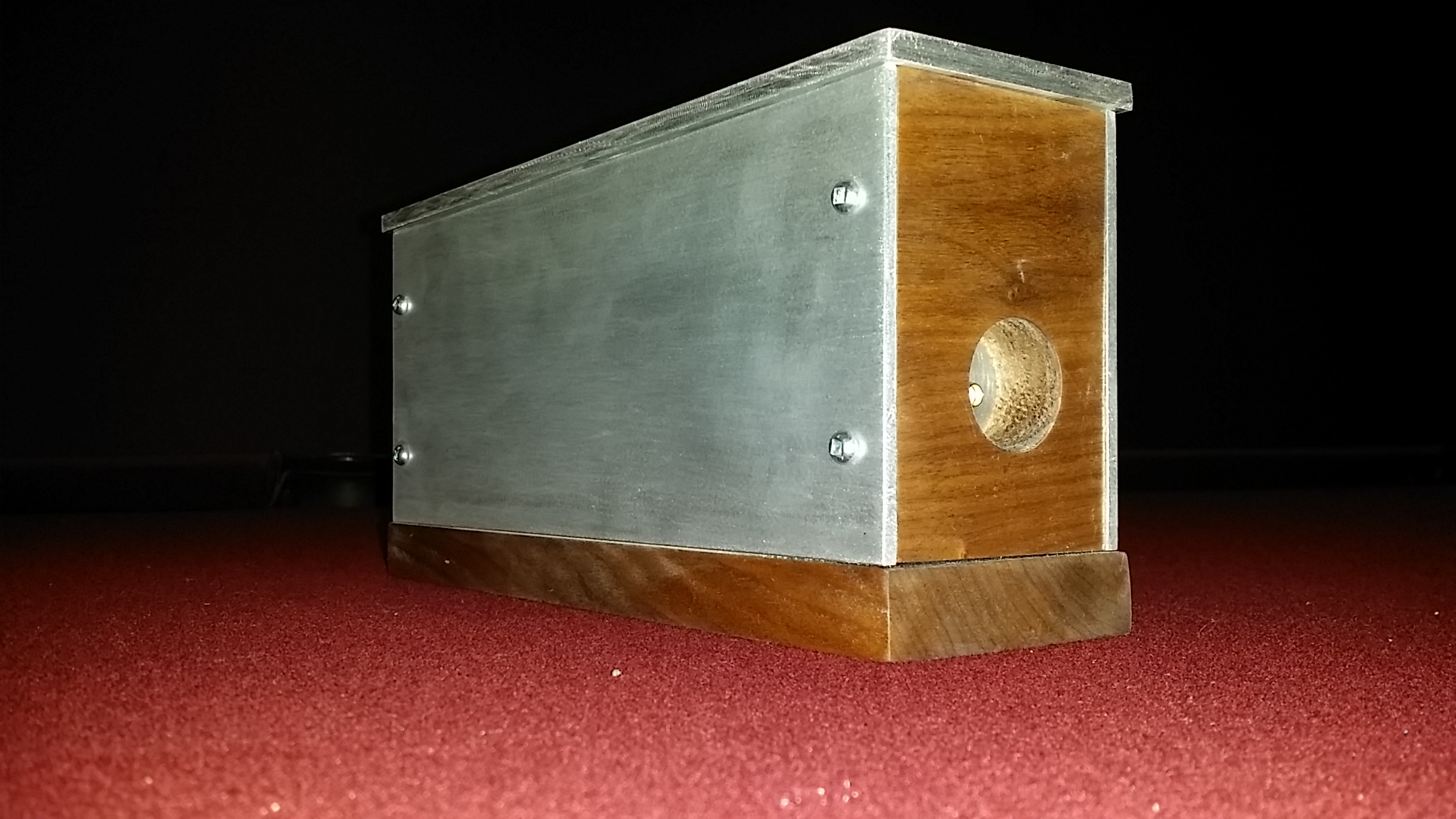

I would defer to Andrea to see if he believes that would be harmful to any of the components.I could fill the Hammond case with dry sand, thoughts on that welcome please?
What I thought of doing was to put it in a light plastic bag and bury it in a shoe box full of sand. If you don't hear a clear improvement in sound, scrap the idea. Idea being you don't want to put stress on through hole components. Also, many could argue that this is extreme and not justified. They could be right. Only way to know is to try it in a way you do not destroy it. So I certainly can't advocate this approach. On one hand we are working with something we value and cannot be replaced. OTOH if it makes an improvement it might be good and there really is no reason to take it out. Kind of like potting a circuit board.
That box is just the clock ?
Yes. Like when you buy an outboard clock for your commercial DAC. 120v in and SMA clock signal out.
