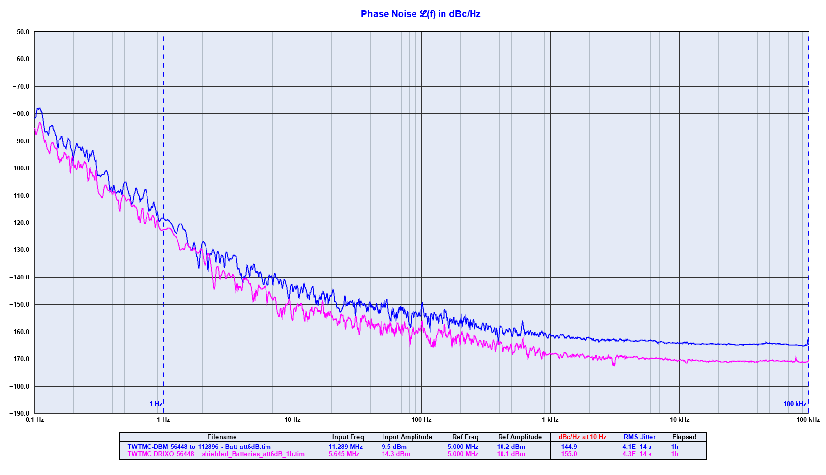

How can success of DRIXO be measured?
Phase noise plots from multiple measurers showing SOTA measurement
Subjective listening tests from multiple people around the globe who actually listened

Hi Chris,
well, let follow the approach "If you don't prove it, it doesn't exist".
We arbitrarily forget that we are not yet able to explain how our brain processes the signals it receives.
In this thread we are talking about oscillators so we have to find a scientific approach to measure an oscillator, or better to define the threshold below which there is no audible difference .
I knows two methods only, phase noise (frequency domain) and jitter (time domain), but I'm open to other ways.
So there are a few questions to explore the unknown:
1) would you prefer jitter or phase noise measurements?
2) if jitter was the preferred way, what integration bandwidth?
3) if phase noise was the preferred way, what part of the noise spectrum?
4) if jitter was the preferred way, what is the audibility treshold?
5) if phase noise is the preferred way, what noise audibility treshold and at what frequency from the carrier?
This is the minimal starting point, without the answers to the above questions no scientific analysis can be pursued.
Now I'm waiting for someone to define the above research parameters.
Andrea

I just do not get the point of these attacks to Andrea's work. He has his own approach to digital audio and a line of products according to this vision is being developed.
First product is the oscillator, and the performance has been published resulting on pair with the best oscillators in the market (Mutec REF SE120) at a small fraction of the price. So, what is wrong with that???
If someone does not agree is obviously free to ignore his work and state his/her opinion as well. But this fierceness seems strange, I have never seen this in any other thread.
This is an audio DIY forum and not the conjecture de poincare demonstration committee. There are Physics and Maths as it should, but not only....
I want to THANK Andrea for his work and ENCOURAGE him to keep on working his way. I consider his products the most interesting in the digital arena right now!

Just a curiosity, how would you measure a DUT better than the tool?
Last time I’ve checked is called “correlation” and your timepod uses it as well.
My Timepod uses 3 cornered hat measurement to measure a DUT better than the reference, not only cross correlation.

It looks like your tool is a little outdated, maybe you could replace it with a modern one.
It's enough obvious that you can't measure a Wenzel BT ULN oscillator.
BTW, although your tool has the limit of 10MHz input frequency, it's not so difficult measuring a 5MHz oscillator.
Just add a frequency doubler and finally subtract 6dB.
I would assume that you are able to do this.
