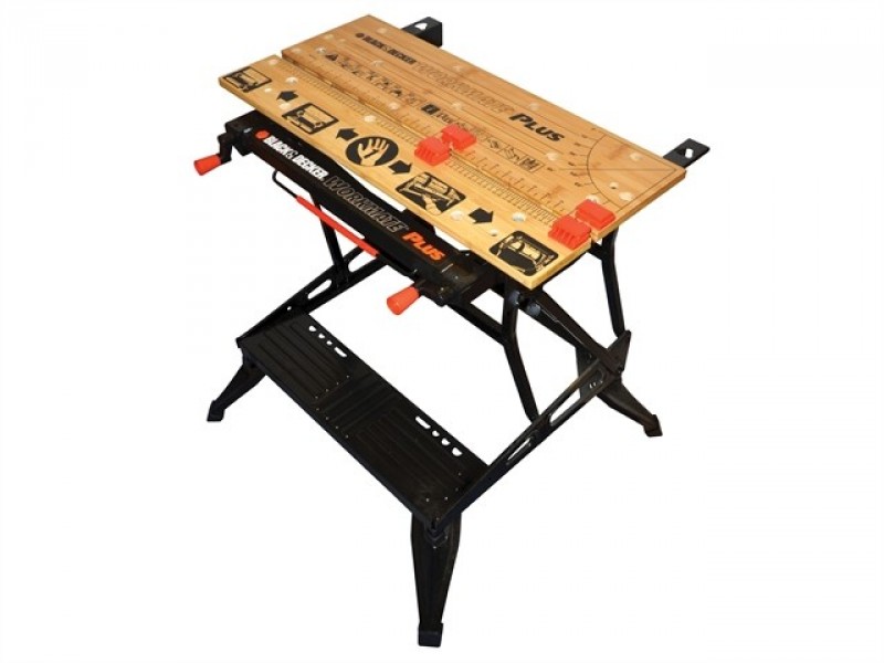

I like where this is going! You can easily cut aluminium with good router bits. I've done it multiple times cutting up to 10 mm thick aluminium. The cooling fluid I used was simply WD40.
Protection is definitely recommended. I used a template and router bits with bearings. I've had lots of those bearing just explode on me. You don't want pieces of bearing in an eye so work safely with gloves, hearing protection and eye/face protection.
In the end I still used the same templates but with a solid construction bolted to my home made table (black 'n decker work bench *) holding a following pin like this:
In close up detail:
* = Workmate used:
Router is upside down clamped in the Workmate and bolted to a piece of birch ply by it's side guide system.
It will cut like butter, just bring the speed of the router down a bit to avoid burning the router bits and cool with WD40. As I had a powerful router with just one speed setting I bought a variable speed limiter to bring the speed down.

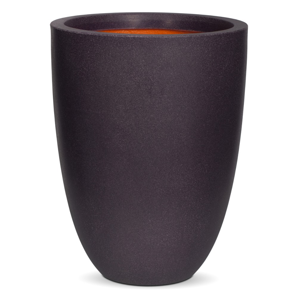

They do this vase planter with the same diameter as the sphere - approx 60L volume.......
Are you going 60L sealed sub with Linkwitz transform?
Title changed.
The new title is helpful, I like the "Synergy horn of spherical proportions". Is that Bushmeister's or your wording Cal?
Synergy horn of spherical proportions (SHSP) sort of reminds me of rodents of unusual size (ROUS) for anyone familiar with that acronym...
I am guilty of the title X! Sorry.
Yep If I perch the spheres on top of the 60L vase planter then I end up with a down firing sub which raises the spheres up to perfect listening level......
