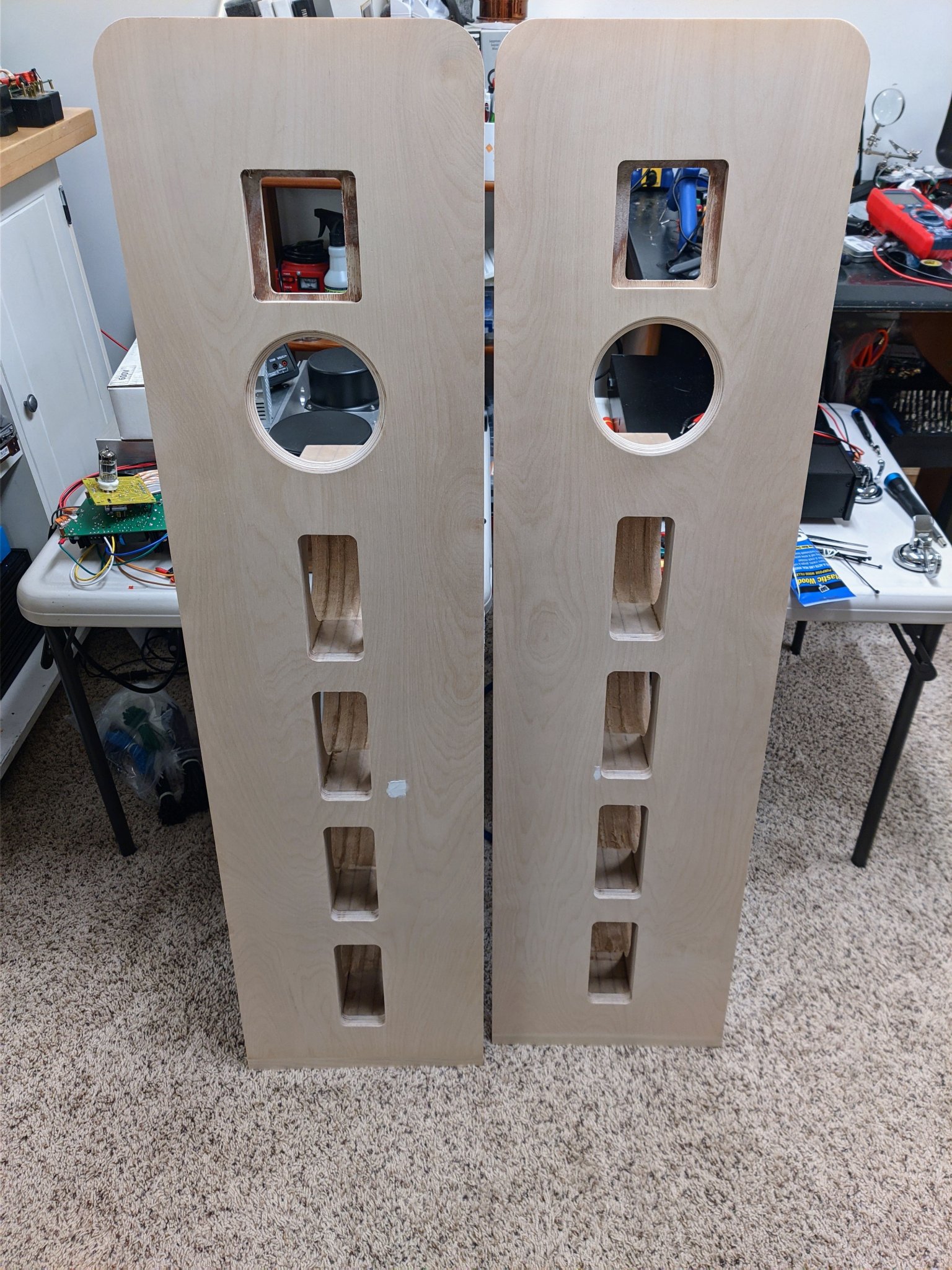

A great day today, my XSD baffles/cores arrived from xrk's cabinet maker. I can't stress enough how wonderful of a person he is to work with and how great his craftsmanship is. As I mentioned in the group-buy thread, I let him know that baffles and woofer cores were major barriers for me, and let him run with that knowledge.
I really wish I would have taken some pictures of the way they were boxed up, he really went above and beyond. I was too excited and ripped the box open like a kid on Christmas. Baffles and cores were glued together already, then one assembly laid face down on cardboard, and the other assembly laid on top of that face up with the woofer cores lined up next to each other. In between the woofer cores was a very thin strip of wood that was probably ~8" wide, with an MDF circle cutout from the woofer cores glued on the top and bottom on opposing sides. This was used with some strips of wood and very long bolts to lock the baffle/core assemblies in place. Follow that up with some plastic wrap all around the speakers, and two UPS store boxes cut and glued up to snugly fit everything. Unfortunately UPS did put a little dent in one of the baffles, but I am fine with that as I intend to paint the speakers semi-gloss black with a gloss clear coat on top of that. The nick was not deep, not large, maybe a 1cm square, and definitely nothing a tiny bit of wood filler can't take care of in a jiffy. At the bottom of each baffle there is a strip of wood glued on to take the hassle of a 5 degree angle out of the picture for me. I honestly did not even think of this, and something that will probably save my skin in the coming days. Thanks to that all I need to do is cut some wings and a platform for the speakers to sit on. Easy right? 🙄

Don't worry, I didn't forget to take a picture 😉

The cabinets look fantastic! I used thick self adhesive felt feet that are used for furniture. That lets me slide the speaker around on my wood floor. The spikes you linked look great and would indeed allow height adjustment. Note that the PRV midrange should be the 8 ohm variety not 4 ohm. The one I have was labeled 4 ohm mistakenly at the factory. I had ordered 8 ohm and it measures as an 8 ohm. The 4 ohm would be very different with regards to the crossover. I used a black Sharpie marker to color over the PRV logo on the cone.
Thanks X! Good catch, I did order correctly, but in haste I opened a new tab and hit "PRV" which auto completed to a page for the 4 ohm. Hope I didn't mislead anyone!
