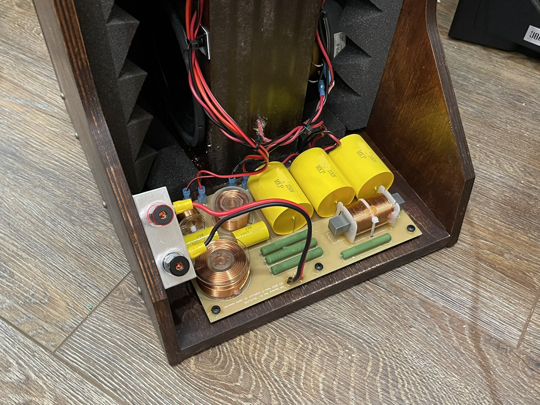

I wanted to ask about the acoustic egg crate foam used on the inside of the wings. X, how did you affix it to the wood, hot glue I assume? I've mounted egg crate paneling with 3M poster mounting strips and it was not a great long term solution. Although far more costly, how would something like dynamat or noico work in place of the egg crate foam?
I used double sided tape initially but that wasn’t very secure. I used hot melt glue for best results. It needs to prevent hard surface reflections so Noico won’t work. You can use thick felt or melamine sponges too. The melamine is probably best. BASF Basotect melamine foam in grey color would be ideal. It might work well without it for you - give it a listen.
I did not use a gasket for the woofers. The seal between wood and bare metal frame was good enough given the large open slot on the front. I did not recess the woofer. If you do, it’s not going to adversely affect the response due to volume change. The upper end falloff is mostly dictated by slot depth.
Slow going but I've begun. I have a week of warmish weather so hoping I can get some significant work done on them. My tentative plan is to use T-nuts and threaded inserts on the ledgers to mount the wings. On the wings I'll use a forstner bit to inset the machine screws and washers I'll use. I'll probably use some locktite or something similar on the screws just to ensure everything's stable once fully assembled, but I'm intending to assemble in a way so the wings are removable for tinkering, etc, but appealing. Black paint, black inset machine screws. Given that, would a very thin gasket where the wings join the speaker be worthwhile just to ensure a good airtight seal?

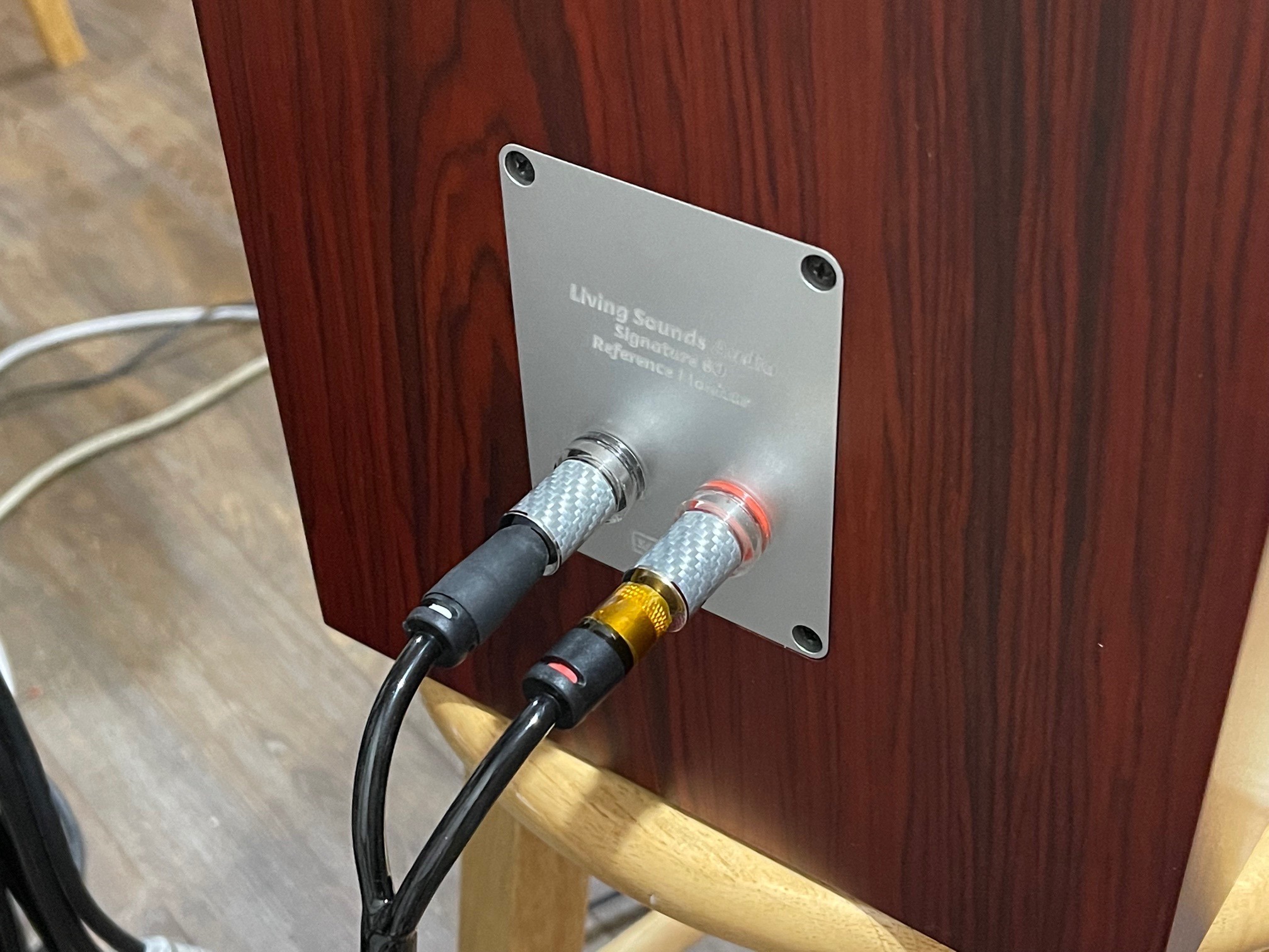

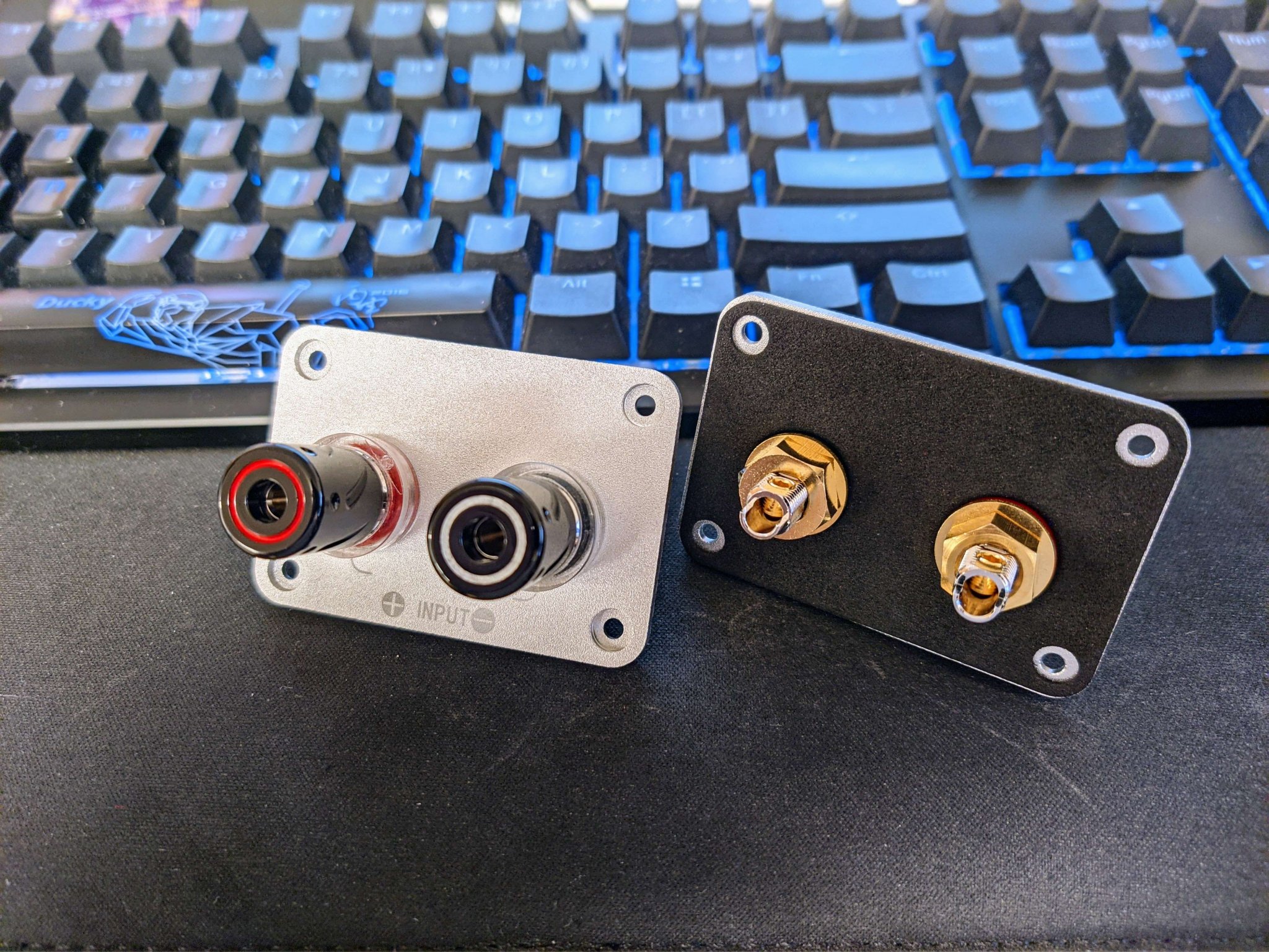

I'm not sure what everyone is planning on doing for binding posts for their XSD's, but I just got these in from aliexpress, https://www.aliexpress.us/item/3256803529393230.html specifically the L65 model, they are roughly 2.5" x 1.75" x 1/8" (not including the foam gasket). I swapped out the binding posts themselves for some nice Viborg posts. Originally I was going to go with a set of plates from parts-express, but theirs were all too large for my liking.
