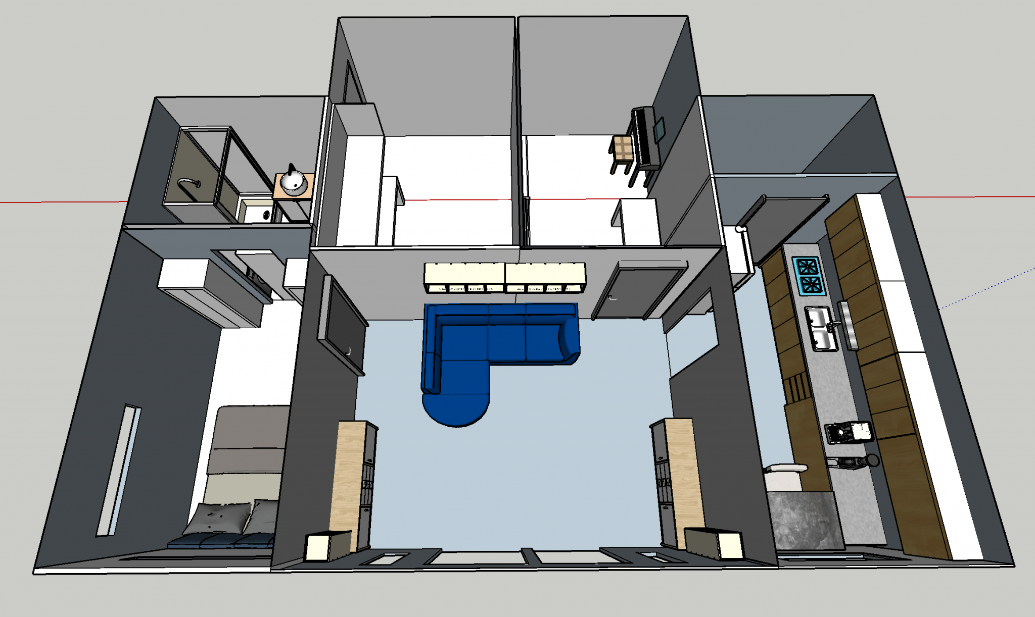

From the way X has described them, I would guess XSD's would work in a space like that. We'll have to get the expert's input thoughAnd, the living room where the speakers will be. It's about 5m x 6m.
Design is far from finished, this is just a rough draft.

Alright, so, your room and my projected living room are about the same. How far from any wall is the XSD? I am still enamored by OB, but I thought this was way too small to resolve it. I'd be happy to be proven wrong!

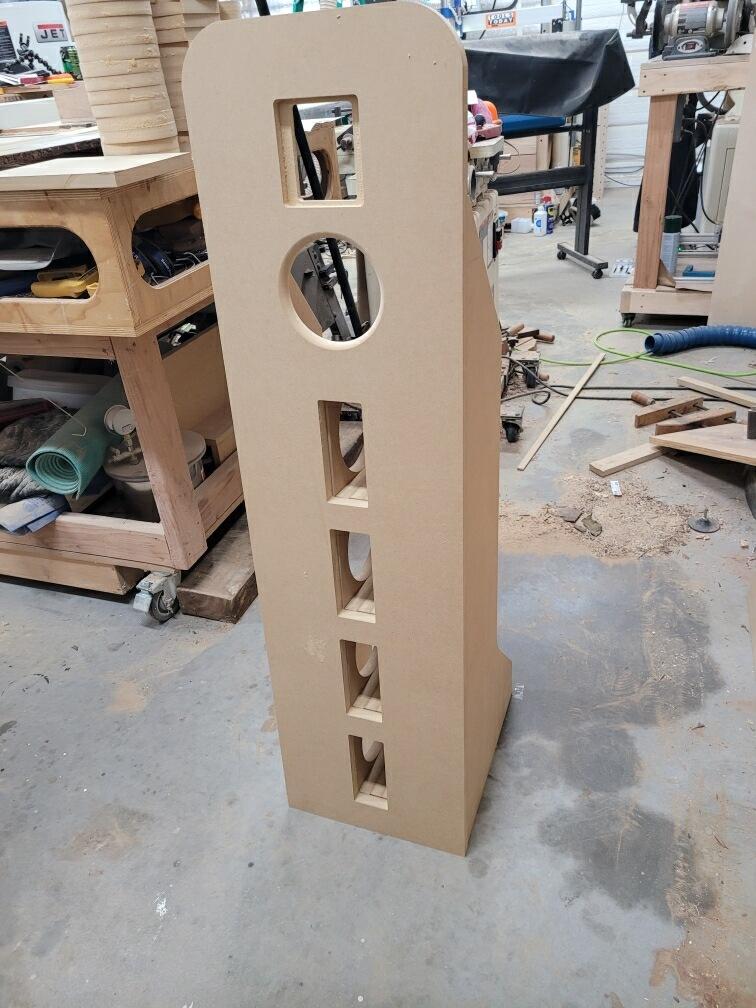

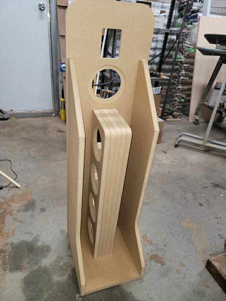

It looks sooooo great, I would be very happy if mine was in this condition!Looking at a variant of XSD in all MDF and finished in a unique texture. All made in USA. Would folks be interested in a CNC MDF flatpack?
I am very happy with how this turned out and to know that it will be made in Texas by a small company is awesome.
