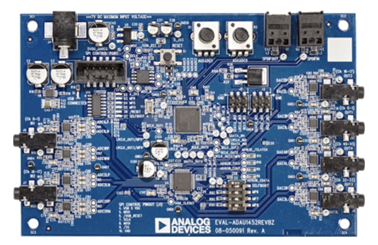

Today, I would go with the ADAU-1452 based DSP and a very good one is the Ev module made by Analog Devices which has analog and SPDIF in and out plus 8 Ch out. Use the free Sigma Studio gui based software - super flexible. It takes a little more work but should be very good.

I think so, the 1462 has more memory. But please check manuals.The board above looks very tempting. Can it do FIR filters? And how many taps would be available?
https://www.analog.com/media/en/technical-documentation/user-guides/EVAL-ADAU1452REVBZ-UG-1662.pdf
The 1452 seems like a great option. I take it since has I2S output all the processing is done before the DAC(s) so one could use two or three DACs, the best one on the mids I am sure but maybe all need to be of equal quality, according to budget allowance.
