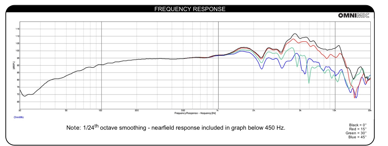

Years ago I built a foamcore tractrix horn and put the PRV 5MR450NDY at the throat. I was doing the usual sweeps to measure response with a mic and REW. After I was done (and I typically do sweeps at 2vrms), I noticed my ears were ringing. It turns out the 10dB horn gain and 95dB native sensitivity hanged up to mean that the sweeps were 100dB+ but it didn’t “sound loud” because the driver was moving maybe 40um - so no distortion. I wear earplugs now when measuring horns.
