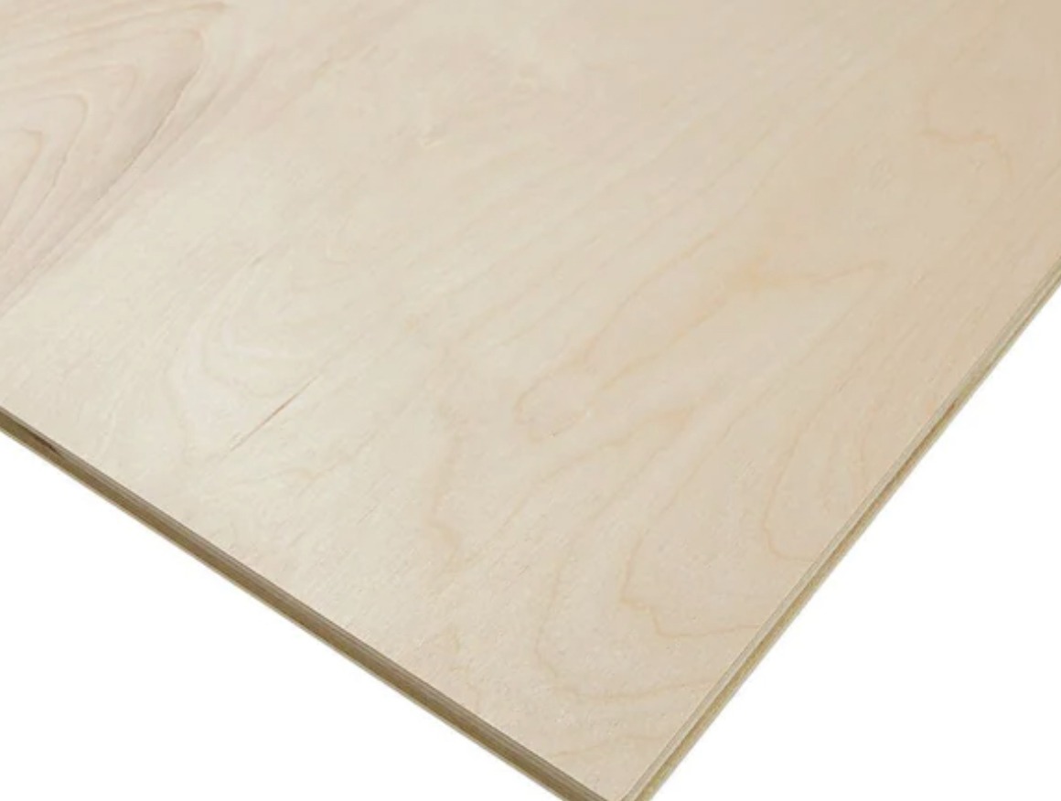

I am having a hard time sourcing Baltic Birch plywood due to war in Ukraine and embargo on Russian products.
Nice option is Purebond brand if birch plywood. Looks very smooth and should be just fine.

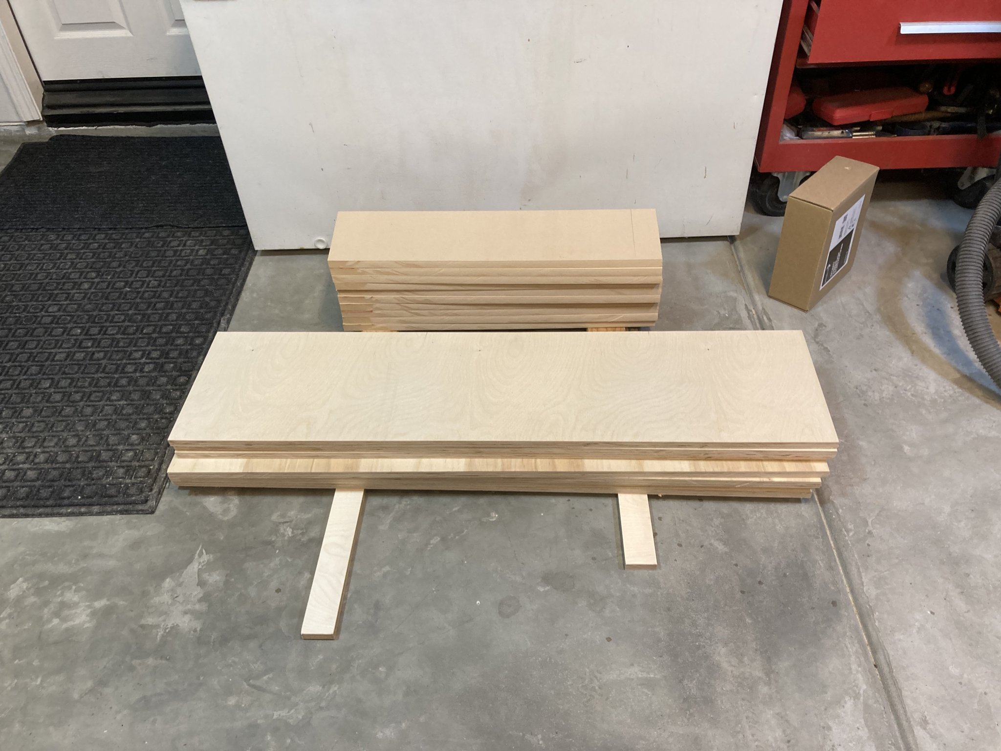

I’m going to get a set made in this new material and we will see how it looks.
Purebond is available at HD. Although I think we will be getting it from a professional lumber supplier. It has external birch facing and internal poplar construction and uses a soy based adhesive vs formaldehyde. Probably not as heavy as all-birch ply but I think should work well and look good. Important that it’s flat and warp free which it appears to be.

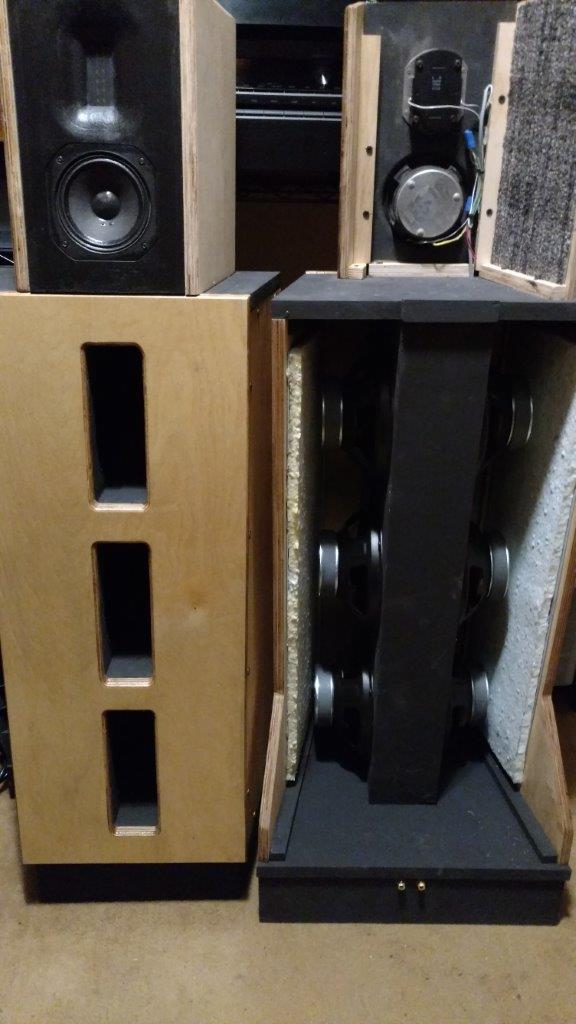

Here is an adaptation that I wanted to try out.
Six 8" GRS woofers, saves a few dollars and has more surface area.
Now closer to 6 ohms instead of 4.
Can't really hear or measure any difference in low end.
Punched the wings out 10 degrees, extra room for bigger drivers, and like GR Research does.
Added a small stand under, Its 3 in higher and the crossover hides there.
Made it two piece so any top could be made to work, and used drivers I had.
otherwise as close to original drawing as I could do.
Mids are JBL LE5, custom CNC wave guide

Very cool implementation Congo5! I like how you separated the bass unit and the top so you can experiment. LE5 is an excellent driver and well suited. Your choice of 6 x 8in GRS woofers seems to have worked. You didn’t put the magnet inside in one side - that will reduce suspension induced distortion.

Have tried it both ways (like you), its easier to wire this way.You didn’t put the magnet inside
