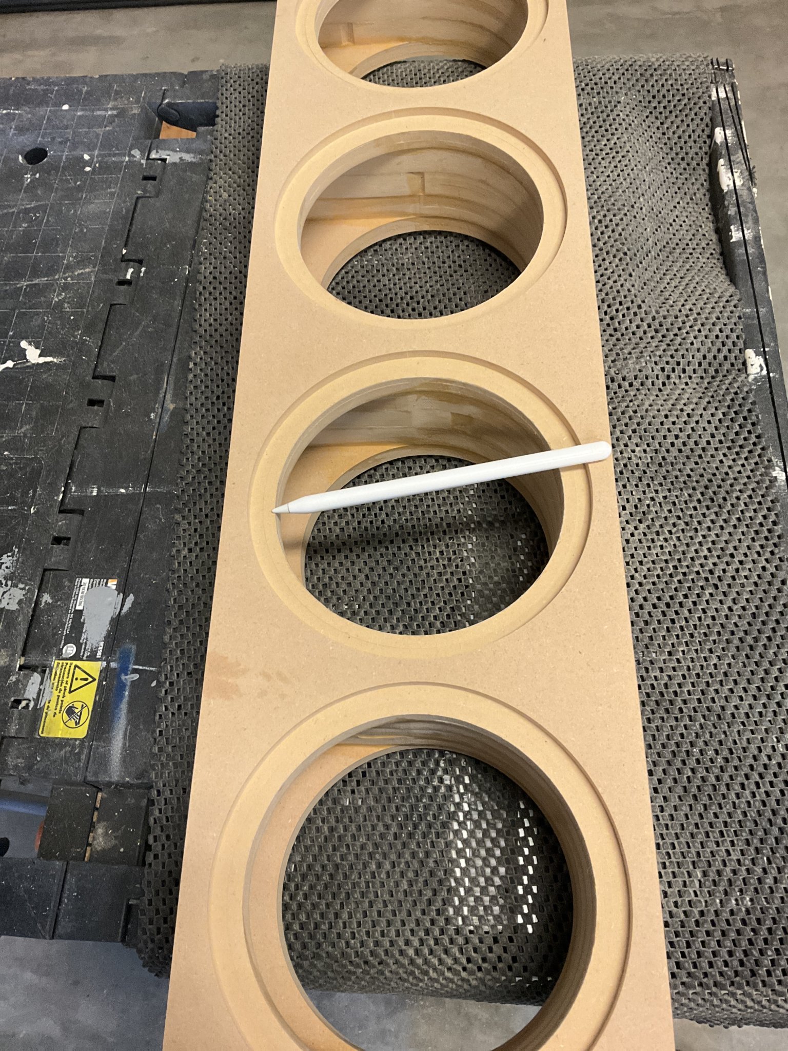

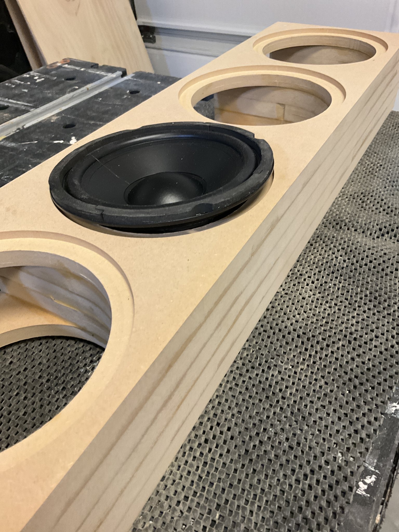

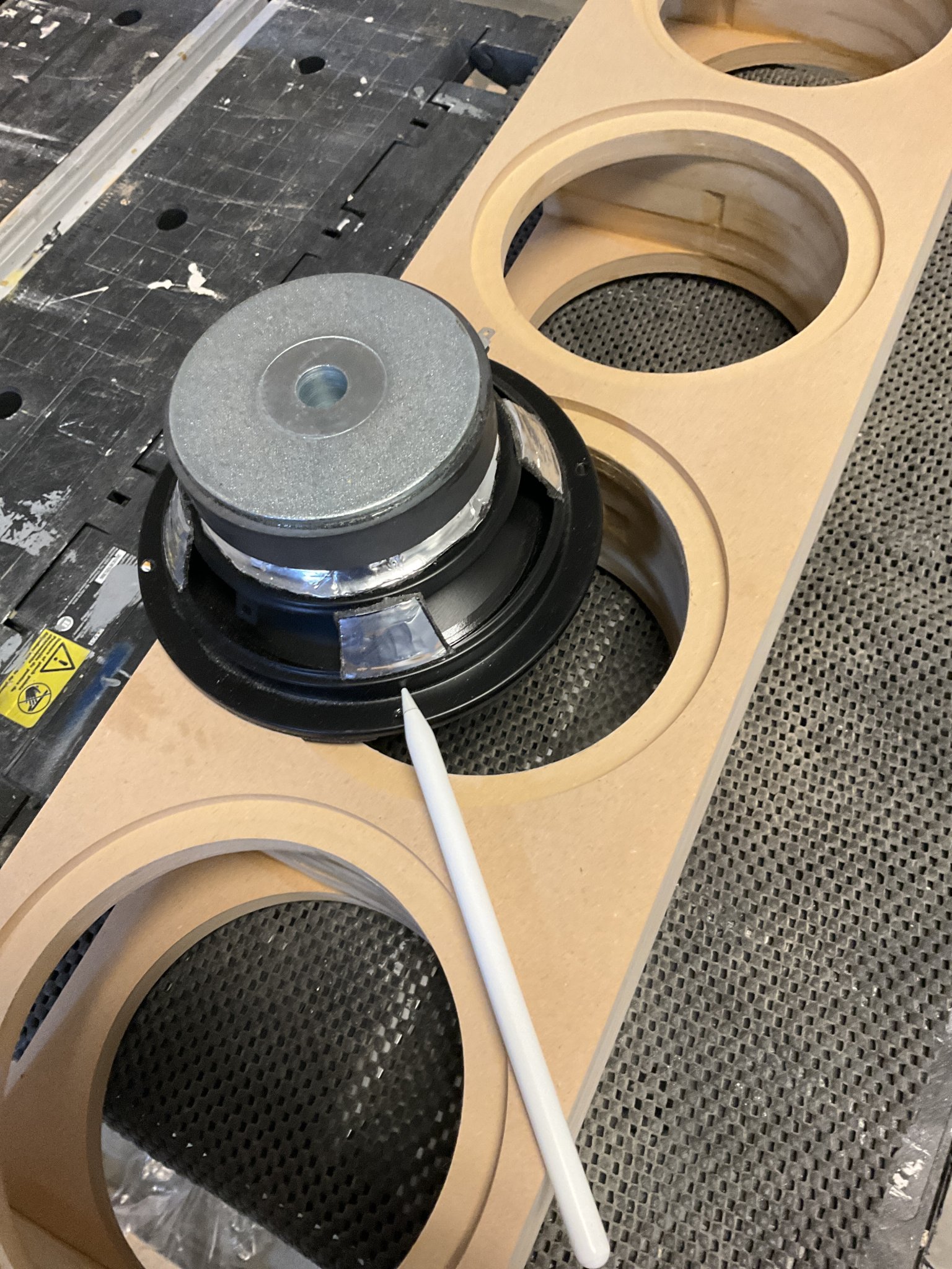

I just went to dry fit the GRS woofer and mark the screw holes, 5.5 inches is too small for the underside of the flange for the woofers that are not mounted inverted. Fortunately I have a spindle sander to open it up and though it will not be as accurate as the original hole no one will see it.
Bill
Bill
I am getting another sample flatpack CNC’d with the birch faced polar plywood (Purebond brand). This time with the correct diameters so that the drivers fit.
