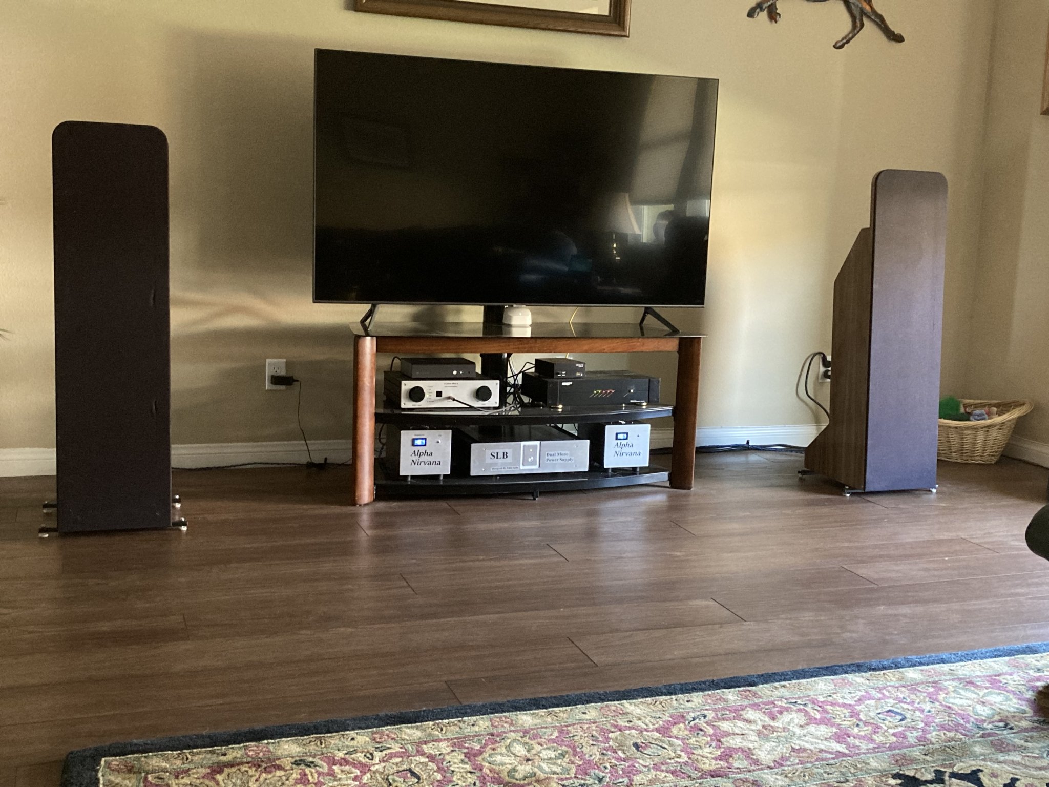

Are there any details on how you did the grill? Very nice appearance, I hadnt even considered a grill. Nice look and solves a few problems.Taking their rightful place in living room.
Thanks all they came out great, grills are 3/8 plywood, stretch cloth on freezer and hold with duct tape and use contact cement.I used magnets to hold them on. One tip I learned when you spray contact cement on plywood frame tape the inside of the cutout. They sound great on the Alpha Nirvana, as they break in the peak around 2K slowly drops out ( 3rd full range speaker for some reason they all had it). Great bass no longer need subwoofer. No longer narrow sweet spot in the room, you can really tell a lot more about how material is recorded nice detail.

The grills do look great, feet as well, makes them look like a high end speaker, which they are acoustically of course!
I do prefer no grills for critical listening and I have made grills out of many things and normally do not use them unless grandkids coming over, etc....
Lucky for me, my wife loves great sound enough that she is fine with no grills or whatever design I want to build

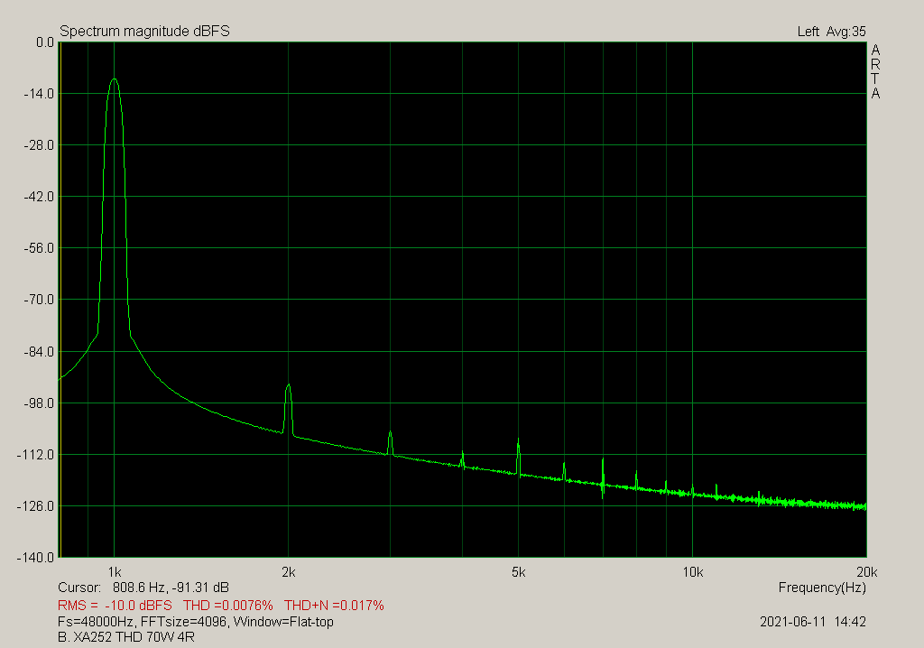

Been getting mine up and running. I concur with WW on comments. Soundstage and imaging is very deep and detailed. Bass is definitely very tight, snappy, and strong. Mid and highs were muted for me in beginning. I agree that maybe the PRV needs some breaking in. Also, the amp I started with was not well suited (SissySit). I moved up to Aleph 30 which improved, and then to a MAC receiver @ 65wpc. This made a huge improvement in the dynamics of the speaker, and now the mids and highs are at their proper level. I've also got an XA252 on my amp list next so l am looking forward to hearing that combo.
That is the amp I am now building. ZM's package is making it's way here, as are power supply caps. Transformers, case and outputs here already. I think it will be perfect amp for these speakers.Been getting mine up and running. I concur with WW on comments. Soundstage and imaging is very deep and detailed. Bass is definitely very tight, snappy, and strong. Mid and highs were muted for me in beginning. I agree that maybe the PRV needs some breaking in. Also, the amp I started with was not well suited (SissySit). I moved up to Aleph 30 which improved, and then to a MAC receiver @ 65wpc. This made a huge improvement in the dynamics of the speaker, and now the mids and highs are at their proper level. I've also got an XA252 on my amp list next so l am looking forward to hearing that combo.
