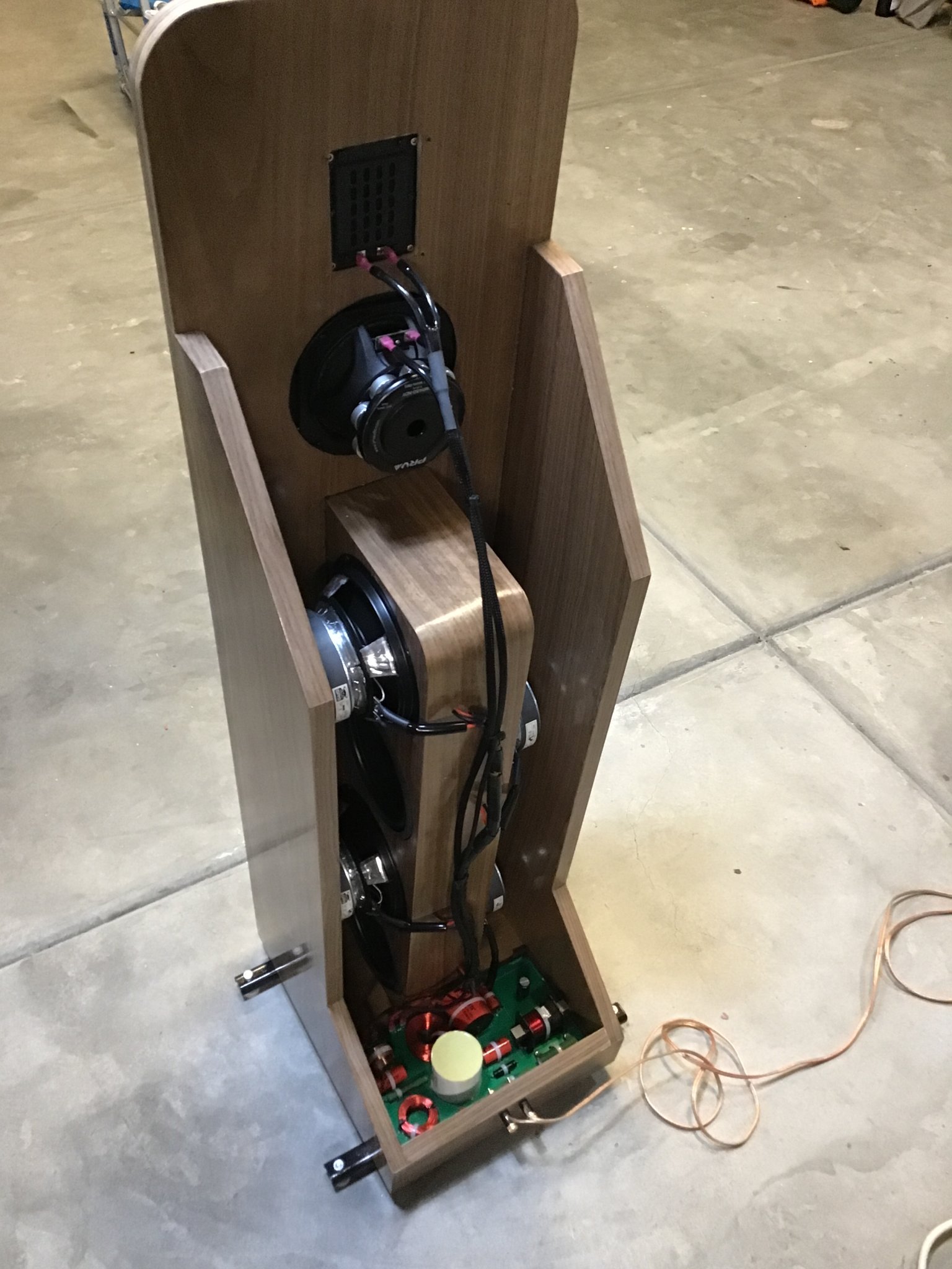

So I finished off one speaker and played some music, and there is no output to the tweeter. I cannot locate my copy of the crossover schematic to ck if I assembled it correctly. Can you email me another copy. I should have the second one finished tonite.

Hi WW,
Nice looking cabinet! Congrats on the build. The XO is a parallel design so you should be able to disconnect the mid and woofer and try to play only the tweeter to see what is amiss. Usually when there is no sound in a path, I will check for either continuity, a short, or lack of return to ground.
With woofers and mid disconnected, what does ohms show between speaker terminals? Should be “open connection” since AC coupled high pass. This is the shorted test. Play a 5kHz test tone and see if you hear it. This is the AC “continuity” check.
Let me know how that goes.
Also, are you doing XO P2P or using the PCB designed by one of the members here?

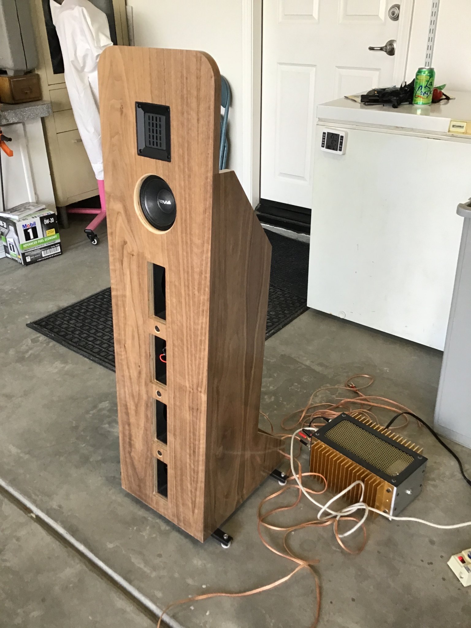

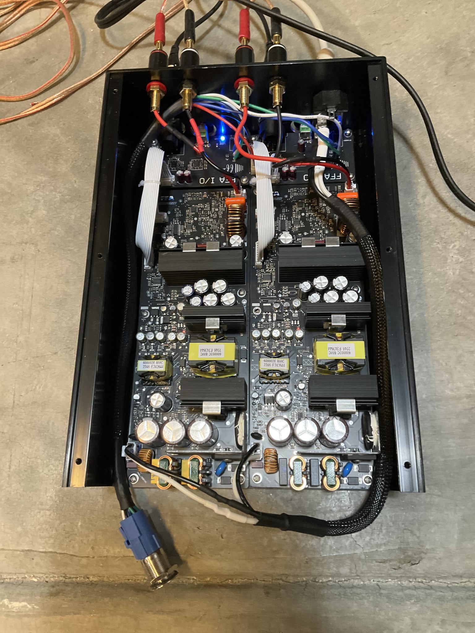

Ok so Adason may have been right, the positive terminal had been painted red. I sanded the paint off and it began working. I think these will require some time to break in. I swapped the little 12 watt aleph mini to 120 watt class D and that improved things as well.
Thanks, they turned out looking pretty good, I tend to get a little impatient with the finish but my veneer skills are improving.I plan on putting a grill on them to make them a little more wife friendly. My endgame amp will be the Wolverine and I think it will be a good match. I am trying not to listen to them critically yet but they do have a different sound but this is my first time experiencing a OB speaker.

I used the printed circuit board, I made my bass motor assembly removable for a cleaner look on the side panels. I was going to hide the crossovers but I think they add to it.
