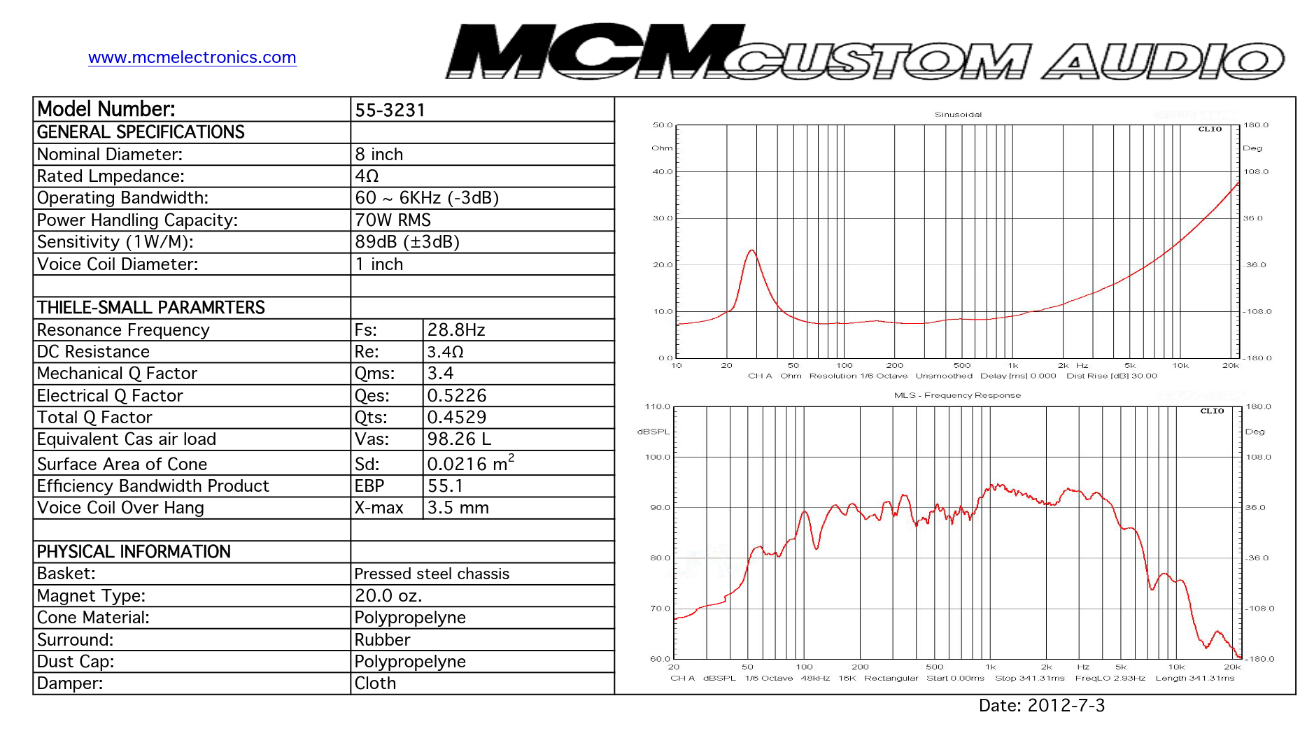

note the significant drop in response even before the Fs, it's down over 15 dB by 40 Hz. Not promising. I don't know what all the factors are that affect a driver's response near it's Fs, but it sure does vary quite a bit from one driver to the next. Presumably things like suspension factor, motor design, etc. all matter, but more to the point, not sure this driver will have real useful bass in an OB arrangement below 50 Hz. At a minimum I'm searching for an arrangement that gets me an F3 of 40 Hz, but I'd really like to see 35, and 30 would be endgame.FWIW, here are specs. It's VD is @ 1.8X the 6.5" GRS.
4 of them would have the VD of 7.2 of the 6.5 GRS.

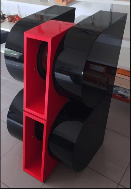

How is that any different than the inside of the slot. The slot channels are half rounds so the sidewalls in the back of the slot are closer than the sidewalls on the back of the facade.The issue I see with this layout is that a significant portion of each cone's movement will be trying to blow past the edges of the front panel. The air impingement on that panel could cause the cone to be loaded unevenly and cause distortion. I would want more free air behind the drivers.
Take a look at the RS225-8 or Peerless SLS 8". They appear to be better, but also come with a "better" $$$.note the significant drop in response even before the Fs, it's down over 15 dB by 40 Hz. Not promising. I don't know what all the factors are that affect a driver's response near it's Fs, but it sure does vary quite a bit from one driver to the next. Presumably things like suspension factor, motor design, etc. all matter, but more to the point, not sure this driver will have real useful bass in an OB arrangement below 50 Hz. At a minimum I'm searching for an arrangement that gets me an F3 of 40 Hz, but I'd really like to see 35, and 30 would be endgame.
The slot channels would at least load the cone roughly symmetrically, and at ~5" there is a fair amount of room looking straight across the inside of the slot. The problem I see is that he's recessed the front edge of each driver perhaps an inch or more "under" the back of the baffle board, and the clearance is very tight to the back of the cone as well.How is that any different than the inside of the slot. The slot channels are half rounds so the sidewalls in the back of the slot are closer than the sidewalls on the back of the facade.
Could always put some channels on the back for some symmetry. Front and backwards facing U channels.The slot channels would at least load the cone roughly symmetrically, and at ~5" there is a fair amount of room looking straight across the inside of the slot. The problem I see is that he's recessed the front edge of each driver perhaps an inch or more "under" the back of the baffle board, and the clearance is very tight to the back of the cone as well.
The bass MDF stack would get a lot thicker and heavier.
Would have to account for the larger diameter of the bezel versus the seating hole diameter.
The picture was meant to give a visual example of symmetric forward and backward U channels, not necessarily the slot width or driver mounting choices based on @Cavedriver 's concerns about front/back loading symmetry.Looks more like stacked ripoles. I think the slob uses the slot loading (around 33% open area) to lower Fs and better couple with the air. It's based on the Heil air transformer idea. The ripoles usually seem to have a much larger outlet.
It has a modern/retro 57 Chevy wing look to it.That’s a complicated but cool looking way to achieve the same thing the XSD bass module does.

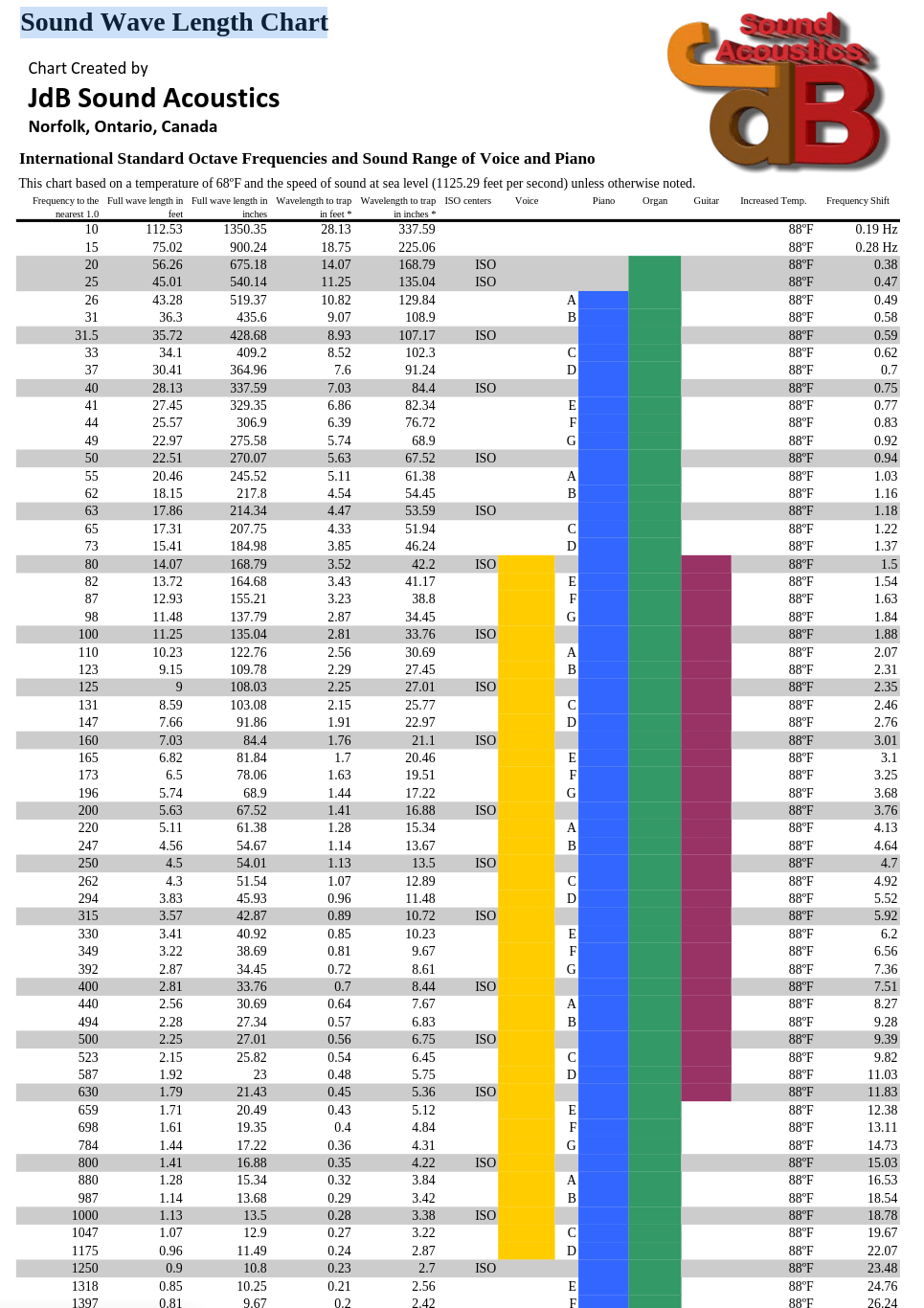

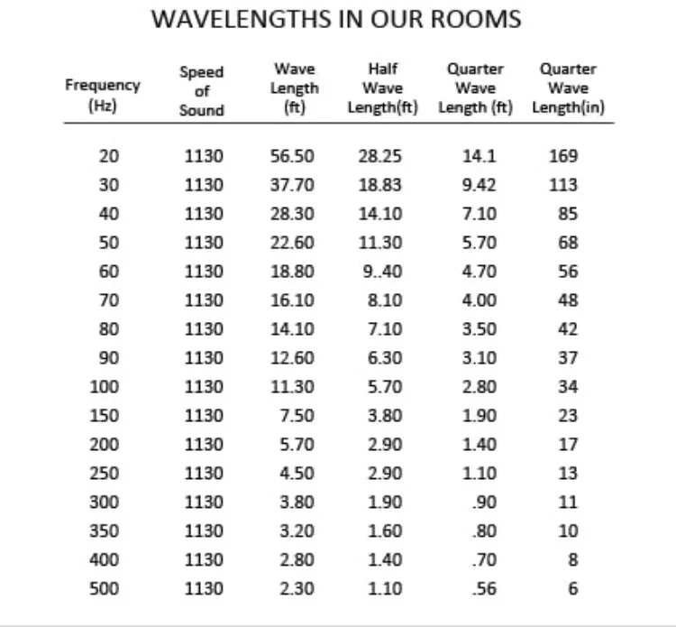

You don’t need all these tables. Just calculate the wavelength using the speed of sound in air. Speed of sound at normal ambient conditions is 342m/sec.
For any frequency in Hz (cycles / sec), divide speed of sound by frequency to get wavelength.
For example, L=(342m/sec) / (50/sec) = 6.84m. The quarter wavelength is usually the important length corresponding to minimum length closed-end to open end TL to sustain that resonance. This is same as a quarter wave trap. Or 6.84m/4=1.71m or 67in. (Matches value of the “trap” in table above). But note that now you don’t need to carry tables around but just remember the speed of sound.
Speed of sound is proportional to sqrt of temperature so a mild sub linear dependence.
The TC18 would work I think from acoustic standpoint - but the frame has a curved plastic bezel meant for topside surface mounting. You can’t mount that to have the cone facing in very easily and get a good seal. Also, the passive XO would not be valid anymore and you could use your own or DSP.
