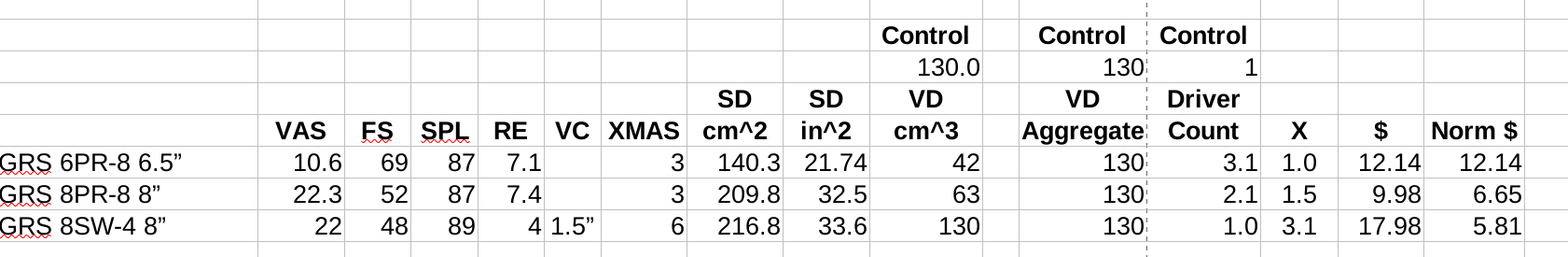

FWIW, I made a spreadsheet of multiple drivers comparing VD (cm^3, SD and XMAS) values to play what-if questions for sizing the SLOB array.
I have a few SLOB related questions.
After reading the thread, there are the 6.5" and 8" HF quarter wavelength cutoffs and 20-40% aggregate SD slot area concerns.
The GRS 8SW-4 8" has 3.1X the VD of the GRS 6PR-8 6.5". Some more expensive drivers (not listed, e.g. Peerless SLS 8" with 8.4 XMAS and 4.3X VD) have higher relative ND ratios via longer throw XMAS.
Are there any concerns about over-driving a SLOB slot with higher VD values ( chuffing, peaks, etc.) ?
Are there any drawbacks for using "subwoofer" drivers with higher ND values ?
Thanks much.

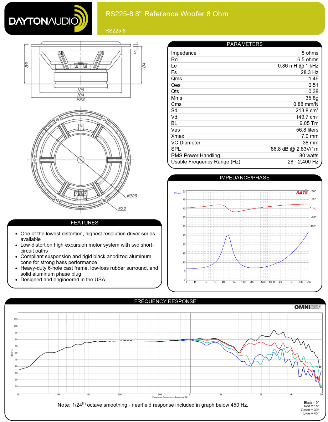

Another potential 8" driver with 3.6X the VD (149.7 cm^3) is the Dayton Audio RS225-8.
It has a lower FS (28.3 vs 69) and supposedly low distortion, but with a higher price tag.
4 of these DA drivers should approximate @ 14 of the GRS 6.5" drivers with respect to aggregate VD.

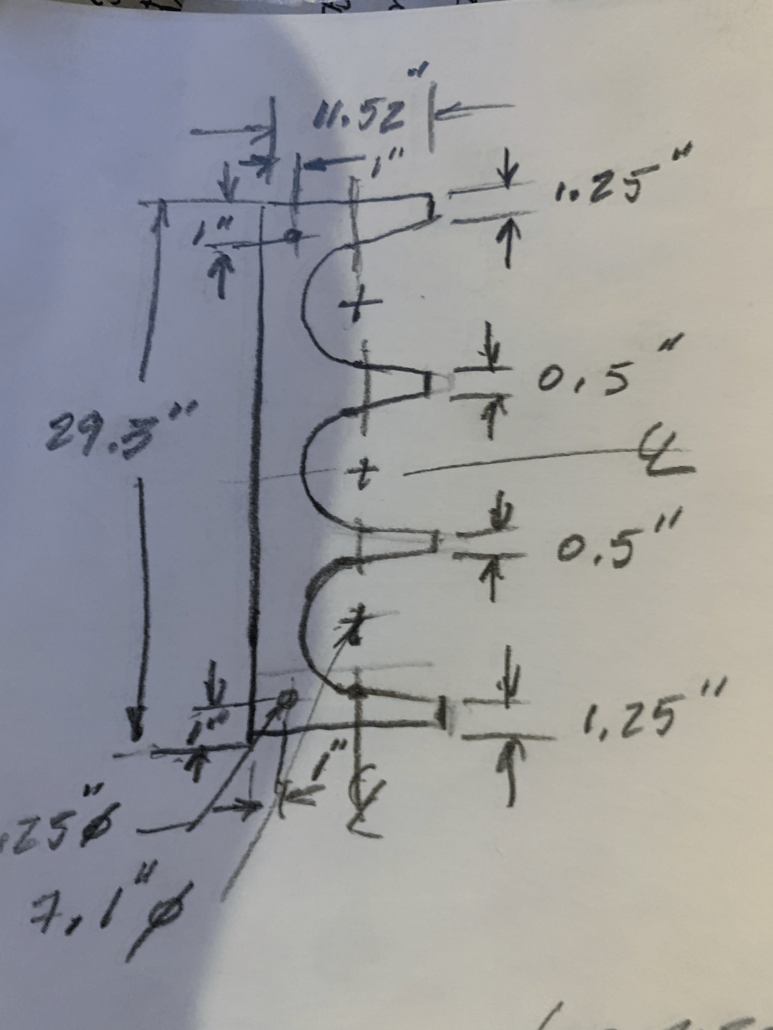

I believe that standing wave issues related to the depth of the slot are what limit the upper frequency at which the bass array can be practically used. However, by making the top and bottom of each chamber flared towards the opening, one could likely increase the upper frequency substantially. I have guy cutting some panels out for me per the attached sketch using 6 Dayton DS215-8 8" Designer Series Woofers per side....Will post back once completed. I only plan to use them up to 80-100Hz but will measure higher to confirm the theory...
RS225-8 can work well. Series parallel 4 gives nominal 8ohms. It has low Qts so magnet is more powerful and can drive the air more authoritatively down to its Fs. The slot depth is deeper though so XO will need to be about 370Hz vs 470Hz. The biggest drawback is that the driver is very flat response well above this range so it’s a shame to only be using it up to 370Hz.

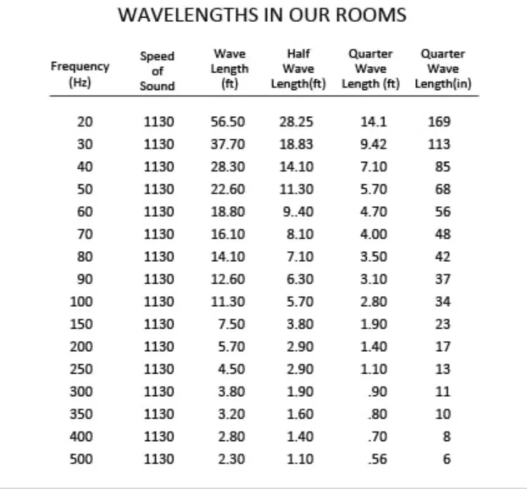

@cab - the 1/4-wave equation is what sets the upper bandwidth. Your slot depth above is about 10.5in plus baffle thickness 0.75in for 11.25in. 11.25in x 0.0254m/in = 0.286m. Since this 1/4 wave full wave is 4x0.286m=1.14m. Speed of sound is 342m/sec so frequency is 342m/sec / 1.14m = 300Hz. This will be a -12dB/octave falloff. Place a -12dB/oct electrical low pass at same spot and you get a -24dB/oct (4th order) filter for the price of a second order.

Thanks for the confirmation on the RS225-8. Do you have any guess on what the noise level improvement would be over the GRS ?
You have documented -50dB to -55dB down @ 50Hz for the GRS.
370Hz should be fine for my application but the option of higher is a nice to have.

This quarter wavelength chart is useful....

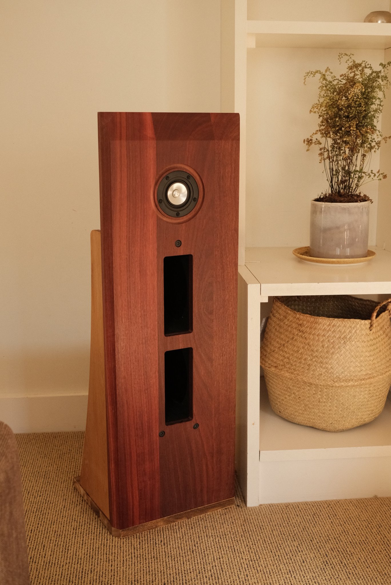

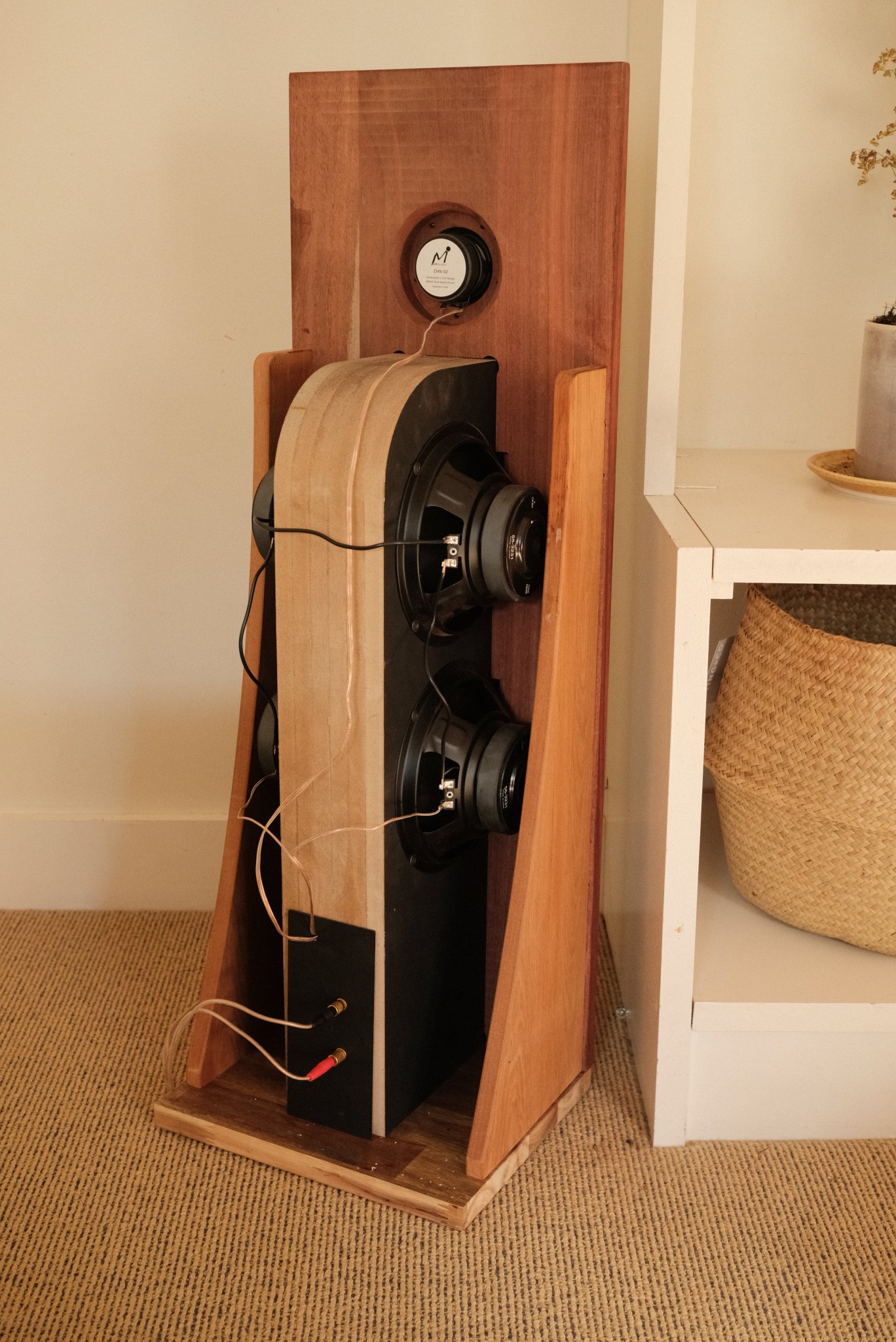

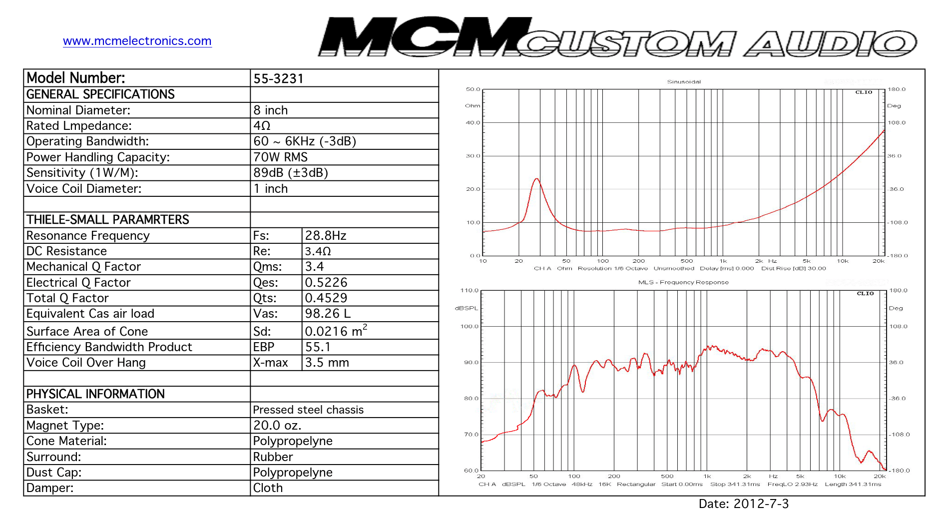

The MCM 3231 only has an xmax of 3.5 mm, so not much more than the 6.5" and 8" GRS woofers, which are both 3 mm. It does, however, have a much lower Fs so I'm wondering how much lower the extension on this design was? Earplay indicates, "it's not the last word in bass", but what is? Could we see an F3 of 35 Hz? 30 Hz with DSP perhaps? Thinking about 6 of them per channel on a separate amp with DSP to drive the nominal 6 ohm load for 2P3S wiring.Thanks - they certainly look better than my previous open baffle monstrosities, which was the main appeal. It's all modular so I can disassemble and try a different top driver one day.
Mostly built in the last few days, had some reclaimed mahogany I'd been dragging around for years so figured it would suffice - super heavy, and machines up nicely.
Woofers are MCM 8 inch model 3231 (I think). Currently passive crossover circa 3-400hz, but needs work!
FWIW, here are specs. It's VD is @ 1.8X the 6.5" GRS.
4 of them would have the VD of 7.2 of the 6.5 GRS.
The issue I see with this layout is that a significant portion of each cone's movement will be trying to blow past the edges of the front panel. The air impingement on that panel could cause the cone to be loaded unevenly and cause distortion. I would want more free air behind the drivers.It is @Earplay2020's build starting with post #12.
