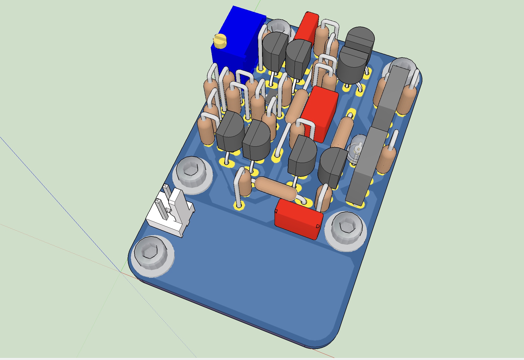

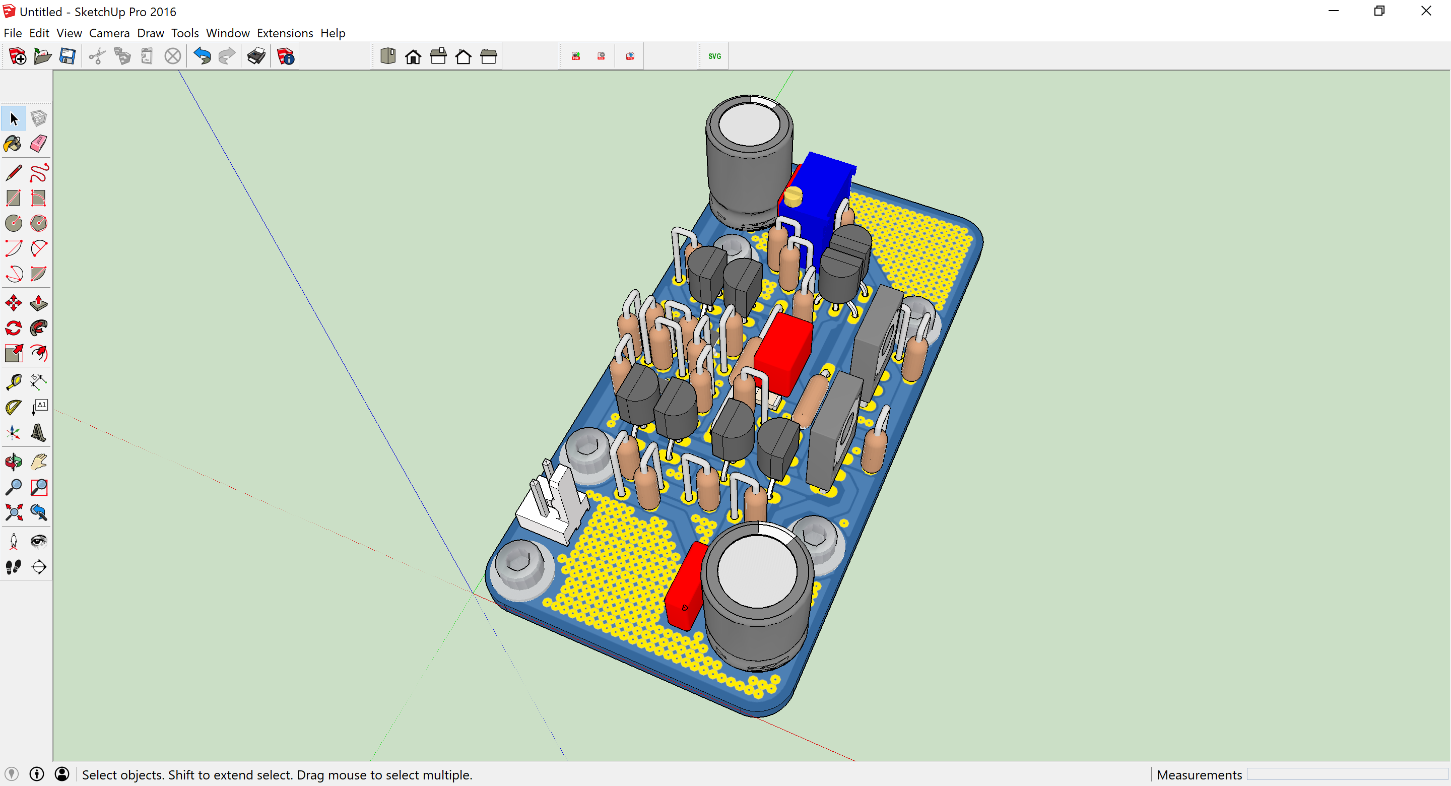

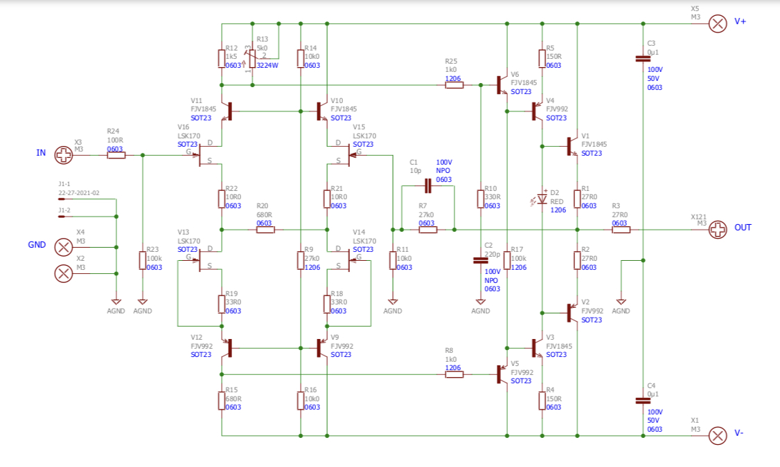

Interest in Wayne’s 2017 BA Linestage daughterboard for Yarra motherboard?
JPS64 has come up with a mostly through hole (TH) implementation of Wayne’s 2017 BA Linestage preamp in a Yarra-compatible format. This makes it easy to test out this preamp by simply popping it into your existing Yarra. The Yarra also makes preamp “rolling” possible. Here is the schematic (for SMT version). The TH version still uses the four JFET SOT23’s soldered underneath. They are easy to solder. The rest are TH and we have upgraded the output devices to state of the art TO126 Toshiba TTA004C and TTC0004 devices which handle the heat dissipation better and also allow some tweaking for higher bias currents to drive even headphones if desired. Alternatively, one could even install this as the input stage for the M2X amp.
Schematic:
attachment.php
3D render:
attachment.php
