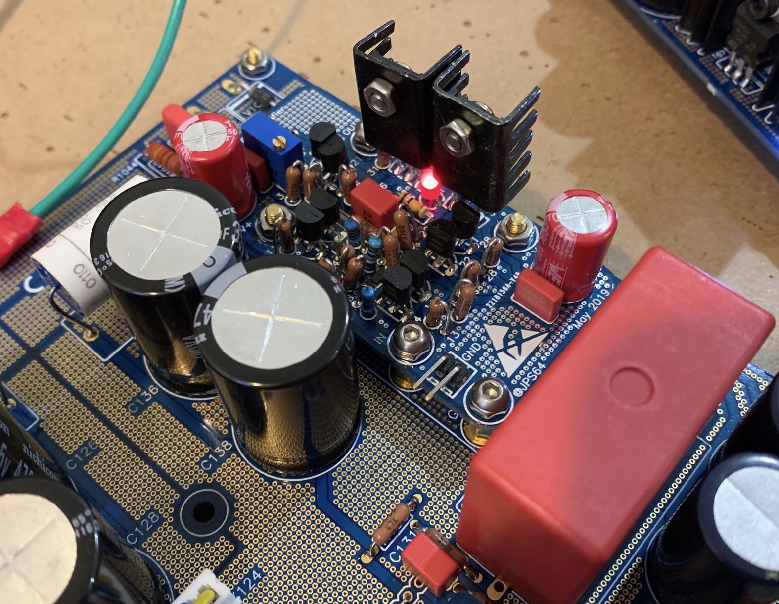

Wayne’s BA-18 preamp board re-visited, now with output coupling caps. Since I had to install output and input coupling caps on the Yarra mainboard, I thought I would give the WBA-18 another try. It had some pretty bad DC offset drift due to the steep temp dependence of the the transistors. Just wafting your hand over the boards would make it wander 15mV.
Installing it back into mainboard - now WBA-18 also fitted with some serrated fin stamped heatsinks on the output BJTs:
attachment.php

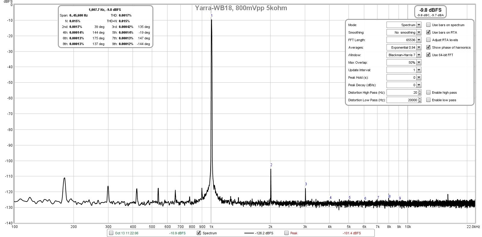

The preamp measures very clean now. The huge sub 1000Hz DC drift hump/hill in the old FFT is gone. Preamp displays natural second order distortion and lower third harmonic. Overall very low levels in the 0.0017% THD range for circa 700mVpp output into 50k load.

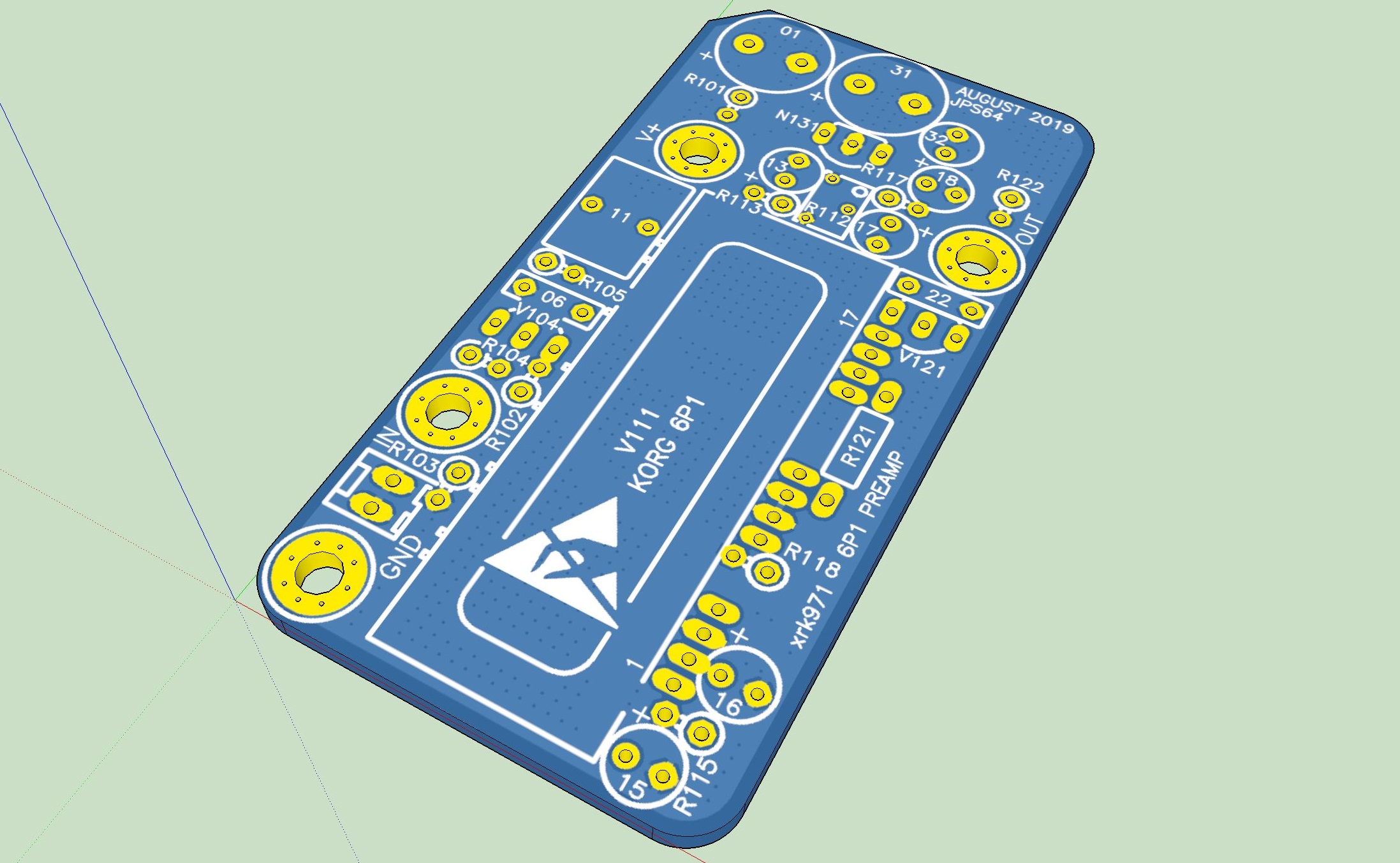

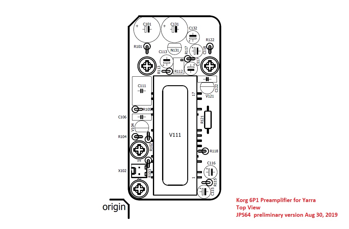

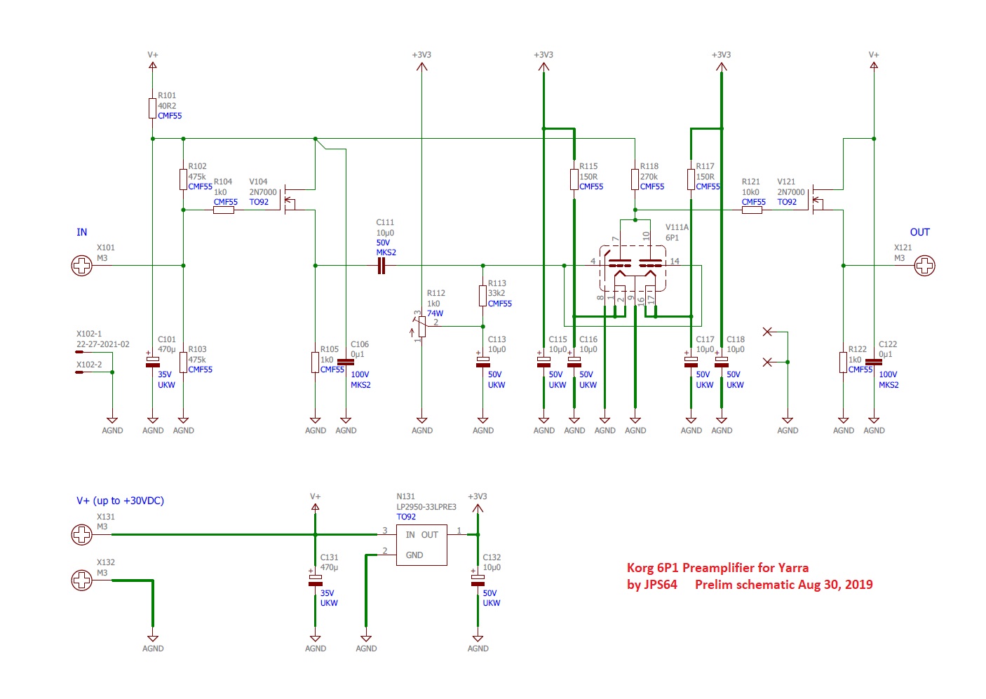

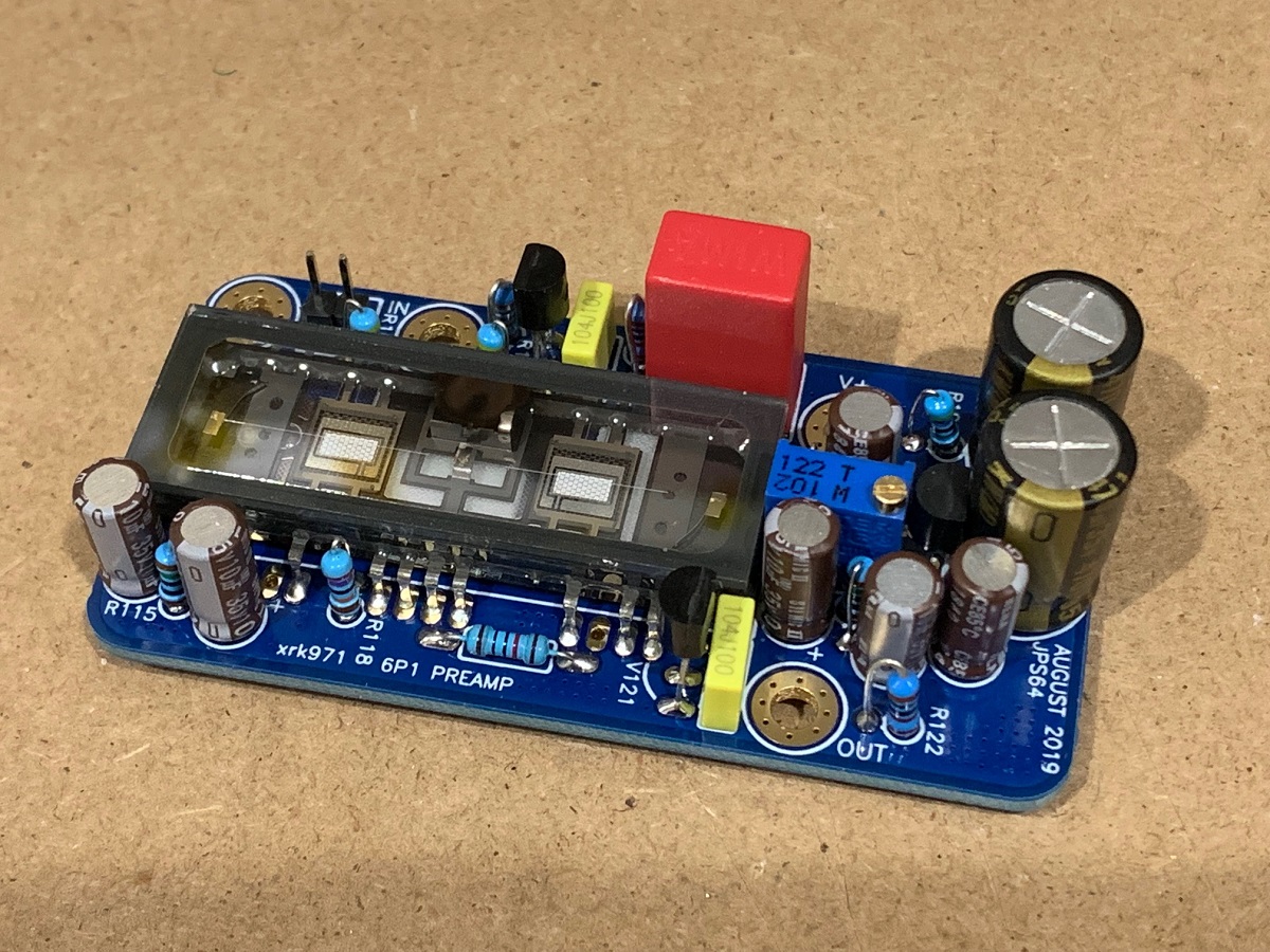

Ok, here is the Korg 6P1 preamp data in one place.
Setup Instructions: Adjust pot to set voltage = 12.00v at the plate of the 6P1 (same as left leg of R121 or pin 7 or 10 on the 6P1). This achieves the design performance of dominant H2 and monononitcally decreasing higher order harmonics while keeping overall THD low.
Very important: you MUST use AC-coupling caps on the Yarra mainboard for both the input and output or the Korg 6P1 preamp board will not work.
778463d1567193097-yarra-preamplifier-hpa-melbourne-db-buy-korg-6p1-yarra-3d-render-pcb-02-jpg
778461d1567193097-yarra-preamplifier-hpa-melbourne-db-buy-korg-6p1-yarra-schematic-v0-jpg
778464d1567193097-yarra-preamplifier-hpa-melbourne-db-buy-korg-6p1-yarra-top-stuffing-guide-v0-jpg
787418d1570917320-yarra-preamplifier-hpa-melbourne-db-buy-korg-6p1-yarra-test-build-01-jpg
787419d1570917320-yarra-preamplifier-hpa-melbourne-db-buy-korg-6p1-yarra-test-build-02-jpg
