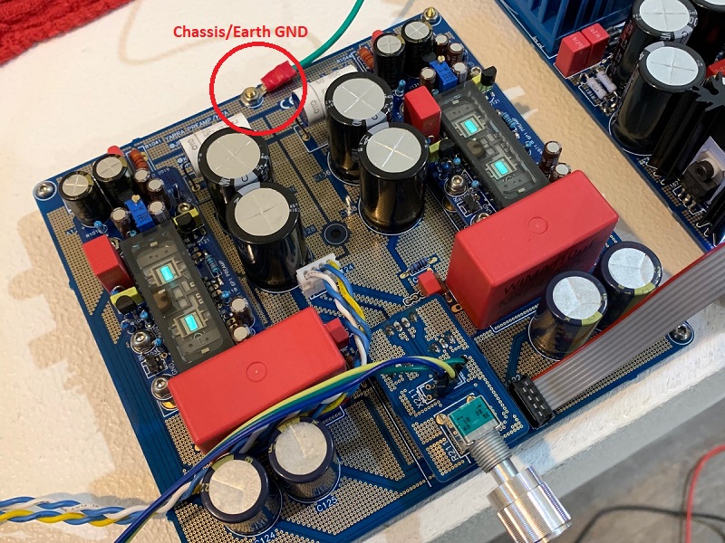

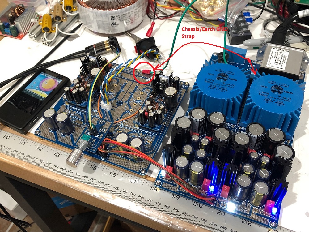

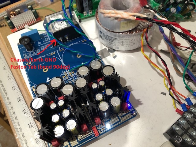

Measure the drop from the downstream point of the large 2R2 resistors (and same as the 4700uF caps) to the output jack. I soldered some test clip pins to points on the board to get an easy hook up for the alligator clips. It is good to set the voltage drop at this point just so that the left and right channels are consistent.
The only point that should touch the chassis ground is the middle back bolt pad on the main Yarra board (this point is connected to analog 0v gnd via 10R or NTC ground loop breakers for clean GND). From that bolt, tie a ground strap using a loop crimp connector to the ground tab on the IEC shell. IEC shell can be screwed to the chassis/earth ground.
These images should help you:
attachment.php
attachment.php
attachment.php
