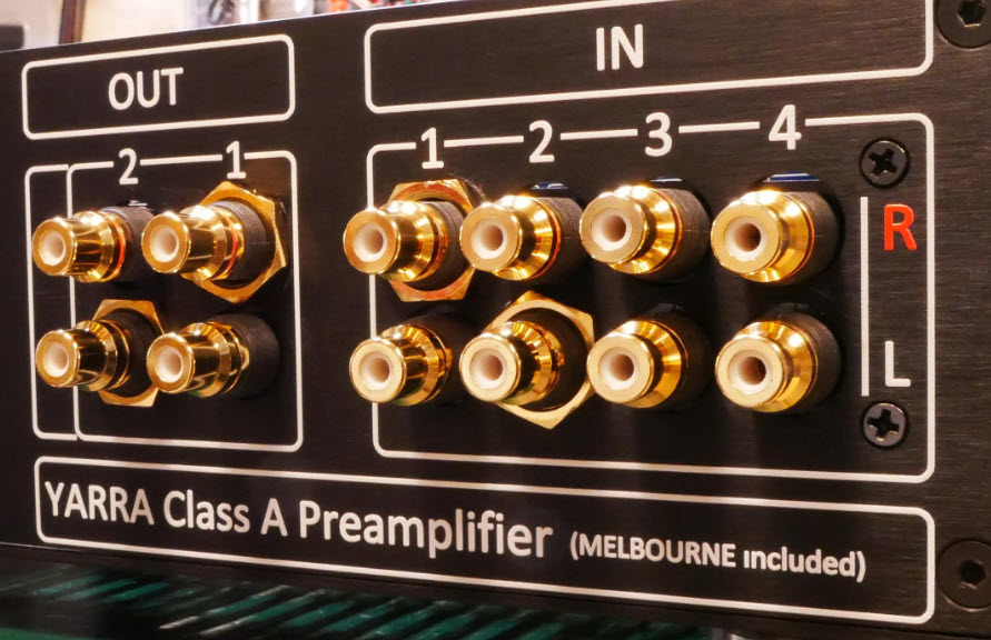

Adding a Subwoofer?
Hi all,
Since my mishap earlier in the week, I continue (rather skittishly) to test the Yarra, and the influence it may have on my power amps. So far, the test have been positive as long as I observe the proper power up/down sequence.
As the Yarra does have two-sets of line-level outputs, I was planning on using the second set to go to a sub. I've been using a powered sub-woofer for years - most connected to the SUB-OUT on the rear panel of commercial preamps. Properly adjusted it adds the full dimension of the sound when paired with my Elacs Uni-Fi - UB5 speakers. The powered sub has its own line-level input, crossover and volume control.
So, during testing this morning, I hooked up my test sub to a single RCA channel on the 2nd set of pre-outputs. Powered everything up as it should be (no clicks or pops), and slowly adjusted the level of the sub. All I got was a continuous low-level hum roughly around 60Hz. No variation as the music was playing. I thought this odd. Seems like the process is simply adding another amp from the pre.
I first tested the 2nd set of output jacks with the main power amp and music played beautifully. So, thinking maybe the cable was at issue, I exchange it for a brand new sub cable I had in my shop. Still the same issue - low level continuous hum. I decided to try another sub, and got the same thing. I'm not trying to 'Y' the outputs together, or SUM them, just testing one of the RCA jacks for LF information.
So, what to make of this development? Can the 2nd set of pre outputs be used with a sub? Is there something simple I'm overlooking? My apologizes for all these seemingly basic questions.

Hi Redjr,
I never hooked mine up to the input/ouput selector PCB yet. I ams still running from an un-encsased PCB connected via an RCA jack connected to the headphone outputs (jumper pins 2-3 for X123 and X133). You will have to look at this schematic and tell me where you are connecting your power amp, and which is the "2nd set of jcks"?
The odd thing is you say that your main power amp plays music when you connect the 2nd set of RCA outputs.
Vunce has his fully wired so maybe he can hep.

@X
When looking at the back of the pre, outputs labeled #1, are closest to the 4 inputs. Since output set #2 play fine through my power amp too, I simply assumed they were wired in parallel with set #1.
Edit: Are you suggesting these 2 sets of outputs are in some way independent?
Edit 2: See oranges circles below. I thought these jumpers were for the addition of a headphone jack. Do they control outputs #2?
@X
Just to be clear, my pre is outputting the selected source through both sets of outputs, #1 and #2.
EDIT: Yes, that's my take. Do a sanity check and unplug the speakers and plug the sub in to one set and the other... does it work?
