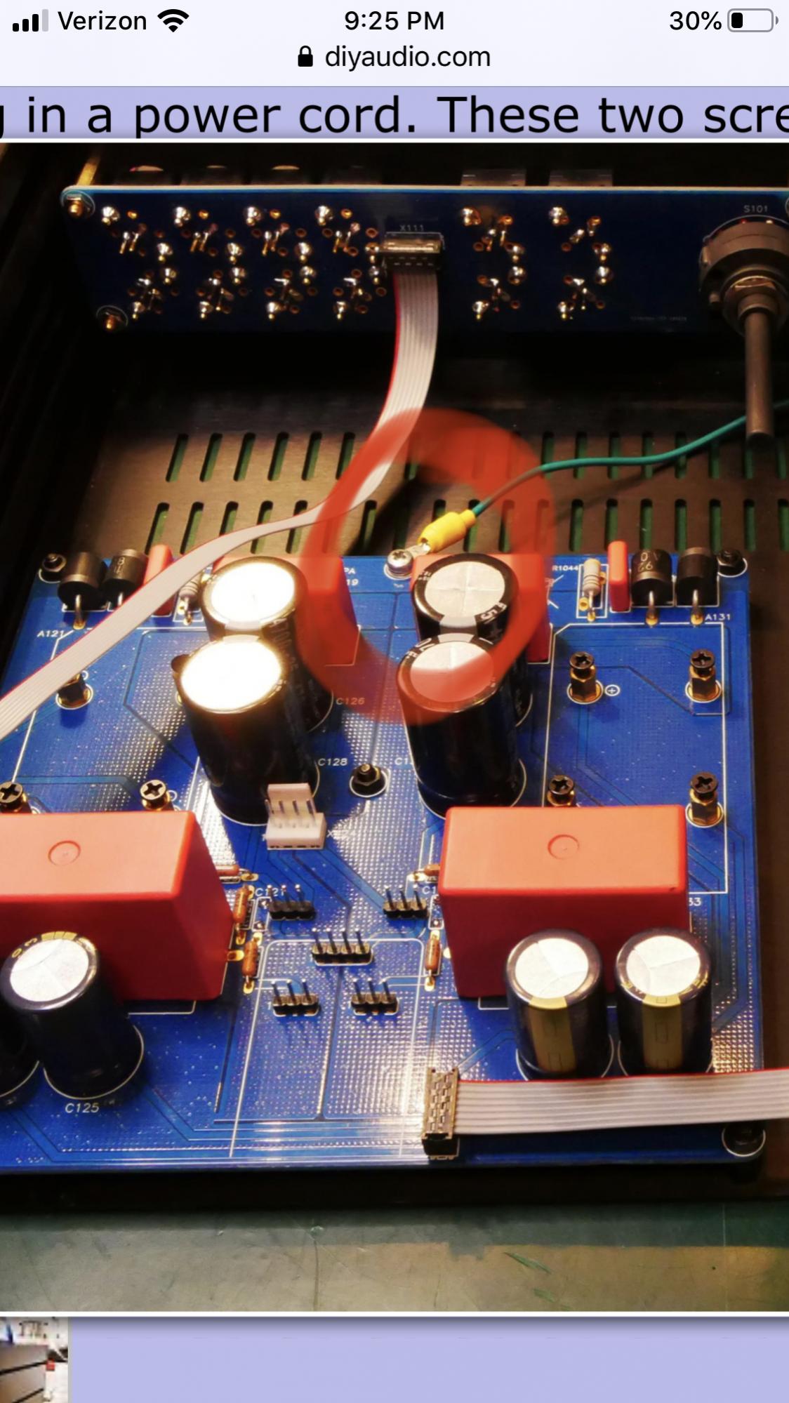

@X Is the audio ground 'floating' with this pre? Is it tied to earth ground anywhere? (I hope that's not a stupid question!) I just thought of another thing in how I mounted my IEC connector to the chassis. I can't verify until the morning. I'll post my findings.
Yes. This is only connected to the IEC socket on the PSU board. Both the PSU and Yarra MB PCBs are elevated on 5MM nylon standoffs. They are not grounded to the chassis.Hi redjr,
Check to make sure this screw (circled in red) doesn’t connect to the chassis.
Edit: Correction. RCA jacks NOT in contact with chassis. Nylon fittings.

I just noticed your edit to the post. The Yarra chassis is most definitely tied to earth ground. You do not need to support the motherboard or the PSU board with nylon or plastic standoffs. None of the support holes on the motherboard have any connection to a ground plane they are isolated. There is a single mounting hole next to the AC inlet power module on the PSU board that has a metal ring, that is your connection for earth ground to chassis. Drilling the support holes for the IEC plug also created another ground path. (I also drilled support holes, but do not have any negative effect)
Your RCA grounds connect to chassis ground through the ground loop breaker on the motherboard. If checked with your DMM, all RCA grounds to chassis should show 5-7ohm resistance.
If no sound at all comes out of the sub, I doubt it is a ground “loop” issue, but maybe a reverse polarity ground on +ve input issue. That is, the output of the Yarra is going straight to ground when the sub is connected. Does sound still come from the main channels amp connected to the other output?
To check, use DMM and measure ohms conductivity between output at Yarra RCA out and ground (should be 680R or whatever the output bleed resistor is). When connecting the sub, I bet it shows circa 0 ohms. Sometimes, this can be caused by the reverse of the +ve and -ve leads on the sub’s RCA jack.

My recently built USSA5 with single SLB was giving me a lot of ground looping hum issues, so I decided to switch over to twin SLB powering the USSA5 as a twin monobloc inside one chassis. Hum issues were quickly resolved, so my USSA5 was super quiet, no hums and no hiss at all.
The moment I plugged in my Yarra preamp, my right channel will hum faintly with my ear to the speaker. I know something is not right in my Yarra's build. I remove both Yarra's pcb to change out all brass standoff to plastic ones, with the exception to the one as shown in the pic below.
On the other preamp pcb, the ground was tie to a thick green cable with NO standoff below it, and it was connected to the main IEC socket's ground tab. This was advised by Vunce.
Put everything back in order, and the same hum still exists on the left channel.
Many more days were spent on troubleshooting the hum issue, then I realized where my mistake was.
When I initially build this preamp, I got magic smoke out on my first powering up, it was caused by all the star nuts that I used, they are bigger in diameter and contacted the VIA ground plain around the standoff.
After replacing those star nuts, the preamp starts singing till today. Little that I know, the 4-star nuts were still used to hold the RCA input pcb, so again they touched the ground VIA and thus the grounding loop issue on my right channel.
Since exchanging out the 4-star nuts on the RCA pcb, all the hums were gone, both Yarra and USSA5 are silent at Max volume!
Lastly, I changed out those big output coupling caps for smaller value as it was not intended for headphone usage at all.
I hope the above can help others in some way when they are building their Yarra.
Note: You do not need to use plastic standoffs, just make sure they stay within and not touches VIA ground plain.
