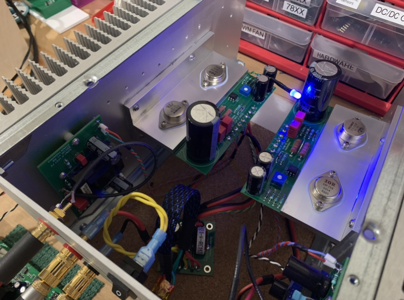

This is what I am using. I love them - I wish I knew about these years ago. I found out about them here, when I realizedd the VFET board has no Fastons or Molex.
Ferrule Crimping Tool Kit, Preciva Hexagonal Sawtooth Self-Adjustable Ratchet Wire Terminals Crimper Kit with 1900pcs Wire Terminals Crimping Connectors Wire End Ferrules https://www.amazon.com/dp/B07XBLGPC...abc_9B03J8SMT1DG3NA5RWSG?_encoding=UTF8&psc=1
I really like it - use it everywhere now. It’s like the little things on the end of your shoelaces. I have read that the pin end crimp allows you to not use solder to make a firm tip. The solder wicks into the wire and makes it a “solid” wire where it’s important to be flexible and will break from strain faster.
Example of hexagonal (radial) crimper:

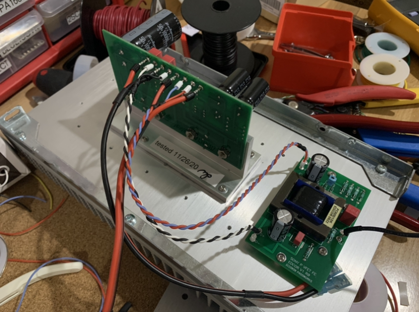

I first used these on the DIYA VFET amp and they allow flying leads to be soldered without becoming stiff due to solder penetration.

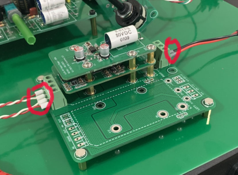

Also used on the terminal blocks of my LuFo P2P prototype amp:
