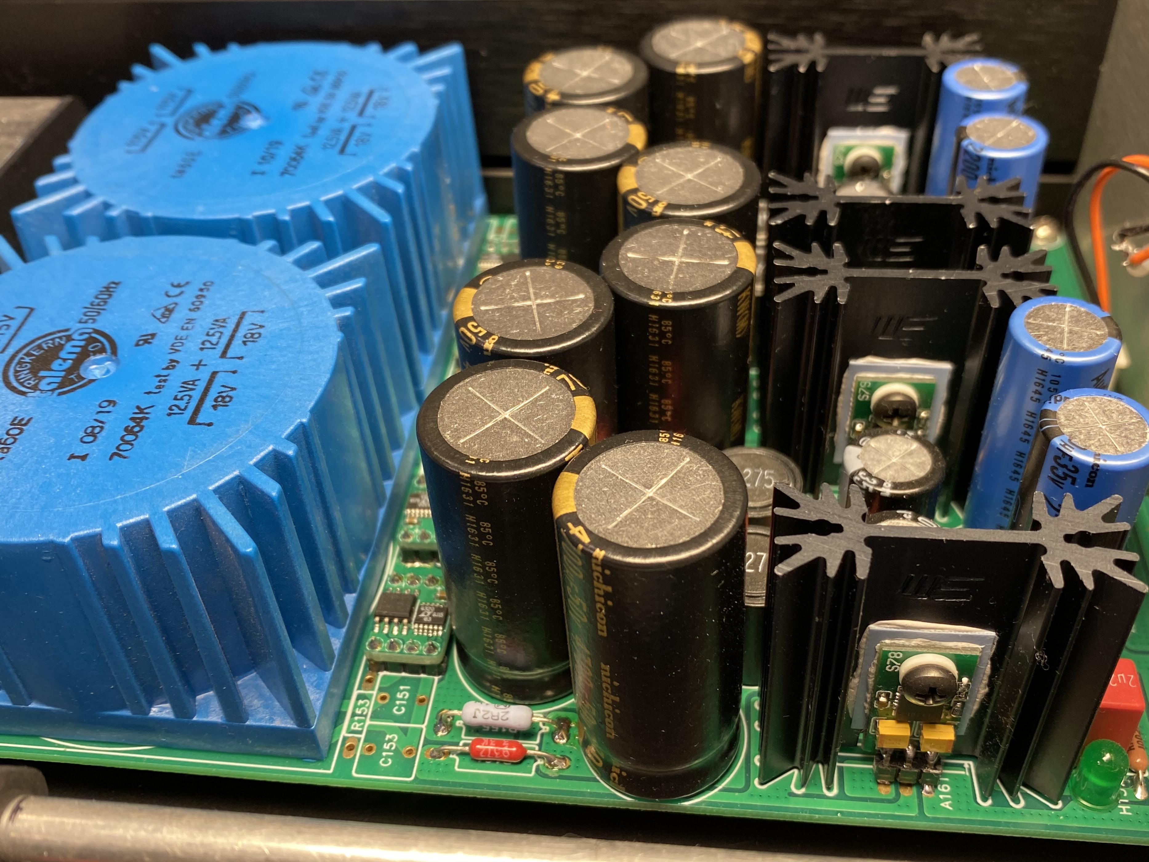

X Thanks for the explanation. For my part, I understand that using Talema 70052k 12v + 12v (+/- 18v output) I will have to bridge and leave the 24v (+ 34v) output winding in series. I will try to play with the potentiometers on the Yarra PSU and the R121 / 122 resistors on the Hakuin pcb, adjusting the closest to + 24v.

12v x 1.41 = 16.8v
Then you have to account for the capacitance multiplier voltage drop. The better option is a Talema 22v trafo.

Using the higher voltage transformers will give you more options with your daughter board choices. Using a 12v transformer will not get the output voltage your looking for.
Also, The trimpots in the PSU section have very little effect over output voltage, probably less than 1v.

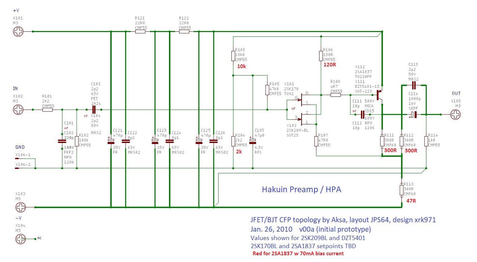

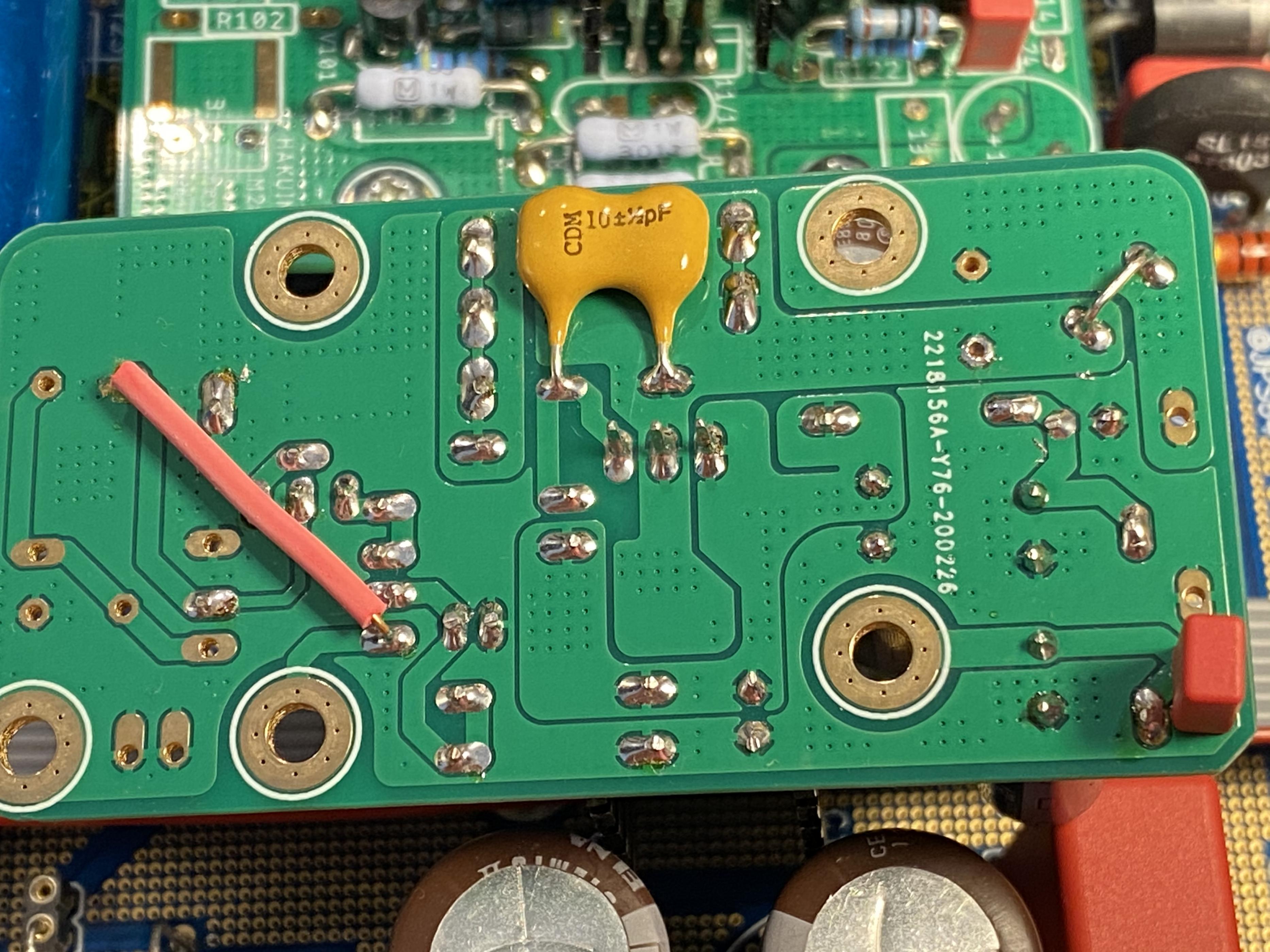

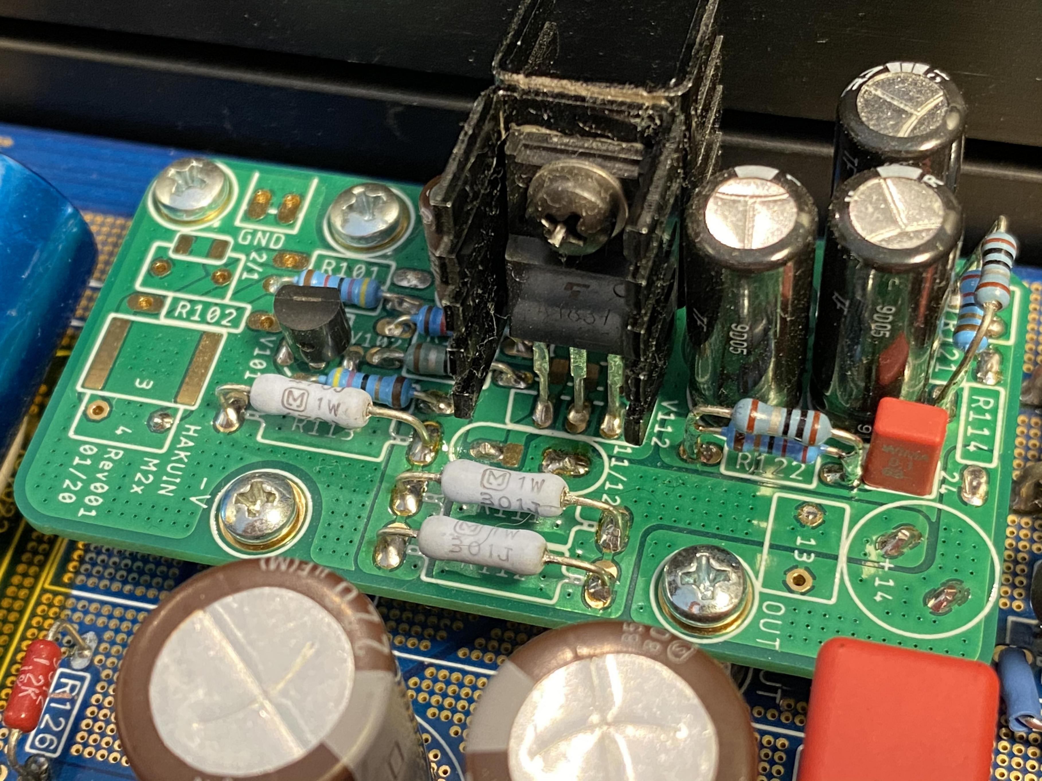

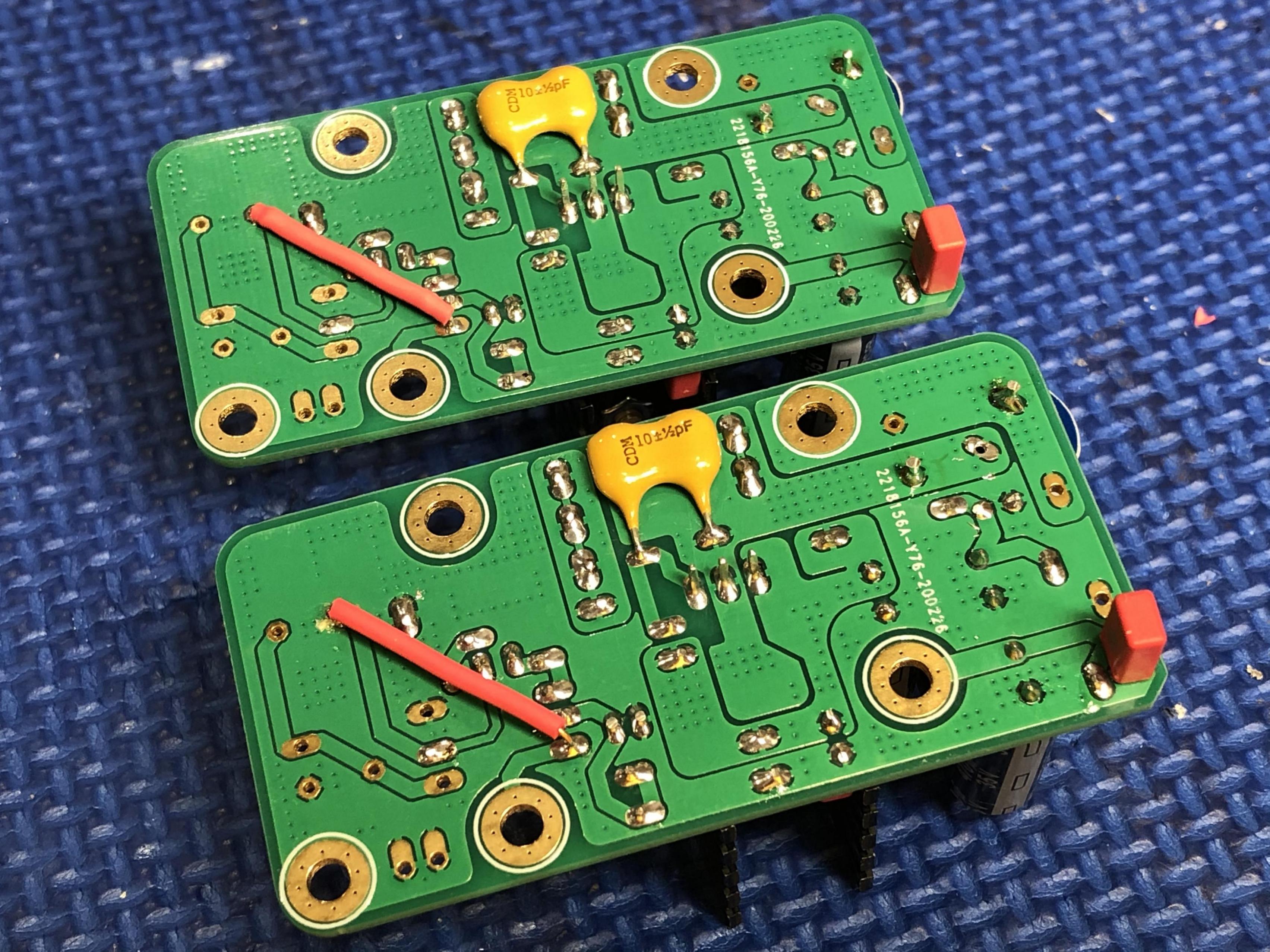

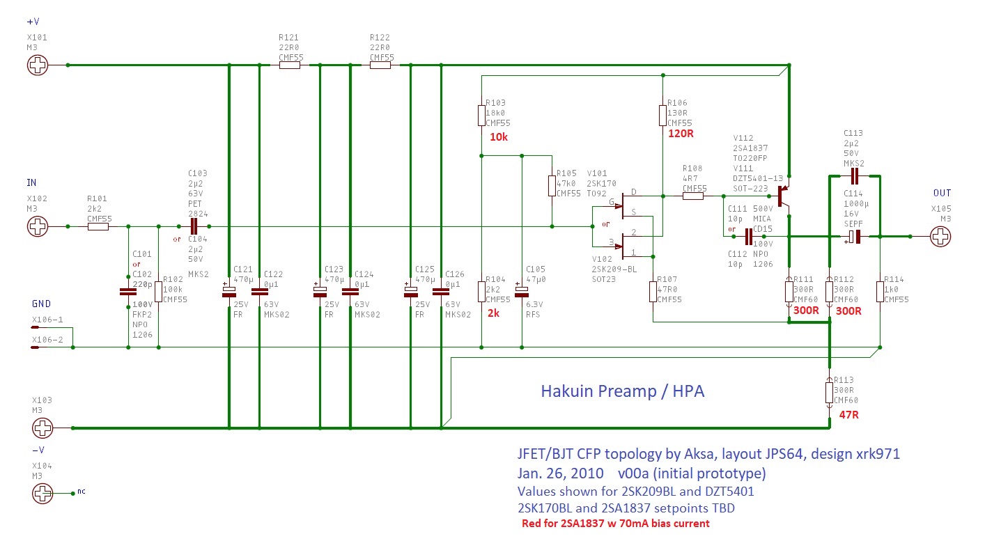

I am finally getting around to putting together my Hakuin boards that will go on a fully loaded up Yarra motherboard, using 2SK170BL and 2SA1837. I would like to verify that, in this configuration, it is ok to leave the following components unpopulated on the Hakuin boards:
R101, R102, R114
C101, C102, C103, C104, C113, C114
V102, V111
Thanks,
Alan
R101, R102, R114
V102, V111
Thanks,
Alan

Correct setup AJ.
Don’t forget to add two jumpers:
C104 —>R101
Short C114

Start with 22R and increase to drop the output voltage to the Hakuin. Ideally, adjust so that the value of voltage at the collector of the 2SA1837 BJT circa 24v +/-2v is ok.
I built my Hakuin boards according to the resistor values in the schematic in post 1404, using 22R for R121 and R122. According to the 2SA1837 data sheet, the collector is the center post of the device. I hooked boards up to a lab power supply set at 24 volts, and measured voltage at the center pin of the 2SA1837 to ground, and I am only seeing ~12.8 volts. The other pins are seeing about 20 volts.
Am I measuring the wrong pin, or did I do something drastically wrong?

The emitter (pin3) will see the voltage right after the CRCRC.
My setup measurements:
Input V+ = 23.90v
B = 23.09v
C = 15.28v
E = 23.72v
AJ, my power supply outputs 24v, So I do not have to drop any voltage on the Hakuin Board, I have paralleled resistors for only 1R at R121 and R122.
If you are feeding your Hakuin with 24v also, drop the 22R’s to 1R

Great! So I was at the wrong pin. I just had experimented by dropping R121/122 to 6.9 ohms and got closer. Just need to find some low ohm resistors.

Hi Vunce,
In post number 1232, you wrote:
"C113 and C114 were not populated at first because the Yarra main board is cap coupled. But, I noticed a slight DC spike when powered on and off. Installing a 5uF film cap in C114 totally eliminated the DC spike and offset is now rock solid hovering at 0mV."
After your post, X talked about bass roll-off points with various cap values in C114. In later pictures you have nothing in C114 but a jumper. How did you ultimately deal with the DC spike and drift?

Ahhh, many details I forget about with my Yarra. After that post a psu board was developed that uses LDO regulators. I have mine set up for +/-24v. Also, my main board is optimized for preamp duty only with smaller back to back electrolytic caps and appropriate bleed resistor values. No more dc spike and rock steady offset now. I’m away from my bench at the moment, this evening I’ll dig in for more details to post.

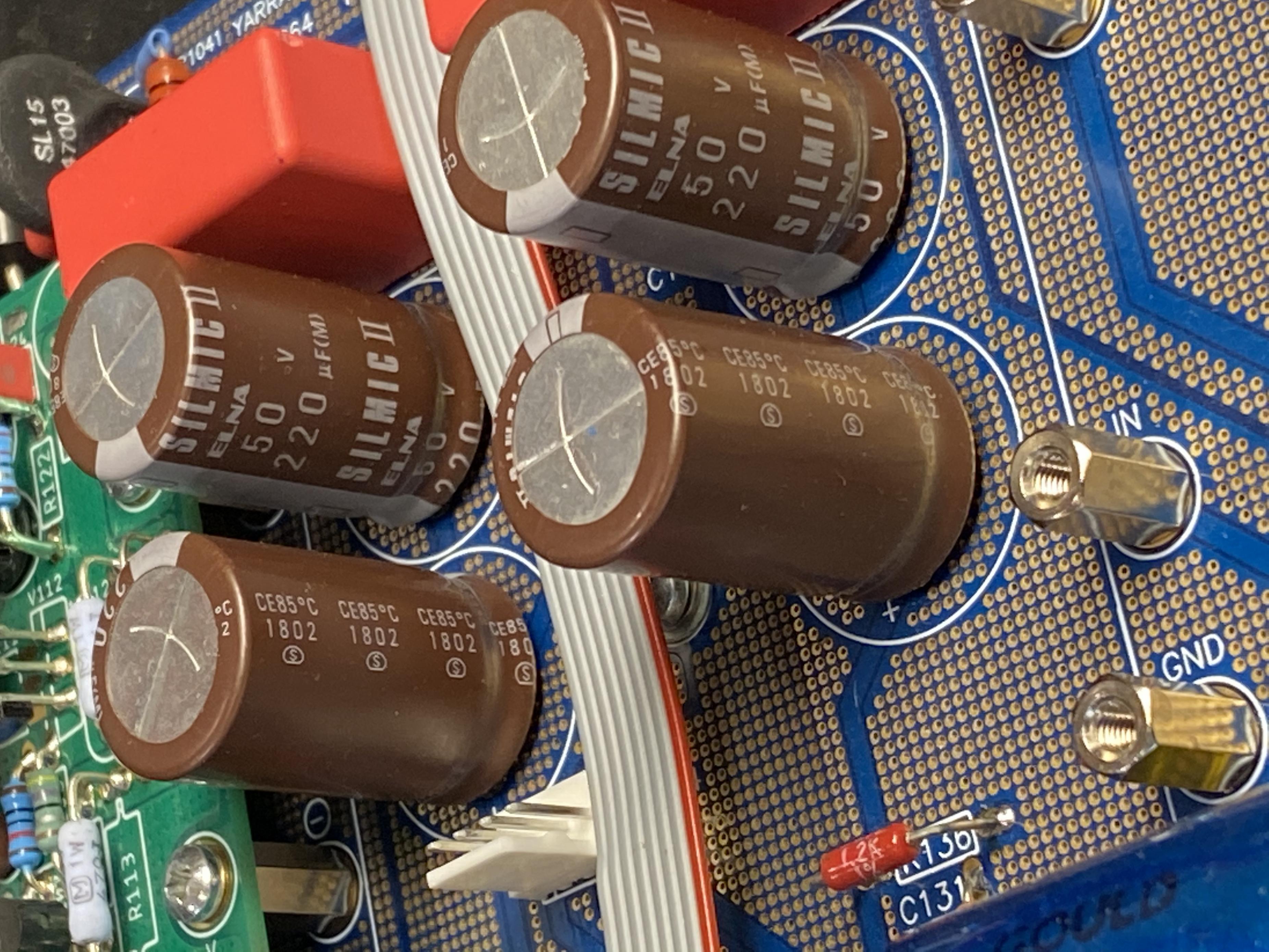

Hi Fellas,
I have some more details about how my Yarra/Hakuin preamp is configured.
Main board:
C126,128,136,138 = 220uF, 50v Silmic II
R126, R136 = 1K2
MKI Regulated PSU board:
LT4320 Ideal Micro Bridges
CRCLC Filtering
+/-24vdc output via TPS7A4/3 LDO regs
Post#1178 introduced this PSU
Hakuin module:
Resistor values used for Toshiba devices (listed in red)
R121, R122 = 1R
If you’re using the stock PS board with CapMx, 22v transformers should be used.
This will output approximately +/-28vdc, then use the Hakuin CRCRC resistors to drop approx. 2v each to arrive at your 24v.
If the Talema 22v trafos are out of stock, small toroidal (60mm dia. max) can also be used. Just not as “neat” looking, LOL.
Enjoy your Yarra builds!!
