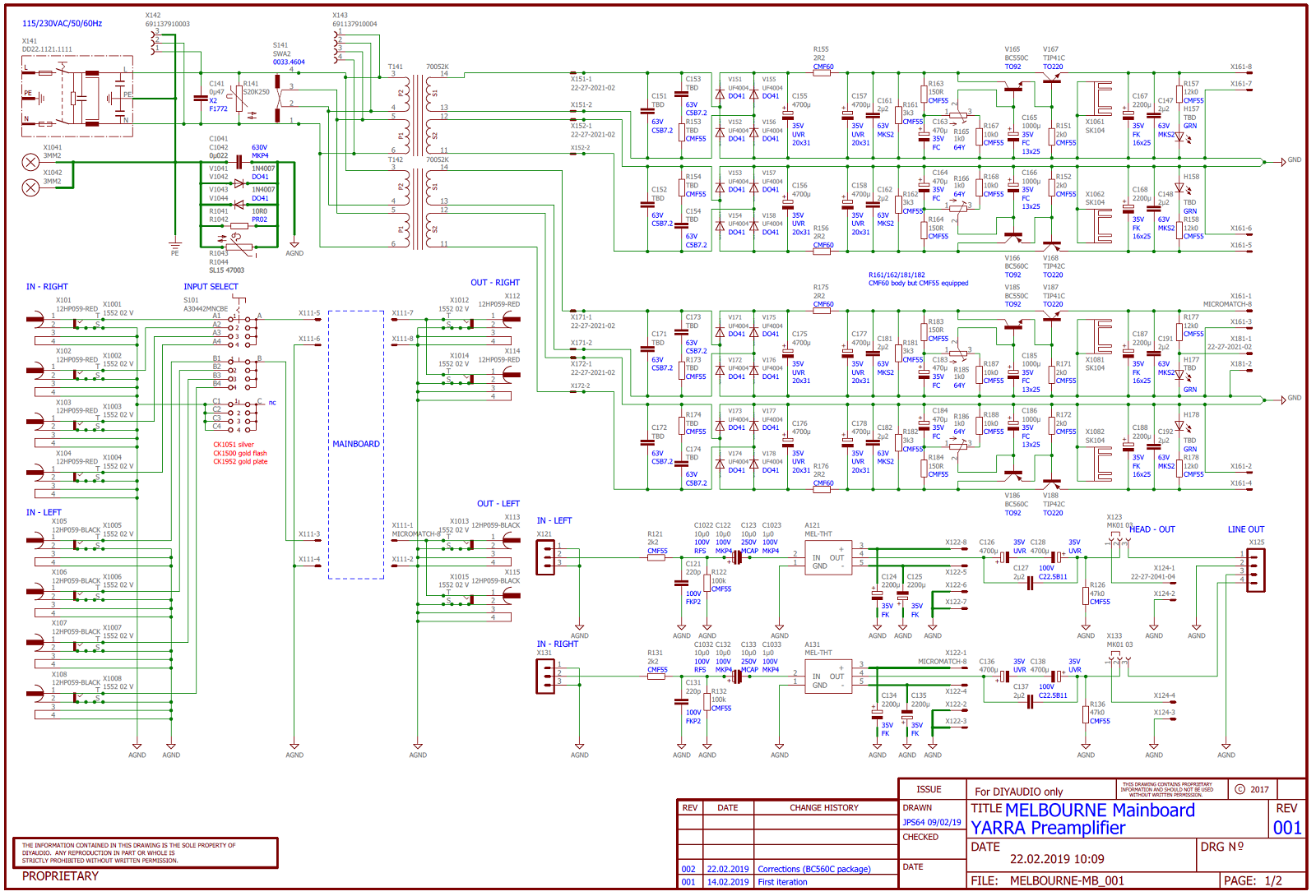

Sure, bypass caps are “to your taste”. Some people think a 22nF bypass does wonders. The way to look at it is ask yourself what frequency range do you want to make sure you hear that the electrolytic might not be so good at conveying? Assuming your bleed resistor is 1200ohms and we ignore 10k load impedance and 1uF, the -3dB frequency is 1/(2pi x R x C) or 126Hz, or 500Hz 2 octaves above that. The 1uF film cap will have you covered as low as 500Hz. Sounds like a good amount of coverage for the bulk of the midrange to highs.
In this topic that has been commented on the bypass capacitor, I have thought about something and it is not clear to me ... can the positions of the capacitors be reversed? I mean, the signal first finds the bypass capacitor c127 and then sees the electrolytics c126 / 128 (respecting polarities). In this way I would take advantage of the electrolytic space and I think that electrically there would be no problem.

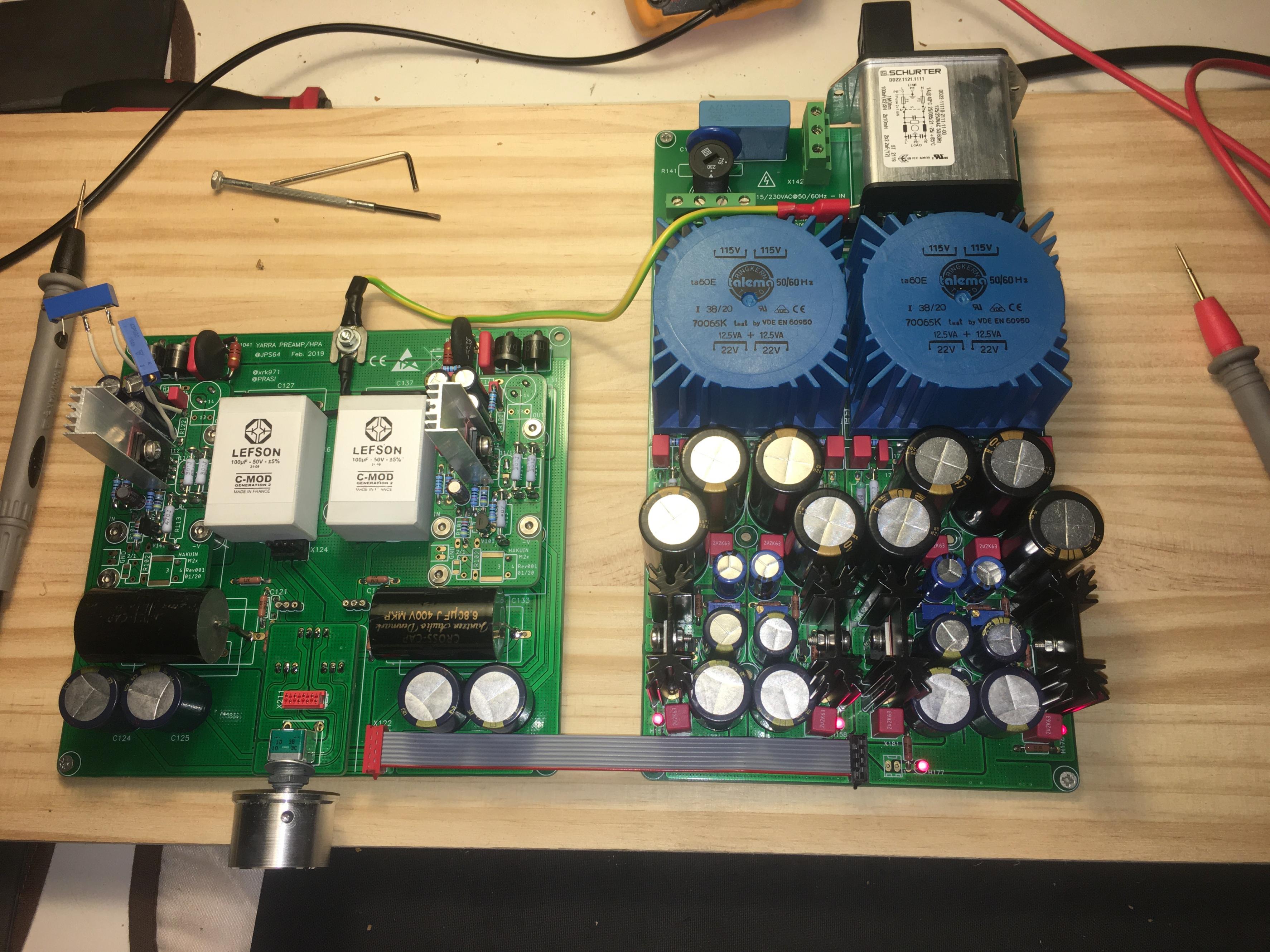

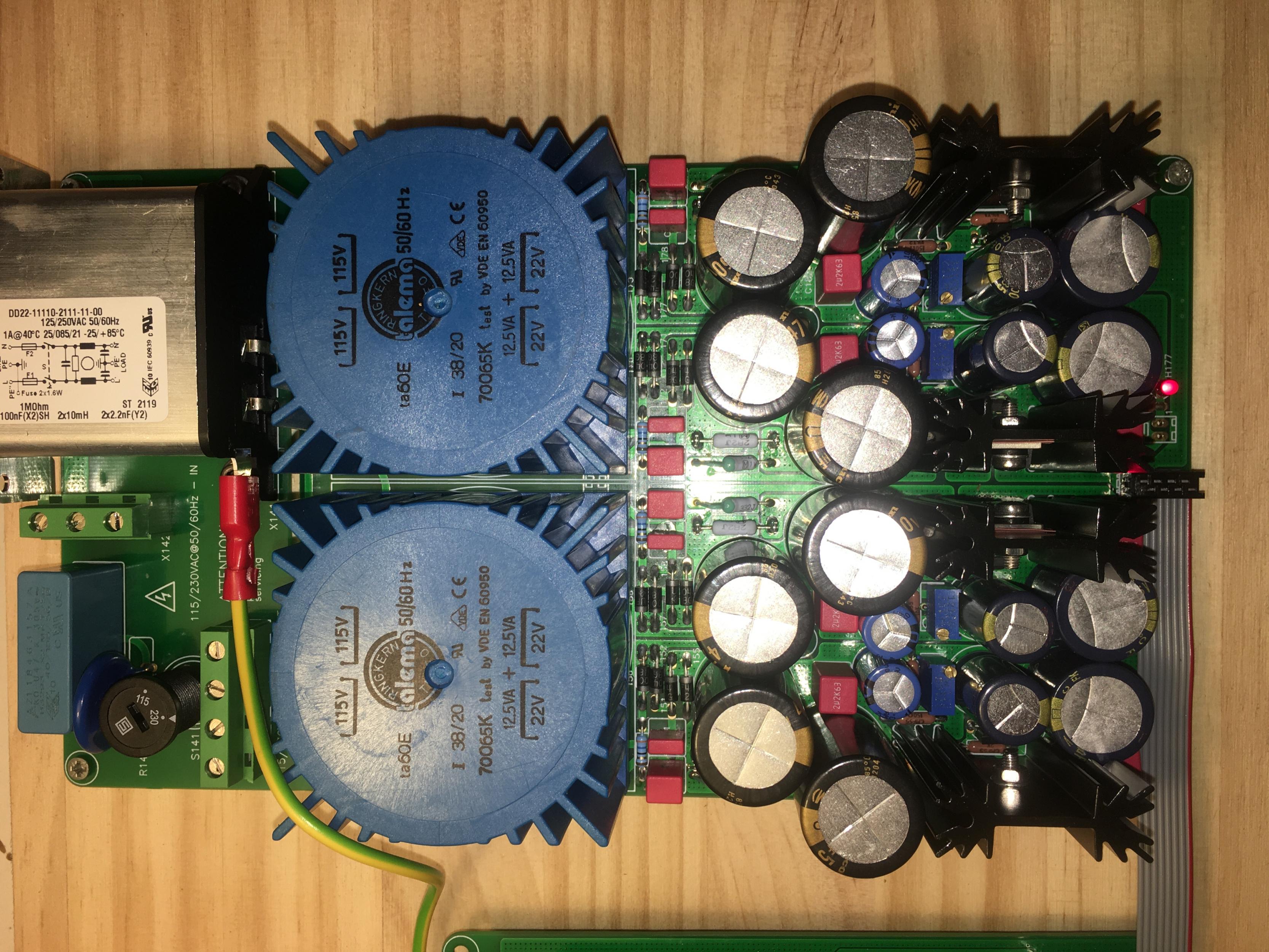

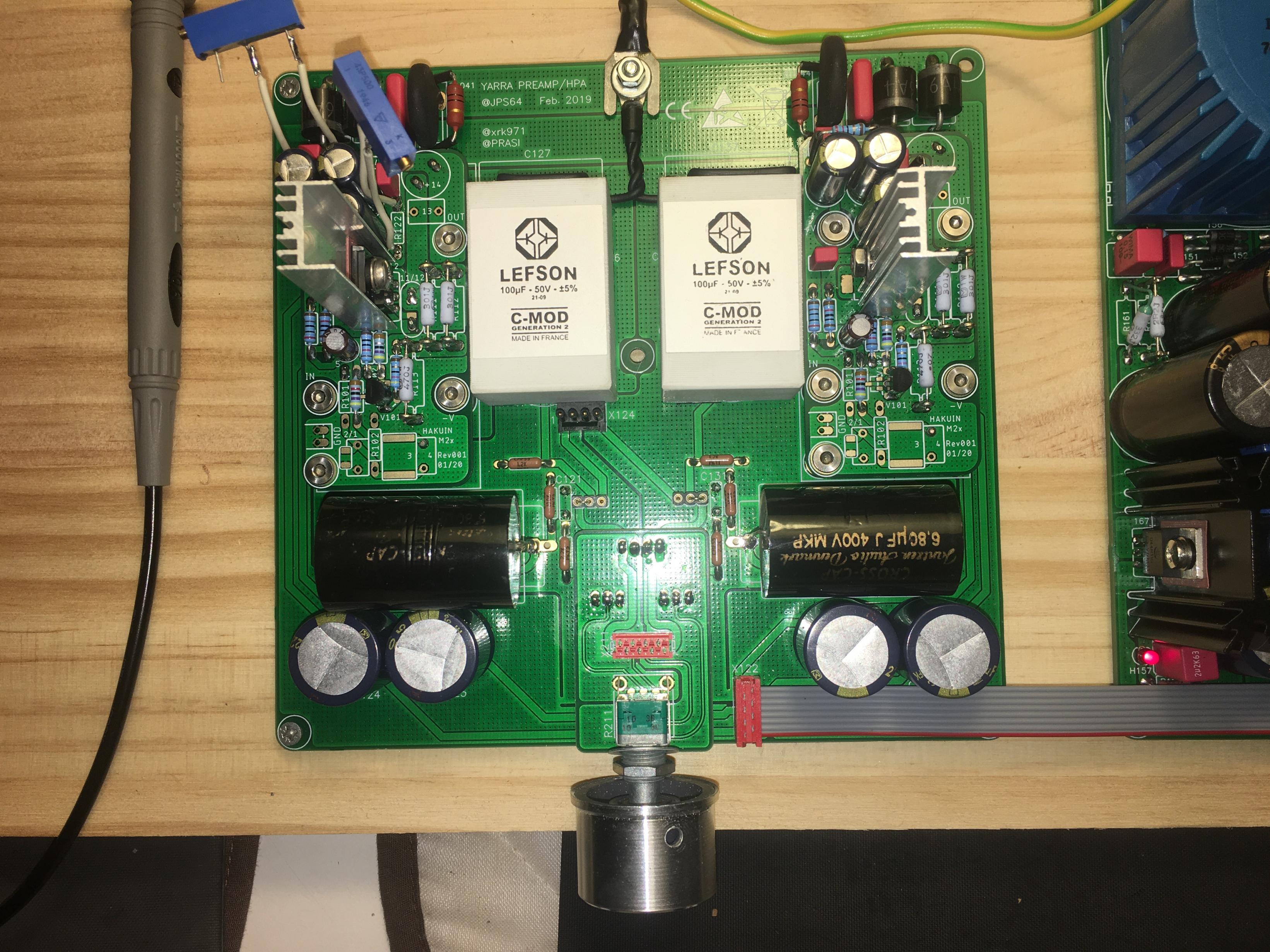

Hello,
I have already assembled the Yarra / Hakuin components. The truth is that it is a fun project with a lot of documentation
. I am trying to make the voltage adjustment on the PS but I don't quite understand it ... I have used Talema 22v and I am measuring on the 2K2 resistors:
R155 = 31.7v
R156 = 33.2v
R175 = 31.9v
R176 = 33.2v
A121 Hakuin = 29.9v
A131 Hakuin = 27.3v
I don't understand why I can't regulate (lower) the tension in R156 / 176 which are the highest ... what am I doing wrong?

The cap Mx adjustment pot was not meant to be used to change the output voltage but rather the depth of the ripple reduction. The voltage drop you have may be from one Hakuin drawing a lot more bias current than the other. What are your currents across the output stage?

Your Yarra PSU is working perfectly, R155 /R175 represent the positive rails for each channel and are loaded down by the Hakuin boards. R156 / R176 represent the negative rails and remain unloaded, hence the slightly higher voltage. Use the Yarra positive rail trimpots to get voltage close between channels (there is <1v range). Do not use the Yarra psu to lower the voltage for the Hakuins, adjust the R's in the CRCRC on the Hakuin board to decrease the voltage. Hakuin's run at +24V.
