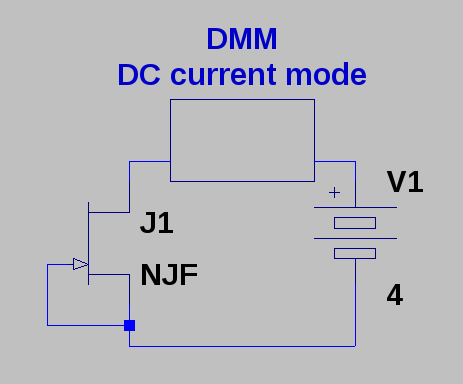

AndrewT brought up a good question. The pinout for the JFETs. How can I tell which is the drain and which is the source in your schematic? Also, is it important that the two JFETs be thermally coupled?
I hope you meant the layout as in schematic is standard how to draw nfet. Up - Drain, Erow - Gait, Down - Source.
Look the attached layout, LSK389 has marked pins, S1, D1, G1 - S2, D2, G2.
Problem is with individual LSK170(2SK170) the pinout, S, G, D, you will need some pins bending to accommodate two fets in the position of dual fet. Try to thermally couple them if you can, but more important is to match two fets Idss.
BR Damir

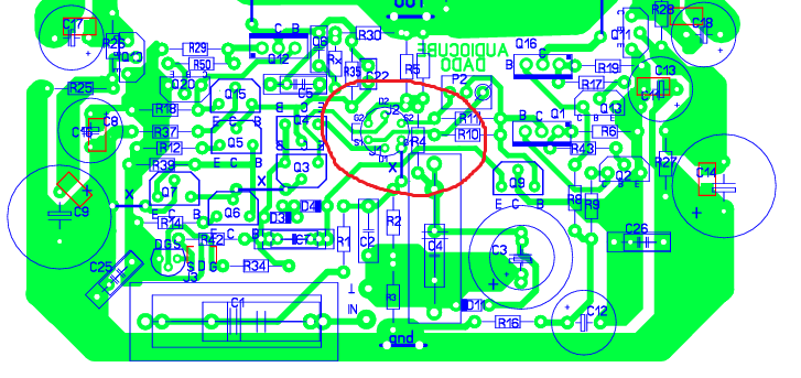

Hi, Dado,
I'm close to finishing populating the boards. I'm having trouble finding a couple resistors on the Schematic. There are two R35. One attached to the vbe and one next to Rx. Neither that R35 nor Rx are on the Schematic. Can you tell me what to use for those?
Thanks, Terry
Hi, Dado,
Thanks, Terry
Hi Terry,
R35 attached to Vbe is 6k8, R35 and C22 next to Rx don't populate(they are not on the last schematic), and instead Rx put short connection, jumper. Last schematic is here. http://www.diyaudio.com/forums/solid-state/182554-thermaltrak-tmc-amp-27.html#post4165464
Did you get input fet? If any problem, just ask any time.
BR Damir
Hi Damir,
I saw that they were missing on the Schematic but even the latest layout you posted has those parts. I will do as you say. I was unable to find the dual fet you specified. I plan to use two k170s.
Thanks, Terry
All those components are there to have possibility to try a bit different compensation. R35 paralleled to C22 are to have some local NFB around VAS(it lowers LG), and I did not get any perceivable sound change, but that's me, maybe you can try that if you like, but everything is working without it.
Try to match the k170 for Idss.
Damir
