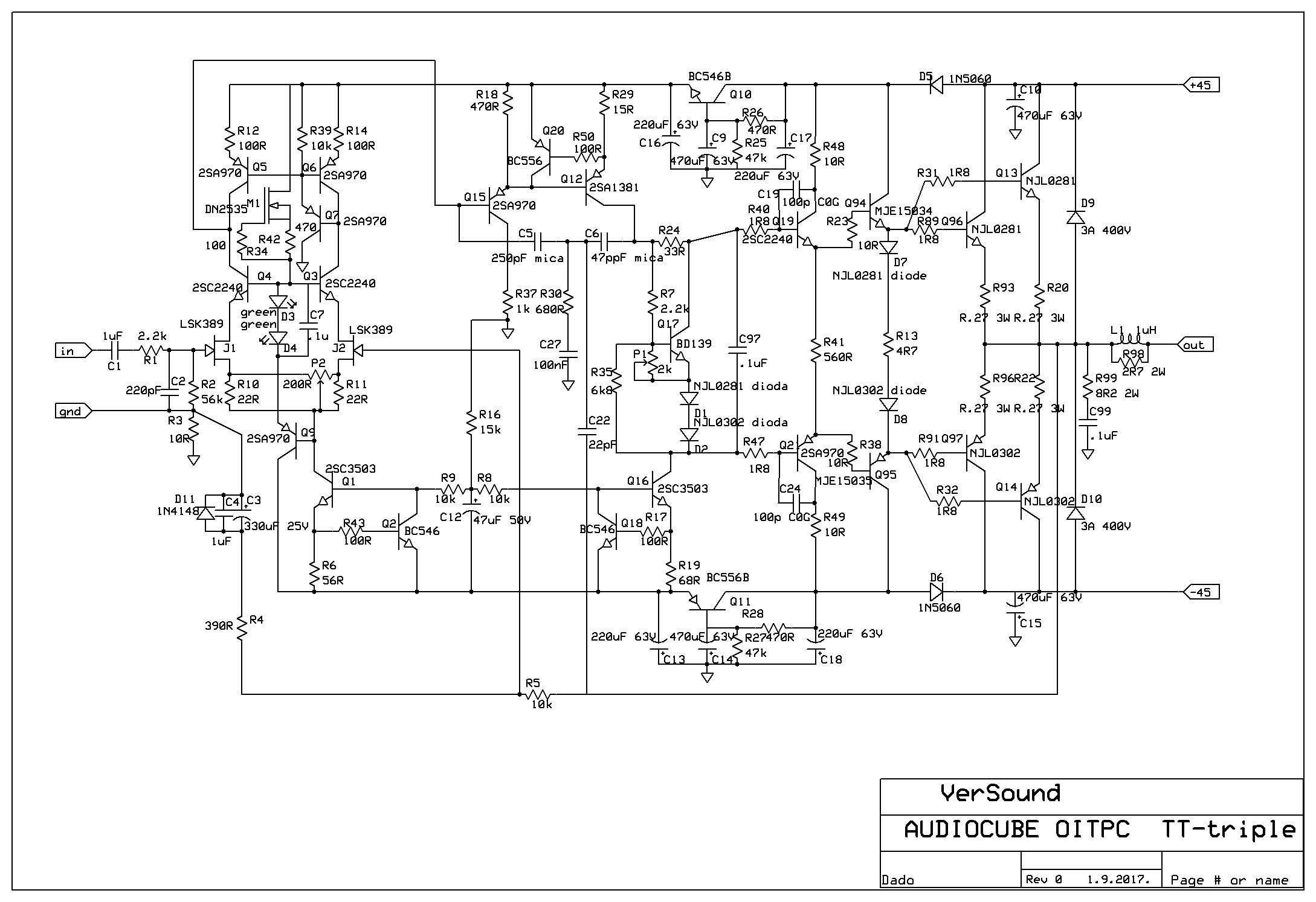

Hi nania,
Attached last schematic and BOM if it help you.
Damir

Looking over the BOM I have some questions:
1. Is the use of the mosfet @M1 optional?
2. The C6 value indicates 47ppF, shall I assume you meant 47pF?
3. If the 0.1uF values are not typos, why didn't you use 100nF to describe them?
4. Is the BOM only for the amp or does it also include parts for your supply/protection board?
Damir
1. You can use 15 kohm instead M1, R34, R42
2. 47 pF
3. 100 nF is the same as 0.1 uF. 1 uF is 1000 nF.
This is the amp BOM only.

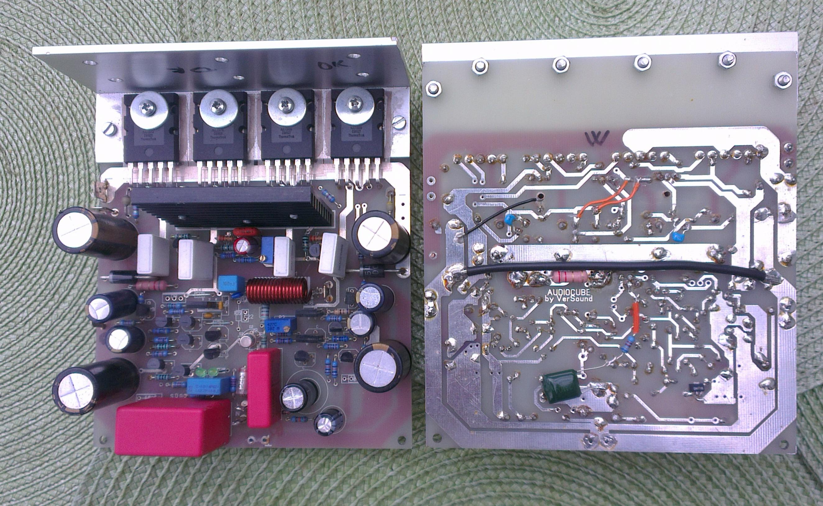

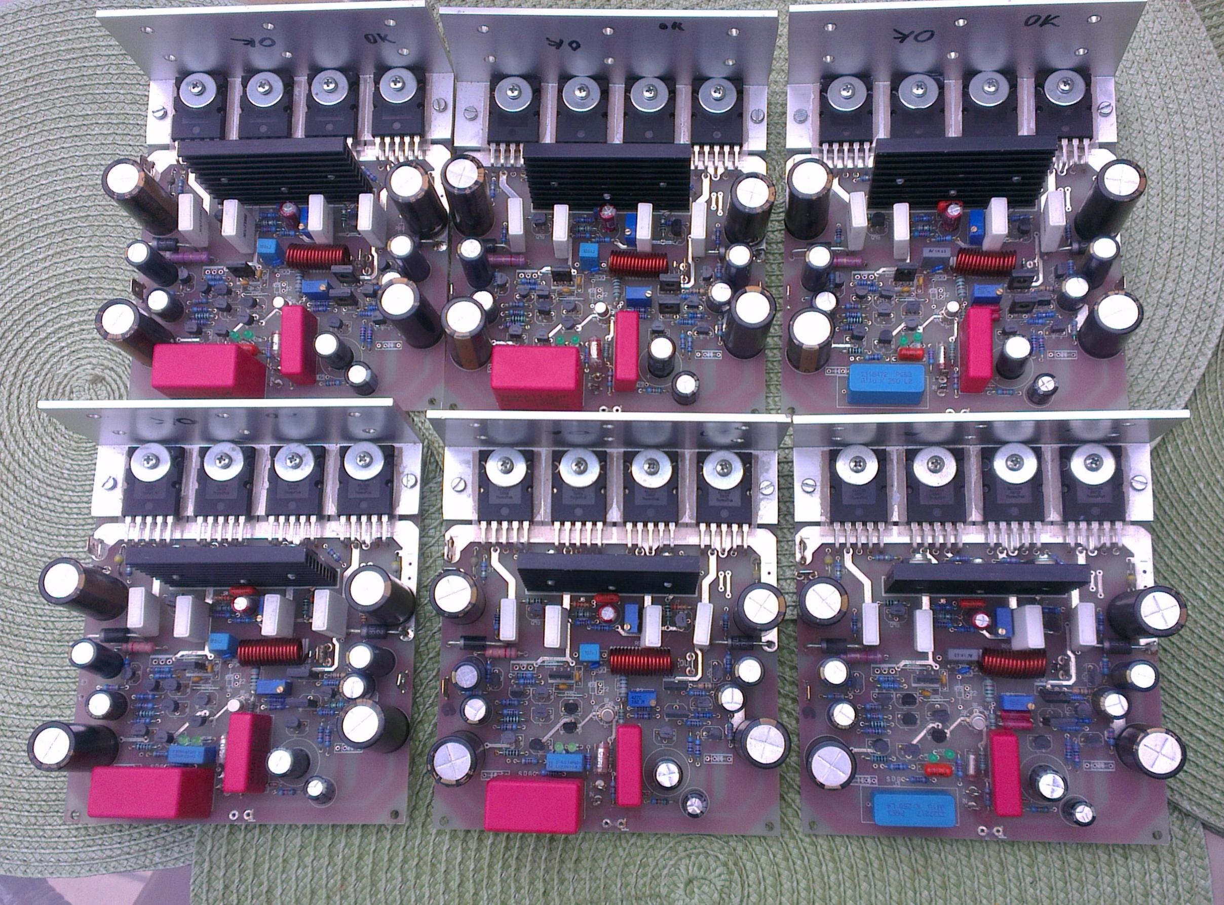

It’s time to sell some of my power amps boards I built in the past. I have to much different power amp and I need space for new design.
I would like to offer six boards of my TT power amp. It is improved from first version with the TMC to the OITPC with corrected layout (see the photo of the backside). All tested and used for some time. The sound is excellent, powerful and clear. I used bipolar electrolytic capacitors in the feedback (C3 - 470uF) to lower THD specially at low frequencies.
Other caps used are nichicon MUSE, wima polypropilene, polystirol and ceramic NP0. ThermalTrak transistors used in four boards are NJL3281D/NJL1302D and two with NJL0281DG/NJL0302DG.
The price is 100 EUR per board plus shipping, selling in pairs only.

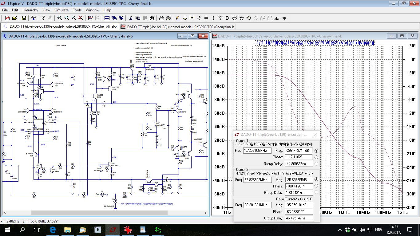

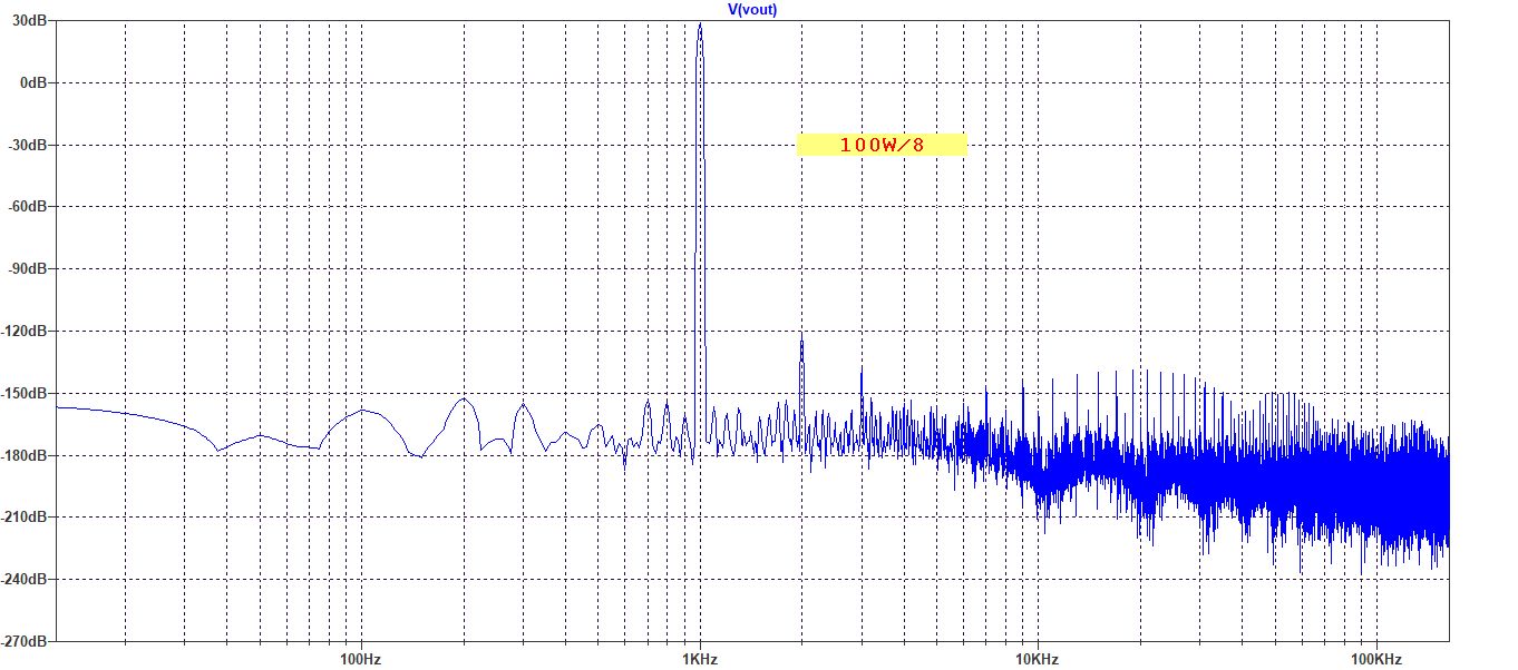

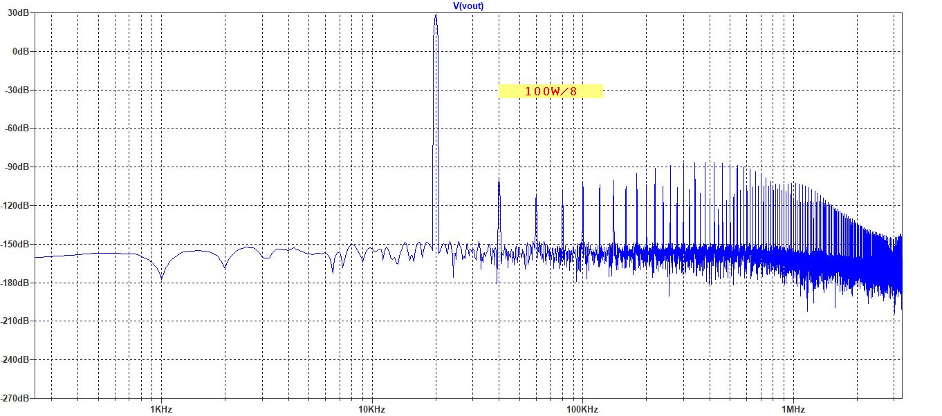

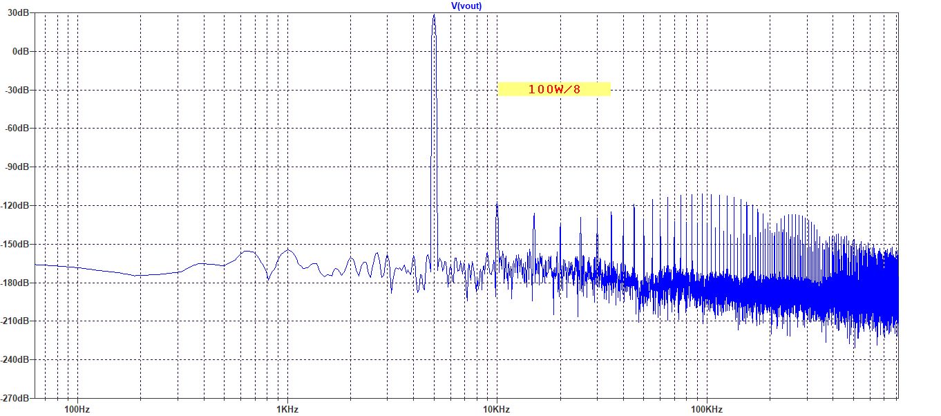

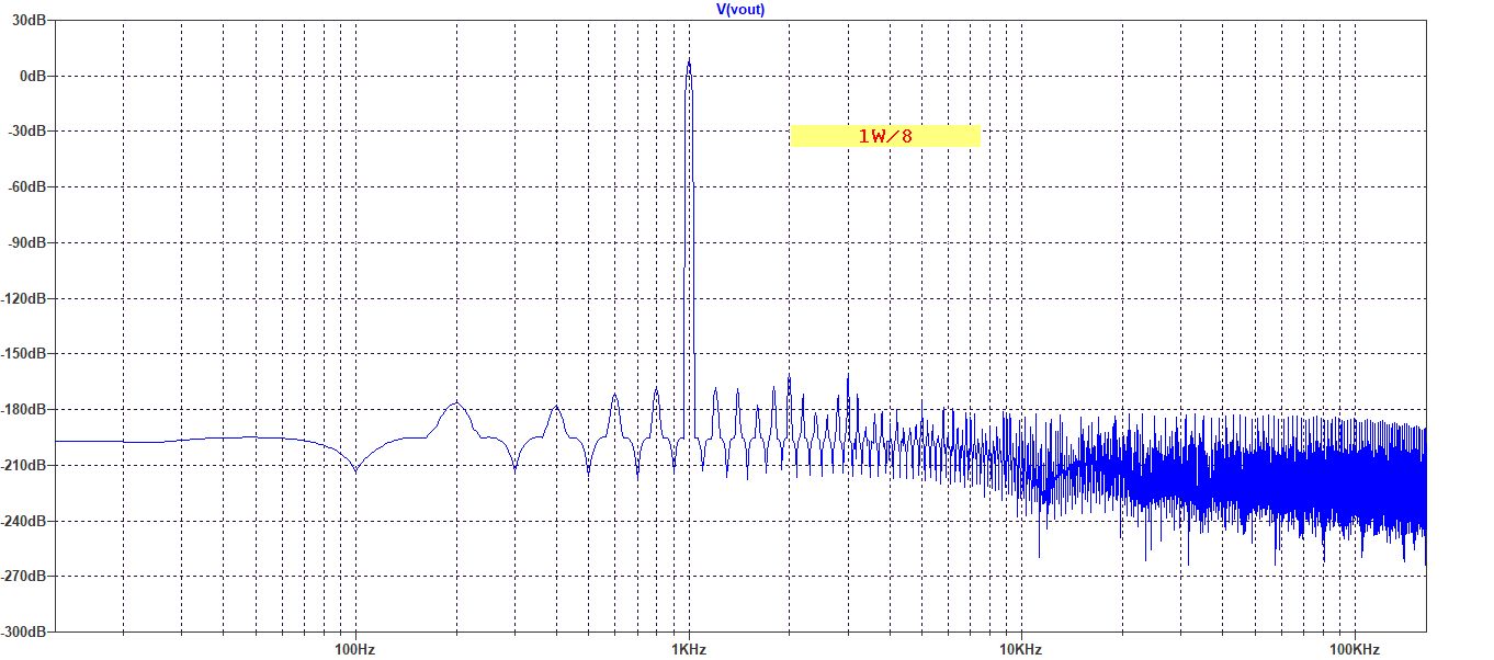

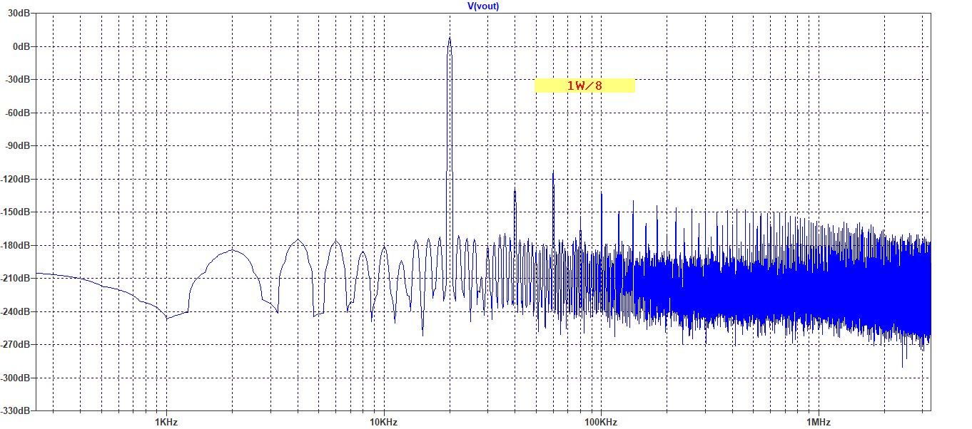

Some specification:
ULGF = 1.7 MHz
PM = 63 degree
GM = 35 dB
SR = 150V/usec
THD20k less than 1 ppm at 100W/8
THD1k less than 0.1 ppm at 100W/8
ULGF = 1.7 MHz
PM = 63 degree
GM = 35 dB
SR = 150V/usec
