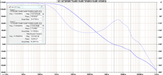

The attached shows the result of a reworked compensation scheme to accommodate 22k & 820 Ohms in the FB path. I think you know already why these two are interesting numbers?
Compared with your approach in #632, due primarily to these higher values, HF performance is reduced very slightly by .1~ ppm.
The arrangement of compensation components to produce this result are notably dissimilar to #632 and are also somewhat off the grid of standard TPC, TMC etc.

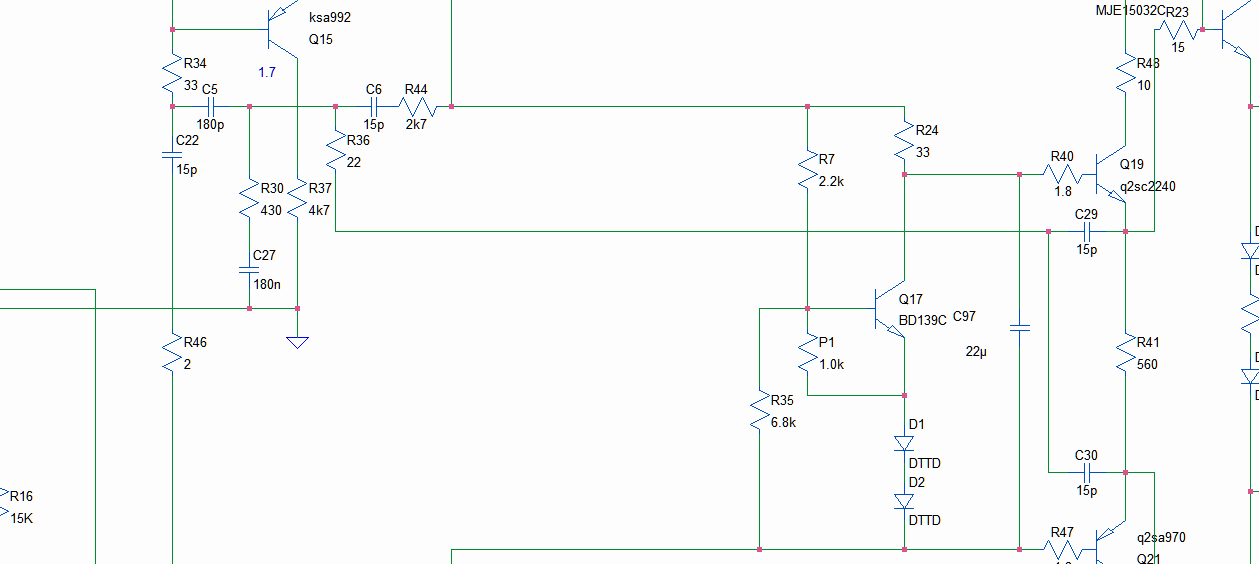

This is still a work in progress...
...to determine final values against likely parasitic strays and to confirm stability with the new inner loop.
The 2 Ohm resistor on the left is part of that effort. It connects before the FB network; after the output of the Tian probe.
I would be pleased to hear any critique you may have of this approach.

Could you show what you've changed in the schematic? No, I don't know why 22k & 820 values are important, I think that is better to have lower impedance FB network.
I tend to agree with you that lower FB values are generally preferable and indeed sometimes can be safer. However, you have used these same values in previous designs and again in your 'cold buffered' differential input arrangement as seen here.
From study of that method I note that the overall amplifier performance is quite dependant on the quality of the output of the cold buffer. In this case higher FB values are beneficial because it then has less 'work' to do.
For a very high performance amplifier such as the one in this thread. In order to obtain balanced operation by cold buffering do you think it would need to have a FET based input or would a BJT one provide a sufficiently good match?

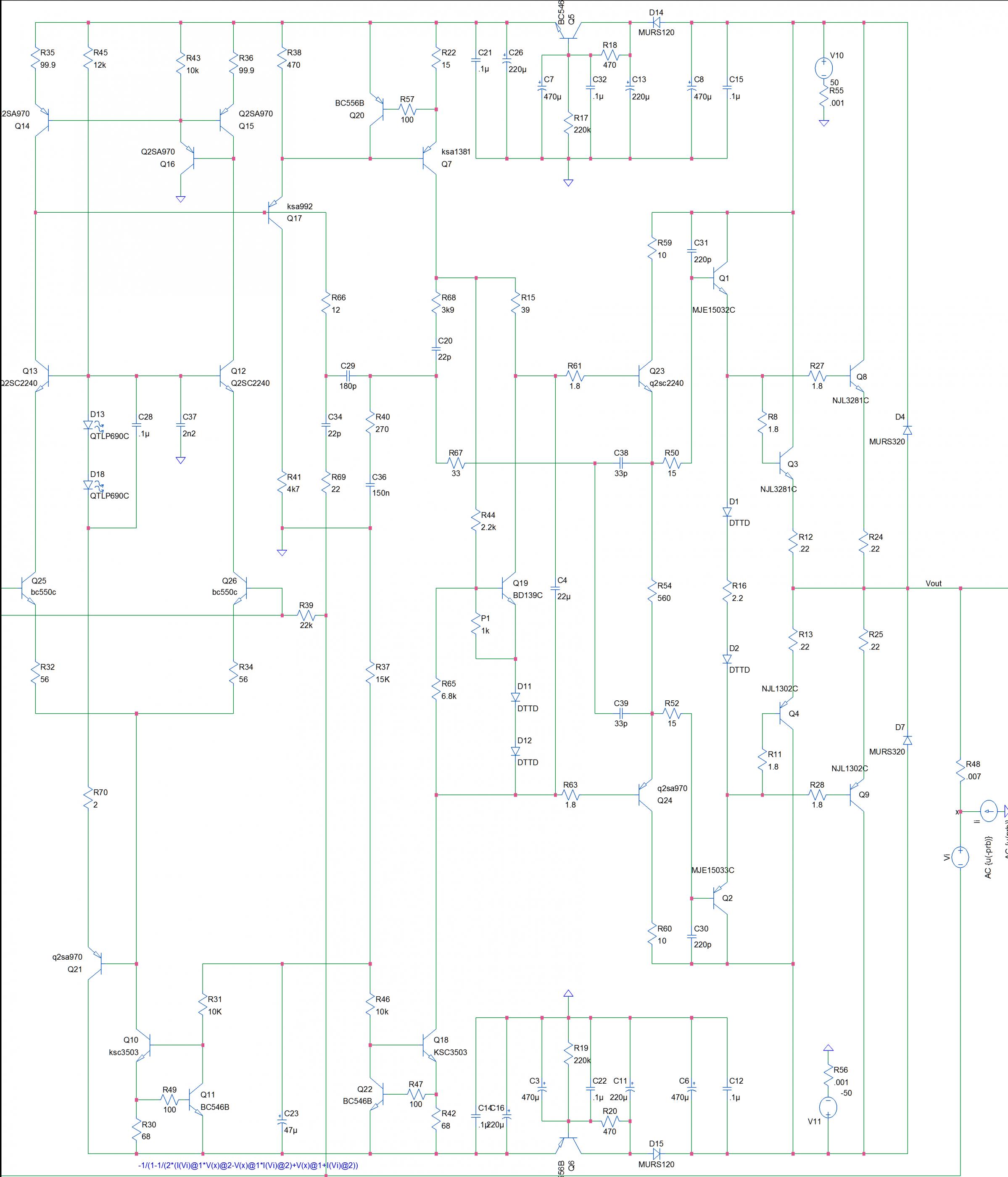

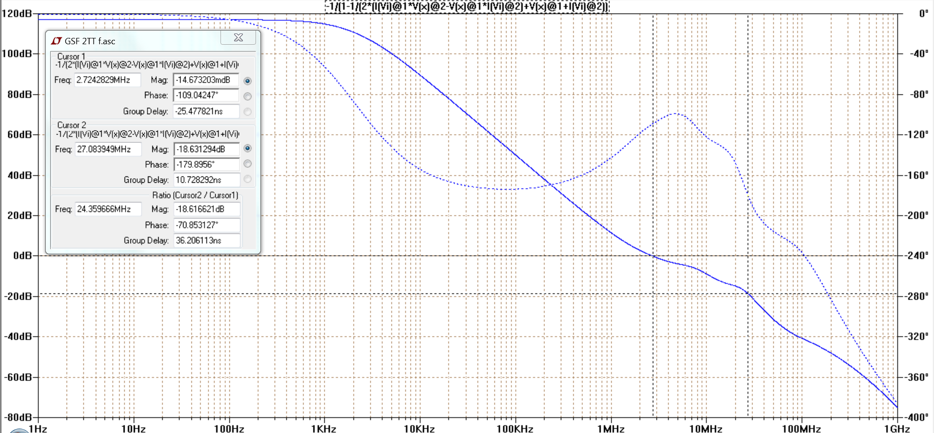

After further rework the circuit now has a degenerated BJT LTP. Off to the left is a servo and cold buffer.

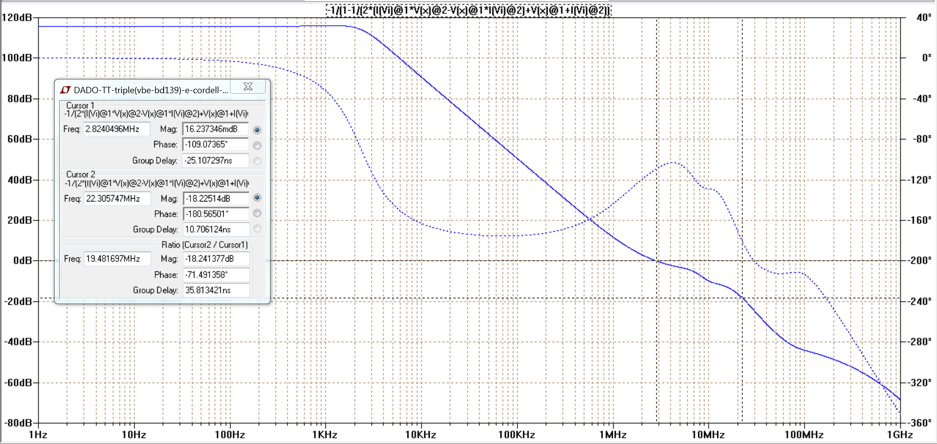

Following an approximate analysis for strays and taking your advice into account the new compensation is now more effective and resilient.
The THD performance is still remarkably good and due to the high quality of the cold buffer is almost entirely unaffected by balanced or single ended connection. The relevant numbers are in each image filename.
Do you think 56 Ohms is sufficient degeneration for the LTP and would you have any concern that the ULGF is still ~2.7MHz but now with 22k & 820 in the FB path?
![dadod cube - logician coldbuf circuit nucomp g1.jpg dadod cube - logician coldbuf circuit nucomp g1.jpg](https://www.diyaudio.com/community/data/attachments/559/559619-8a8868bfefe64e68295acd1b146c13e9.jpg)
![dadod cube - logician coldbuf loopret nucomp PM71deg GM18.6db UG2.7Mhz g.png dadod cube - logician coldbuf loopret nucomp PM71deg GM18.6db UG2.7Mhz g.png](https://www.diyaudio.com/community/data/attachments/559/559671-60d0abe155b01baca8208121bae53d81.jpg)

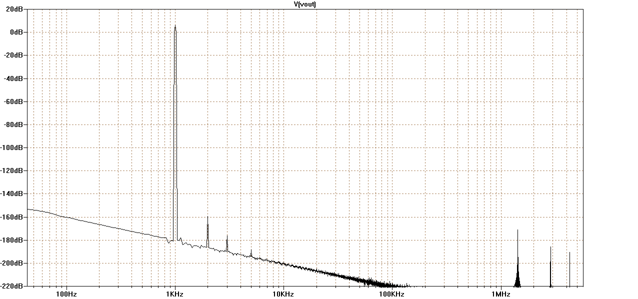

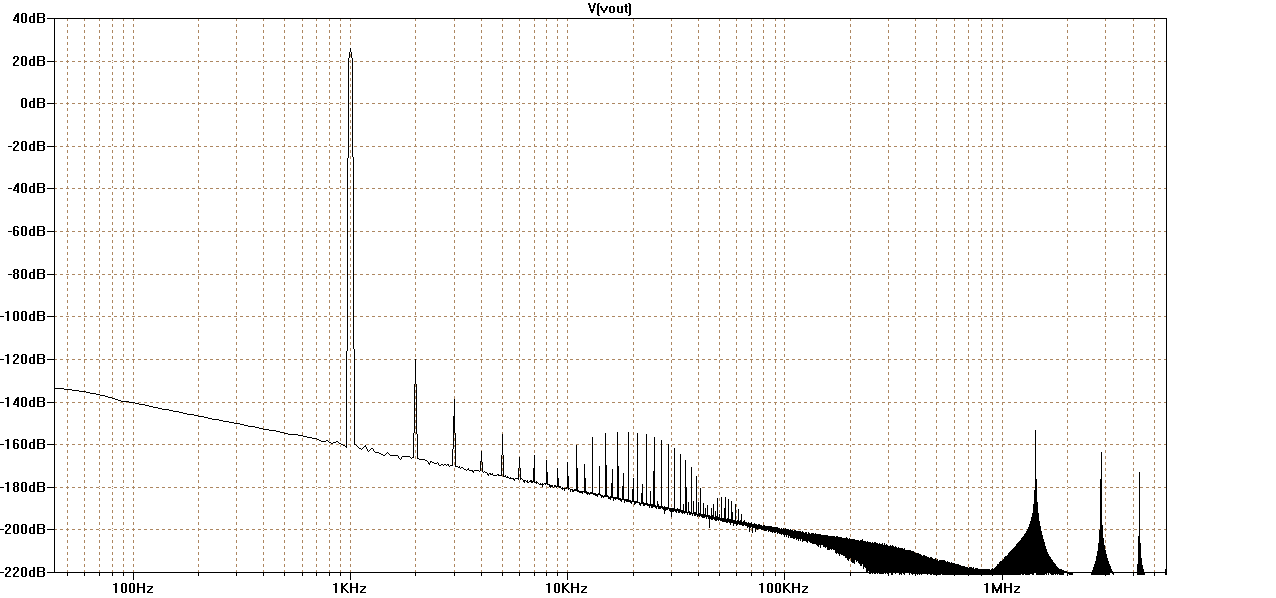

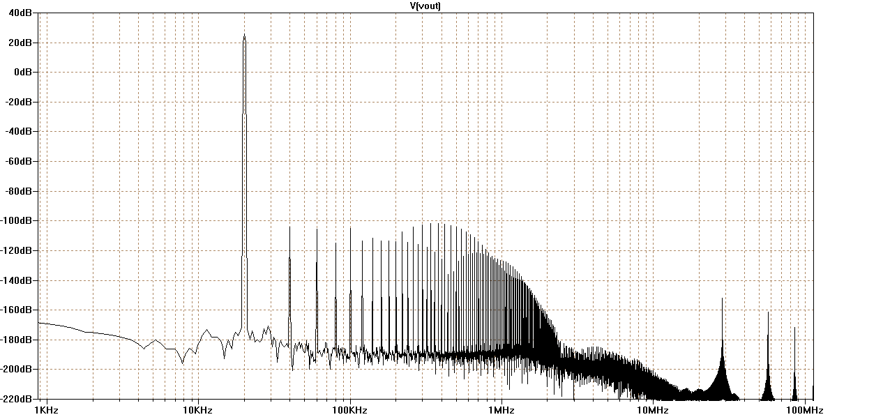

![coldbuf cube 1K 1W 8R T9HD 0.01 ppm.png coldbuf cube 1K 1W 8R T9HD 0.01 ppm.png](https://www.diyaudio.com/community/data/attachments/559/559708-356245a07e85396f3482e4bd37762721.jpg)
![coldbuf cube 1K 100W 8R T9HD 0.05 ppm.png coldbuf cube 1K 100W 8R T9HD 0.05 ppm.png](https://www.diyaudio.com/community/data/attachments/559/559720-4a503fbb0bb40b1c19928a0da85c8f3b.jpg)
![coldbuf cube 20K 100W 8R T4HD 0.43 ppm.png coldbuf cube 20K 100W 8R T4HD 0.43 ppm.png](https://www.diyaudio.com/community/data/attachments/559/559731-7c4e1bd692fef56897696d19881fdf4a.jpg)

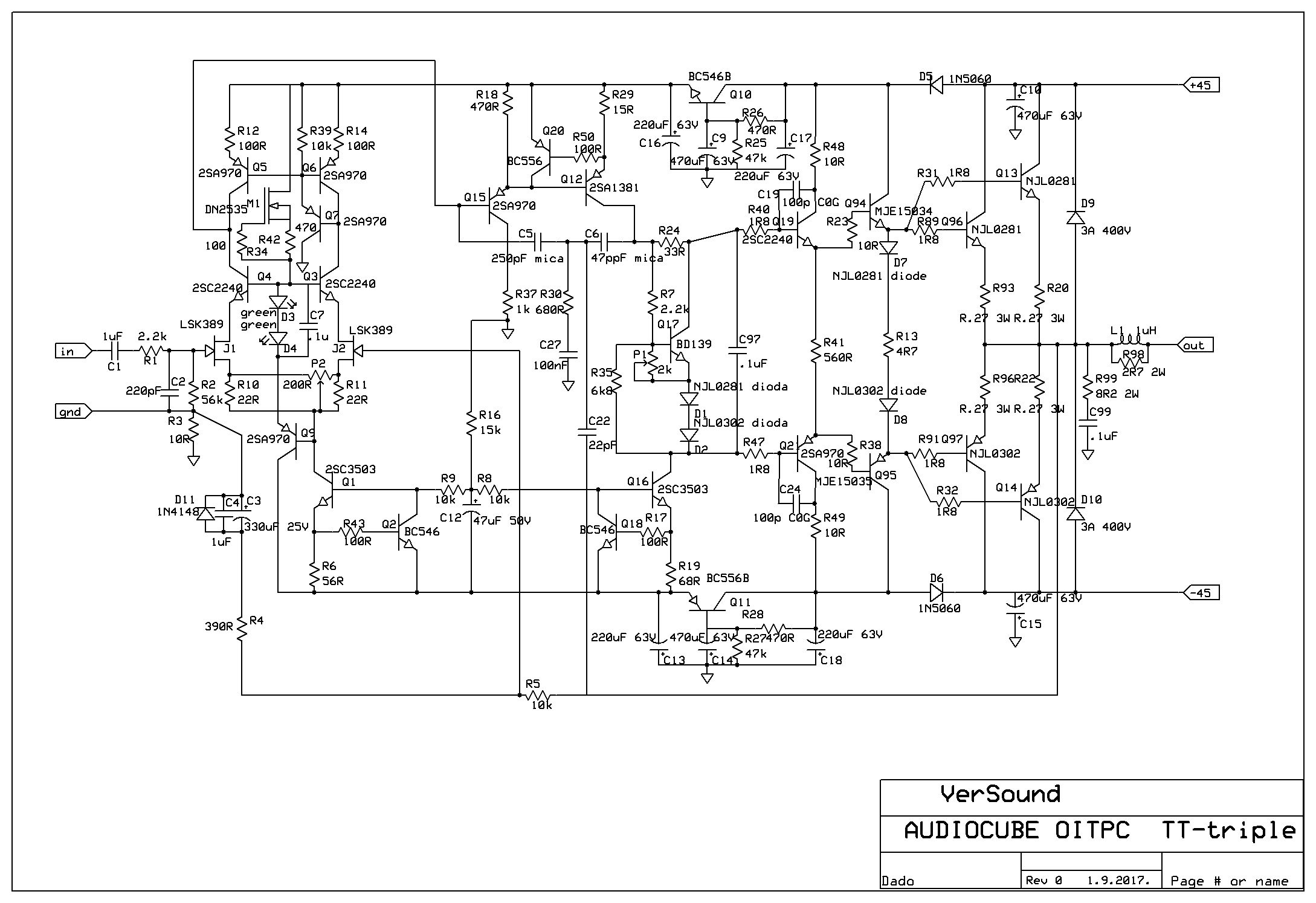

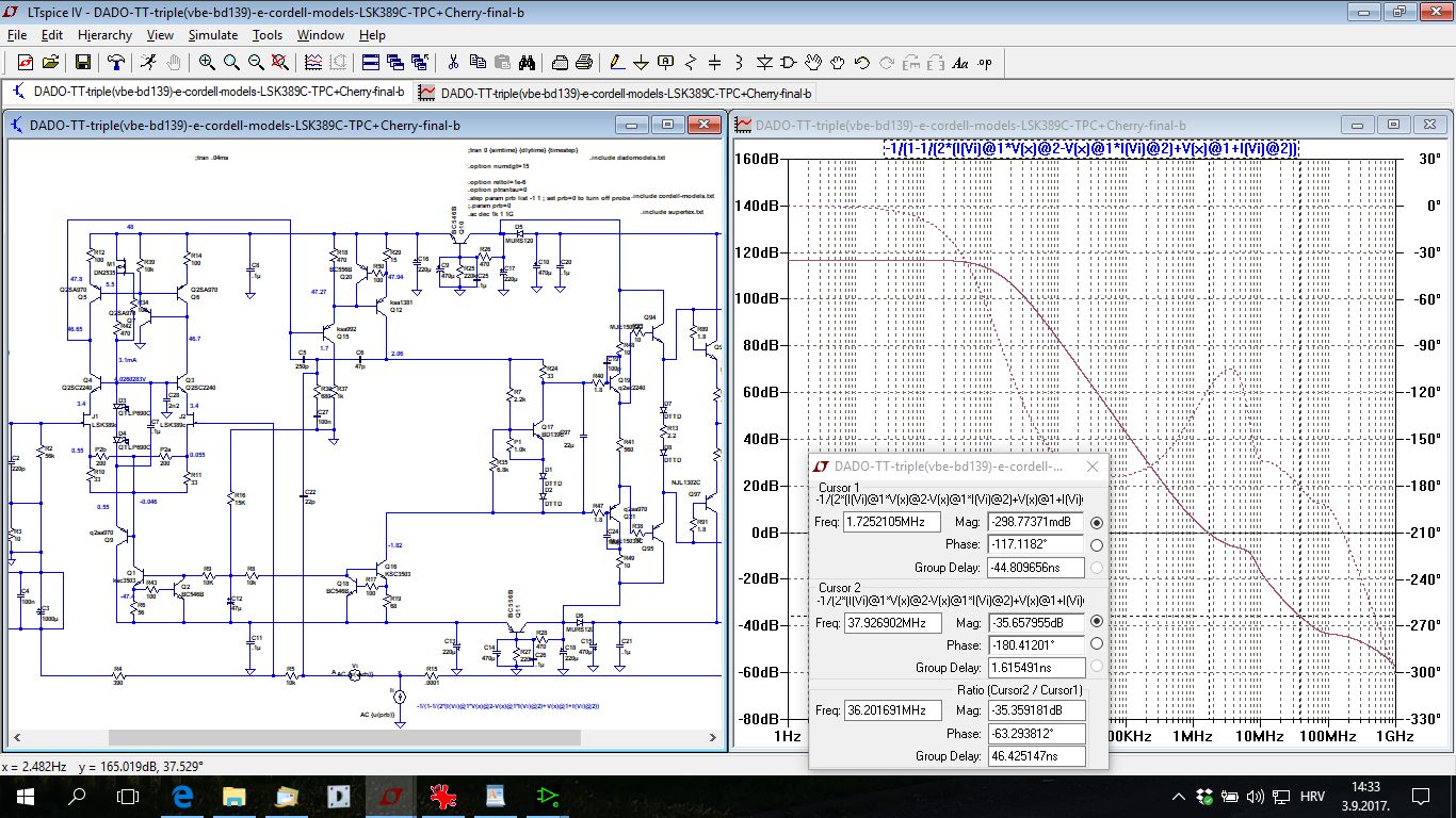

I used my own type of compensation in my CFA amps, parallel TPC, one around VAS and one from the output too, I called it OITPS (output included TPC).
It showed some advantage over TMC, more PM and GM.
I decided to try it in my VFA TT amp so here it is.
Simulation showed quite good result and I went to the practical implementation. First attempt showed some oscillation, and it was resolved by moving Miller compensation from the drivers to the pre drivers (triple is notorious for instability).
Here is the schematic and simulated Loop Gain. The modified amp is playing now, it looks very stable and nice sounding.
So far so good.

Nice. So about 30% compensation from output, 70% compensation from VAS output.
I choose it by simulation to get good Phase and Gain margin. Here the OPS is triple and more sensitive to self oscillation. In my CFA I used simpler OPS, only divers and output MOSFETS., and there was possible to use almost fifty fifty compensation.
