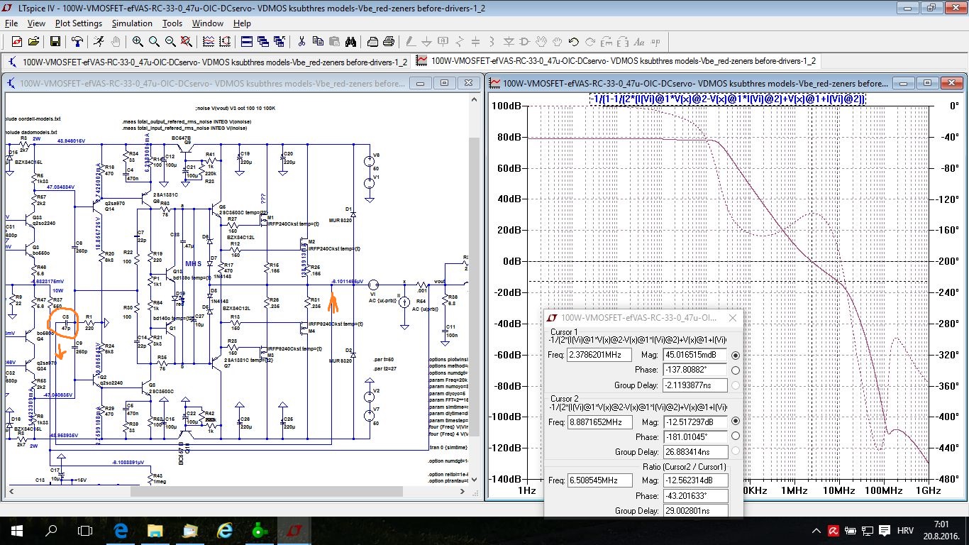

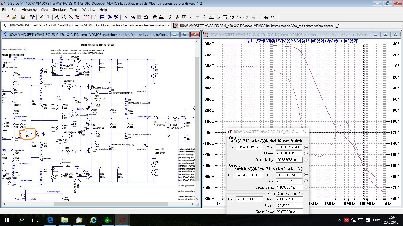

Hi David,
I could be that as I see it is not correct, but my simulation was confirmed in real amps.
If you look again #post 806 http://www.diyaudio.com/forums/solid-state/182554-thermaltrak-tmc-amp-61.html#post4755022 ,first plot is where Tian probe is in correct place, it cover both, GNFB and nested NFB from the output to the VAS input(R23).
Next example is from my CFA, first plot is correct as it cover again GNFB and nested NFB via C8.
Best wishes
Damir

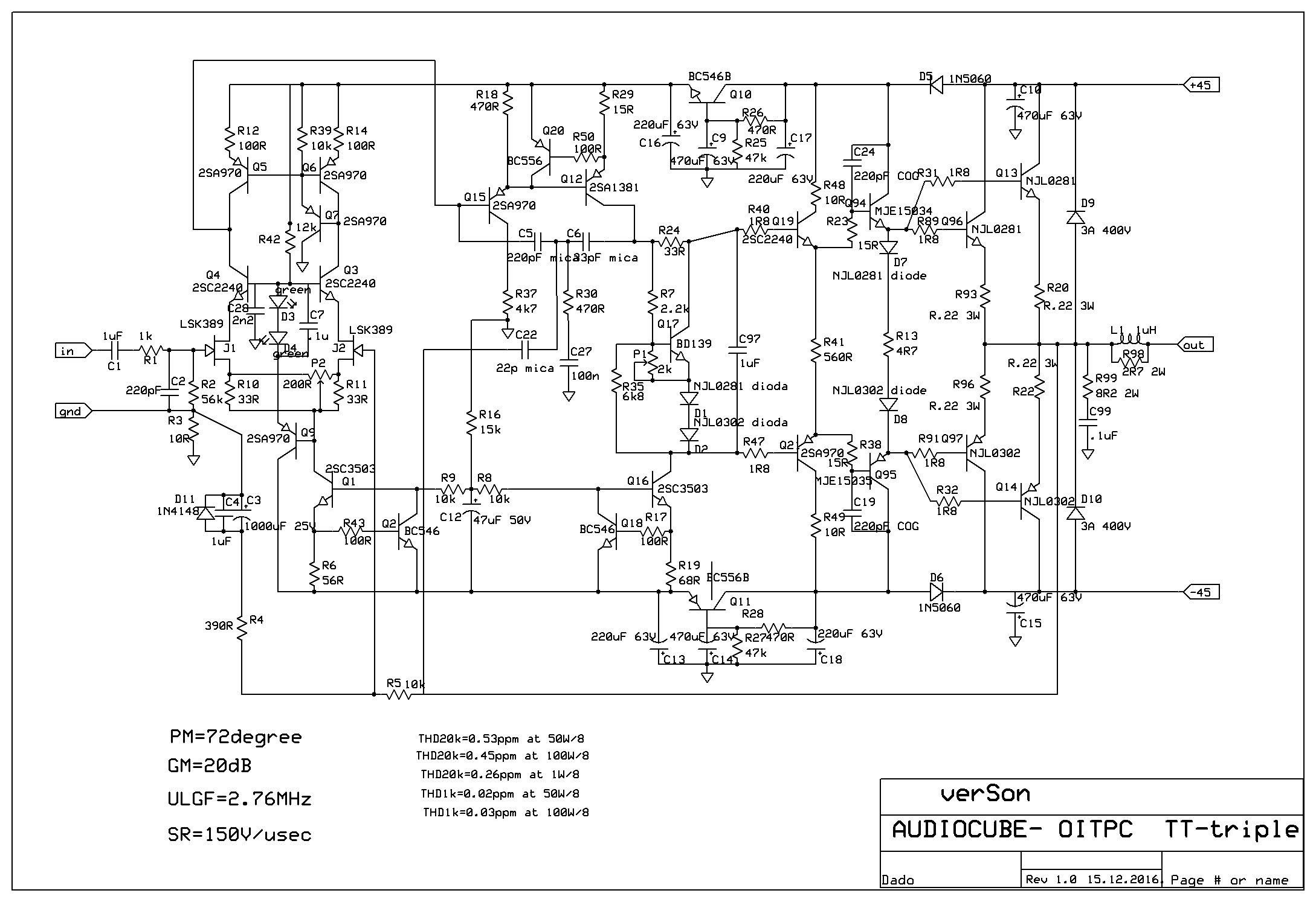

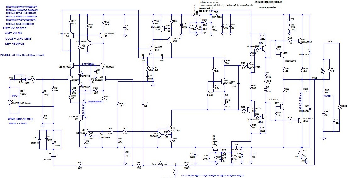

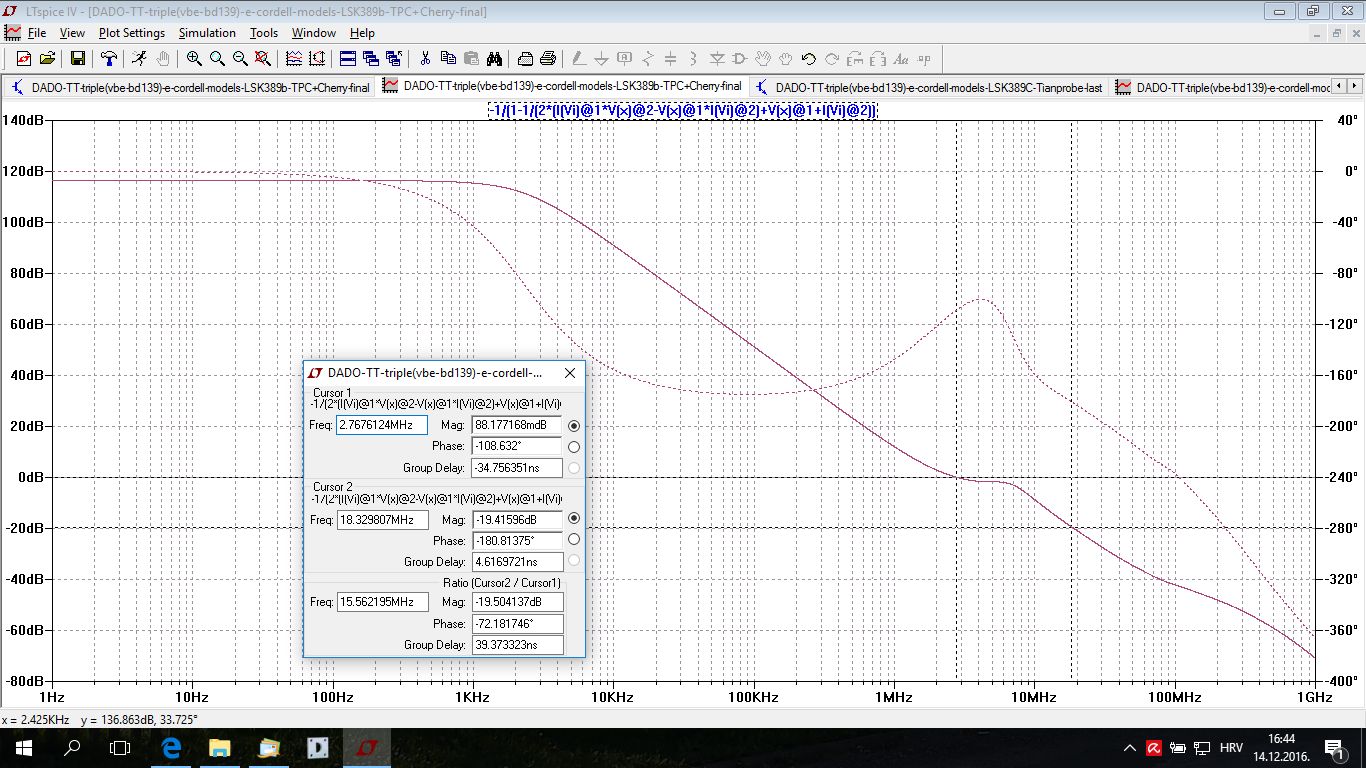

This is my TT VFA but now with different compensation, instead TMC I used here OITPC(Output Inclusive Two Pole Compensation), similar to the one I used in mine CFA.
With some other changes and simplification distortion is lower and the amp is more stable with better Phase and Gain Margins.
Damir

This is my TT VFA but now with different compensation, instead TMC I used here OITPC(Output Inclusive Two Pole Compensation), similar to the one I used in mine CFA...
So the loop plot is with the Tian probe in the outer loop?
I need to think more about the loops around the VAS, but first impression is that it looks pretty nice, my compliments.
Best wishes
David

How close is this to the original? Can it be built on the original boards with minor modifications?
Thank you, I think that is the dominant loop, so we are in accord now.
But I would be curious to study the inner loop, there should be non-minimum phase behavior similar to what we discussed when you noticed it in an earlier circuit.
Could you post here or email me the ASC?
Best wishes
David
Hi David,
Here is the .asc
BR Damir
  • DADO-TT-triple(vbe-bd139)-e-cordell-models-LSK389b-TPC+Cherry-final.asc

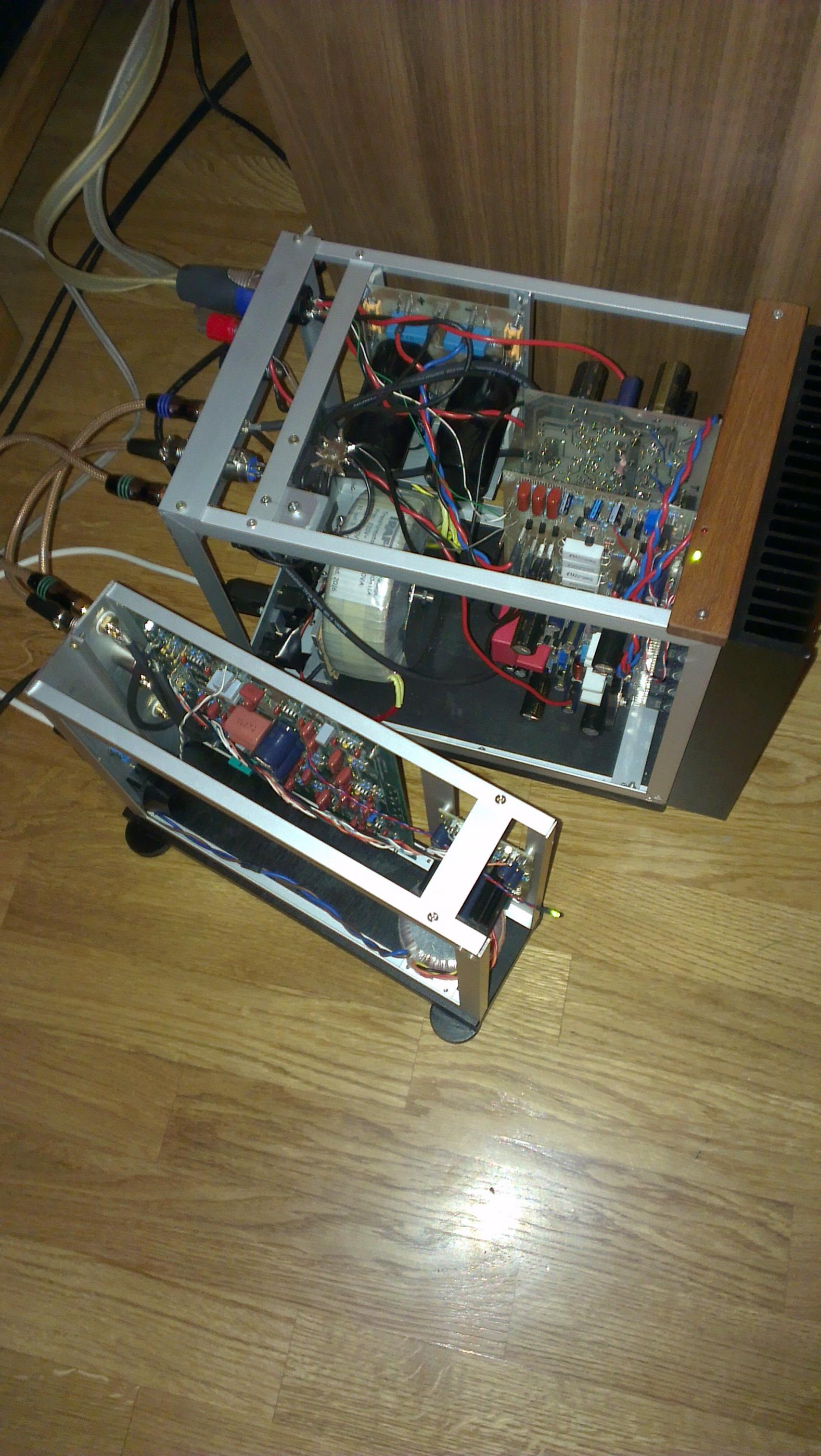

Finally after years I put in boxes mine three channels TMC ThermalTrak amps. When I started with my design it was intention to use those amp to drive majestic Linkwitz Orion loudspeakers. It is here now, not yet completely finished, boxes cover is missing, but it works and sound fantastic. Useded are analog active crossovers designed by Likwitz and the smaller boxes are that.
Damir

Hi Damir
Discussion in another thread reminded me to have another look at the OITP Compensation and I noticed a bit more this time.
I have found that it works well to put the Bode step in the feedback network, so a capacitor across the feedback resistor R6
I know that Bob Cordell doesn't recommend this because of possible RFI but it looks the optimal way to maximize feedback.
A few European papers refer to this as a "phantom zero" if you want to check the literature.
Have you considered this approach? it may permit you to simplify or reduce the internal nested loops.
Of course, your results are already so nice that the idea is more for educational interest.
Best wishes
David

Hi David,
I know about Cordell recommendation and I agree with him. A capacitor parallel to the feedback resistor helps in some way but introduces problem too. In my compensation the capacitor is connected from the output to the middle point of the TPC compensation, in my case where C5, C6 and R30 meet. In this case I've got much better PM and GM. It's similar to the Cherry compensation, but not exactly, Cherry does not use TPC.
Best regards
Damir
