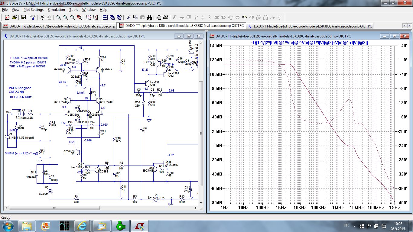

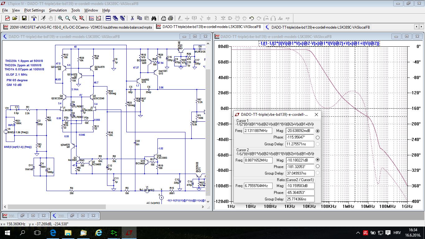

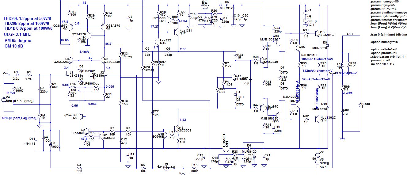

This uses the same compensation principle as in my "200W CFA MOSFET" or "Unique" amps, and I call it Output Inclusive Two Pole compensation (OITCP).
The main advantage over TMC I used in this TT amp is much better Gain marine, hence better stability.
--------------------------TMC------------- OITCP
THD20k at 100W/8---- 1.91 ppm------- 1.64 ppm
THD1k at 100W/8----- 0.03 ppm------- 0.02 ppm
ULGF-------------------- 2.26 MHz------- 3.6 MHz
PM---------------------- 63 degree------- 69 degree
GM---------------------- 9 dB------------- 23 dB
BR Damir
BR Damir

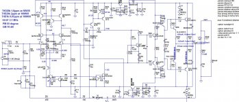

Can you add a link to this (new) sch into post1?
The link added.
This is in some way simplified and in the same time enhanced version of this TT amp.
It has increased open loop bandwidth (Groner fig. 55, comment on Self book) and less GNFB, exceptional PSRR(R33 and C12 connected to the ground) and very low THD.

Hi Damir
Nice to see your continued work.
I think you need to move the Tian probe to accurately see the Return Ratio around the OPS.
It needs to be from the OPS before the link (R23) to the intermediate section.
R23 is fairly hi impedance so it may not make much difference but may as well be correct.

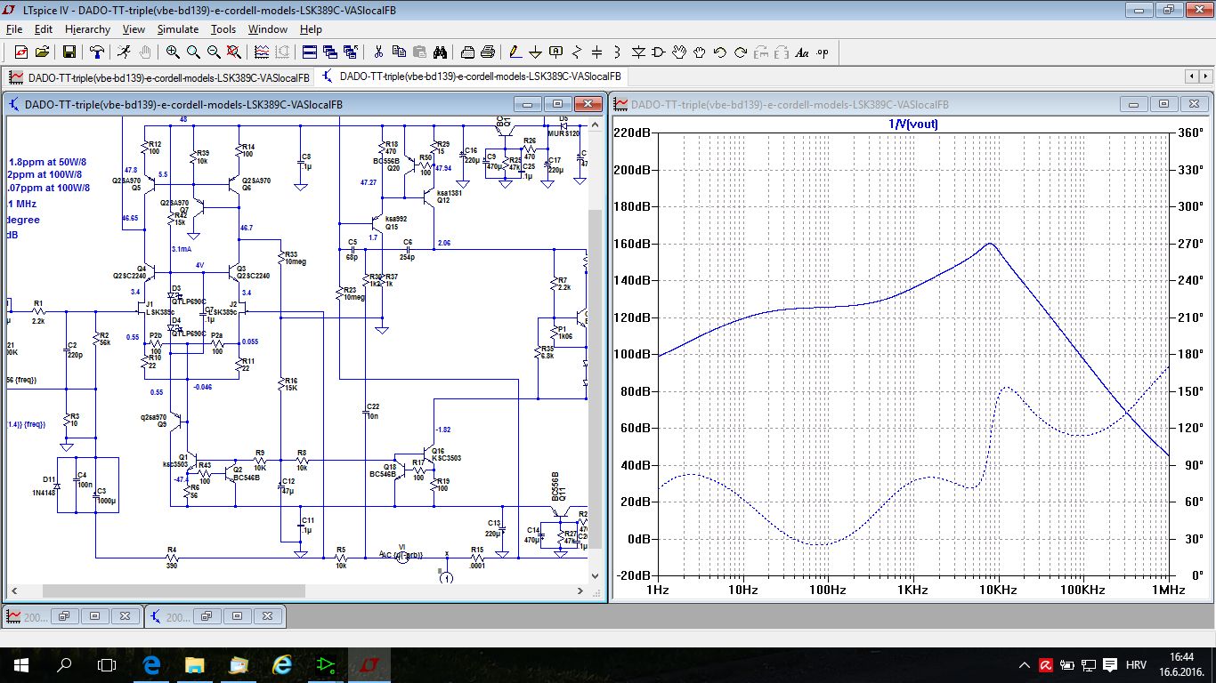

But I still haven't worked out the other loops, I don't understand what the last plot is?

Hi David,
I am all the time doing somethig with audio, just a bit less now when there is more work around house. I haven't seen you around lastly here.
I don't think moving Tian probe will show some difference, but I will try it, just next days I have a tablet only with me.

... Tian probe will show some difference, but I will try it, just next days
I think you are correct, the difference should be very small as the circuit now is, but better to have the probe where it should be, then no surprises if you start to modify.
Also people who copy your circuit can learn the correct technique, they may
not be so experienced as you to know when it does or doesn't matter
Finally, perhaps we are mistaken, sometimes your complicated feedback has not behaved as I initially expected, very educational to understand why.
