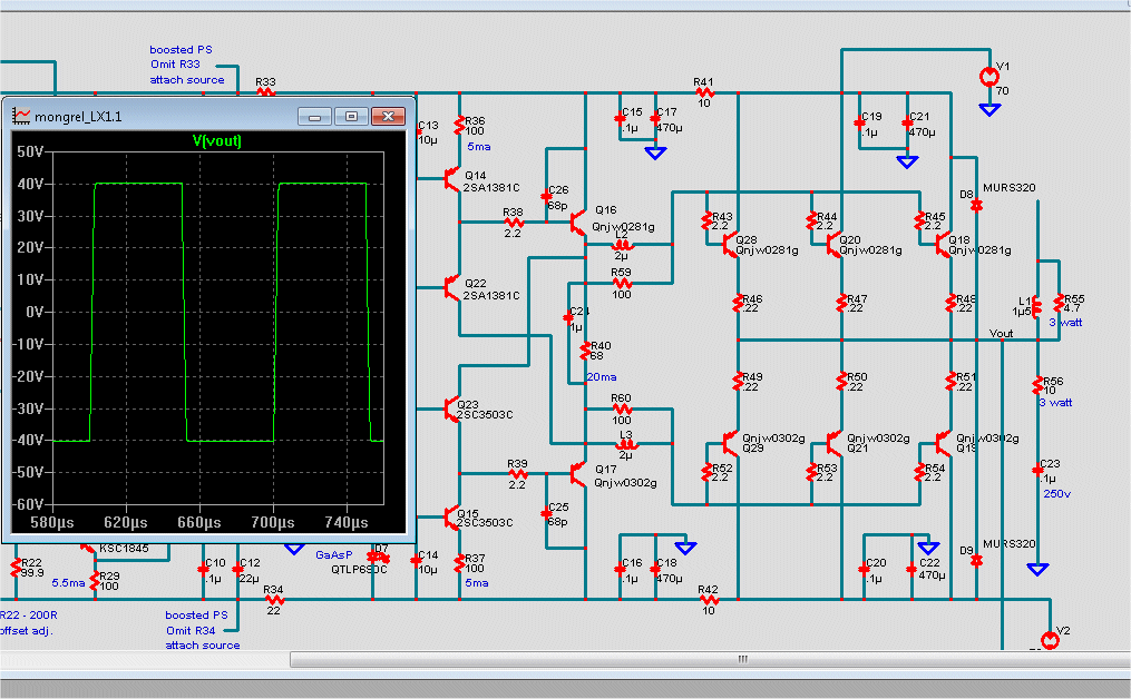

triple territory.
I have just a tad of ringing on my triple (not simmed). So you might want to simulate and leave your real world design open to a few stability enhancements.
Besides the pre/driver RC decoupling Cordell advises on , here are a few additional "tricks".
The B/C driver stopper caps are from the APT1 and the parallel L/R network is a Harmon Kardon "trick"... both reduce the VHF bandwidth of the stage without any degradation. The HK L/R works similar to the main OP inductor typical of most amps. Both mitigate negative resistances at the OP bases , augmenting the basestoppers action.
PS - make your own "L/R" by wrapping 20-25 turns of thin wire around a 100R 1/2w resistor.

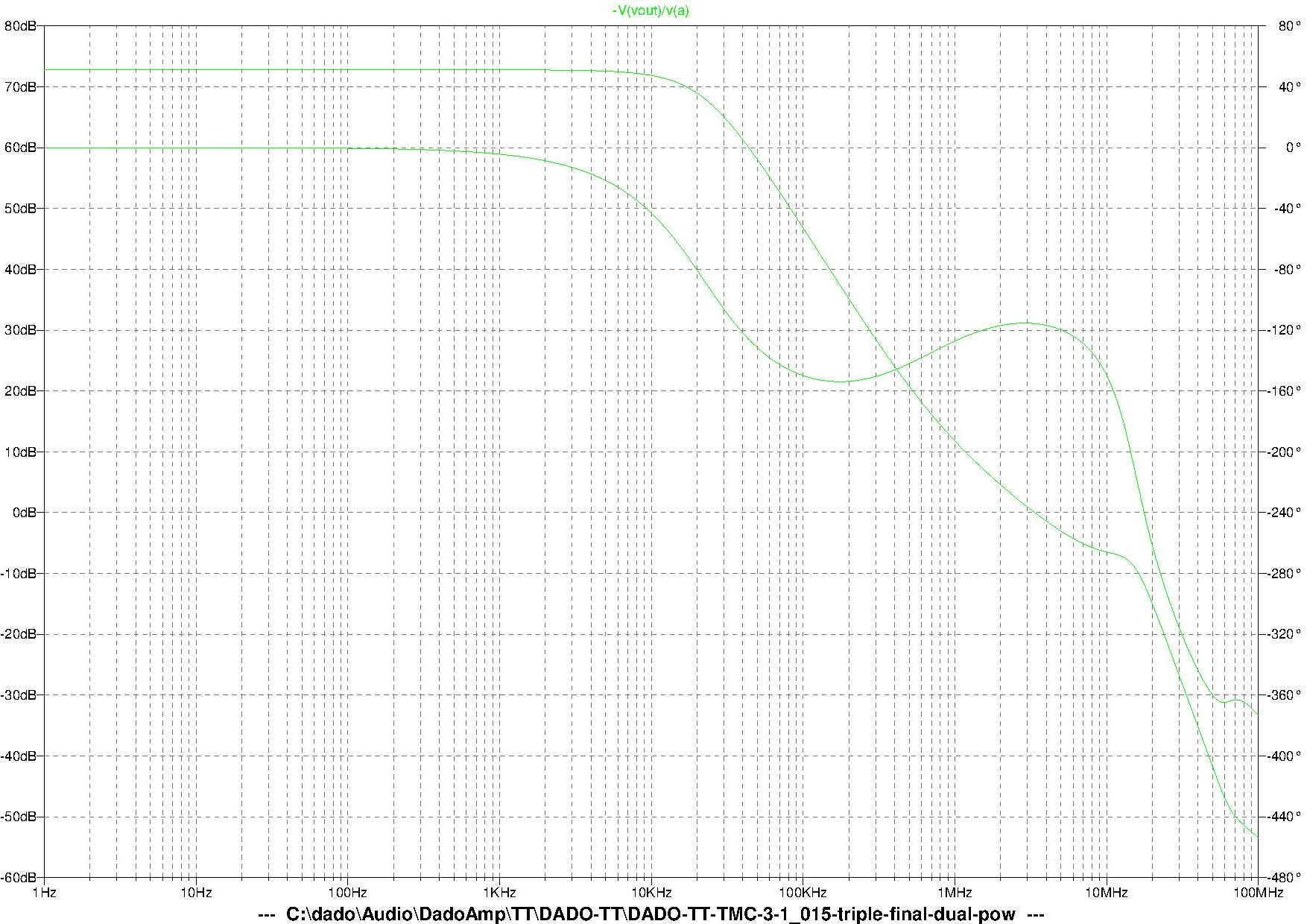

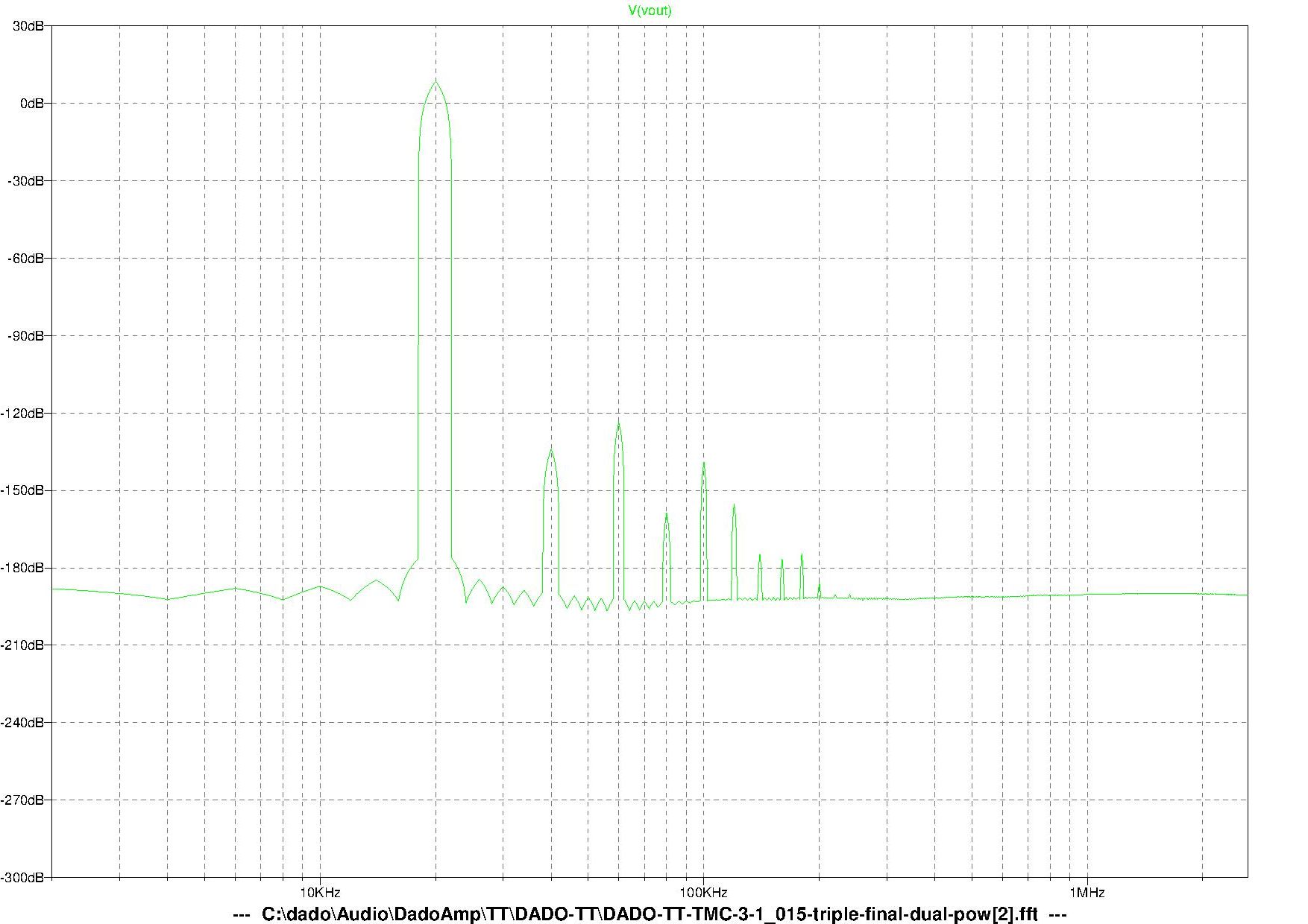

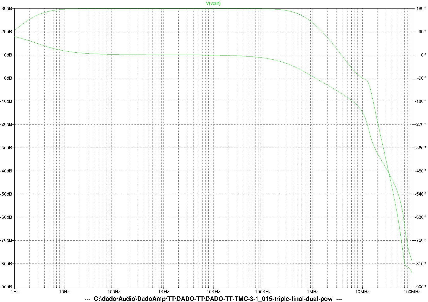

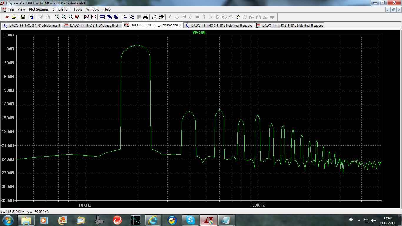

With small changes in TMC is possible to get below ppm at 20kHz and 80W/6R.
Input 0.12v 20kHz
1W/6R Total Harmonic Distortion: 0.000026%
Input 1V 20kHz
80W/6R Total Harmonic Distortion: 0.000093%

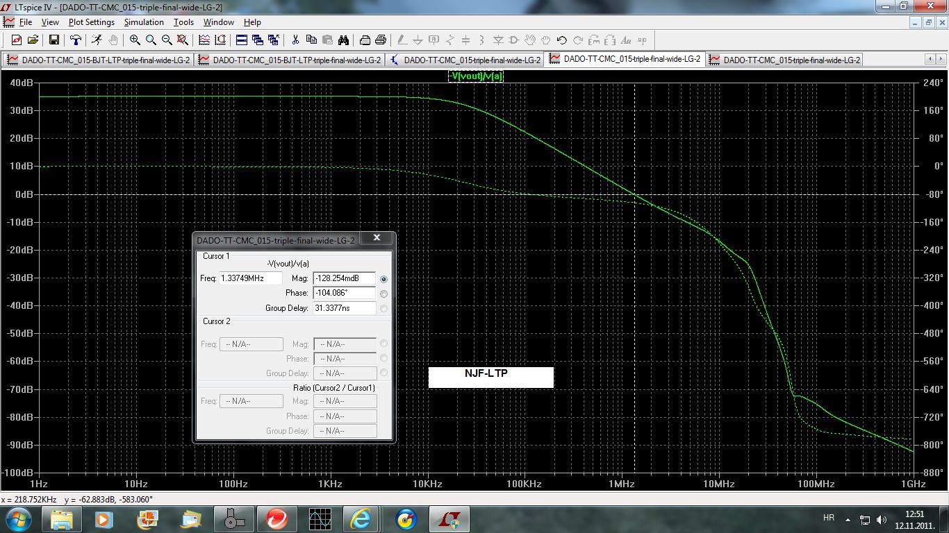

Diagrams in this order:
schematic, FFT 1W, FFT 80W, OLG and CLG
Someone can ask why I use local VAS feedback R15//C22. Whitout it disstortion is even lower, but the phase is passing dengerously close to 180 degree, and with this arrangement it is much smoother.

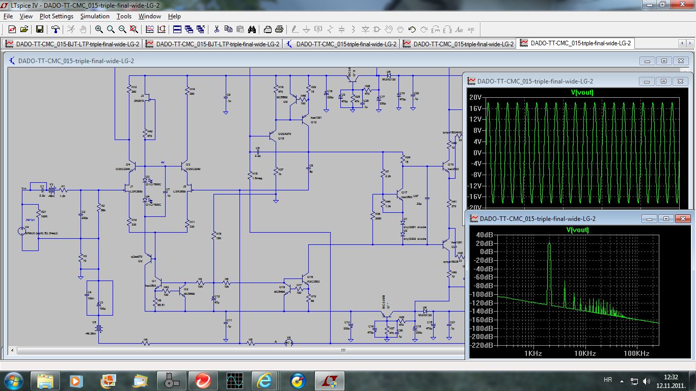

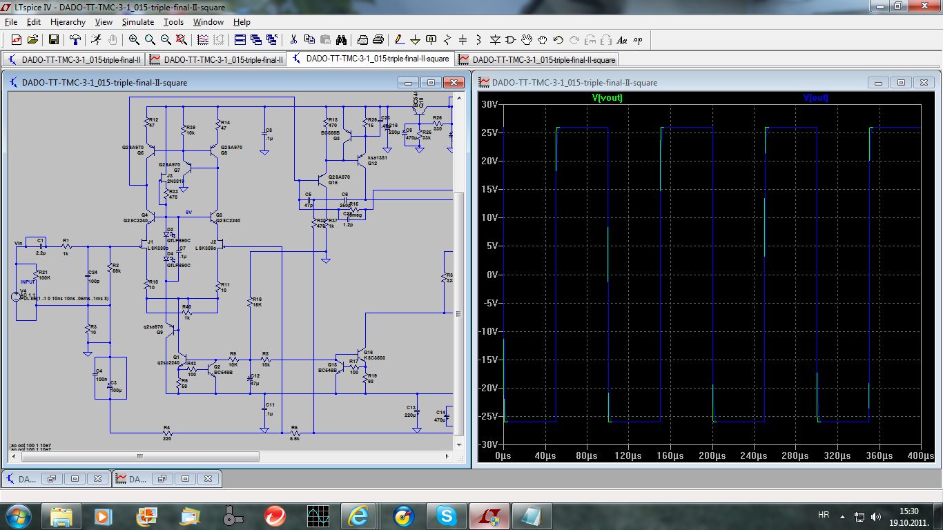

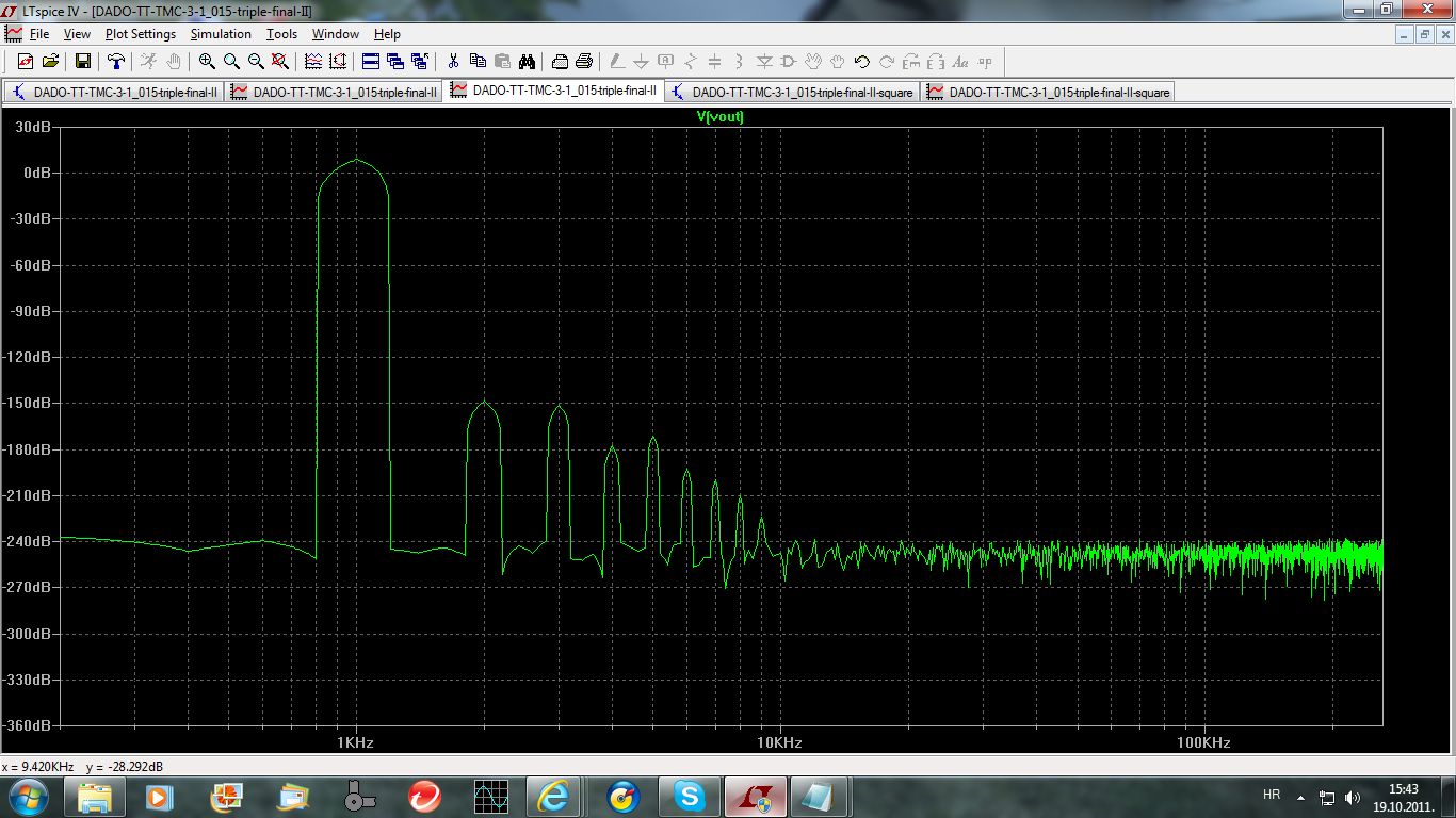

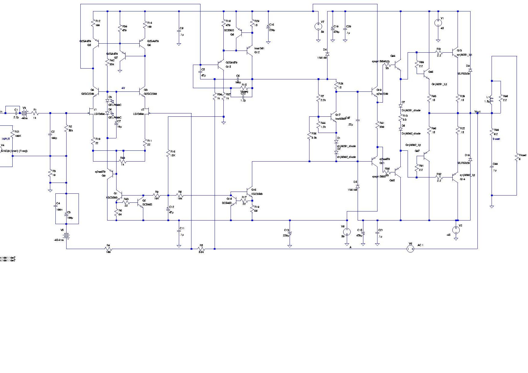

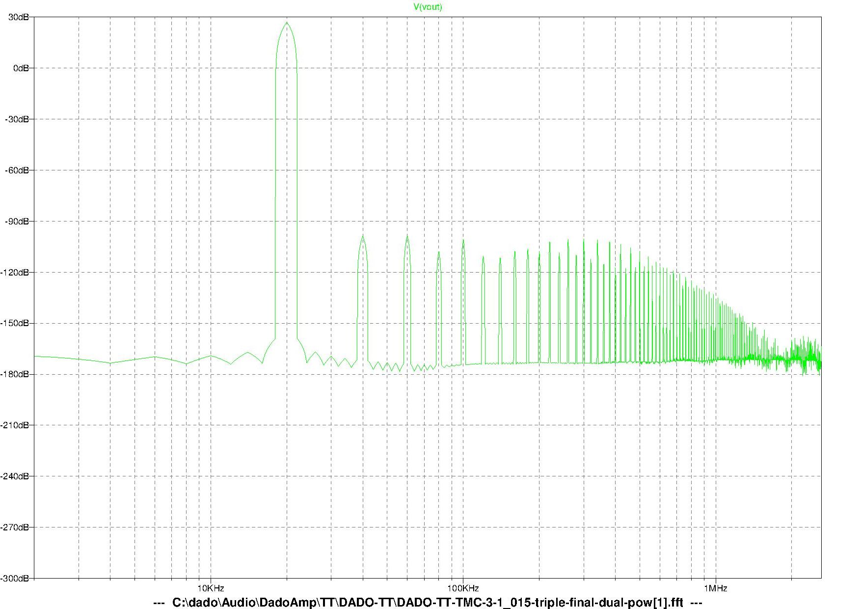

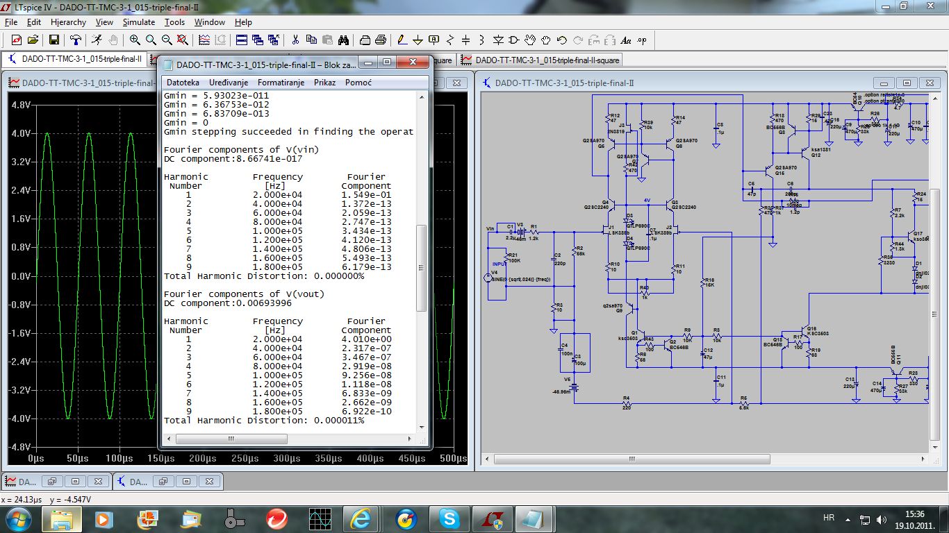

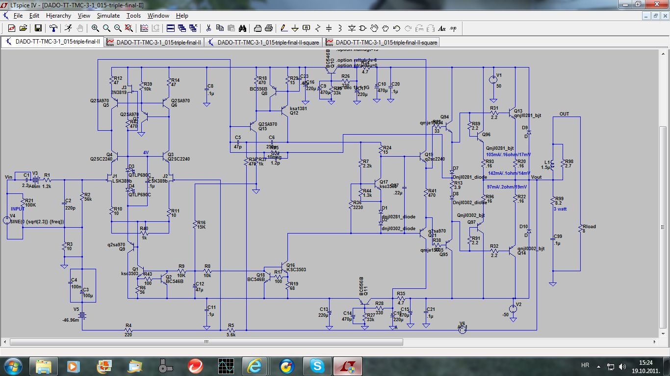

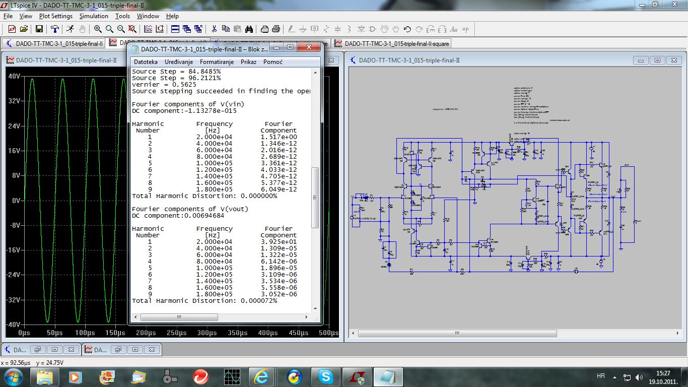

Finally I am going to test this amp.
Last simulation are here and this is going to be the schematic I will use for real life test.
Some simulated data are here:
THD20k at 100W//8ohm is 0.72ppm
THD20k at 1W//8ohm is 0.11ppm
Slew rate with input filter 150V/uS
Slew rate without input filter 280V/uS
FFT atached are:
40W 1kHz
1W 20kHZ
1W 1kHz
dado

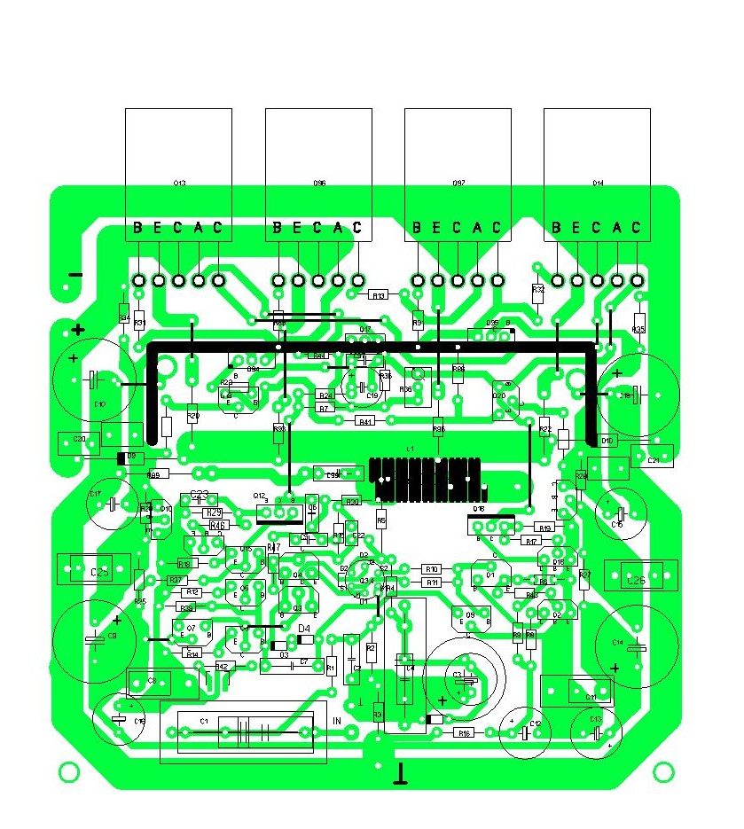

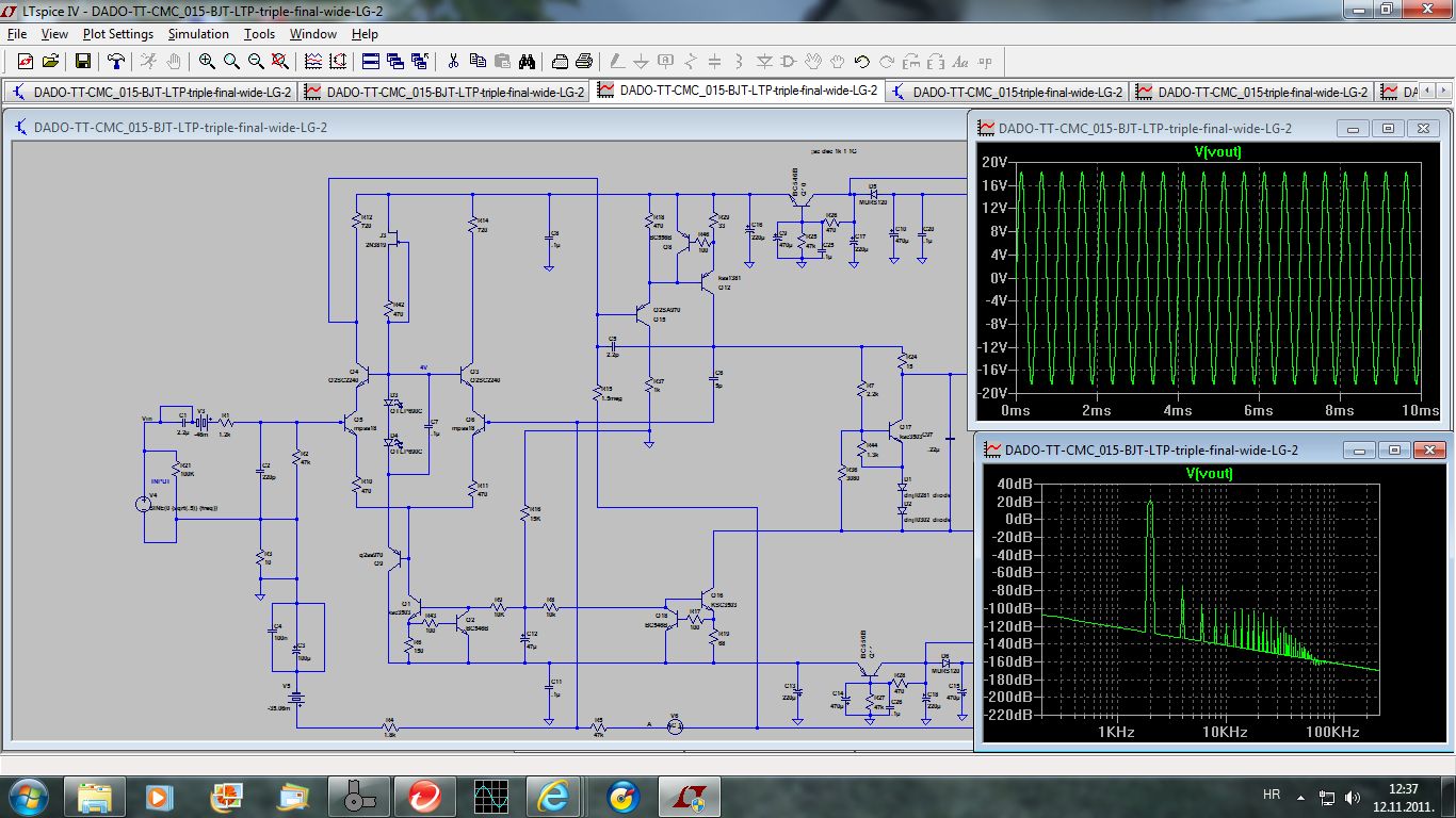

I've got idea to make universal PCB which I can use for more then one configuration of this amp. In this case it can be high Feedback amp, and low Feedback amp.
In this forum there are some discutions about high Feedback with very low THD, and low Feedback and higher THD but with more "benign" harmonics distribution.
Here is the PCB and simulation of two low Feedback amps, one with NJF LTP and other with BJT LTP. I think I am going to make one of both type, listen and hope to hear the differences.
dado
P.S. Important feature of the low Feedback amp is better phase and gain margin.
dado

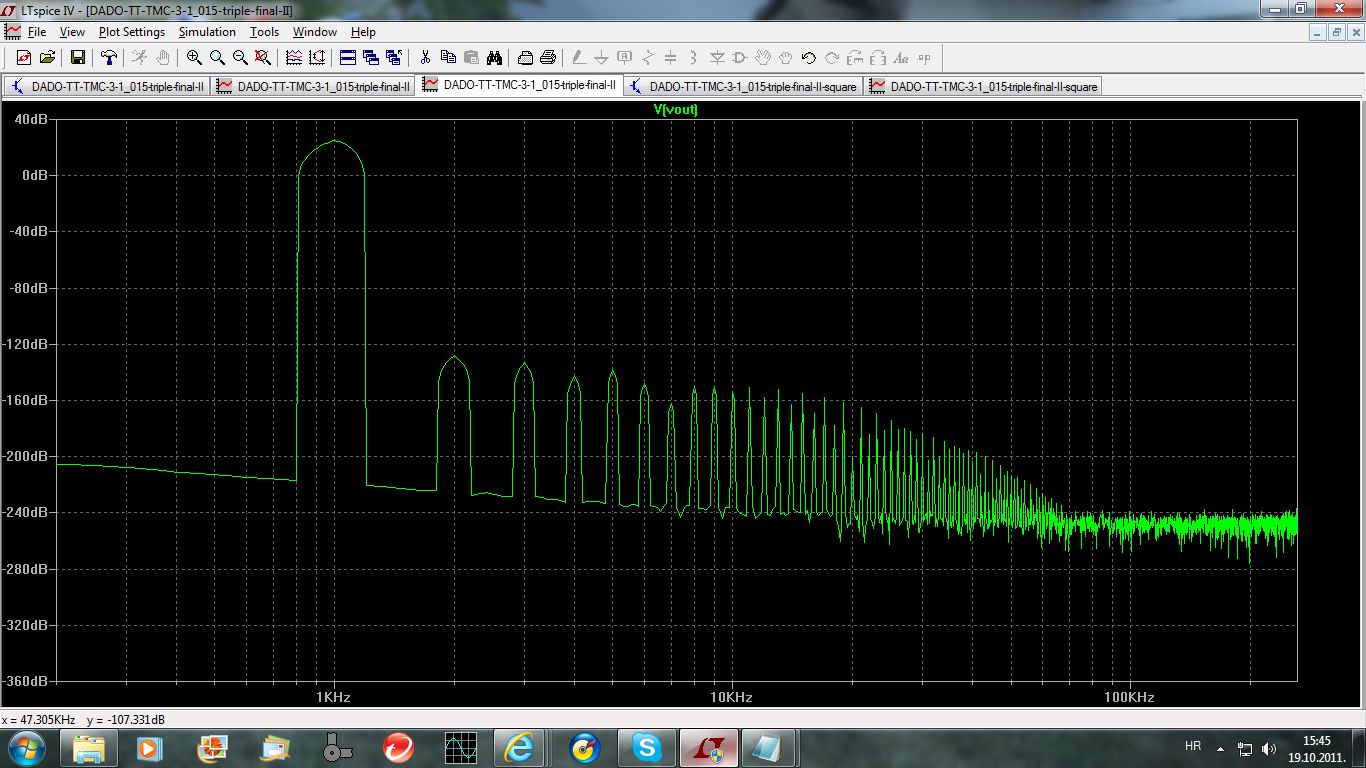

Dilemma
After listening to the triple and problem to stabilize it I am not sure if a triple is worth a hassle. I simulated here a triple and standard EF OPS.
IPS is the same for both amps, with NFET cascoded LTP, VAS is emitter follower before and emitter follower as buffer after VAS transistor and TMC is used. Global Negative Feedback is the same for both.
What you think looking at FFT for both of them? Distortion of the triple is lower but it is so low for both of them and I think no one could hear difference. Standard EF shows dominant second harmonics mostly.
dado

Hi
Sometimes in these threads the same problems come around and around ...
one reason Self's slew rates were asymmetrical was because of the CCS in the VAS stage. The trouble is with the resistor in series with the base, in dadod's circuit it is R38. This seems to have been a derivative of an old RCA circuit (used in their hybrid circuit HC1000) but was always a cheap fix to the problem of the CCS shorting the current source to the input stage if it were to saturate. Far better to use two reference diode chains and separate the bases of the CCS and the CCS for the input stage.
Although Cherry pointed this out, as well, dadod has a capacitor across the base of the CCS which offsets the speed issue to some extent. But parasitic capacitances on the base of a transistor can sometimes lead to oscillations. Better to use a low impedance (low resistance) - say less than 50 ohms - as might be provided by two forward biased diodes.
As for the VAS stage, the use of 2.2 ohm resistor is curious. To improve the slew rate it is necessary to use greater local feedback (10 ohms or more) or, preferably, to use cascodes in the VAS stage. Most VAS stages even with emitter resistors of 10 ohms or so do not seem to be able to offer the speed improvement nor linearity improvement of a cascode. Most distortion seems to arise in the VAS given other stages are optimised, and with the traditional VAS this is not satisfactorily addressed. Cascodes on the other hand offer at least double the frequency performance, and reduce Early effect distortion to negligible proportions.
DOn't know whether this helps at all, but maybe some of the old problems won't keep going round...
John
John
Hi John,
Thank you for your comments.
I would like to know about what schematic you are tollking about as I can't connect it to my schematics(problem could be that I changed the schematics during period of time).
Regarding CCS, I used simple two transistors CCS, usud by meny, JLH between them. I have JLH 80W mosfet amp were this kind of CCS was used and it sounds very good.
Please tell me the schematic you comment and I will be hapy to use your advise for improvements. I am not sure that CCS is so critical to the sound, but I may be wrong. I know for better CCS and I've got Cherry article about CCS.
dado
