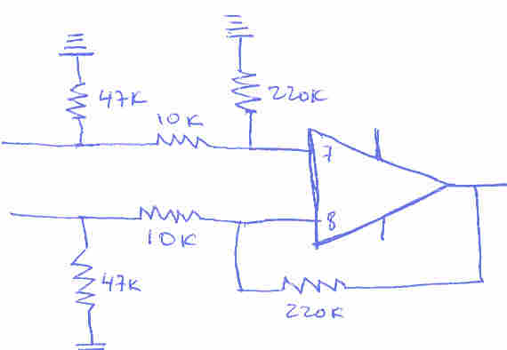

That will kind of work, but because your schematic actually does NOT balance the input impedances of the Amplifier the input will suffer very poor common mode rejection and will unbalance the volume control. The same will happen if the sourceimpedance driving the input is appreciably non-zero.
If a suficiently functional pseudo balanced input is required the following should be done:
1) disconnect the 47k resistor on the inverting input ahead of the 10k resistor
2) place a 22k resistor directly on the Chip's inverting input to ground.
3) replace the 47k resistor on positive input ahead of the 10k resistor with as close as possible to 10455 Ohm, you could use a series connection of 10k and 470 Ohm to get "close enough"
This will now make sure that both the cold (inverting) and hot (non-inverting) input impedance to ground are very close to exactly 10k and thus balanced. The gain on both inputs should be balanced too, so all on the green there.
I would again note that I do not think such an approach to be usefull in most cases and using the chipamp inverting with a 10k:10K line input transformer from a reputable manufacturer will give a much superior balanced input, but I have made that point before.
Anyway in case the pseudo balanced input is sufficiently balanced gain- and impedancewise, using an attenuator with 4 Tracks (which would have to offer a very accurate balance making a precision stepped attenuator in essence mandatory) will result in no degradation of CMRR. A larger CMRR degradation would be the case with your schematic if attenuators are used.
Of course, there is absolutely NO need to have a 4-Track volume control to make a balanced attenuator, but that as they is another story....
Sayonara

KYW,
I know I didn't follow your previous recommendations which you so kindly summarised but I was following the idea behind the schematics on the Marchand Electronics amplifier module seen in a previous thread which seem have same value resistors on both inputs. Does this mean their module is not optimised?
I am sorry for being a little ignorant of EE but may I impose on you to explain how you calculate these values to get the same impedance on both inputs?
One would HAVE to assume so... ;-)
Right, first the main reason. If the output impedance of the balanced source is not exactly zero and the balanced source is not fully floating (Transformer) then the different input impedances of the commonly used pseudo balanced inputs will cause an imbalance in signal. This IMHO tends to make the results often worse than a good unbalanced connection.
The input impedance of the "inverting chip-amp" is equal to the value of the input resistor with pretty good precision. This means the "stabilisation resistor" (inverting input to ground - 22k) and feedback resistor (220k) do not form part of the of the input impedance seen by the source.
Note however that they DO form part of the source impedance seen by the Chip Amp.
On the non-inverting input however we have an input terminat that in theory is infinite in impedance, so the input impedance seen by the source on the non-inverting amplkifier input is the series connection of the resistor to ground (220k) and the input series resistor (10k).
This means the inverting input (cold) has 10k input impedance and the non-inverting (hot) input has 230k input impedance. If we have a output impedance for the source of 300 Ohm per phase then one input will be attenuated by 0.011db and the other by 0.25db. So overall a 0.24db imbalance for the signal would be introduced by even a very modest source output impedance.
I'm not quite up to speed right now to know by how much the CMRR would be degraded (if anyone is handy with this stuff please post), but it would not be small.
So our main task is now to make that 230kOhm input impedance on the "hot" input equal to 10k. If we parallel 10475 Ohm (a 10k resistor in series with a 475R) with the "hot" input to ground (XLR Pin1) we get
230k//10k475 =
(230 *10.475)/(230+10.475) =
2409.25/240.475 = 10.018712 Ohm
So now our "cold" input shows an impedance to ground (XLR pin 1 - ground) of 10k nominal (say +/-0.5% if we use a 0.5% tolerance resistor) and our "hot" input shows an impedance to ground of 10k +0.18%, or well within the tolerance of the inverting input resistor.
If one where to make sure of maximising the CMRR absolutely then all resistors used (220k X 2, 10k X 2) should be of 0.05% tolerance. In this case the impedance matching resistor should be 10455 Ohm as accuratley as possible +/-5 Ohm look fine for 0.05%....
I hope this clarifies the issue.
Sayonara
