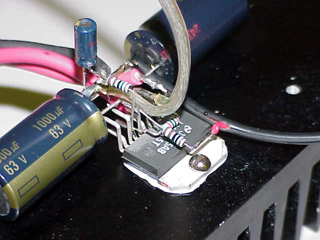

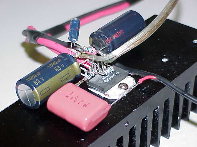

My inverted LM3875 prototype (as it sits now) is using Rubycon YXG 1000uF(63V) per +/- leg (4 total) and I hear no sluggishness or muddiness at all. In fact, my father, a long time audiophile (and aerospace engineer), was amazed at the dynamics, cleaness and musicallity of the amp with so little filter capacitance. I kept the number of parts to a minimum because I have been trying out different component brands and values on the input side. Unfortunately, a slow process, because I allow for @24 hours of a break-in period. I run the unit into dummy loads when I am not home listening to music. I have 4 more of these and plan to double them up tonight and see if there is any change. I honestly wouldn't be suprised if there wasn't any audible difference but, then again, I wouldn't consider myself to have very critical hearing either.
I have pretty much settled on a RelCap RTX 2.0uF(400V) as the input cap to use. I can hear no difference with those in the circuit or out. IOW, transparent. I don't have any other values of that brand and they are getting expensive because they might not be manufactured any more. Auricap's version sounds nice but adds coloration toward the warmer side and softens the sound just a little. I am waiting for a couple of TRT's to come in, but will probably save them for another project.
I am using Dale 2B resistors(NOS) and like them but have some Mills to try coming with the TRT cap order. My over all opinion is that there is less variation in quality of sound with changes in components in this amp than with other designs. Pretty much anything sounds good and some changes sound very good. Probably because of this IC's good design and high PSRR/CSRR, although I think Kuei talked about how using the inverted leg reacts with the ICs internal feedback. Anyway, a great bonus with this amp is that these changes are much less expensive to try than other designs. 😀
Thanks, however...
Halojoy,
A couple of points--I don't want to use a Zobel network on the ouput if possible, and the circuit in the specification sheet has too much gain for my application. Most every general audio application circuit for these power op-amps are the same. The general principles for gain selection and proper coupling are demonstrated in all electronic devices texts and the information is also readily available on the web.
The point here in this post and I believe on this board is to apply acquired knowledge through experimentation to gain more knowledge. I apply this principle on a daily basis and in doing so I will hopefully gain better insight into the subtlties of these devices and there possible applications not only for audio but as motor drivers, etc.
By the way, the standard setup is rife with problems, not schematically, but topographically if proper design techniques are not considered when developing a PCB, if that is desired. Reading the application notes is a must.
