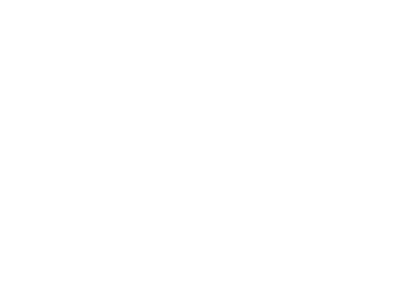

Bridging gainclone
As I am working on some pcbs holding independent and separate non-inverted gainclone versions on the same board, it seemed like a natural idea leaving them prepared for bridging if necessary too.
In spite of using two inverted versions being Thorsten's preferred way, using a transformer to invert one amp input, it's still worth it see how the simpler bridging proposed by National sounds.
What I don't quite get is why the two versions have not the same gain. Can anyone explain why?

Non-inverting vs. Inverting
The gain calculations for the non-inverting and inverting amplifiers are different. Without getting into a lengthy explanation, the gain of the inverting amp is Av=Rf/Ri and the gain of the non-inverting amp is Av=1+(Rf/Ri). Therefore the ratio of Rf/Ri for the inverting amplifier must compensate for the unity gain portion of the non-inverting amp by using a larger feedback resistor.

Re: Non-inverting vs. Inverting
OK. I guessed it was something like that. Thanks.
My intention is to use the "gainclone popular" inverted version as the basis for both amps. That is using 220K/10K to set gain on one amp and a 2.2uF film cap to block DC. The non-inverted stage's gain should be corrected following the Av=1+(Rf/Ri) ratio.
My doubt now is how to compute the Rb resistor from non-inverting pin to ground on U2.
